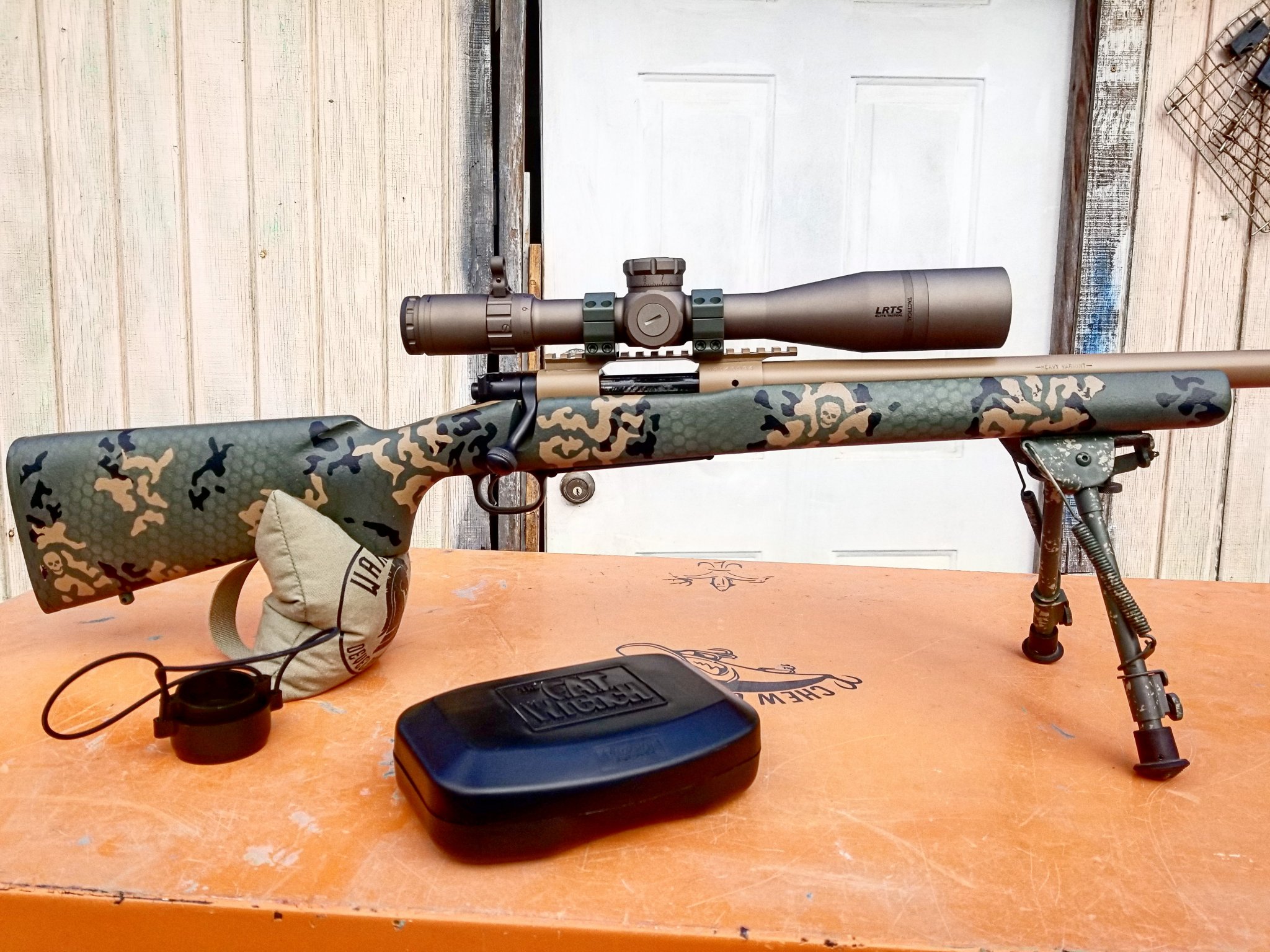

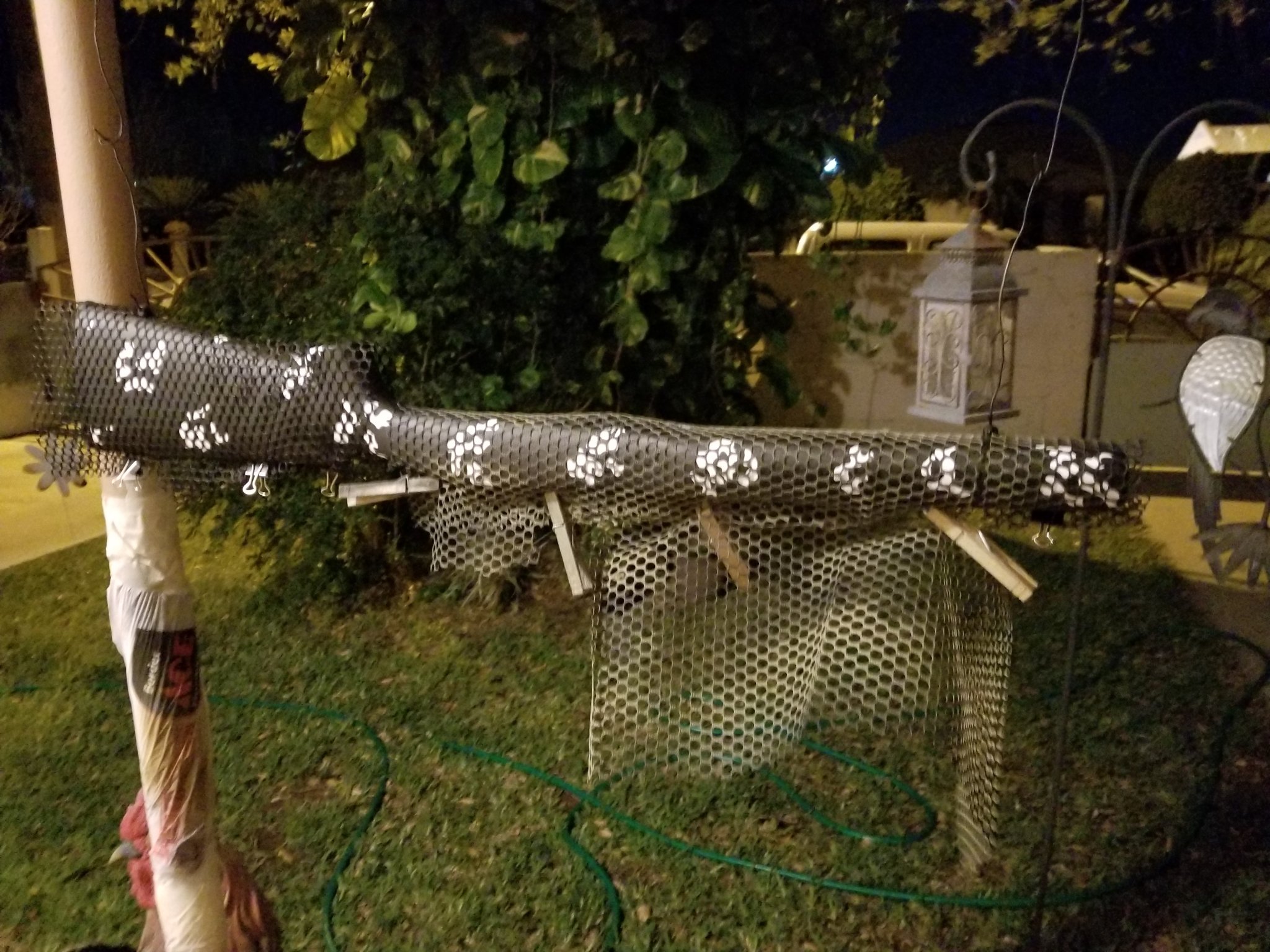

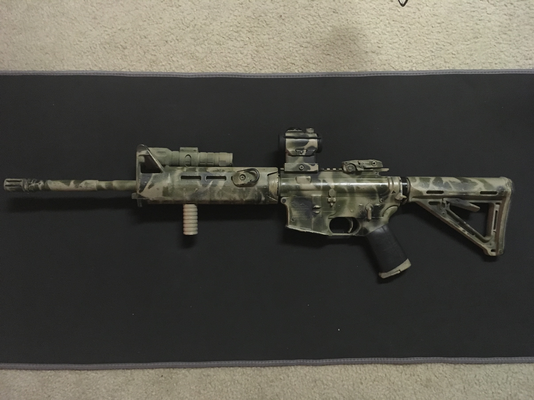

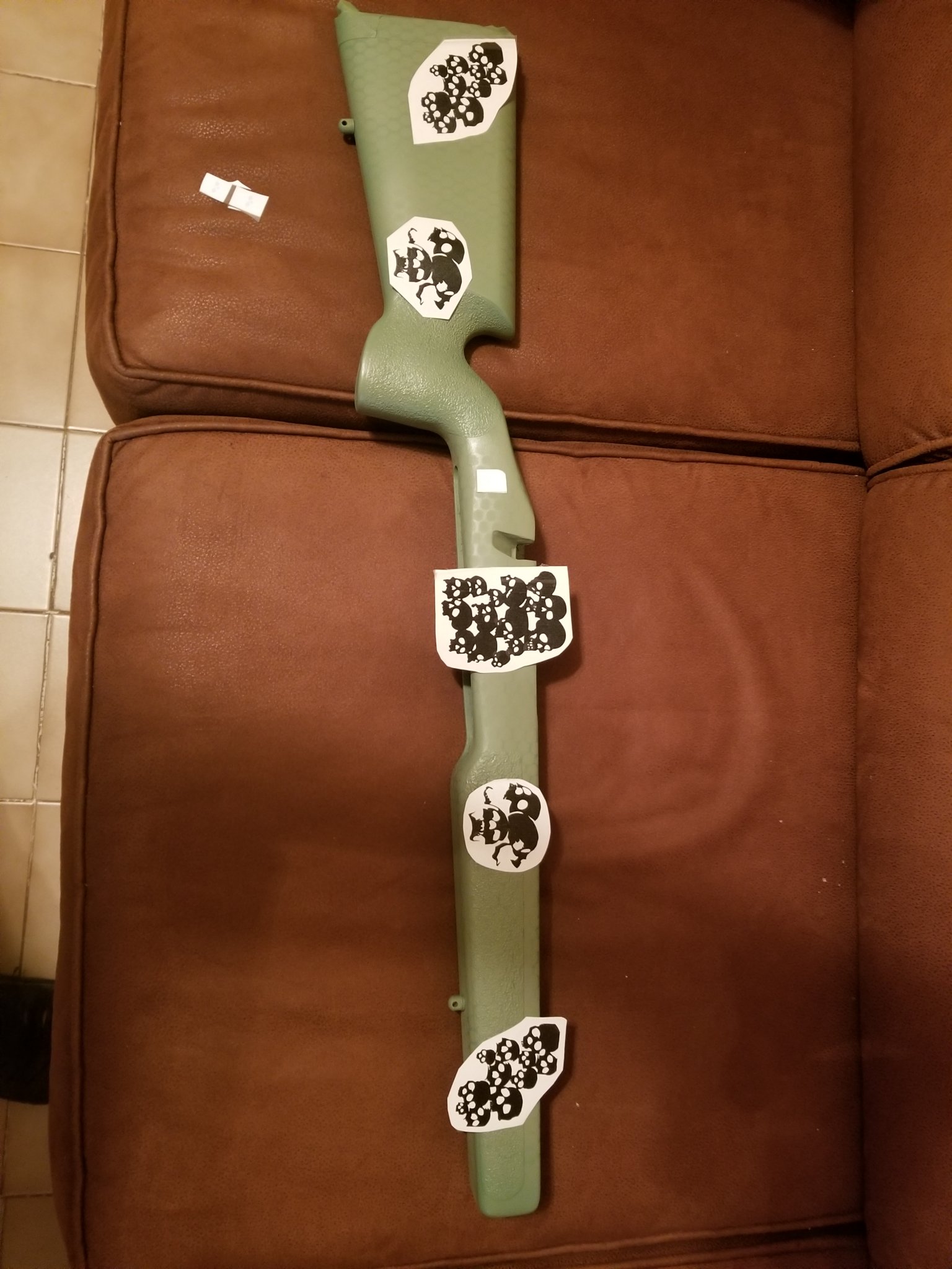

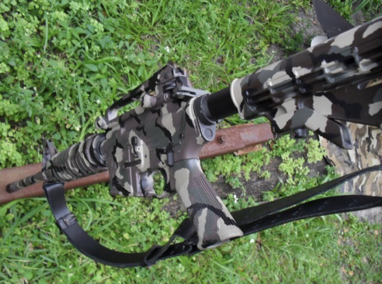

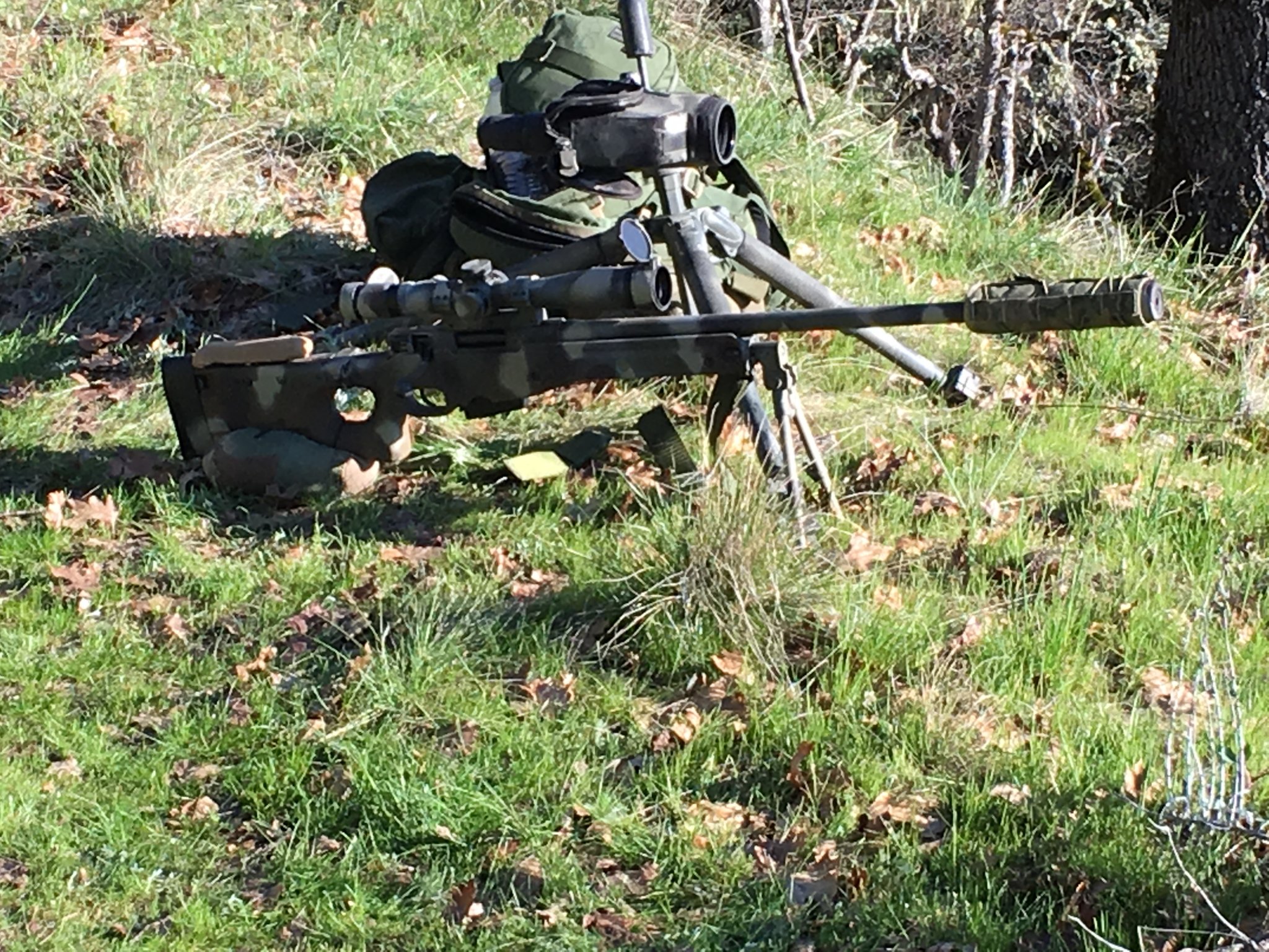

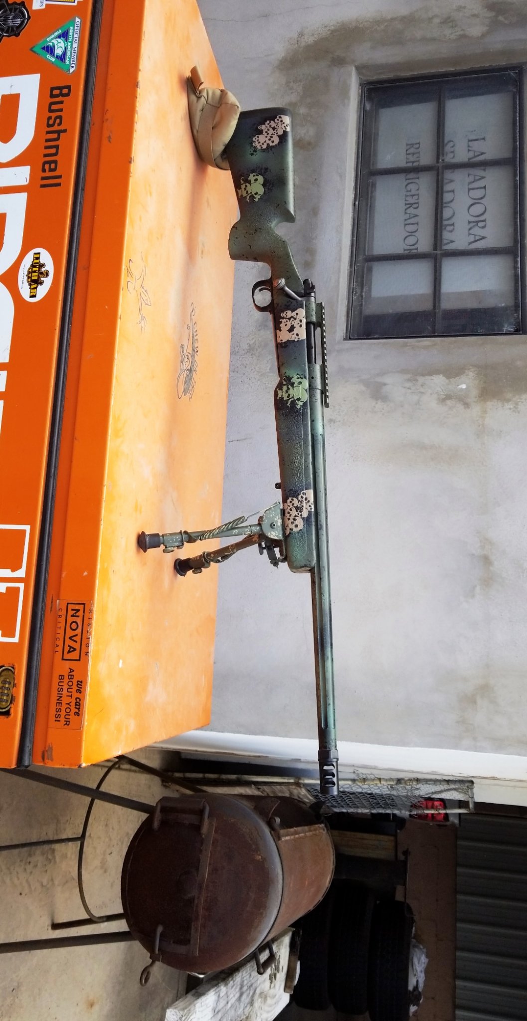

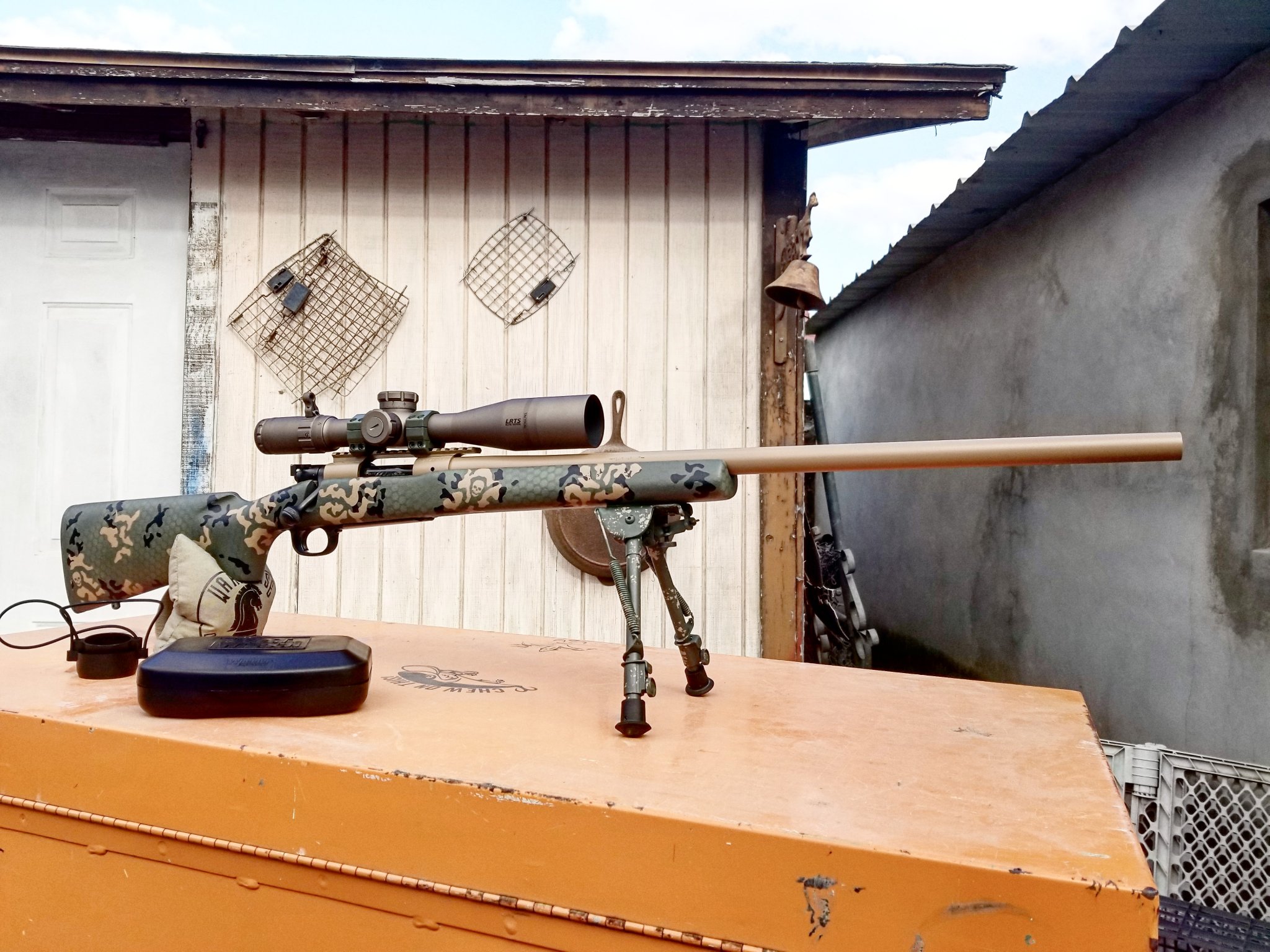

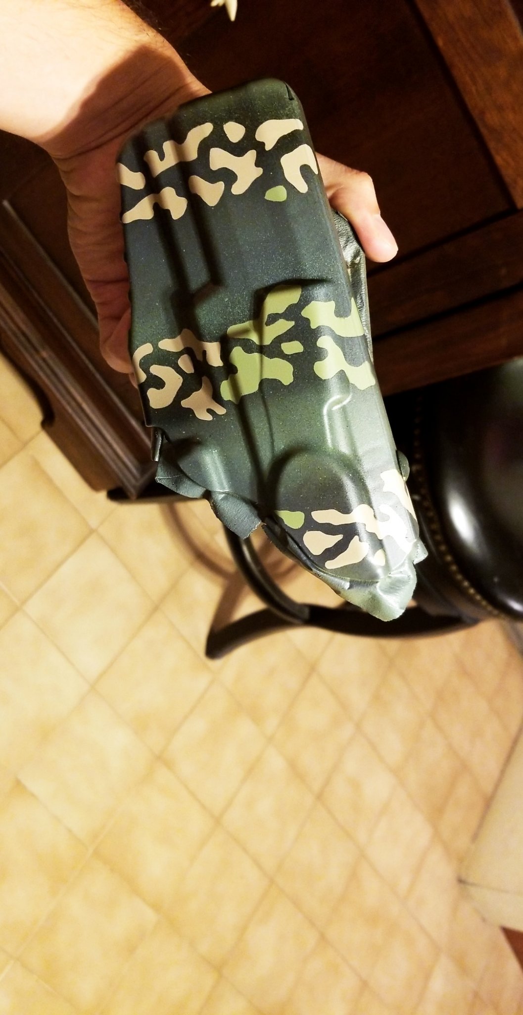

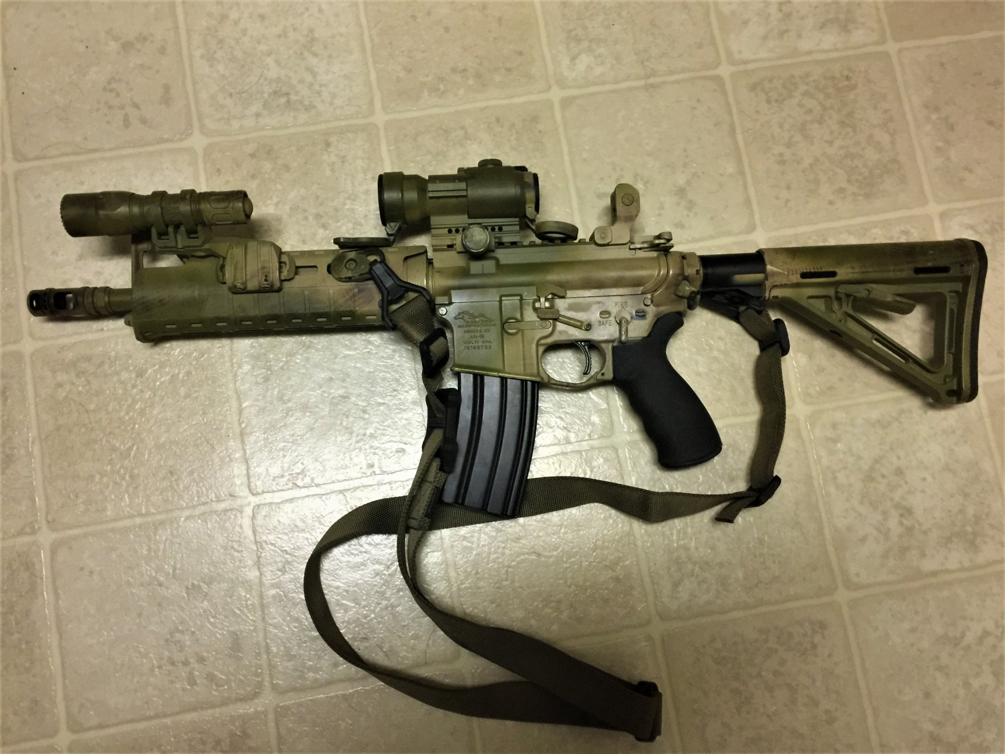

    I can relate. Maybe this will help. I sent one gun off for Cerakoting to Mad Custom. Looks great, very happy with it. Then I rattle canned another. Very happy with it. All the rest I finished myself, Krylon/Rustoleum, and haven’t looked back.
    I’ve got a background in interior finish work, drywall and painting, so I wasn’t too concerned. Grab some cheap throwaway stocks or old beaters from a gun show, practice on those. Pretty good chance you’ll know then what you’re willing to do after that.
    Show us how they turn out!
    ETA: like is often pointed out, it’s really mostly about prepwork, keeping each coat lighter than you think it should be, and be patient. Base coat lighter color.

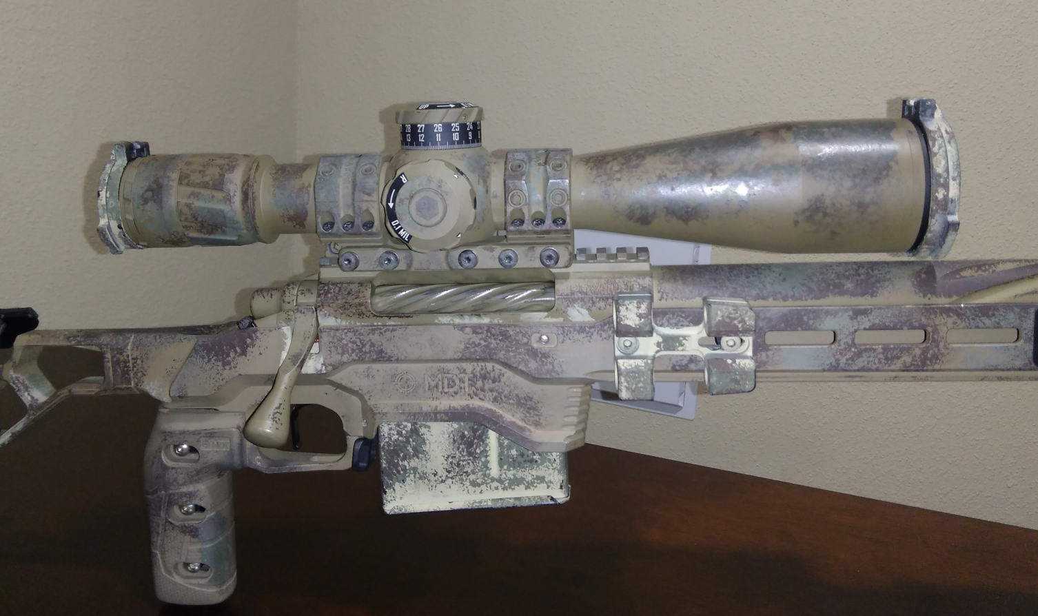

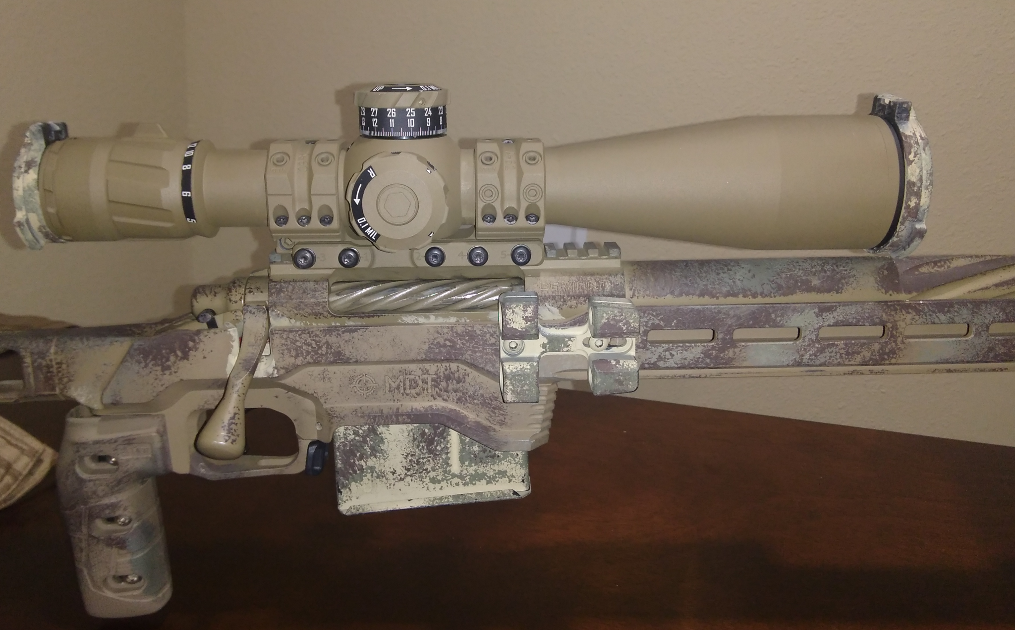

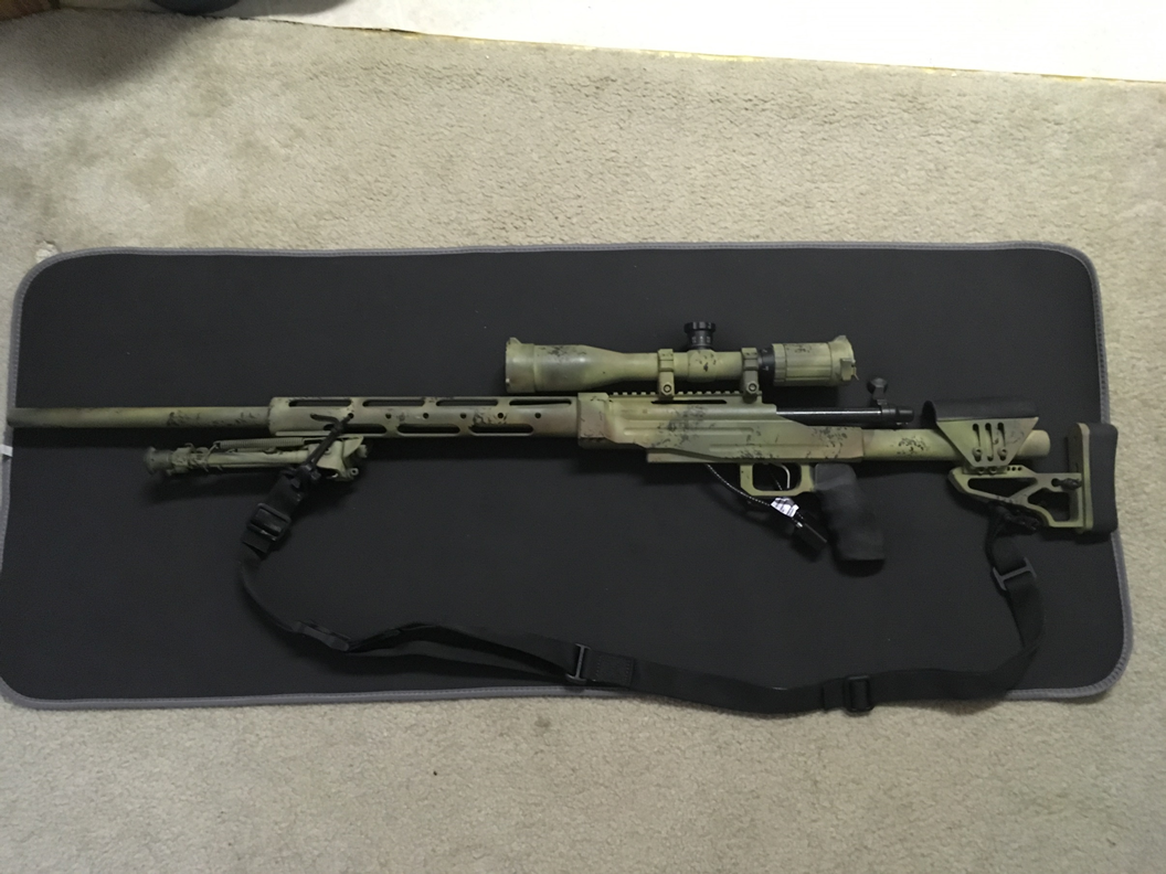

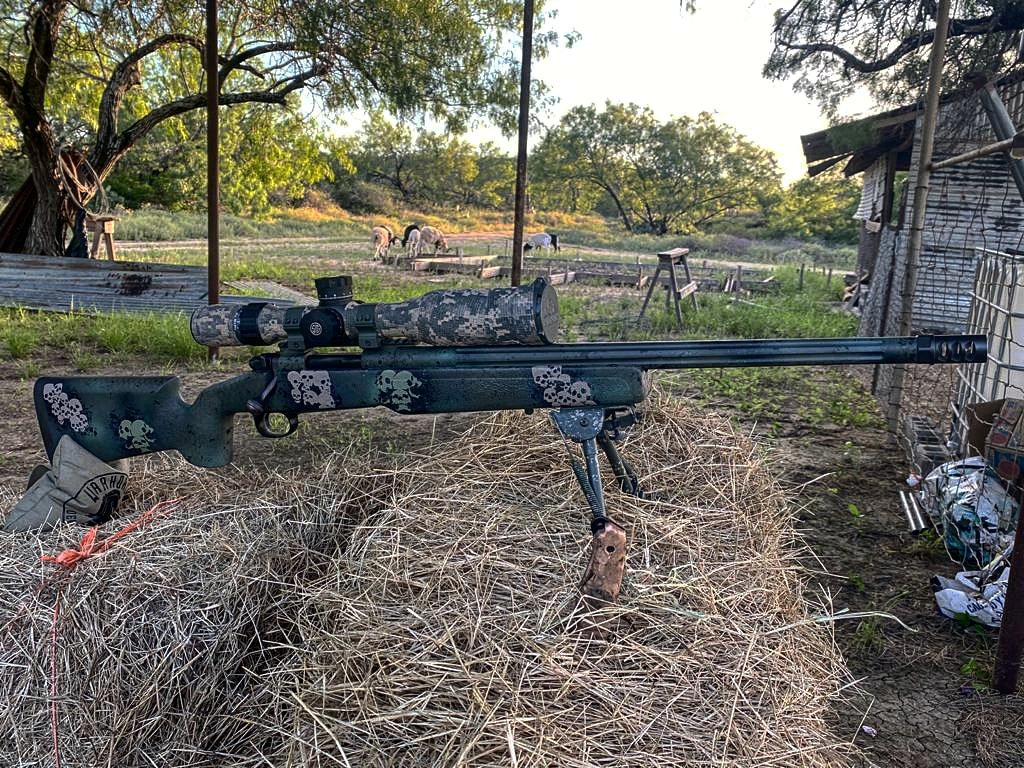

    Maybe this will help....My project today is to finally get around to painting my scope to somewhat match the rifle:
    All total..scope and rifle and accessories....this lump of metal is just under $10k....I HATE plain ole black rifles....everyone has one...they get hot in the summer....and they are BORING. I know beauty is in the eye of the beholder....but sometimes you gotta make things appeal to you...and not those around you.
    My goal in painting my rifle is stop babying it...to use it as the tool it is....don't worry about a ding or scratch here or there....it's a friggin tool....go put it to work. They cry when you put them into a safe....they beg to get out and stretch their legs.

    Here are some of my rattle can painted rifles

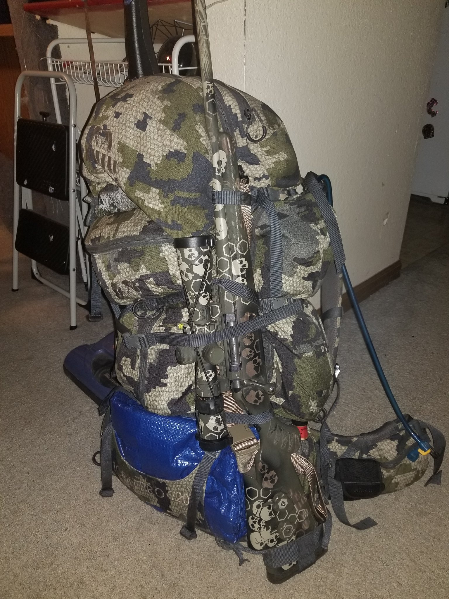

    The good thing about rattle canning over the top of a nice Cerakote is....when you decide to wear different shoes and carry another purse....you can acetone the paint straight off and change it to match your outfit of the day.
    This is my I Don't Give A Fuck paint job:
    And later on...when I wanna go to something else...I can strip this off in an hour. Sorry @CSTactical for covering up your beautiful Cerakote job :)
