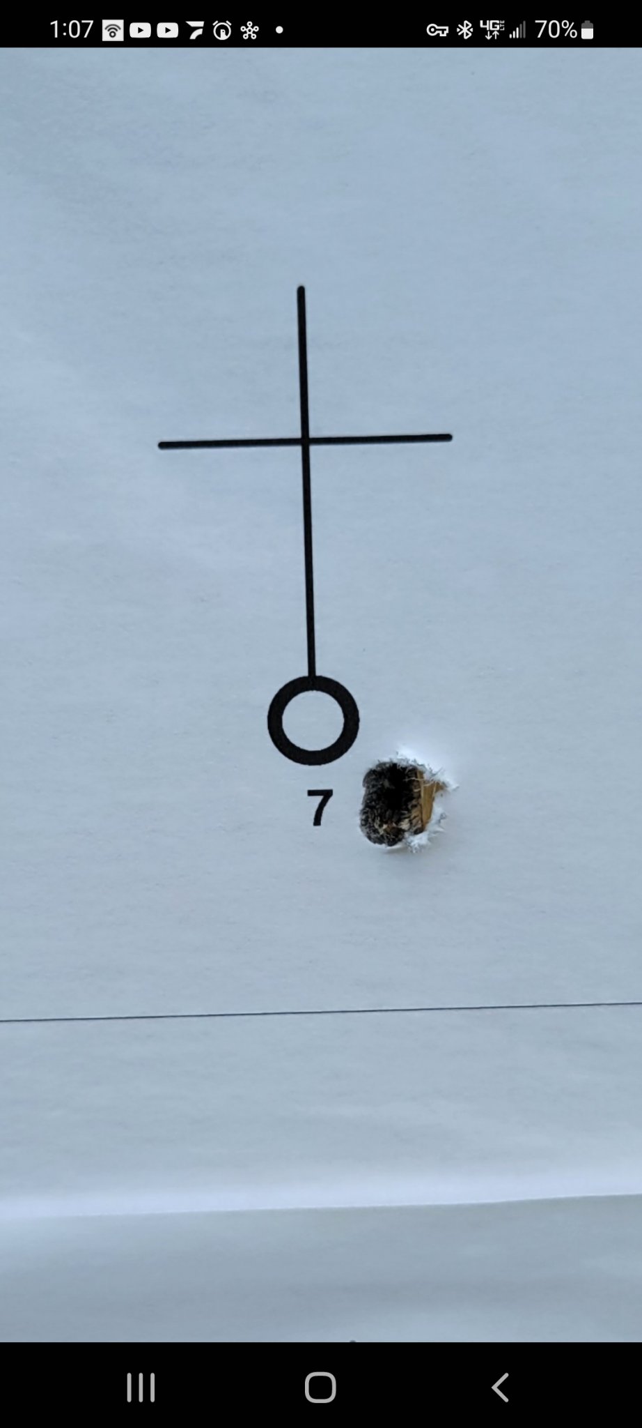

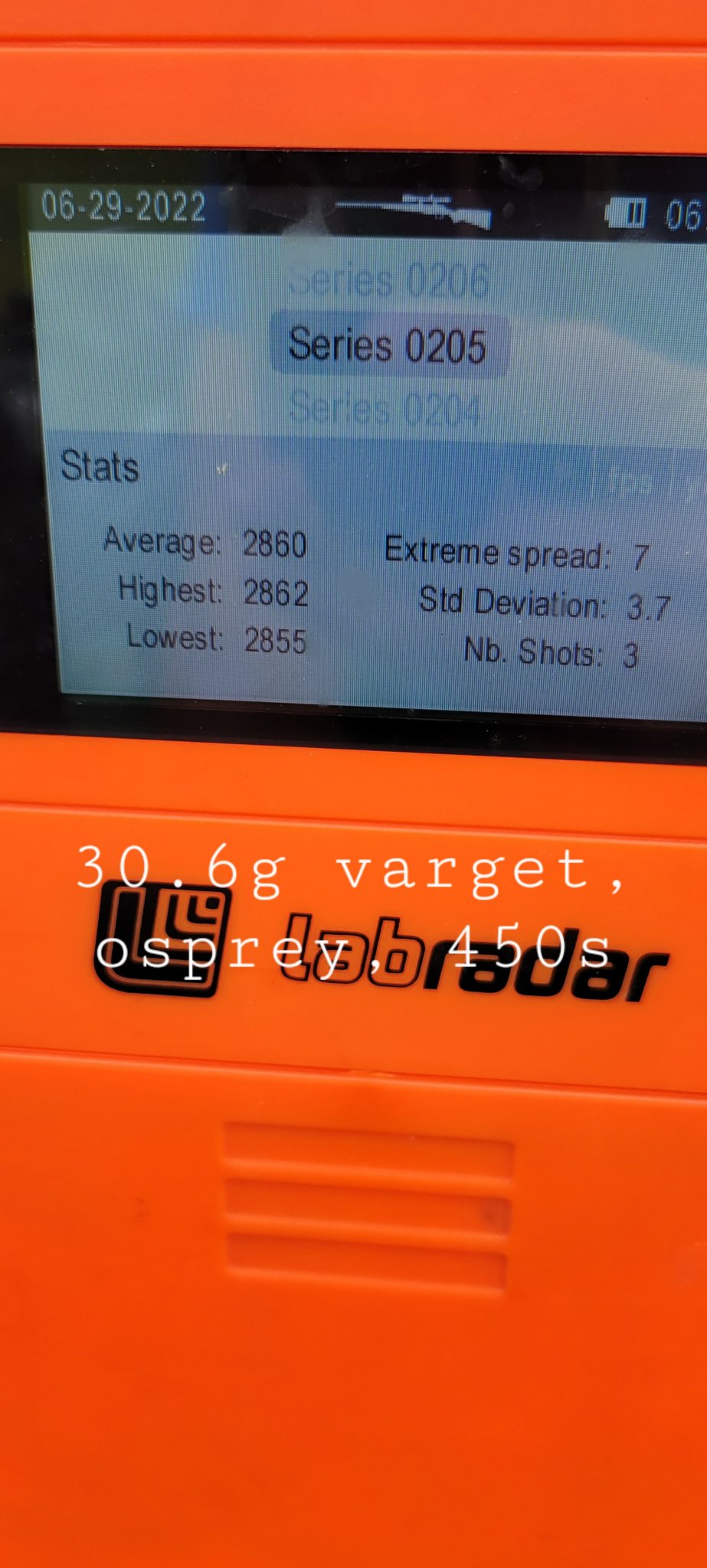

Here is what I've done with my current barrel.
I love a dasher. With that said, I took a 28" barrel, chambered it in 6 dasher, and im running it at BR speeds. So 30.6gr of varget gets 2860 fps with little to no effort, low SDs, small groups, yet feeds great. Ive had a BR and dasher. I think th shoulder angle of the dasher lends to better feeding, and improving the case from BR negates the need to do a lot of trimming. So it's BR performance, dasher feeding and little trimming ever needed. Fire forming brass isn't hard but it is a pain sometimes. Your option from there is getting brass hydro formed, false shoulder method, or jamming. All work (or cost) but they all get it done. I think this is the way I'm going from now on.
