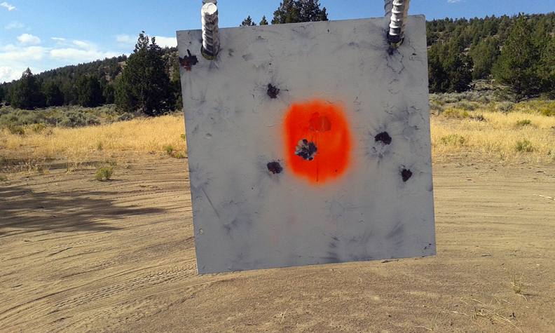

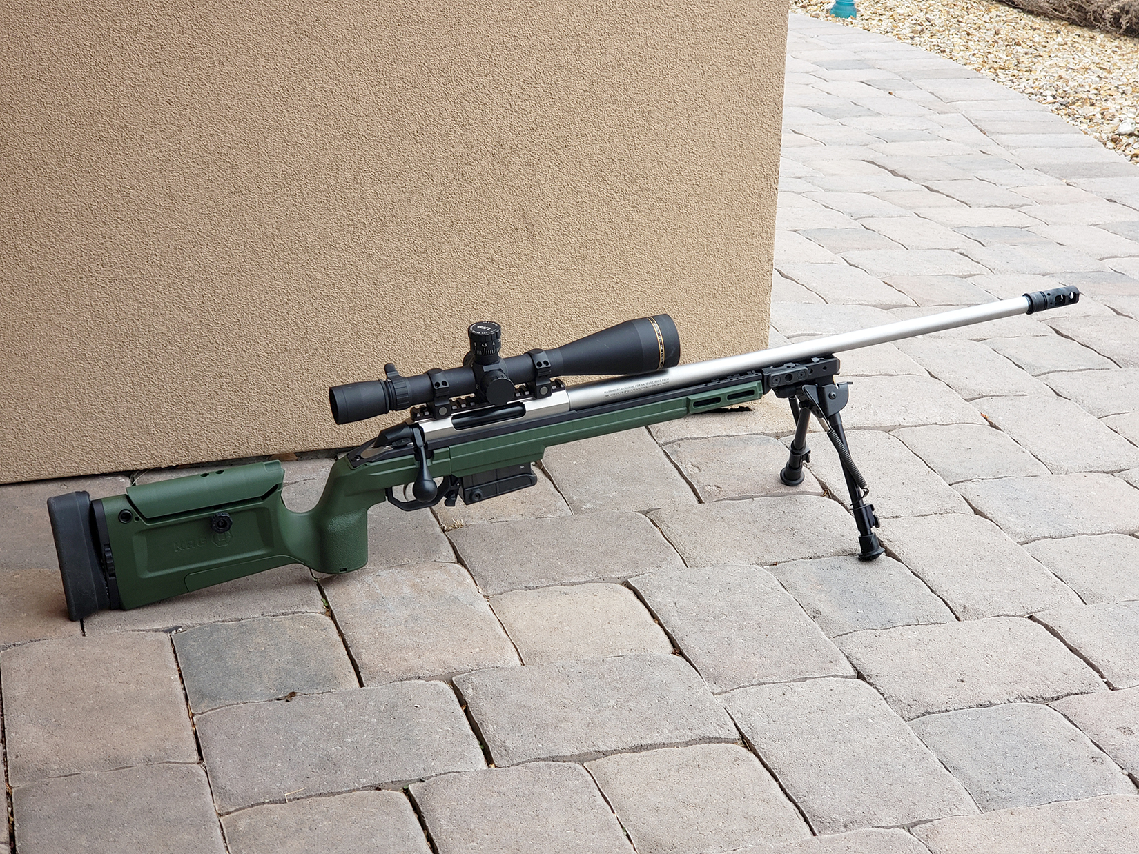

I have shot a 6.5 CM Tikka CTR stainless in both factory stock and KRG Bravo with Tikka magazines out to 1,400 yards on our local "gong" range. With one MOA steel targets. You can lighten the trigger pull with a Yo Dave spring so it is pretty much touch it and shoot. I added a 20 MOA base and use a mid price Leupold 6.5 - 20 x 50 scope. I started off with Hornady Ameircan Gunner ammo to get to know the rifle and used the brass for several reloads, then switched to small primer Lapua. About 1.0 grain less powder in the Lapua brass. You need reloads past 700 yards or so. I have used both 140 and 147 grain Hornady ELD's, 140 Nosler RDF and Berger 144. All with RL16. You will not be sorry you purchased a Tikka. Windage calls are probably as or more important than the rifle you choose.

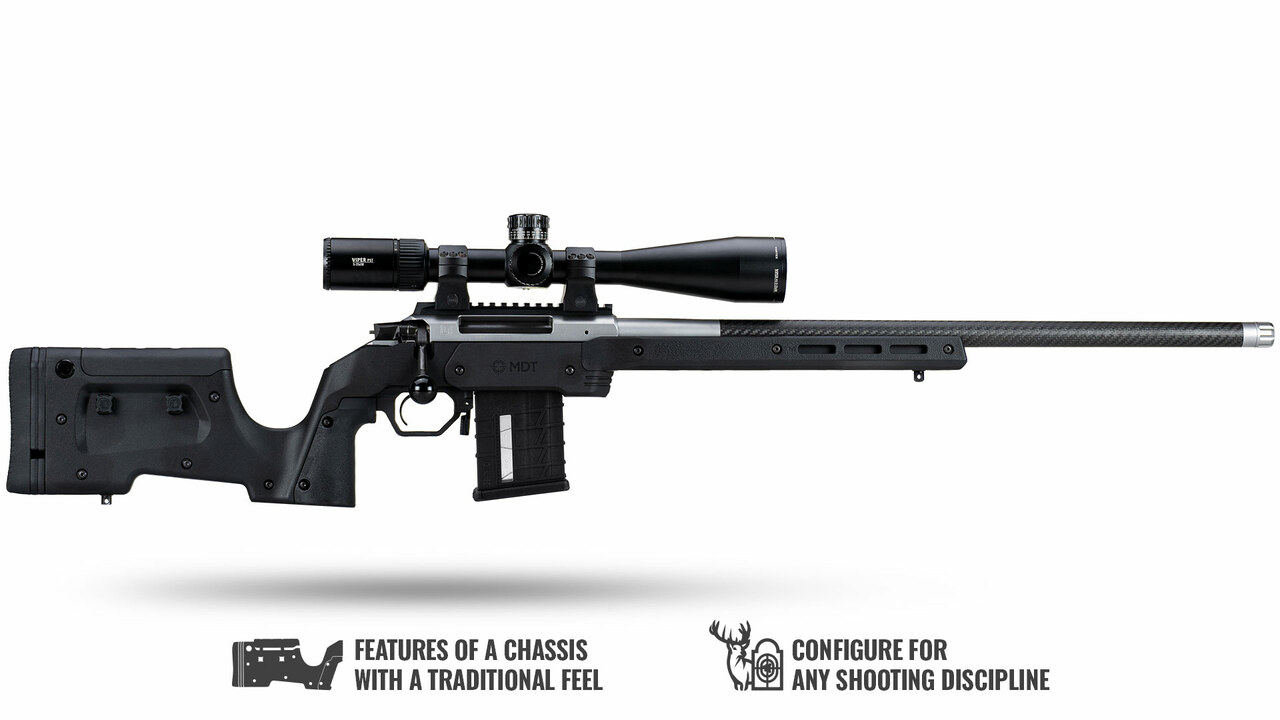

I have the B14 in 300WM and its pretty darn nice right out of the box. my trigger is perfect. and the factory chassis is great. I like the Howa but it comes with that embarrassing, and completely useless LUTH-AR Stock, really really shitty piece, also you will hate or love the layout, the scope no matter what you do sits very high and while im ok with it, a couple of friends just couldn't get enough adjustment out of the stock. replace it with a magpul, but other than that its a really good shooting rifle, and the Tikka if I closed my eyes couldn't tell from the Howa. and this is the MDT chassis I like.
