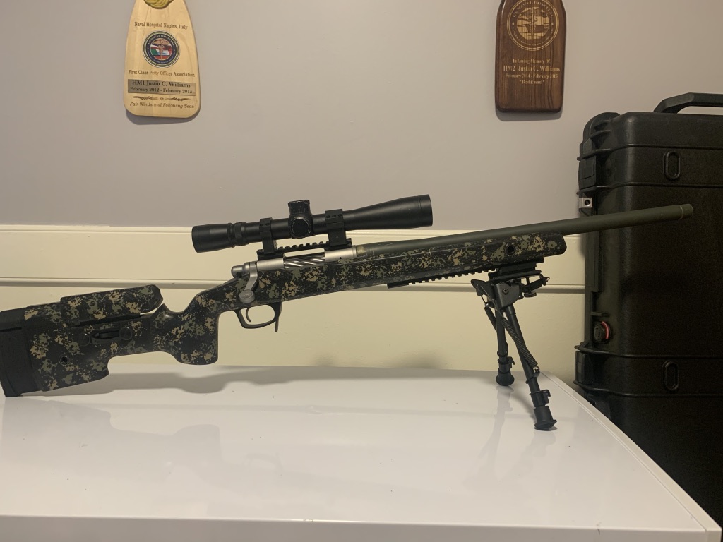

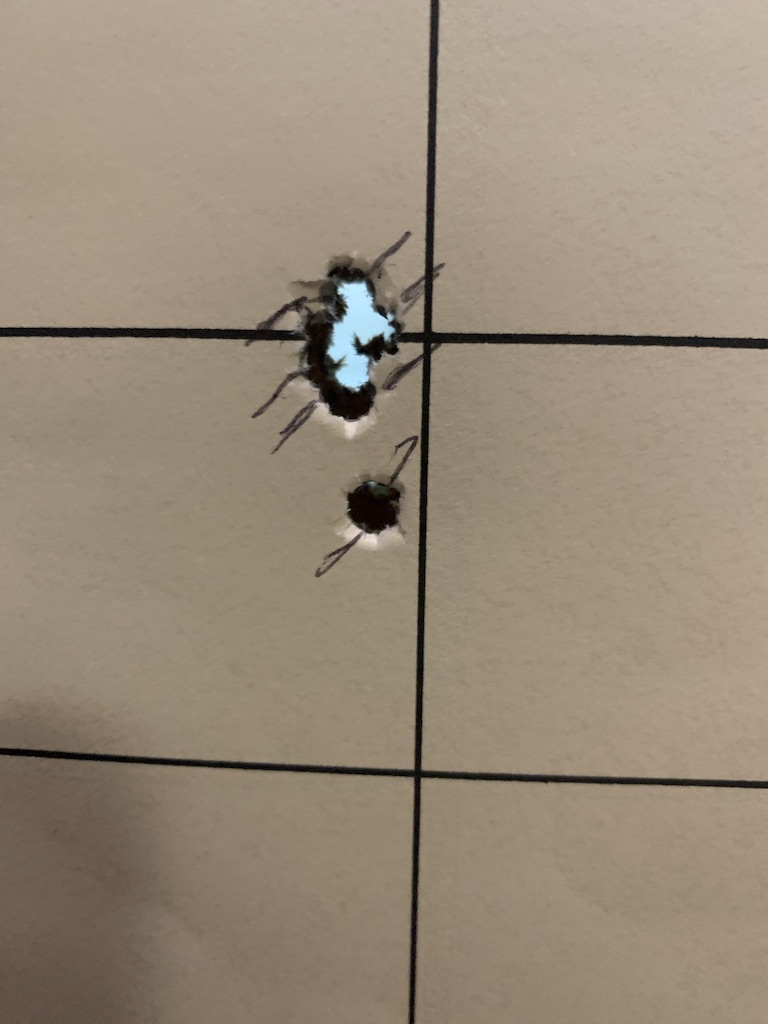

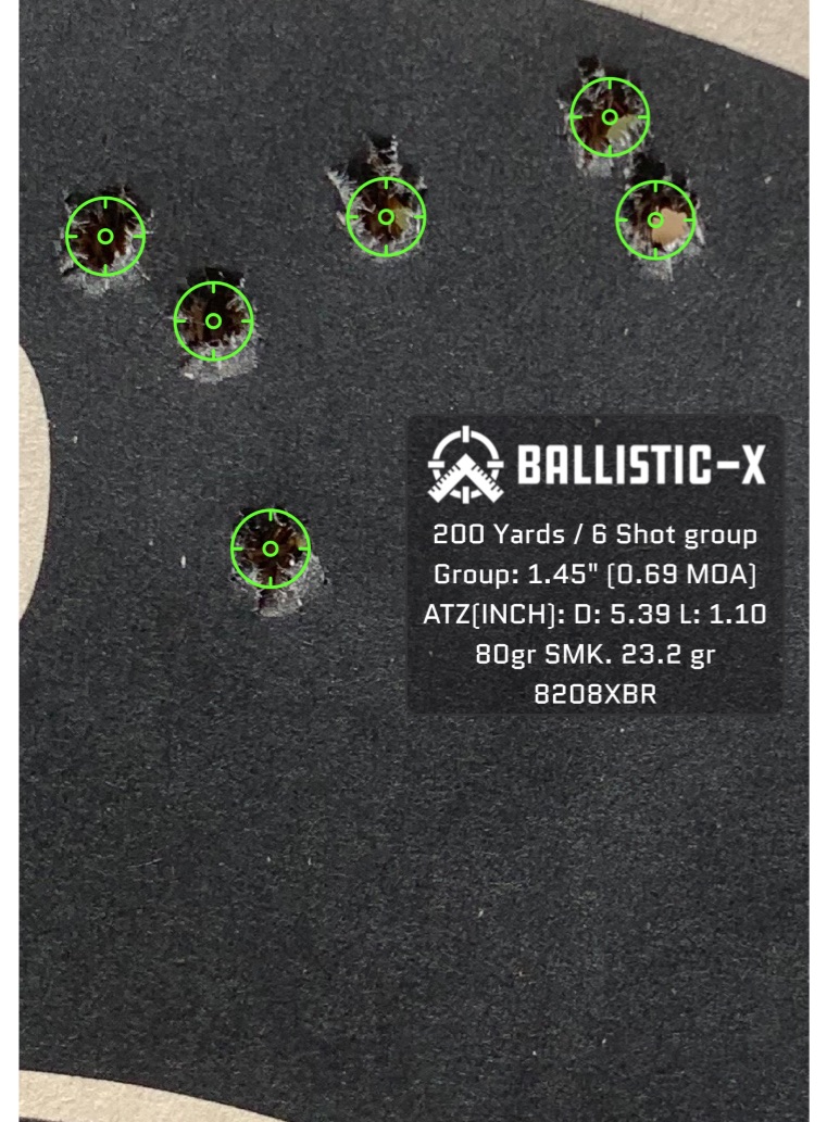

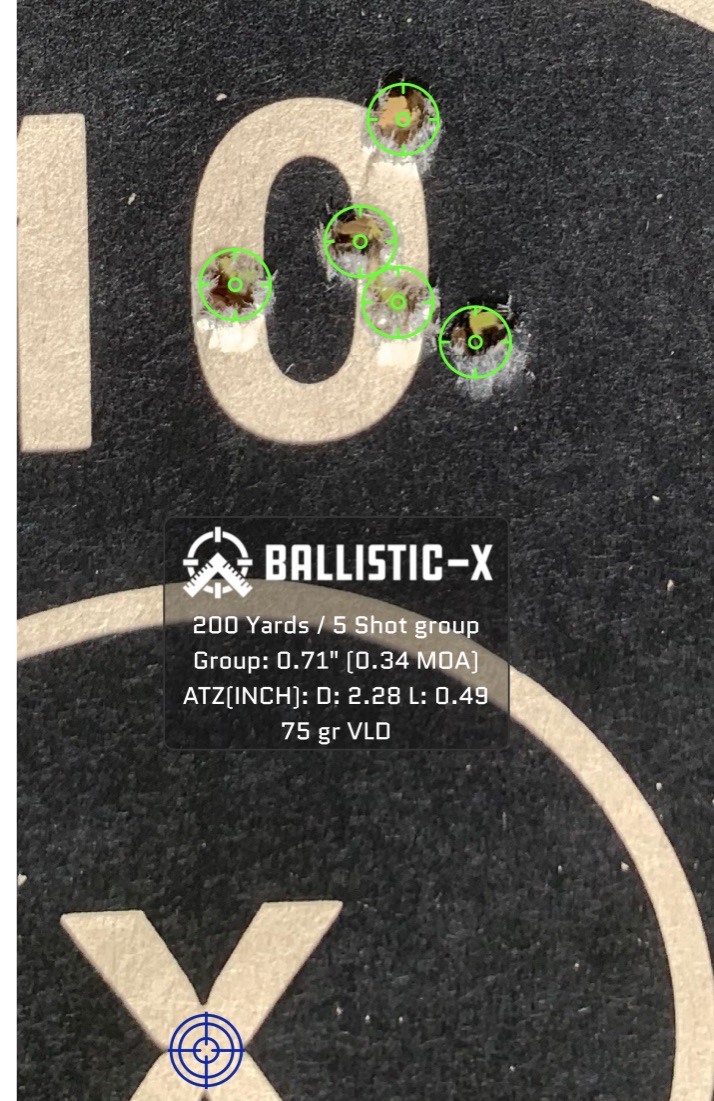

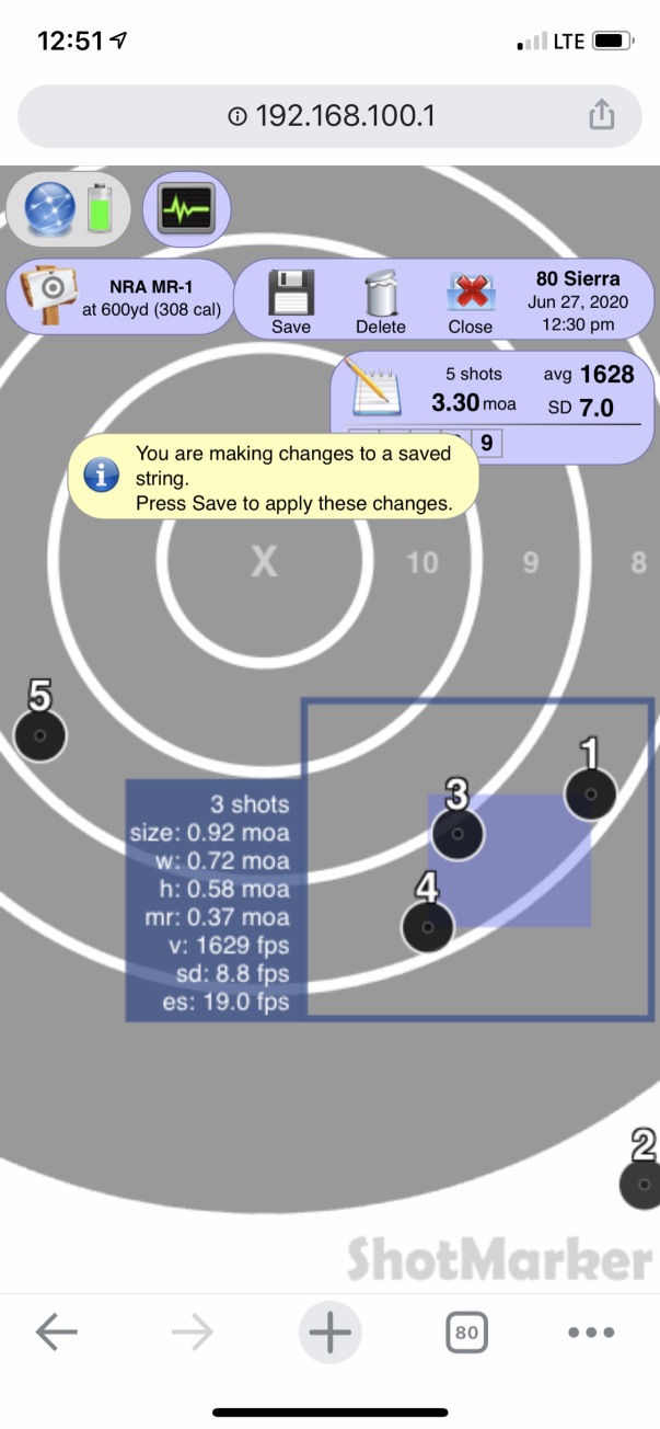

Here are the pics of my build and what it has done. It is a Rem RR trued action, a kreiger 1:8 Barrel, X-mark trigger, and Leupold Mk4 Glass, bedded in a McMillan Carbon A5 Stock. The Shot Marker image is at 600 yds shooting 80 SMK, with a sling as support, the Ballistic-X pic is at 200yds on a bench with 80 SMK and 75 VLDs. The tightest group is at 50 yds using 77gr black hills during sighting in. Hopefully this gives you an idea of how wildly 223 can be out of a custom rifle.
