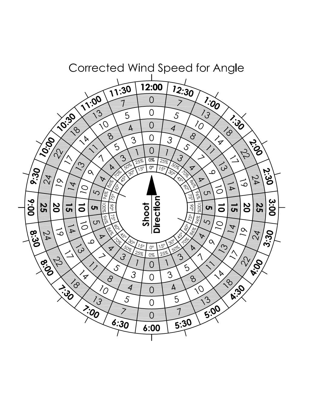

The "o'clock" wind is the direction it is coming "in" from. Example: Wind blowing left to right (full value) is a "9 o'clock" Wind; NOT a "3 o'clock" wind

As long as we're settling wind debates.... Sorry it's a bit of a read.
Let's say I have a 10mph 6:00/90° that requires a 1.0 MRAD wind hold. If I face my wind meter perpendicular to the target it will read 10mph. Wind effect 100%=wind meter shows 100% value.
Now let's say I turn 90° to new target exactly the same distance away so I have the same 10mph at 3:00 or 9:00/180° that requires no wind hold. If I face my wind meter exactly perpendicular to the target (say it's affixed atop my aiming system to be checking the wind at 90°) it will read 0mph. Wind effect 0%=wind meter shows 0%.
That shouldn't be too controversial but now for the twist:
I turn 45° so I have have the 10mph wind blowing at 45°/10:30 or 1:30 and a target at the same distance again. At this angle the wind has about 70% of the effect it did at 90° so that 1.0 MRAD hold is now 0.7 MRAD.
The question I have is: if my wind meter is also 45° to the 10mph wind (that is acting on my projectile like a 7mph wind at 90°) will the wind meter read 7mph and if not what will it read? 6.9mph? 7.1mph? 5mph? 9mph?
Basically is the effect of an indirect wind on the impeller the same as on a projectile in flight?
No, the force applied to the impeller and the tunnel that the impeller is housed in will not give the correct angular wind effect. I have found it to be much higher than the actual effect.
Interesting. I suppose I could have lined up two or three wind meters but I figured there were smarter and more experienced people than I who knew. I appreciate the response.
If you have the opportunity to watch a bullet yaw in flight....it makes more sense.
As soon I read that I imagined a weathervane type effect or something that I hadn't really thought of.
I took out my tongue in cheek comment about the projectile type as that was just meant to avoid semantics about a left or right wind.
