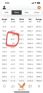

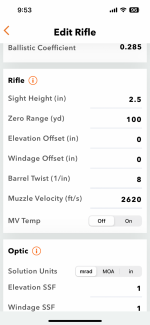

So I've been using Geoballistics for about a year now and I'm very comfortable with it. It is simple to use and navigate through but I keep running into a weird quirk. When I input data to zero the rifle, it shows up in the table as needing to drop down .1 at 100. I thought maybe it was atmospherics but even if I create a completely new profile and use the atmospherics for that day and time, it still shows to drop .1 at 100.
I know that .1 isn't a big deal and even out to 1000, I should still be on steel but my OCD is seeking perfection. I want to rule out everything other than the errors I induce into the system.
Oh, and it does this on every load I've tried.

Since I didn't find out anything here, I sent an email to Geoballistics and included my phone number. About 20 minutes later, I got a call from Ryan at Vortex who got to troubleshooting it with me. It turns out this has to do with crosswind jump. I had loaded my app with a 5 mph crosswind so it gave me a reference point to be working with. Turns out, that was enough to create a rounding issue that shows a .1 down in that 90 degree wind situation I created.
I went into the settings and turned off the crosswind jump feature and now I show zero at 100. As I get better at this, I can turn that back on but for now, that kind of info is lost in the muddle of my own shooting anyway.
