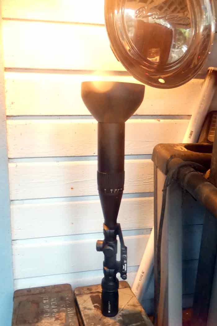

    Here's my Ultra low light scope
    (just kidding :) )
    Notice how the off axis light from the porch light messed up the picture.

    At 100 yards you are stuck with what's there. No light (dark) outside the field of view, no interference.
    The large reflector in my picture captures about 8 times the light that would normally come in to the objective. Gathers lots of light, then sent down the 4 inch long sun shield to straighten it out and send it into the objective lens.

    Anyway there is a way to TEST your hypothesis without an optical bench. A digital camera that has the capability to create a histogram of the incoming light. You can adapt the camera to the eyepiece of the scope. Focus on a darkesh scene and have some off axis light that you can move and adjust. The histogram will show you more light coming in. That is how good the lens stops and antireflective coatings, and the 'BLACK' interior prevent this unwanted light.
    Off axis light makes the scene appear brighter. More light is brighter but the desired image is washed out by this unwanted light. Take my word for it :) it is unwanted.
    My red light example can easily be duplicated with a digital camera at the eyepiece end of a rifle scope. Find a darkish area and set up a dozen rabbits in a row. Dead rabbits, frozen rabbits, or even paper rabbits :) Make the row wider than your field of view at mid power on your scope.
    Illuminate the rabbits with a green light. Use a Red light to illuminate the rabbits outside your field of view. Check the overall histogram of the camera output and look for off axis red light.
    In this experiment Green is the desired image, Red just degrades it.

    Take a look into aperture reducers for large objectives and what they do for image sharpness and depth of field.
    Find some on-line ray tracing diagrams showing a telescope (rifle scope). Straight lines from the object or total field of view to the objective lens sets the aperture of the scope. Nothing outside the aperture is desired. A 50mm objective rifle scope will have a shield about 58-60mm in diameter. This will limit viewing angle to just a few degrees. Stack two 4 inch long sun shields and you will Vignette as you decrease power on the scope. This cuts into the field of view. A dim area at the outside edges of the scope. By reducing the TOTAL amount of light entering the scope (losses at the edge) the remaining area appears brighter. Why? The eye adjusts to the total scene. Removing edge lighting and the eye adjusts to the remaining light.
    It just might look brighter with the narrower illuminated spot zone.
    The camera histogram will show less light but the center will be brighter than the edge.
    So having read this thread, I don't believe anyone directly addressed the following: The only desirable photons are the ones being reflected directly by the objects you can see through your scope.
    Since we aren't trying to look at the inside of our scope, or the inside of our objective scope bell, or the inside of our sunshade, as we don't want photons reflected off of those things and focused on the retina of our eye by the ocular lens. If light is reflecting in any way off of your sunshade or inside of your objective bell, no matter the color of the thing (white, black, mas grey, coyote tan), what you will be seeing as a result of that light is the objective bell, or your sun shade, or as previous posters relayed about extreme angle light sources, the source of the light itself. Since we don't want to see those things, we want to minimize to the greatest extent possible the light coming from those things, hence the flat black finish and texture of your sun shade.
    Why does it seem that no one paints the inside of the sun shade?? Seems as it in (any color other than black) would help in the light gathering.
    This is more about the sun shade portion/accessory, not about the scope objective bell itself.
