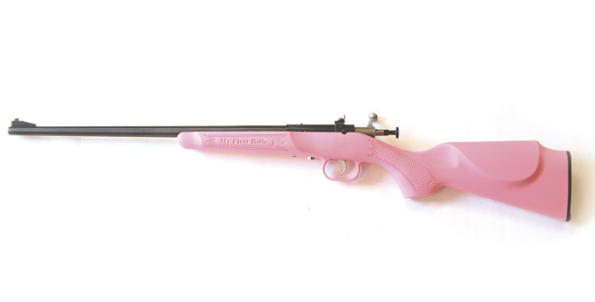

How does something like this sound:
In all seriousness, I'll be curious what you end up with as I've got no clue where to start either.
