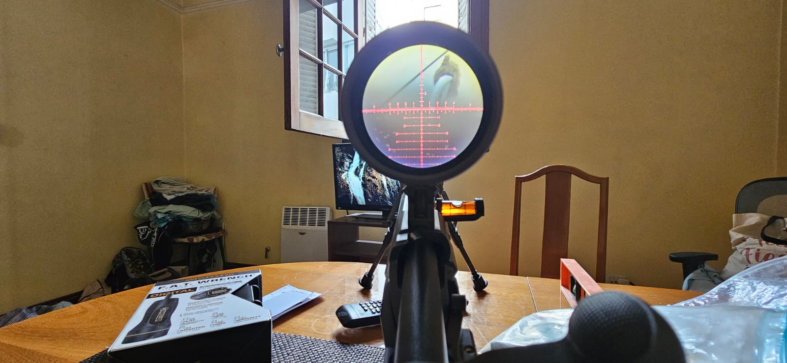

So I have this problem where I cant for the life of me leave the scope alone and go quietly into the night without wondering whether the scope is absolutely leveled. I've measured it with literally anything in this world that I believe is perpendicular to Earth. I've bought 3 different plumb lines, I've used the flashlight method, 6 bubble levels, I've measured it with every radio antenna, every visible straight line in every building that surrounds my apartment, not sure thats legal while the scope is mounted. I KNOW its leveled NOW but I keep going back to it every time im back from the range or when the rifle/scope bumps against something or a new accessory is installed on the scope. Its taking my precious time away from family, sleep, meals and leveling my scope. Help.

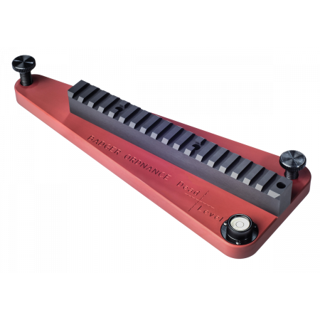

See: badger, area419, gray ops, Hawkins, spuhr
Also the badger dead level is an awesome tool for leveling a scope.

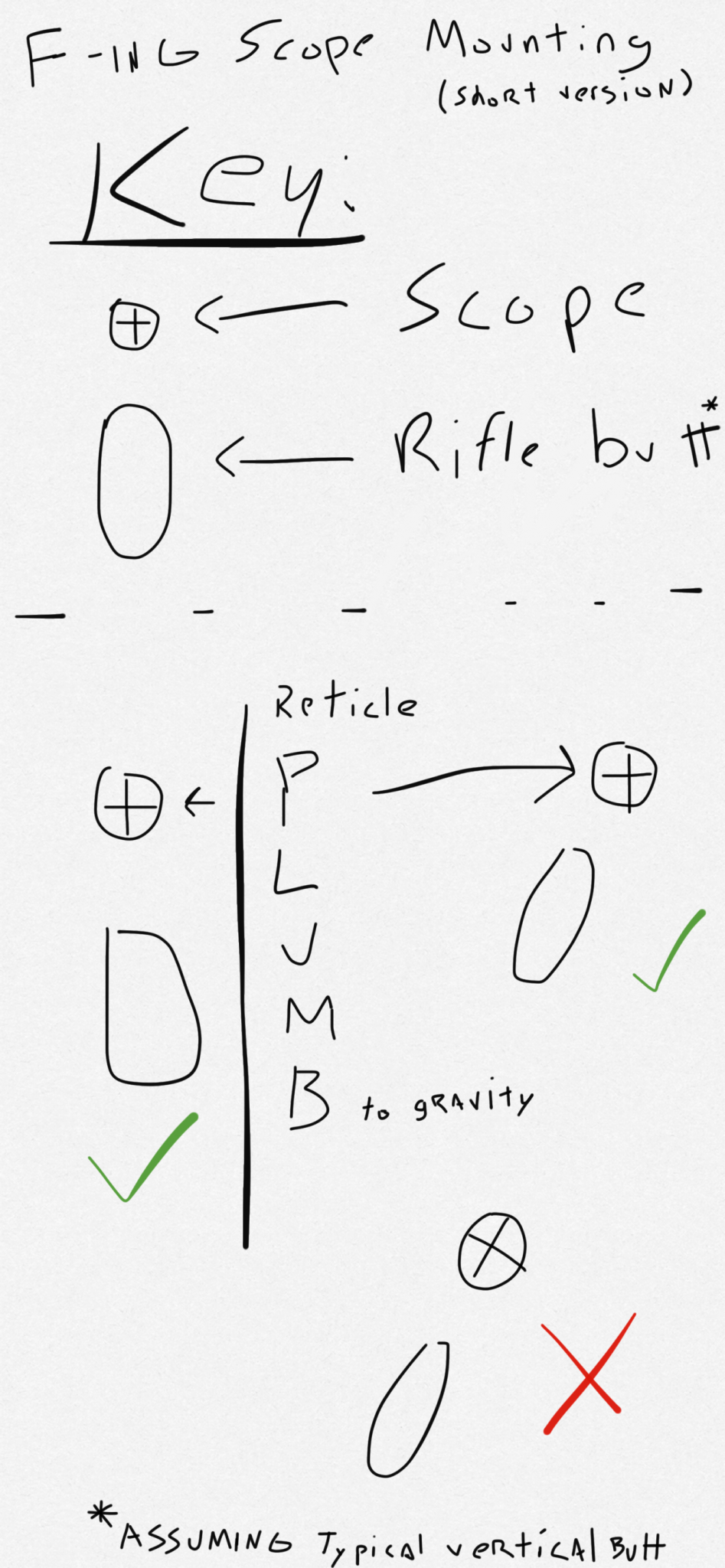

^Long version in post
Short version below
You could buy a Badger Dead Level or make one.
I believe Frank uses a custom heavy one for his clinics to level reticles for those who do not know if they want a cant built into their setup (what @Glassaholic mentions).
