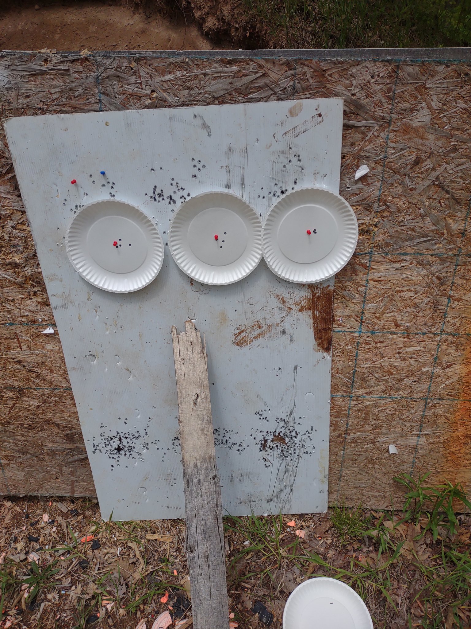

Well keep trying. Me same powder same bullet at 100 yd .the only thing different was the neck trenchion
