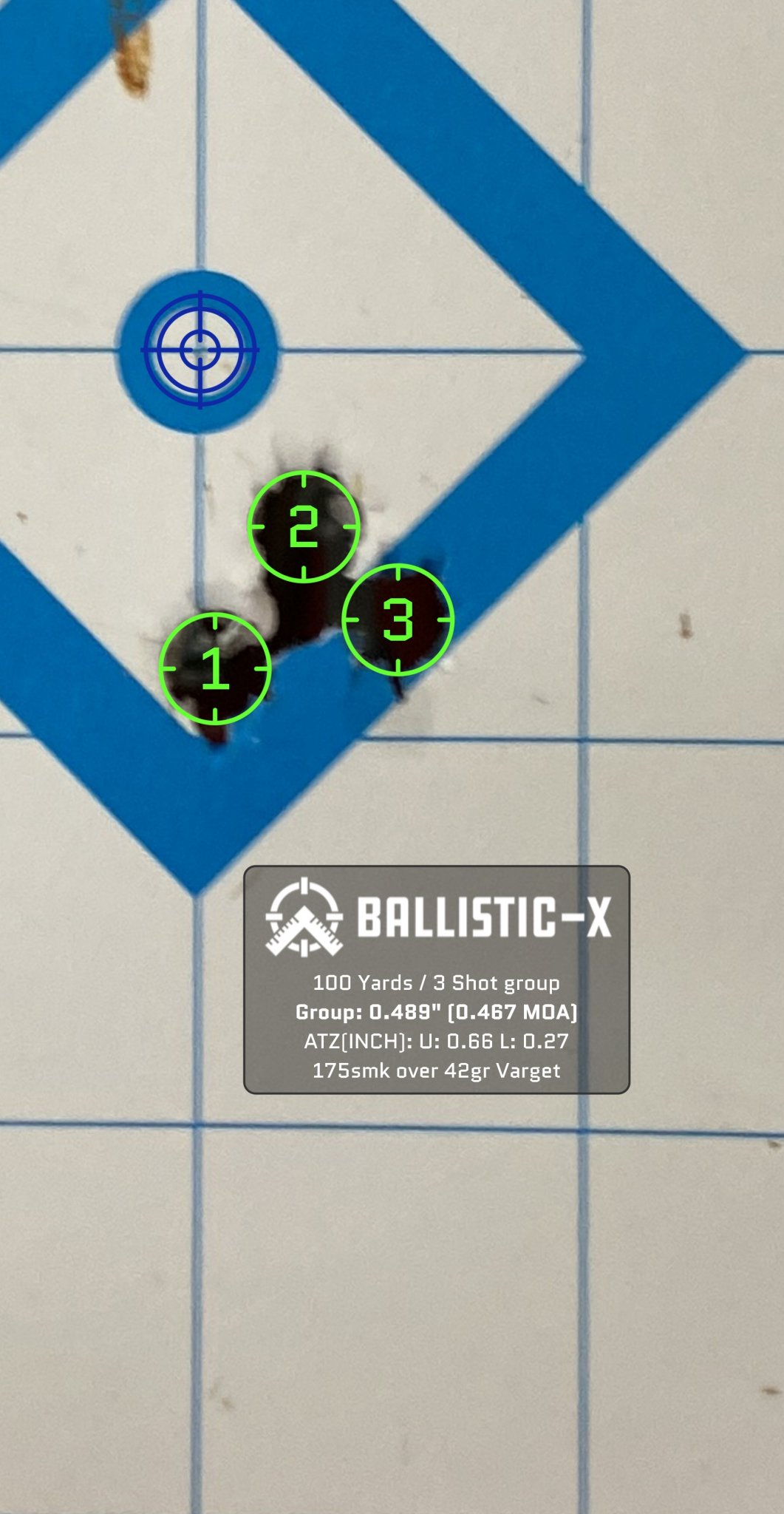

Interesting result today.
After heavy cleaning, sent 10 rounds of FGMM down the tube. Saw an average MV of 2528.25fps with those ten shots. Considered the barrel ready at this point.
Started ladder test with three shot groups starting at 42gr of Varget. 42.0 and 42.3 went well with roughly half inch groups. Only got to 42.6gr of Varget before bolt lift got heavy and ejector was swiping the case heads. At 42.6gr was seeing avg of exactly 2500fps with an SD of 7.2. There was also what looked like some unburnt powder in my can when I took it off and put it on another rig for cycling testing.
Thinking now I will work in .2gr increments down from 42.5gr charge weight and see what we find in a few weeks. 5 shot groups this time too.
Going to have to seat a touch deeper. Had to hand feed some of the cartridges. Should have checked this before I left the house. You live and you learn.
Looking like we will end up in the higher 24XX fps zone using Varget as a propellant. Not ideal. But it’s a result. Am I losing MV by seating at mag length instead of 2.800?
I’m interested in what the FGMM recipe is that achieves 2525ish fps from my 18” canned barrel.
I guess higher end brass would help get some more velocity and get to that “43.5” node that everyone talks about.
The ideal outcome hasn’t been reached. But I’m just getting started and stoked to have some results.
I would try A2520. You will get better speed and good accuracy and it's available.

Varget is an excellent powder for the 308 shooing 168 and 175g projectiles.
My 308 will not get to 43.5 of Varget with a 178. 42.4 is about it. ITs 2620 from a 23" barrel. I can get over 2730 with RL15.
Perfection! Lol.
Nah I was just hoping for some higher velocity numbers before I reached pressure signs. No love lost though. Enjoying the journey. Was super happy with the single digit SD numbers.
Don’t chase velocity, its a common mistake reloaders make, often at the expense of absorbing unnecessary risk…look at the target, that’s really all that counts (seems like 42g may be a sweet spot for your rifle).
