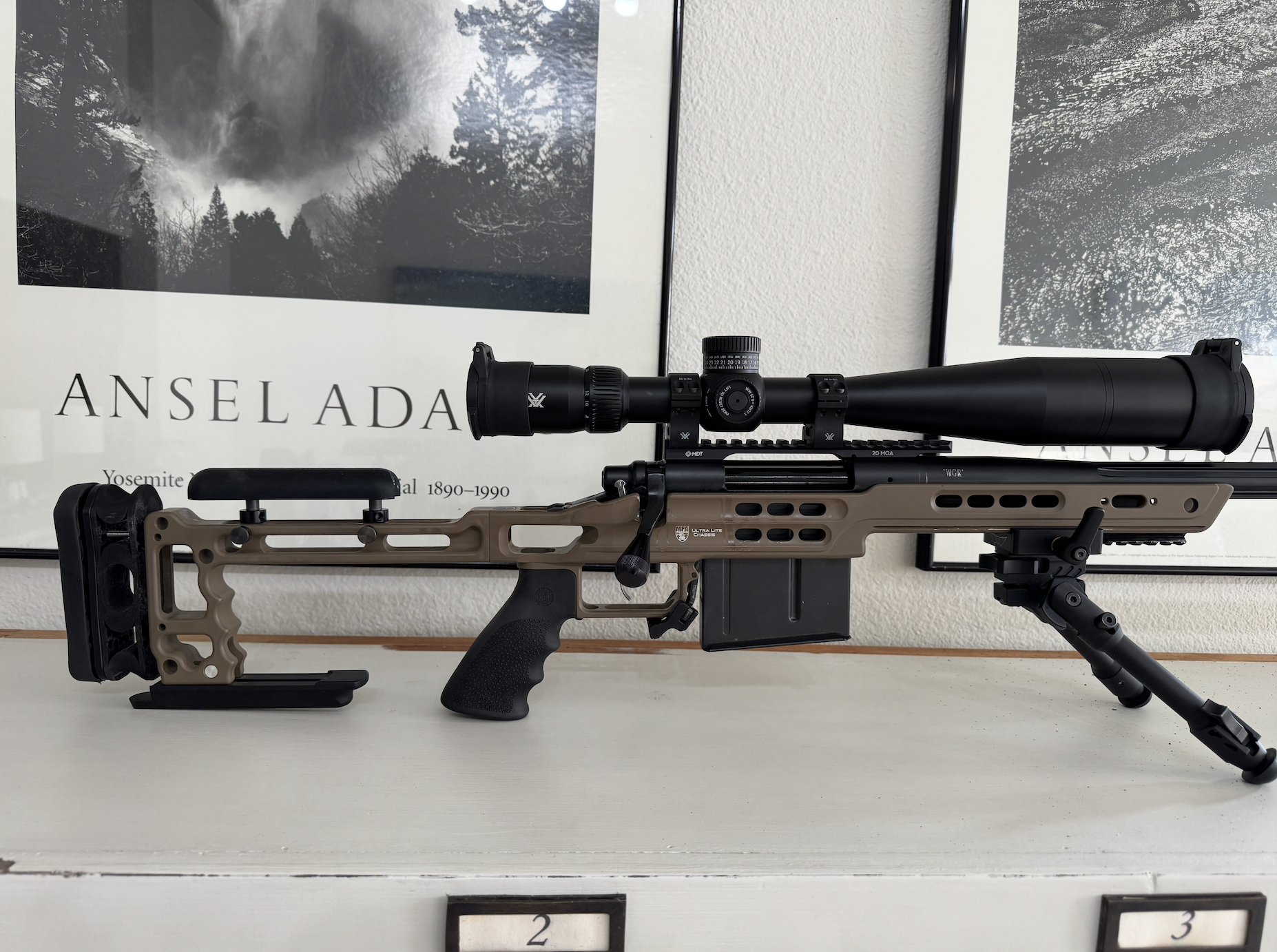

I was given a Remington 700 Long action American Wilderness Rifle chambered in 300WM. It was Free but is now my most expensive rifle and I am considering replacing the last remaining piece of what this gun was which is the action if I include the Zeiss LRP S3 I purchased for it.
I am extremely pleased with the way the gun shoots at it will shoot 0.20 or better over bullet diameter when I am able to do my part. I have shot it out to a mile so far but plan to go further. (I can't even do a transonic Kestrel truing at 1 mile) I have it in a MPA Ultralight Chassis and it has a Bartlein 1:8 twist Heavy Palma barrel finished at 26" + a Little BsTrD break. It is chambered in 7mmX300 Win Mag Wildcat that has an Improved 37 Degree shoulder. (Absolutely love this round). I had been dreaming of a heavy 7 build for a while and I figured once I had the free Rem 700 Long Action Magnum bolt face then the timing could not be better. I shoot 7mm 195 Gr Berger EOL Elite Hunters at 2,945FPS only 70.8 Grains even with no pressure signs 1.2 Grains heavier charge at 72 Grains of Vihtavouri N565. (Still planning to try the N585 even though I am extremely pleased with this load.)
Anyways- The gun shoots great- but it handles incredibly poorly in comparison. The action has been blueprinted and trued. However the bolt lift is abysmal (especially for that last 10 or so degrees before the inevitable click of this action. On the ladder test whether I am a down to 70.2 grain or up to 72.0 Grains there is no real difference in the bolt throw. I would not be able to stay on target and cycle the spent round with 1 hand. I have considered having the bolt timed and maybe a new firing pin kit- But I think in the end I have gone so far with this build that a custom 700 clone action would be the best next step. If someone thinks otherwise please do not hesitate to speak up.
I have ordered 2 more barrels from Bartlein and am strongly considering swathing actions. These will both be chambered in the same 7mmX300WM W/ 37* improved shoulder. I am still going with Bartlein but stepping down from a the Heavy Palma Countour to the Remington Varmint to shave a few ounces. The barrel I have on this rifle right now has around 700 rounds down the tube. No issues with groups opening up yet- But I want to be ready and not cause a delay when it does come time to retire this barrel and it just made since to me to do 2 at the same time.
I am looking for any and all feedback on how to pick the best Rem 700 LA clone/footprint/fit action for me.

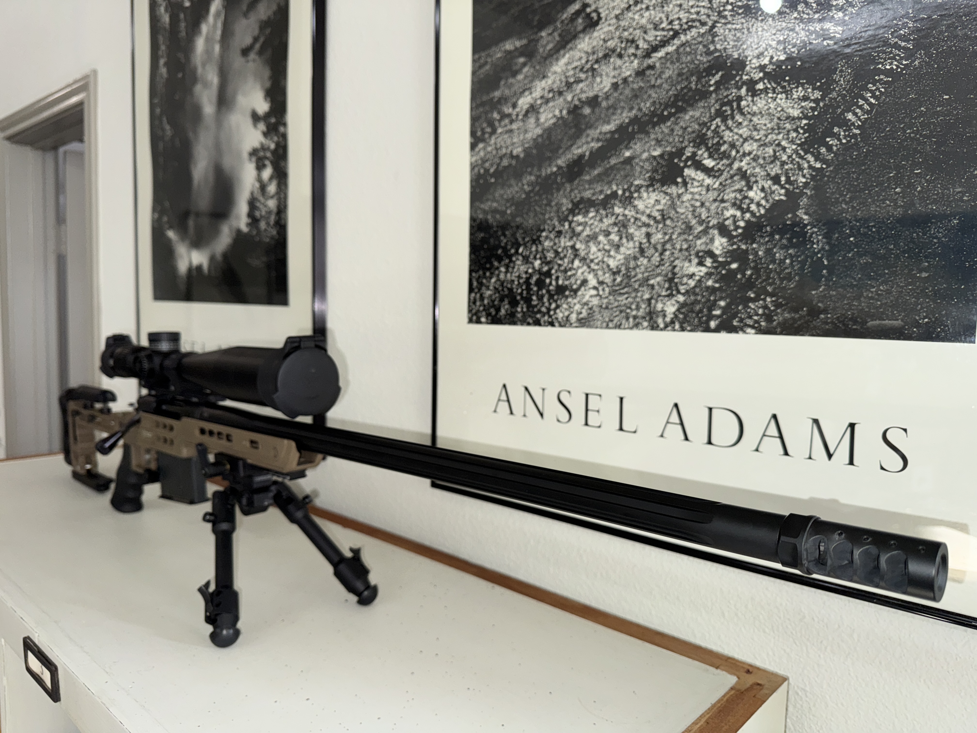

Here are a few pics of the rifle as it is now since you were nice enough to read so much about it.
