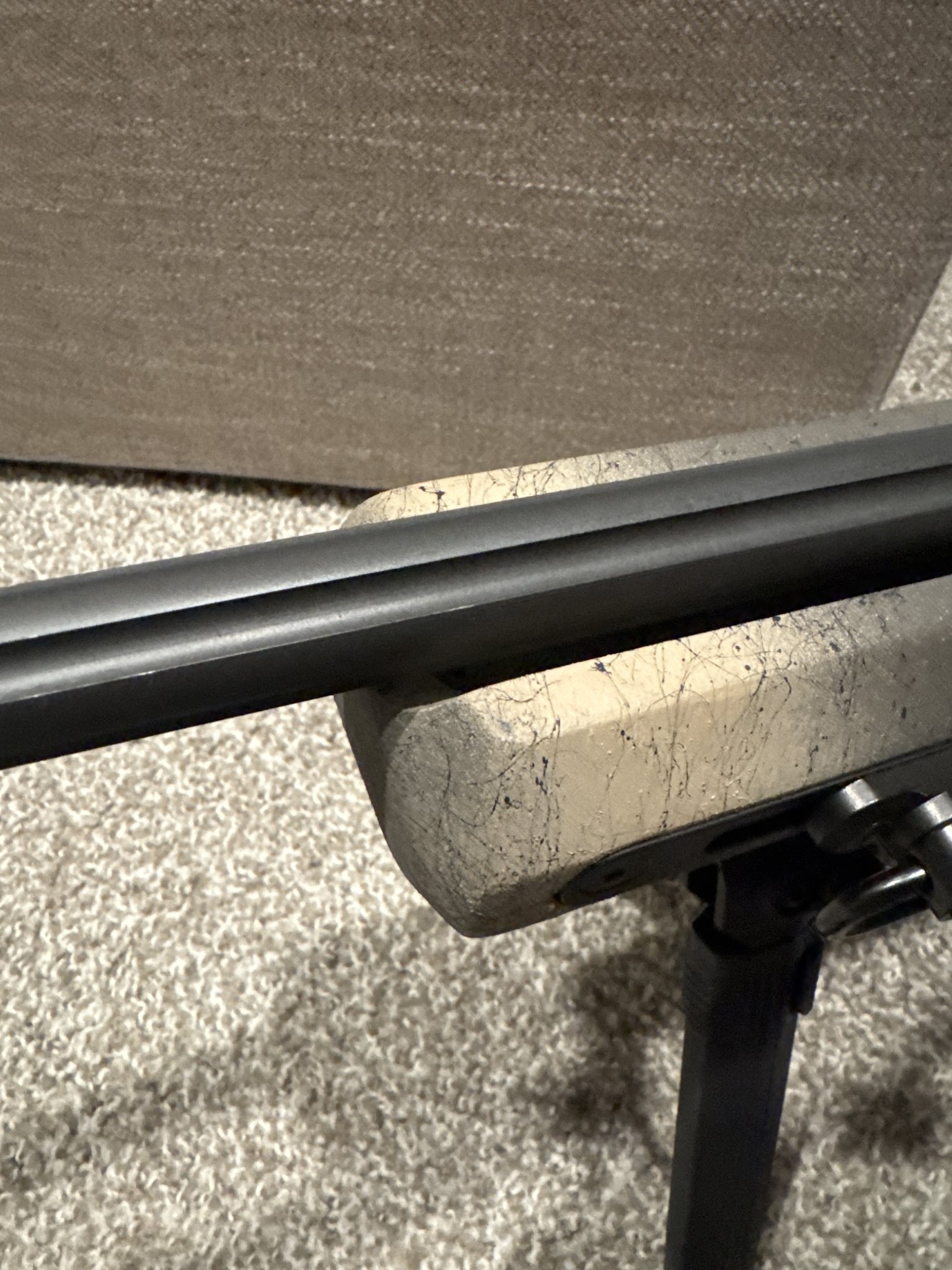

Help needed with new stock
Jaimeb832
Sep 27, 2024
15
1
Arizona
New to this, I have this bergara rifle that I bought a new ridgeback stock for and since I changed it . My grouping has gone to shit and some of my bolts are coming loose. Is the gap between the barrel and stock too much that the vibration is causing this ?
Are you using a torque wrench to set action screws and ring bolts? If not, you absolutely should be.
And personally...and many will have different recommendations of tools that they favor....I like this kit with individual torque limiters and carry a set in my range bag at all times. And I have added a bit to it...low torque limiter (6 in/lbs) for scope turret screws. 2.5mm hex head for same, and their extension to let me get into hard to reach places has been helpful.
Cheap? No. Worth it, hell yeah.
