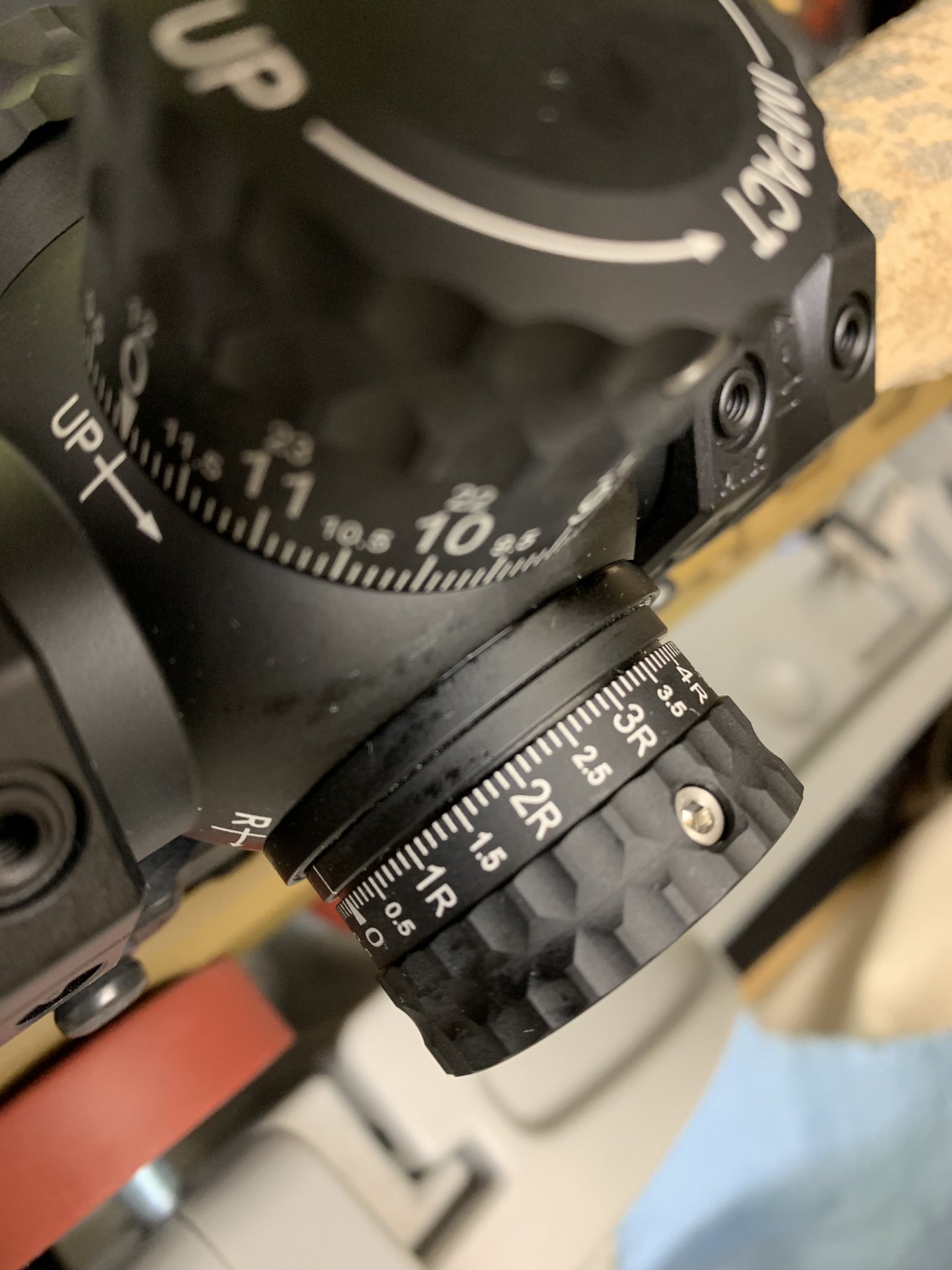

I was just tring it on to see which option do I prefer.
Decided to go with capped windage option and then I can never get the darn ring off :p
Tried some lube etc still no go.

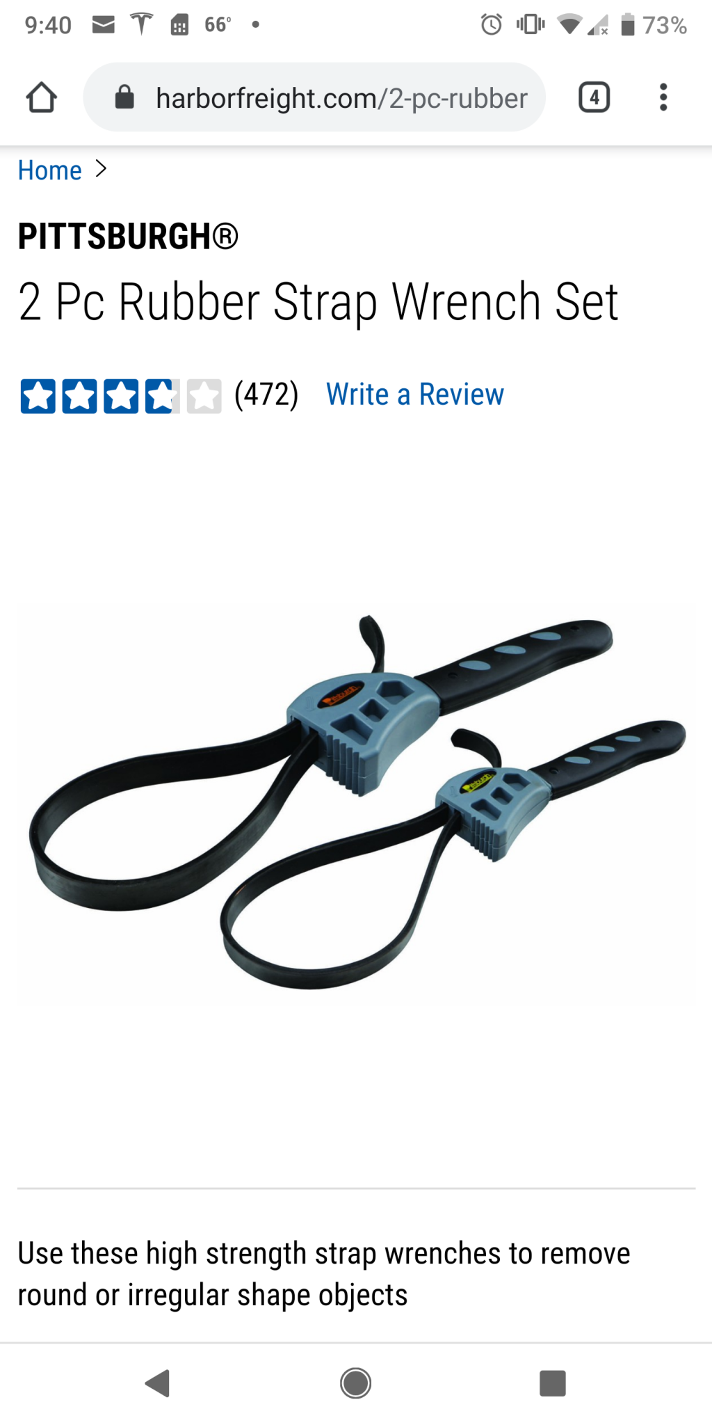

Any suggestions to take it off without scratching the scope? I am thinking of picking up rubber strap wrench from Harbor Freight. Will that work?

There was a thread like this not too long ago. (It might have been on the LRH forum). Anyway, I think the guy ended up using a rubber band around the ring and LITE grip on the ring to get it off. Sounded like just gripping the ring hard with your fingers causes the ring to bind and not turn. You might have to clean the lube off so the rubber will stick to the ring.

Thanks, I will try this method before buying more tools.
Seems I am not the only one fall into this. Wish Nightcore had some better design with this. May be a bit bigger ring with grip.
SWFA has the same thread cover on their 1-6HD scope. They were smart enough to notch the ring to where you could use a small non marring punch or wrap the flathead of a screwdriver and tap it off.
In the end I used the method @ShtrRdy mentioned in his reply. Used a wide rubber band around the ring and took it out.
