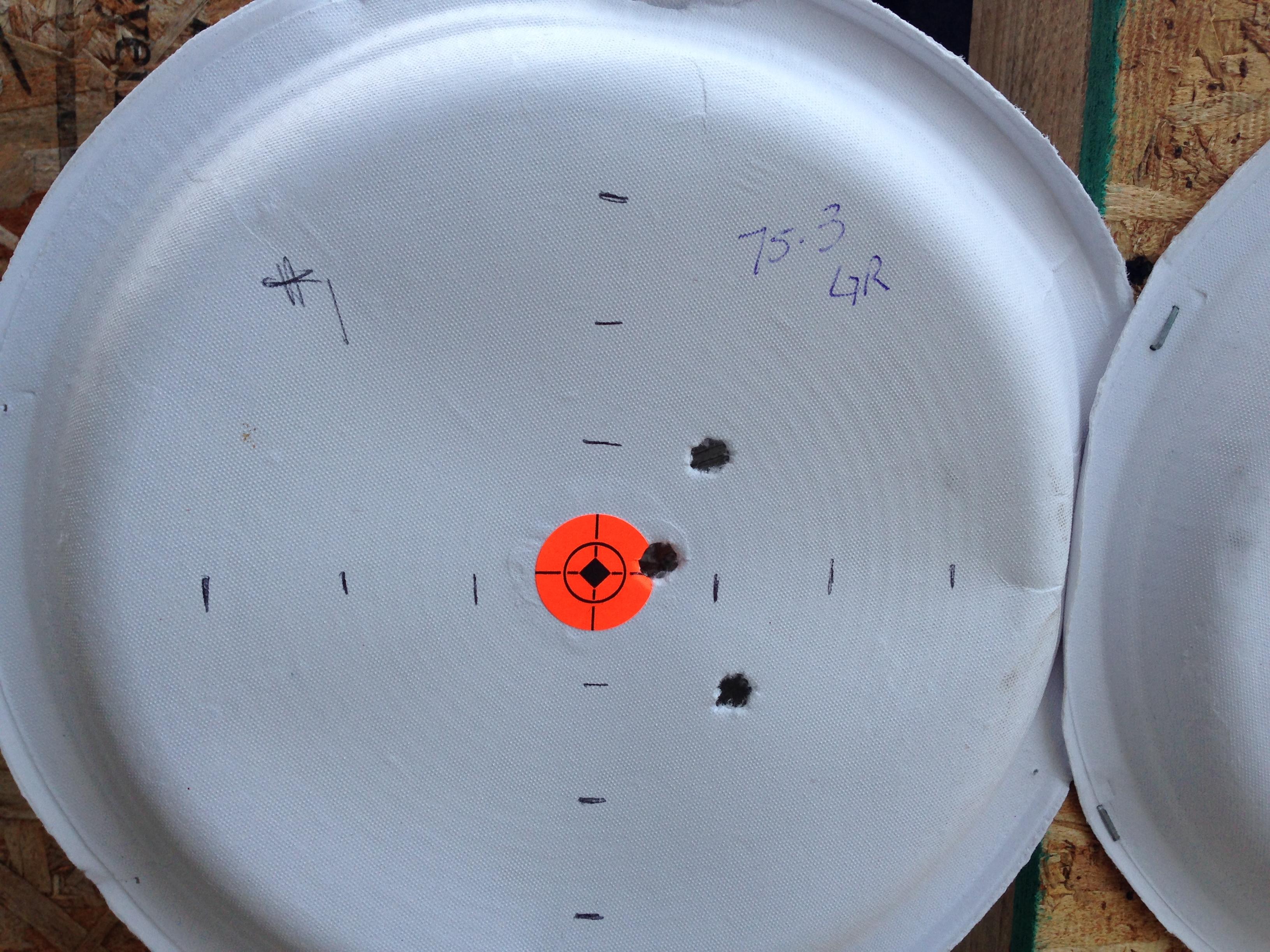

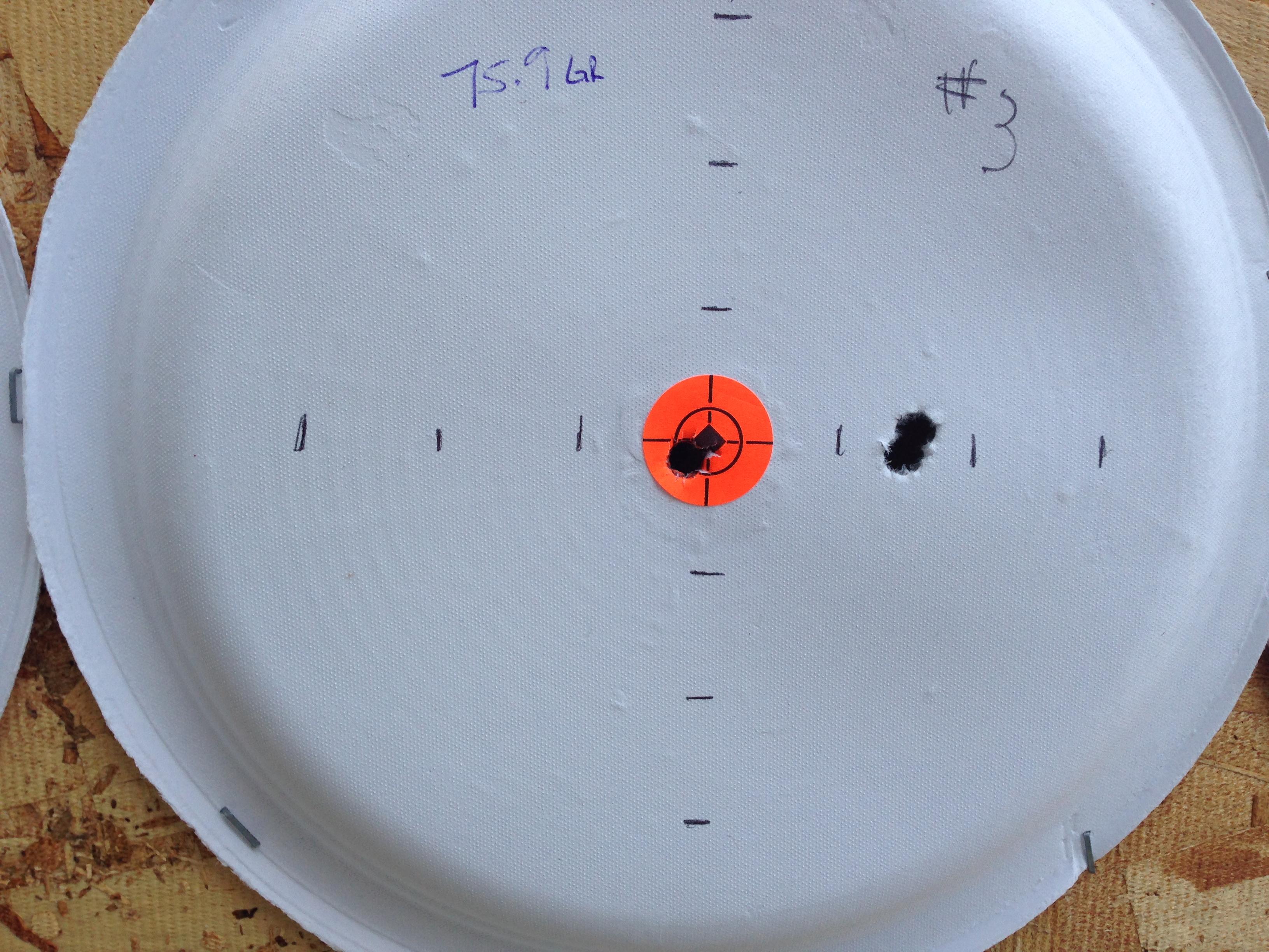

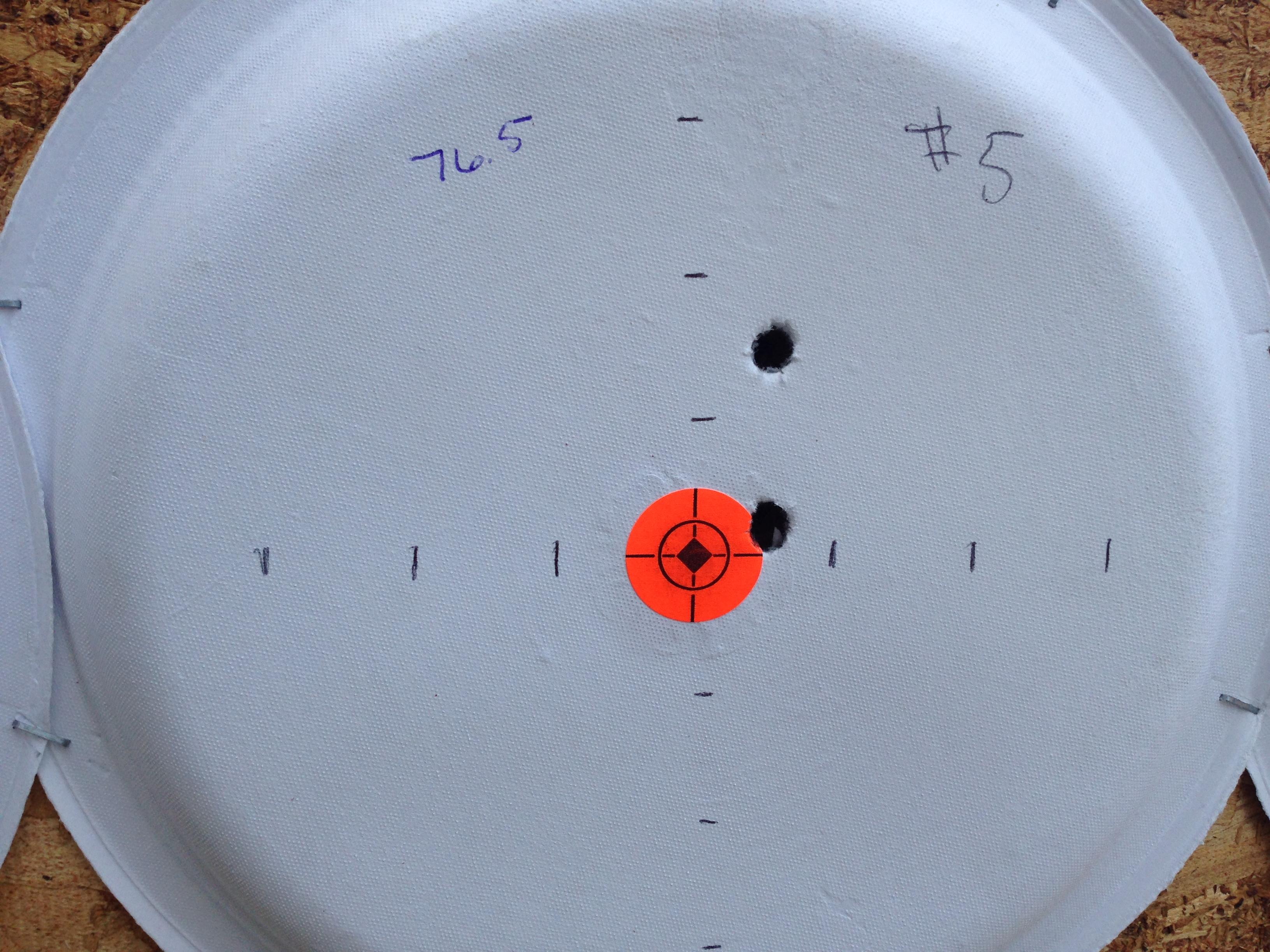

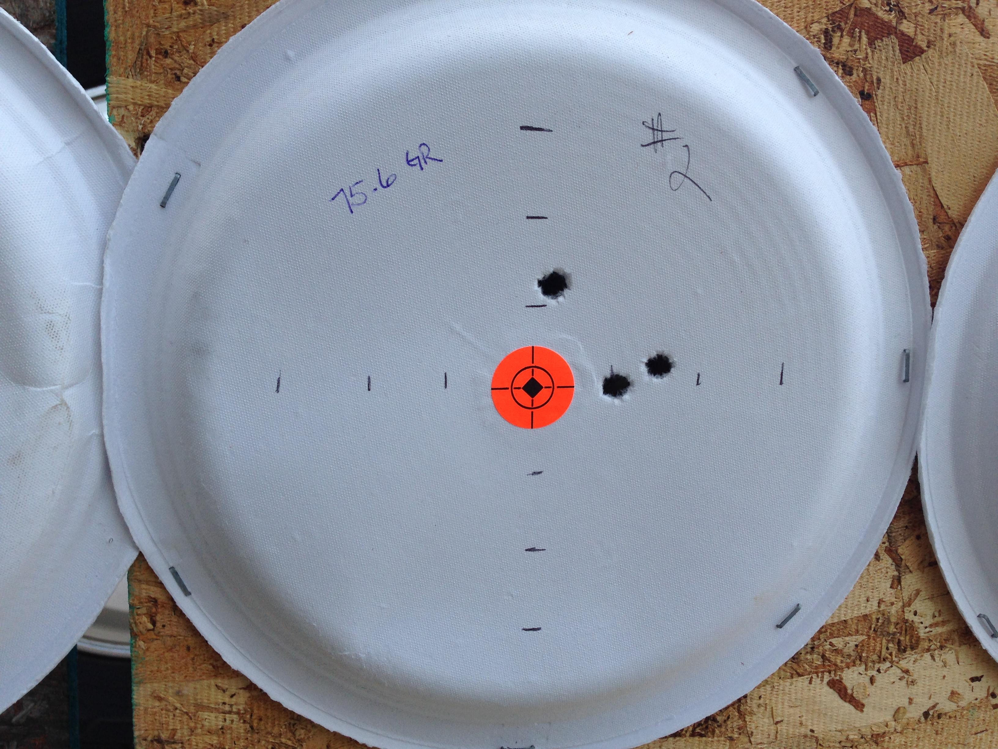

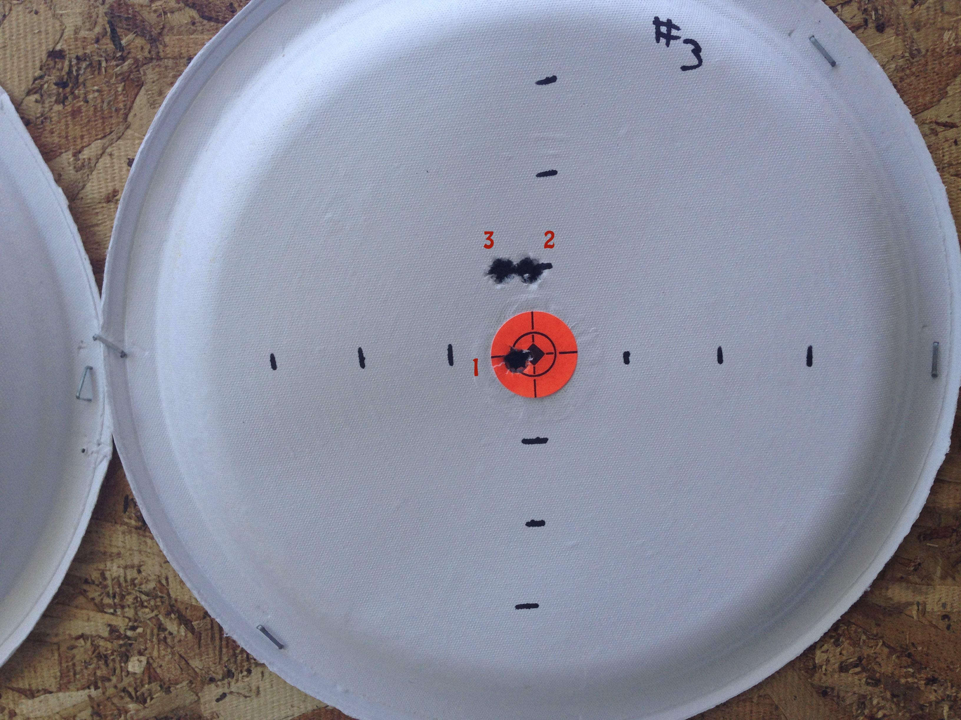

Hello all. First post, looong time lurker… I love this site, found tons of good info. I’ve been shooting/loading for at least 30yrs (yes, started young with my dad) Former SWAT LEO with lots of time behind 223/308 precison rifles.. I think I have a fairly decent trigger finger.. (although my eyes are starting to suck!!) I’ve recently loaded some really good 223 ammo (mostly 53gr vmax for varmints) that shoots ½ to ¾ MOA outta 2 rifles. However, most of my loading over the years has been for handgun/target loads. This is my first jump into “big” reloading for precision. My goal is find some good loads for 1000yd shooting, mostly just for fun… Maybe some big game later (not 1000yd)
I need some help with this ocw. I’m a bit perplexed with my results here. I’ll throw all the data out here and you guys please tell me what I’m missing..
R700P 26”bbl w/brake and Jewel Trigger
300WM
208 AMAX
H1000
Win Brass
Fed 215M
RCBS FL Dies
COAL 3.615 (2.885 Ogive, .030 jump)
I used Hornady OAL gauge for this number….
Brass is once fired in this rifle, sorted by length and weight as close as possible. Primer pockets and flash holes cleaned/uniformed and case mouth de-burred. Sized to .002 bump.
AMAX bullets sorted by weight and bearing surface length. Used only 208.0gr and +/- .002 length for this test.
Powder charge: Guessing where to start?!?!? Using info from the Berger manual, Hodgdon’s site and this site I decided to start at 75.0 with a theoretical max of 77.1 based on .3 increments. Hodgdon says 78.0 max, but reading threads on this site I noticed some guys talking about pressure signs by 77gr and I’m not a hero!!
Loaded 3 at 75.0gr for sighters… then 3 rounds of each
75.3 target #1
75.6 target #2
75.9 target #3
76.2 target #4
76.5 Target #5
76.8
77.1

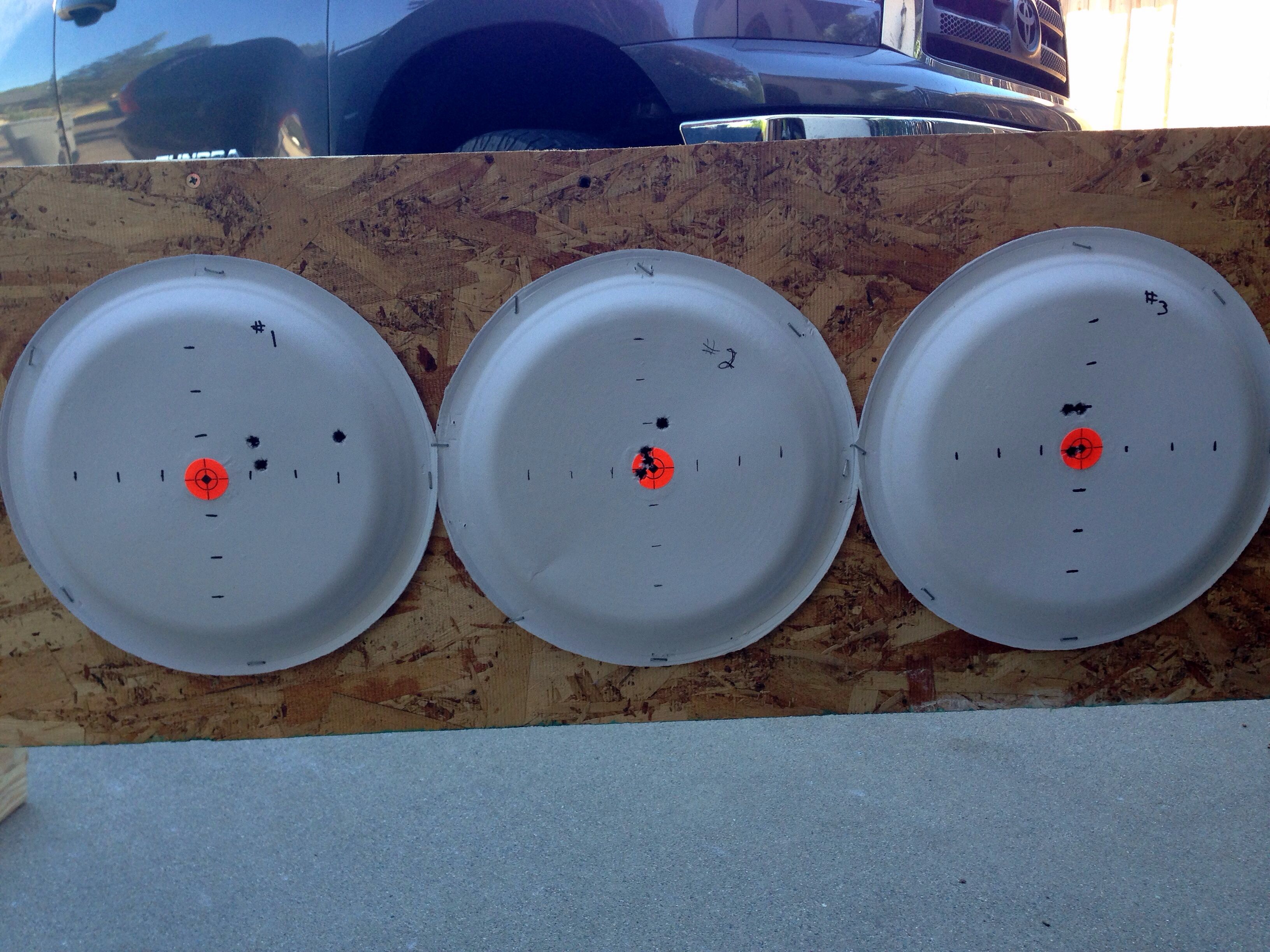

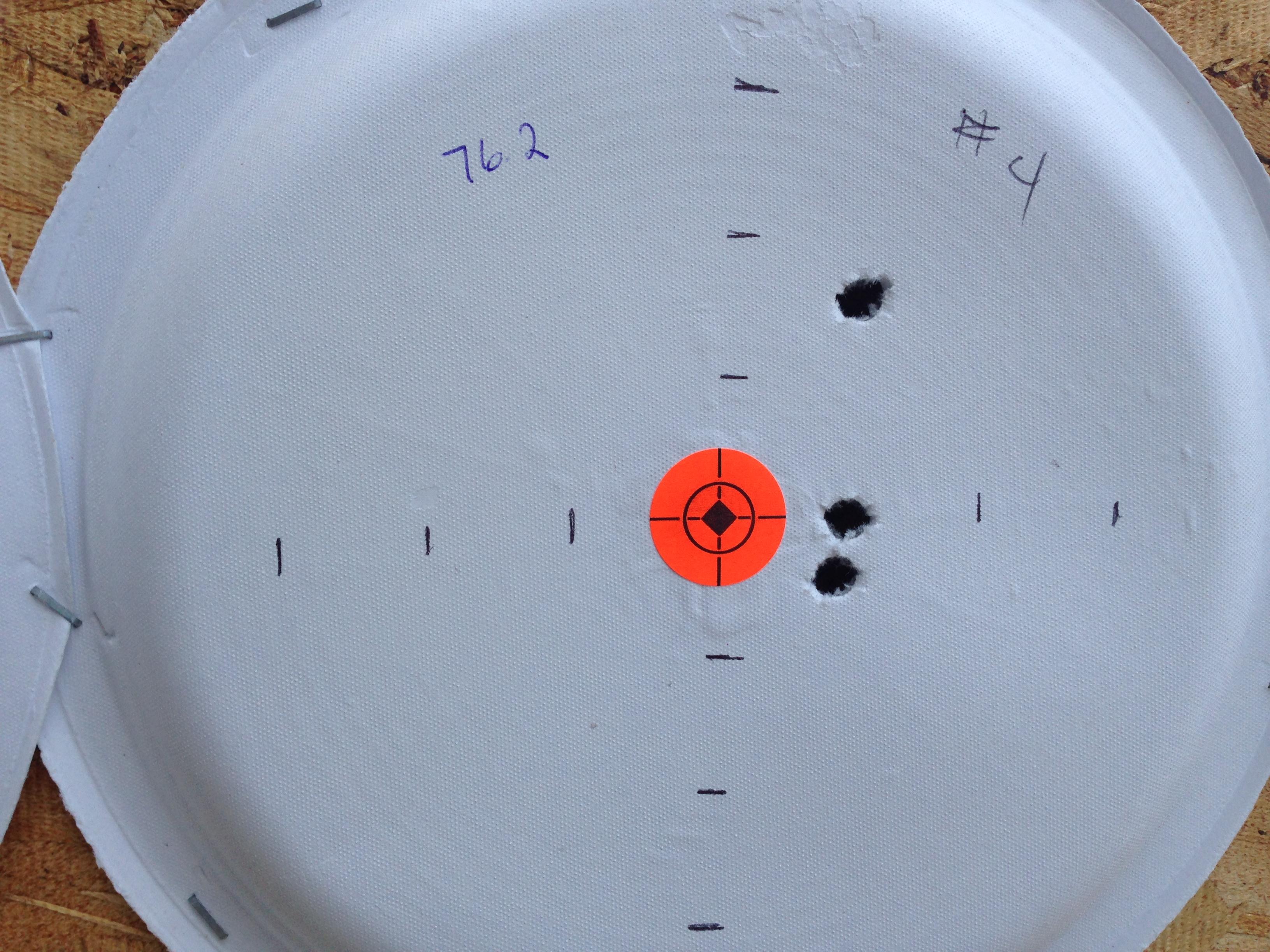

In the pictures hopefully you can see the target # and charge written in the corners. Target #5 is all 3 rounds. Round 1 and 3 are in damn near the same hole. I had to look at the back of the wood to see it.
76.5gr started showing slightly flat primers. I only fired one round of 76.8gr, REAL flat primer and showing the half moon ring on the head so I didn’t continue with those or higher. I didn’t use a chronograph today, just looking for my accuracy node first. I probably forgot to include something here… so I may or may not know the answer if asked. One thing I realized AFTER I had these rounds loaded… Neck tension. Something I’m not sure I understand how to control. I checked my loaded cases vs empty already sized cases and found this: Neck OD, Sized cases=.325avg. Loaded rounds .334avg. .009” ?? Seems like a lot to me? Thoughts?? ANY help is greatly appreciated.
Thank you, Tim

you may want to try a spread with adjusting only jump. I found better groups at .020. I used to get odd groups like yours till I played with jump. I use all the same components as you but 74gr yields 2900fps.
Hard to tell, but it looks like 75.3grs is your scatter node. So per the rules of Dan Newberry, you should find a node 1.5% higher (76.4grs) in your charge. Looks like your getting the dreaded 2 and 1 deal. Could be seating depth?? You could pick 76.2 grs and try a seating depth test using .003" to .005" increments. Find the best, and revisit the ocw test working from 75.8 to 76.8. or so. Use a chorny to record ES/SD.
were your groups shot off a bench or prone or rest? don't want to sound like a dick but if ur not running the proper fundamentals of marksmanship and 300 winmag WILL EXPLOIT any angles u give it and cause shot to shot variation. that can be very frustrating when trying to develop a load. I am using basically all the same components as u are in my win mag only even more simplified powder grads (.5) and found a one hole shooting load WITHOUT playing with seating depth or neck tension... Cronod the load yesterday with the V3 magneto speed with ES of 11fps and SD of 4fps this was with new brass and very minimal prep (mouth expansion and chamfer)
care to post your load info?
Valid question. I shot these prone, sand bag front, my bean bag rear. I shoot this way 95% of the time. I have a good table, but I was trained mostly prone, prefer it. This rifle will shoot .4-.5 moa with with Hornady TAP 178 AMAX (only decent factory ammo I could find available so far) I know what you mean about the 300. I shot 23rds one day before I put the brake on it. Holy %$#… the bruises were impressive. Also, I have my jewel trigger set at 10oz (for load testing only) I've tried to minimize as many variables as possible. Pretty confident with these groups being more load than shooter.

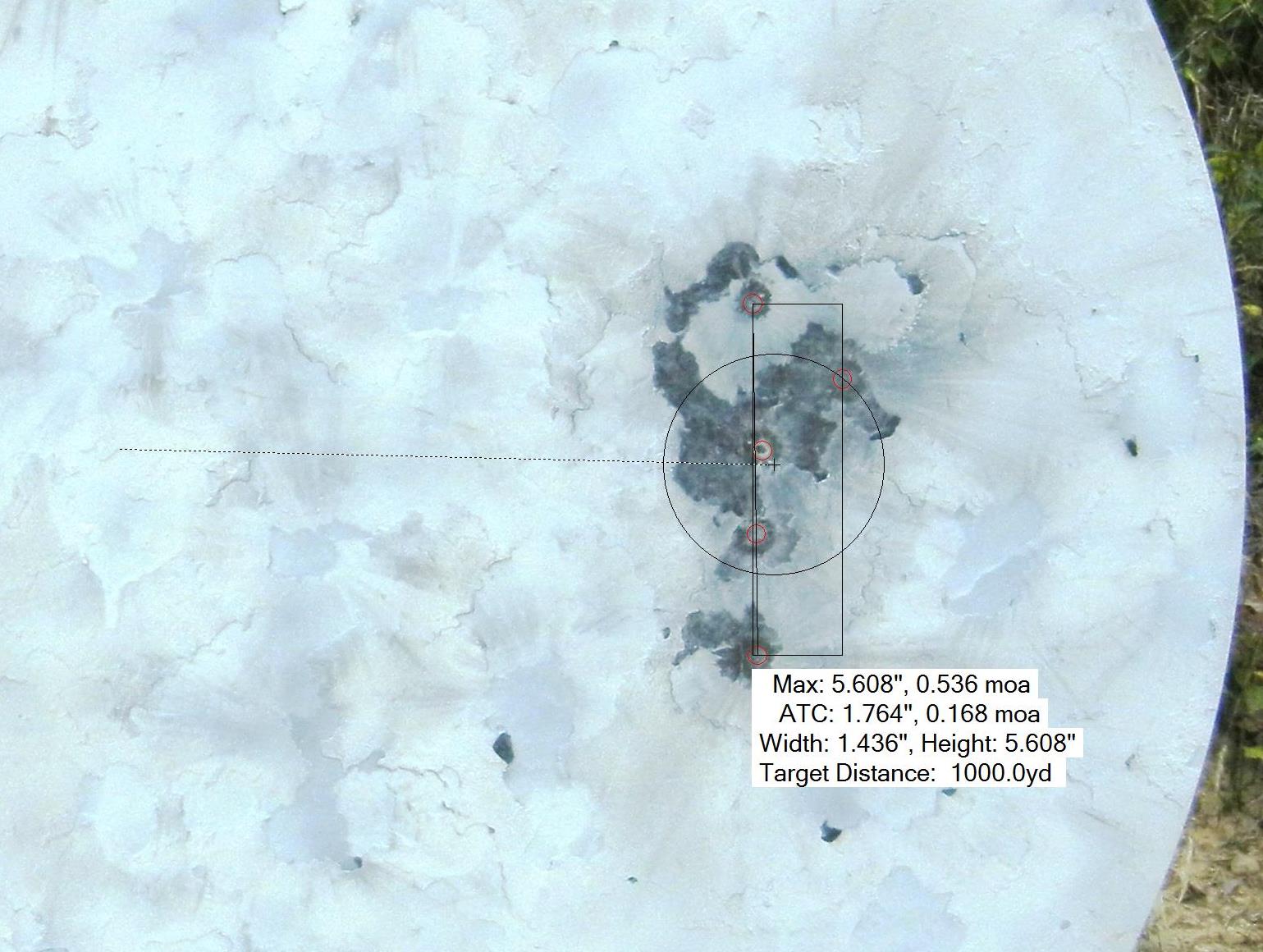

Winchester military brass. Clean primer pocket. Debur flash hole. Size with Redding die, .332 neck, about 0.001-2 gap from shoulder to chamber. Trim to 2.612. All of these cases weighed between 240.0 and 240.9 gr. Sierra 240 HPBT Match, seated 0.018 off the lands. IMR 7828, 67.7 gr - thrown on a RCBS chargemaster. FED 215M. MV ~ 2675. Scope setting 28 MOA up, 1 MOA right. No conditions - 83 F light boil, shot 1 was cold bore, 3 went a little right. A little over 1,000 rounds through the barrel. The gun shoots 1 MOA if I do my part, probably better with a more-skilled shooter. It shoots 0.4 to 0.6 MOA most of the time at 100 or 200.
Note: even blind squirrels find acorns. Most of my targets at 1k don't look this good - this one is worth sharing :)
Long heavy bullets have low drag. That bullet goes subsonic just over 1,400 yards. Slower velocity means longer flight times so I have to read the wind well or get lucky and have zero conditions. I also have a box of rounds where the cases weigh 234.0 to 234.9. Those are loaded with 68.0 grains of IMR 7828. This Win milsup is the best brass I have ever shot and I also shoot Winchester, Lapua, and RWS.

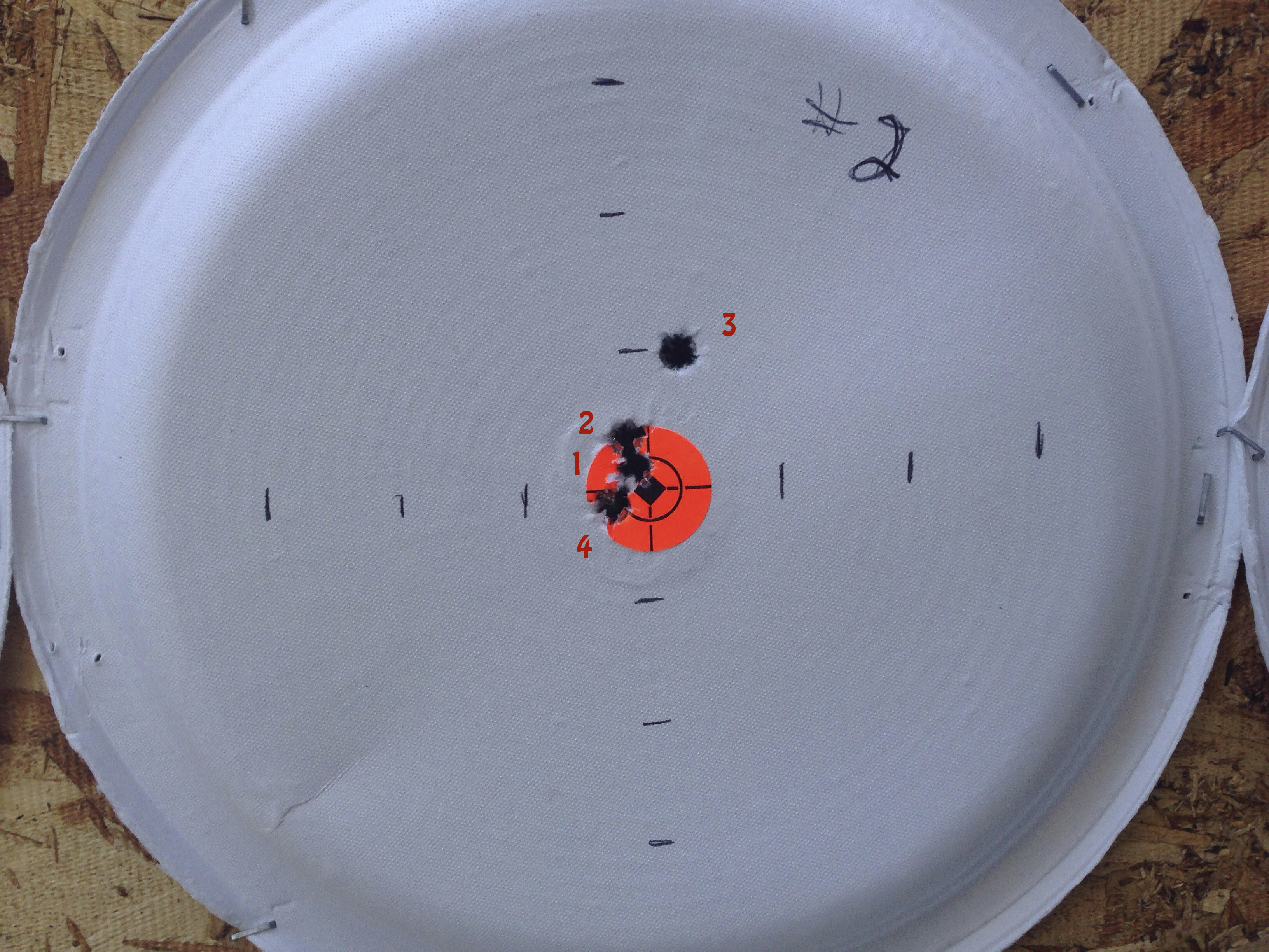

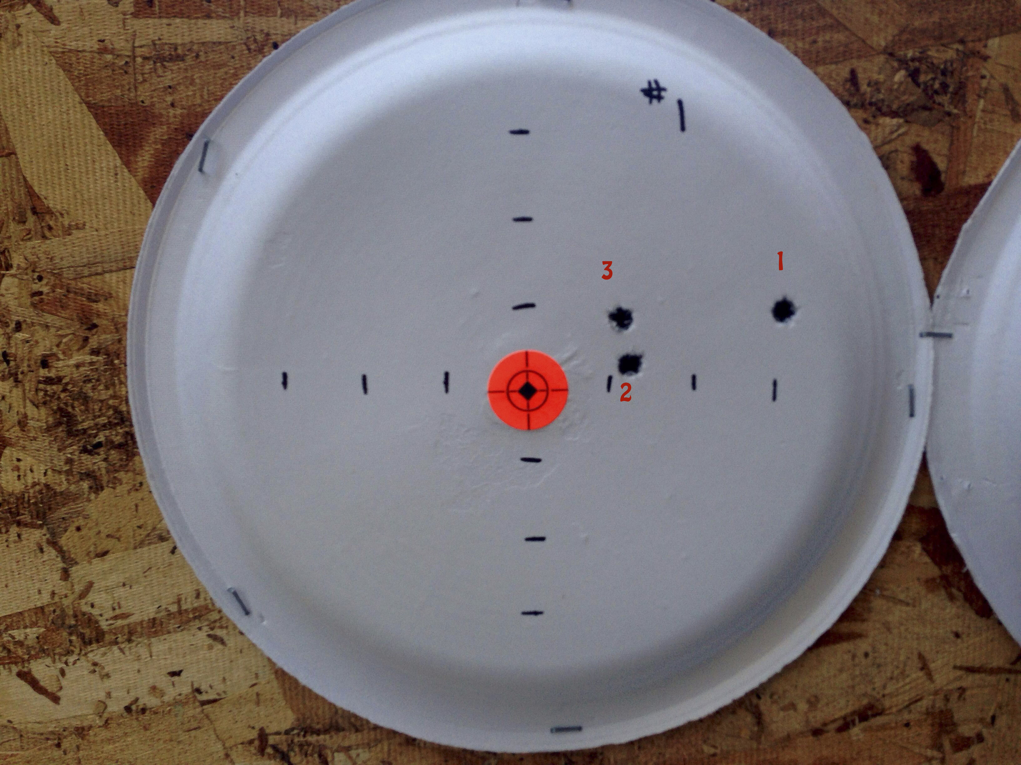

Ok guys…. here we go again. First off, UPS didn't bring me my Redding S die on time, so I pushed forth anyway. All the previous factors from the original post apply (components/bullet/brass prep) I loaded 4rds @ 76.0gr H1000 with a .020 jump and 4 rds at .015 jump. I ran out of once fired Win brass so I grabbed the next thing I had handy, Federal once fired (I know…) to load a few sighters. I loaded the sighters at 76gr and .015. Out to the range this morning at 0530, good conditions, 74deg, 2-3mph wind from directly behind me. 100yds, chrono set up @15' from muzzle, heres what I got. I numbered the shots on the pictures to help.
Group #1: Sighters, shot these together.
#1 2882fps
#2 2895
#3 2848
I made a 2 MOA adjustment left… Groups 2 and 3 I shot round robin. I didn't shoot the 4th round on target #3, figured it was a waste of time due to the velocity spreads i was seeing.
Group #2 .020 jump
#1 2914fps
#2 2907
#3 2895
#4 2912
Interesting group. Shot #3, less velocity, higher poi?? #1, #2, #4 would have been a good group with good ES.. Confused.
Group #3 .015 jump
#1 2875fps
#2 2863
#3 2943
Blah…… 80fps spread??
It appears this rifle/amax combo likes closer to .020.. I know the Redding die will be here today and Im still thinking neck tension may be suspect here. What thinkith ye wise men???
Thank you.
Edited: One thing I forgot to mention about the neck tension, I noticed while loading this batch that I could FEEL the difference in pressing some of the bullets in the seating phase… Clue?? LOL Then I thought at the range this morning… Gee, what a dumbass… I should've marked them!!!!!

So it looks like .020" might be a good spot to start with. Who knows what caused the higher shot in target 2, neck tension, runout, could be shifting in or out of a node, etc. So what brass do you plan to test with next? New, once , or 2x fired Winchester brass on next test?
Not sure.. I have 100 new Win and 50 new Rem.. And obviously the now twice fired win. This is the first time I've really dealt with the brass situation, as far as really trying to find extreme accuracy / consistency. What's your thought on new brass? I always heard that better results come from fire formed cases… Myth? wives tale?? LOL
What's planned for round 3?
I'm not even entirely sure yet. New brass, new die, .020 jump…. Shoot the OCW again from 75.8 to 76.4 in .2 incr.?? Im already getting 2900fps at 76.0 though. Maybe 75.6 to 76.2??
I think I'll go re-read Newberry's website on OCW tonight, kinda feels like I'm over complicating this..
re: shot 3 - in my opinion, the velocity change is not enough to account for an inch. Consider pulling that piece of brass. I don't remember if you are doing this -- make sure to debur the flash hole. Ignition issues caused by flash hole burrs might give you weirdness.

two comments:
1. If the load doesn't shoot, then don't use it. But don't get too excited about velocity changes. Which bullet was the low one? If it was number 3, the fast one, then your rifle is trying to tell you that you have to do whatever it takes to make your velocities consistent.
2. Assuming good reloading equipment and technique, neck tension variation is a message that your brass is not all the same. If your brass is not consistent, you will see velocity variations, POI changes (usually vertical), and other symptoms that you don't want.
okay, three comments ...
I would pick a load, either 2 or 3 above. Load 10 cases all the same and shoot them. I suspect that some cases will shoot into the group and some cases will throw flyers. Mark the flyers. Reload the same cases the same way and shoot them again. I suspect that the first pass flyers will also be second pass flyers. If that is true then you have an issue with your brass. And if that is true, then you cannot use that complete set of brass to identify your optimum charge weight, you need to pull the flyer cases. On the other hand, if the first pass "rounds in the group" become second pass flyers then something else is happening.
Think about it. Look at group 2. Three shots in the group and 1 an inch away. Vertically away. On your range, could wind do that? If it isn't wind then it is the primer, powder, bullet, case, or technique. You used the same primer and bullet, seated to the same depth, and the same quantity of powder. That leaves the cases and technique. Shooting your cases twice should tell you which one it is.
One more unpleasant question - does your gun have a muzzle brake? All of my 30s have brakes, for me that is the only way to get consistent technique. I shoot 240 grain bullets out of my 300 Win Mag. The gun weighs about 16 pounds. Without a brake, it beats me up too much and I get patterns, not groups.

Thank you for the comments on this. I am de-burring flash holes. The day that I shot these groups the wind was very light, doubt it was a factor. I do have a muzzle brake, it really made it easy to shoot (i tried it before the brake, ouch!!)

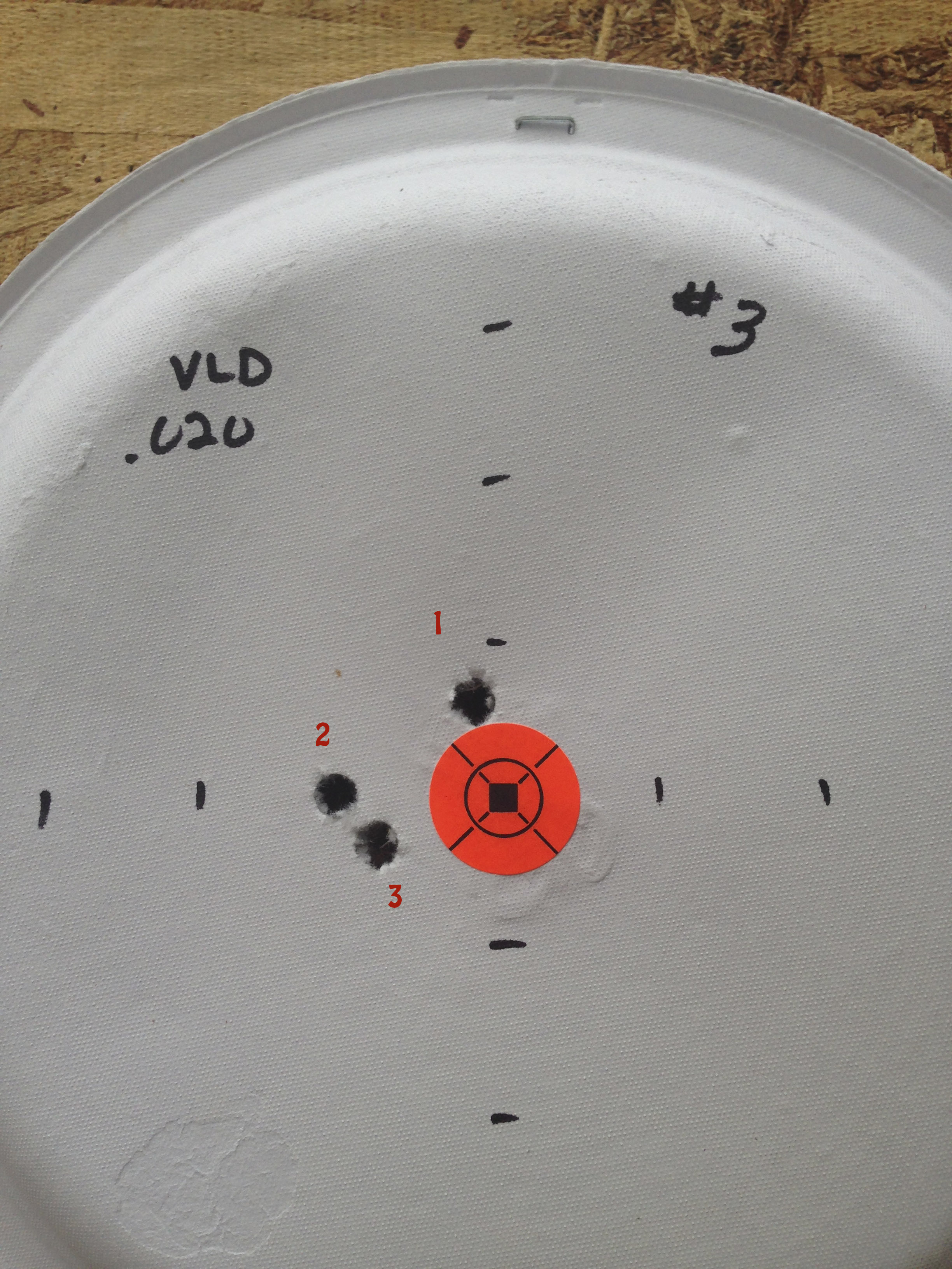

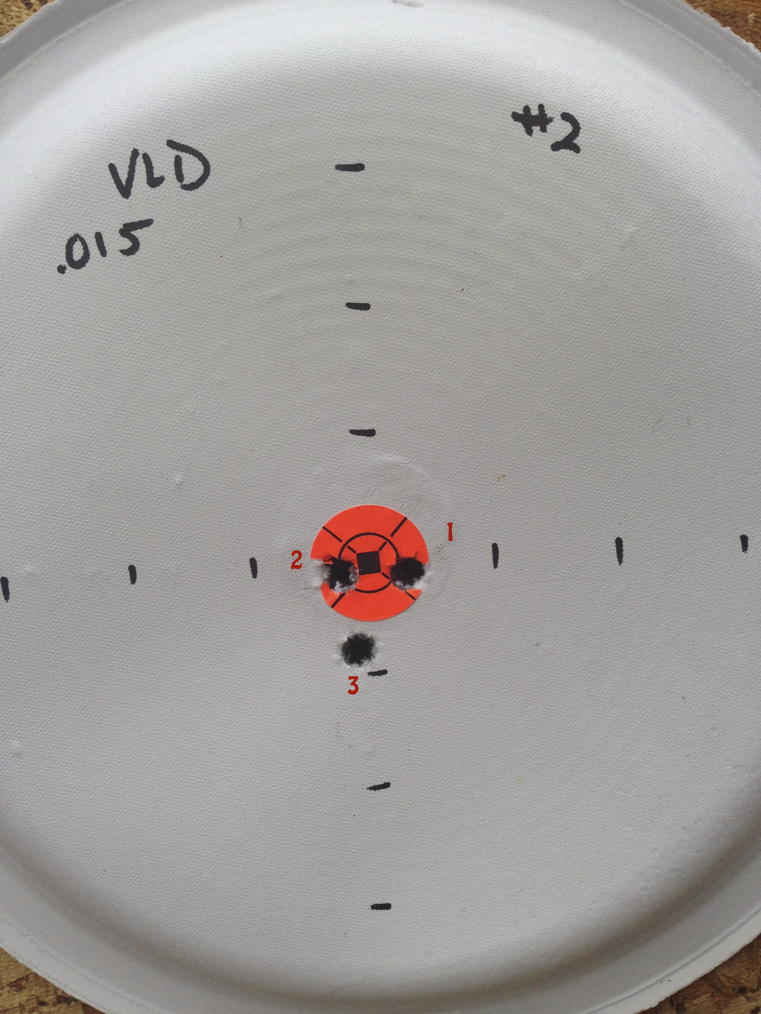

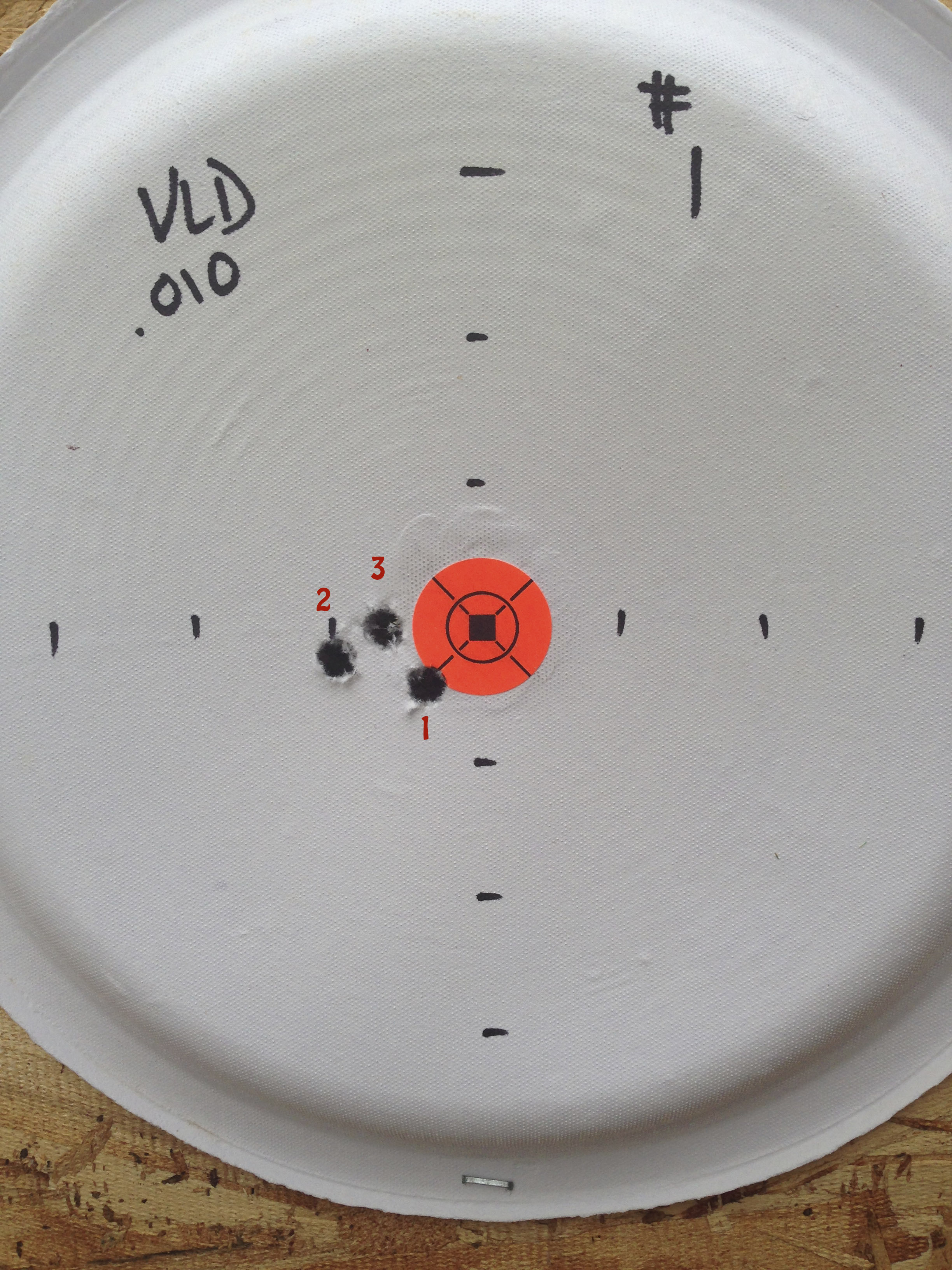

Since this the day I shot these groups, Ive been out 2 more times with the AMAX/H1000 combo, with dismal results. The only change made was to switch to new Win brass and sized with Redding S Die. Prepped the same, weighed and sorted to <2gr, primer pockets unformed, flash holes de-burred, case mouths de-burred with VLD tool. The groups look the same. Lots of the 2/1's, velocities all over the place. Just for the hell of it, I loaded 9 rds of Berger 210 VLD's at 76.0gr H1000, same brass, @.010, .015 and .020. Most encouraging groups Ive seen yet, However, my "High Tech" Chrony decided to go "TU" so I don't have any speeds yet. My next step is to play with seating depth and fine tune it. (I hope) as well as get a new Chrono.
Pix of the Berger VLD Groups
Thank you

"April 9 , 2012. .300 win mag. 700 P. 81.5 retumbo. 208 amax. Win brass. 215m. 3.600. 1/3 Moa at 104 yards. 3 shots. Cloverleaf Too hot need to drop it a few grains. "
