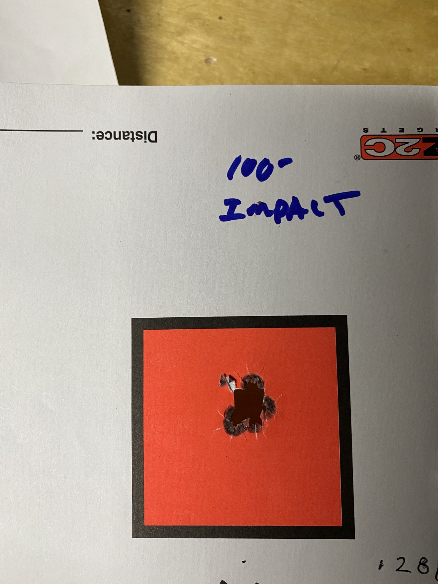

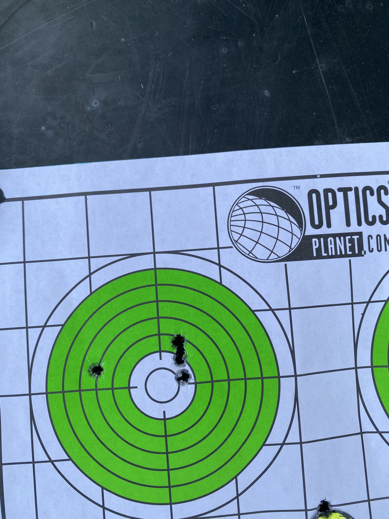

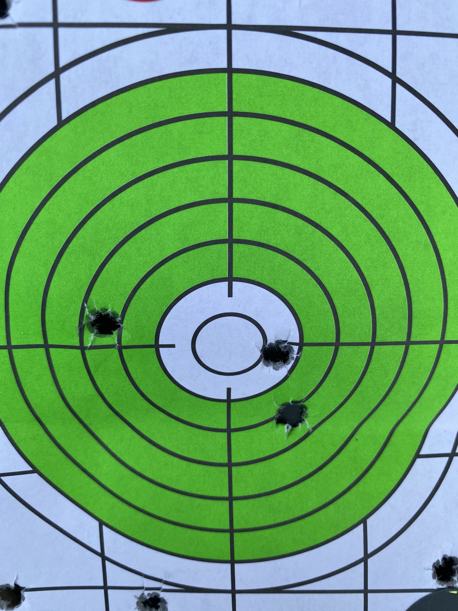

Hi guys,need some ideas on what happened to my accuracy.rifle is a 6.5 Creedmoor,impact 747 action,manners stock,bartlein barrel,gen 2 vortex optic
Had this rifle for 3 years,always shot sub .50 groups at 100 yds,has about 900 rounds through it,clean it 400,800 rds,after 800 rd cleaning it started shooting all over,it shoots a sub .50 group then a 3” group,no consistency at all,I have been using Hornady 147 eld match factory ammo after ammo testing when I first got it,I have recently tried 3 different lots and 3 other types of ammo and no difference,I have triple checked my optic,rings,base and all good,have tried a different optic,have called Manners and tried the 65/45 action screw torque as well as other torque settings from 30-65 lbs. have had 3 ither people shoot it as well,pics below show back to back 5 shot groups shot today with everything the same.As always help appreciated.

Could be the barrel is on its way out. Seems like you checked everything i would have (though im sure someone will point out something you mau have missed). 800 rounds seems too soon for a burn out but you never know. Check the crown and if possible, maybe bore scope it.
Just ordered a bore scope,I would think heavy barrel would last 1500-2k rounds?
Never used a bore scope,how do you tell barrel is shot out?
I would think so as well but you never know. Take some bore scope pics and post them here so folks can take a look.
If the crown and such is fine, and you’ve tried all the things you listed, including scope tracking or another optic…..
The only two options really left:
- try a different chassis. There is a *very* slim chance it’s moving or binding somehow
- barrel is gone. Happens sometimes. I’ve seen 6.5’s go pretty early and some last longer than normal
This is assuming the barrel is actually clean.
Another thing to check is carbon ring in front of chamber when bore scope arrives. I would find it exceedingly hard to believe that a Bartlein barrel with only 900 rounds of factory ammo through it would be anything more than well broken in. I have over 2200 (handloaded, warmer than factory) rounds on my older 6.5CM Bartlein barrel and it's still consistent in velocity and 1/2MOA groups.
I have no personal experience with BoreTech cleaning solvents. With that said, my experience with other products (Hoppes, CLP, others) is that none of them would effectively remove a minimal carbon ring even with a couple dozen passes with a wire brush - and I clean every 200 rounds or so.
Bore scope will probably reveal a lot of carbon buildup in the first 8-10" of the barrel. At 900 rounds, there will most likely be some fire cracking, which is normal.
There are many threads here about barrel cleaning. I have found that careful - CAREFUL - use of CLR (Calcium-Lime-Rust) is by far the easiest way of removing carbon (it won't touch copper). I put a cotton patch wet with the stuff on a subcaliber brush (.22 for 6.5CM), run the patch back&forth in the first 10 inches of barrel, then set the patch atop the carbon ring for 10 minutes. Then swab the bore with at least two dry patches, followed by at least three or four patches wet with whatever "kinder, gentler" solvent I'm using. CLR is nasty stuff. It will utterly destroy bluing and damage most other finishes. Frank Green of Bartlein has tested with CLR and found it to etch barrels if left in very long - he doesn't like it.
Fwiw. Good luck.
EDIT: Be very careful with abrasive cleaners.
You need to clean all of that carbon and copper out of there. Get some JB Bore Cleaner put it on a nylon brush and scrub it until you are seeing shiny bare metal. Clean the bore paste out, I have found that warm water and Dawn on a nylon brush will take it right out. Then season the barrel with graphite lube (lock-eze is one way) before you shoot it. It may help to go through a break-in process as it may copper when it is this clean. Shoot 1-3 rounds and clean it with Bore Tech Eliminator, season with graphite, repeat, repeat. A borescope will tell you quickly how this is progressing. Teslong is the cheap borescope you will be looking for.
Reactions: Marine52

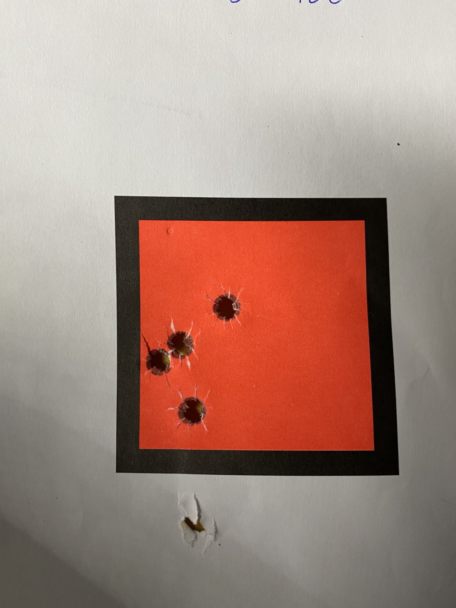

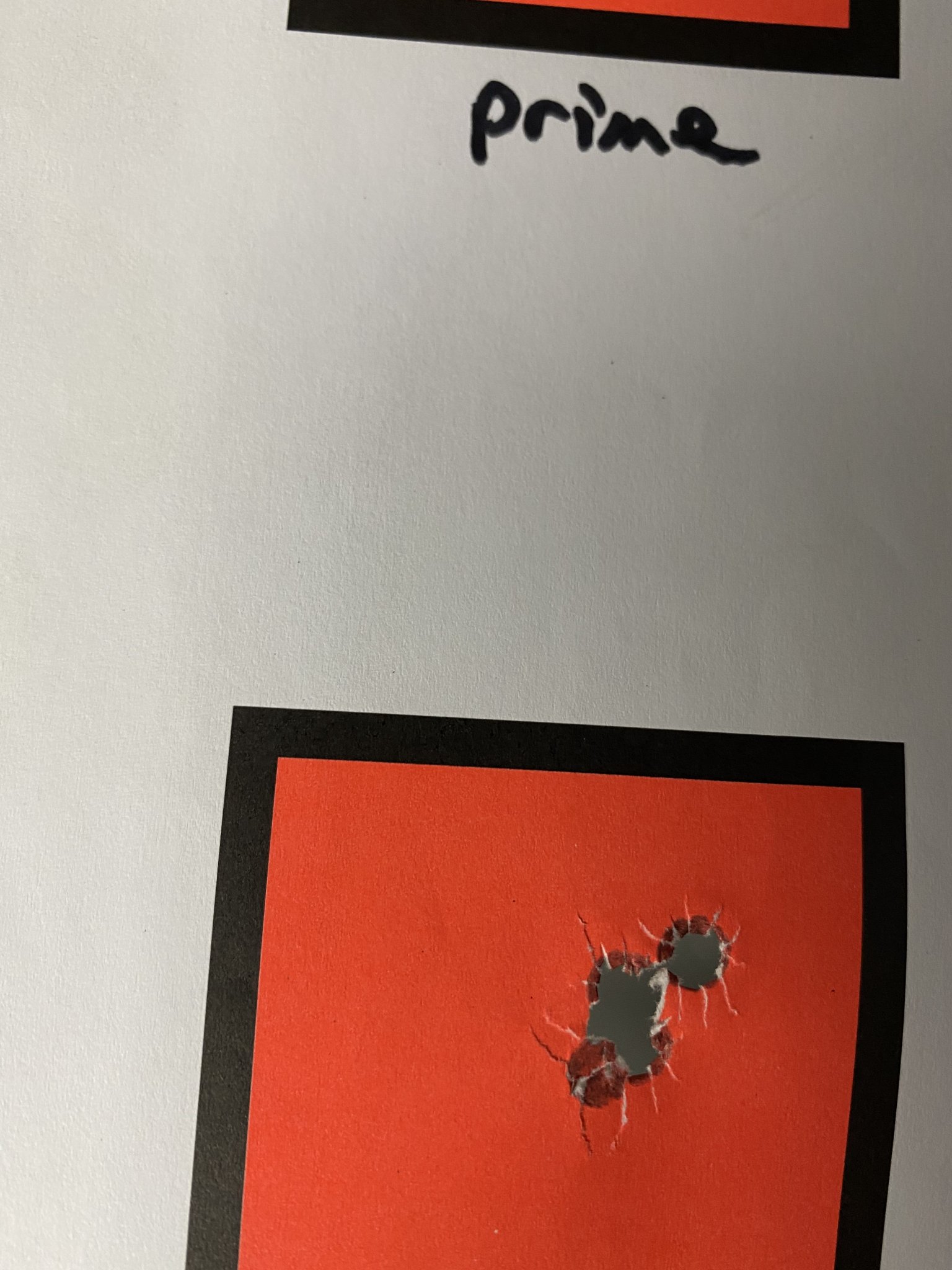

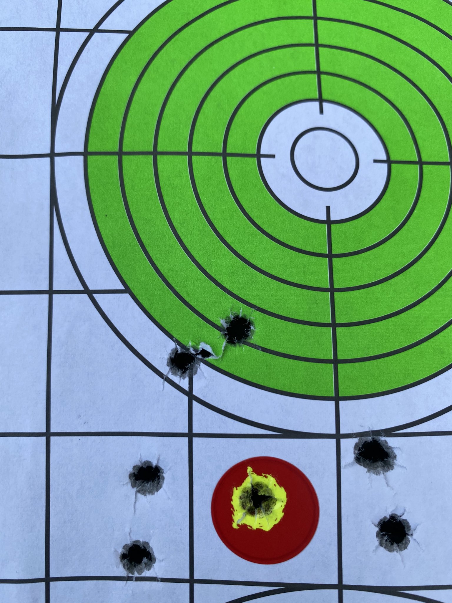

Ok guys,got the barrel to shiny metal. Went to range and shot a bunch of groups at 100 yds. Same result,shoots a sub 1/2” group then a 2” group.all random,puts 2 through the same hole ,then tossed a 2” flyer Shot a total of 100 rounds,letting the barrel cool about every 10 rds.I removed the action,checked everything
Tried multiple action torque settings
Tried 3 types of ammo with 3 different lots,barrel has about 1100 rds now

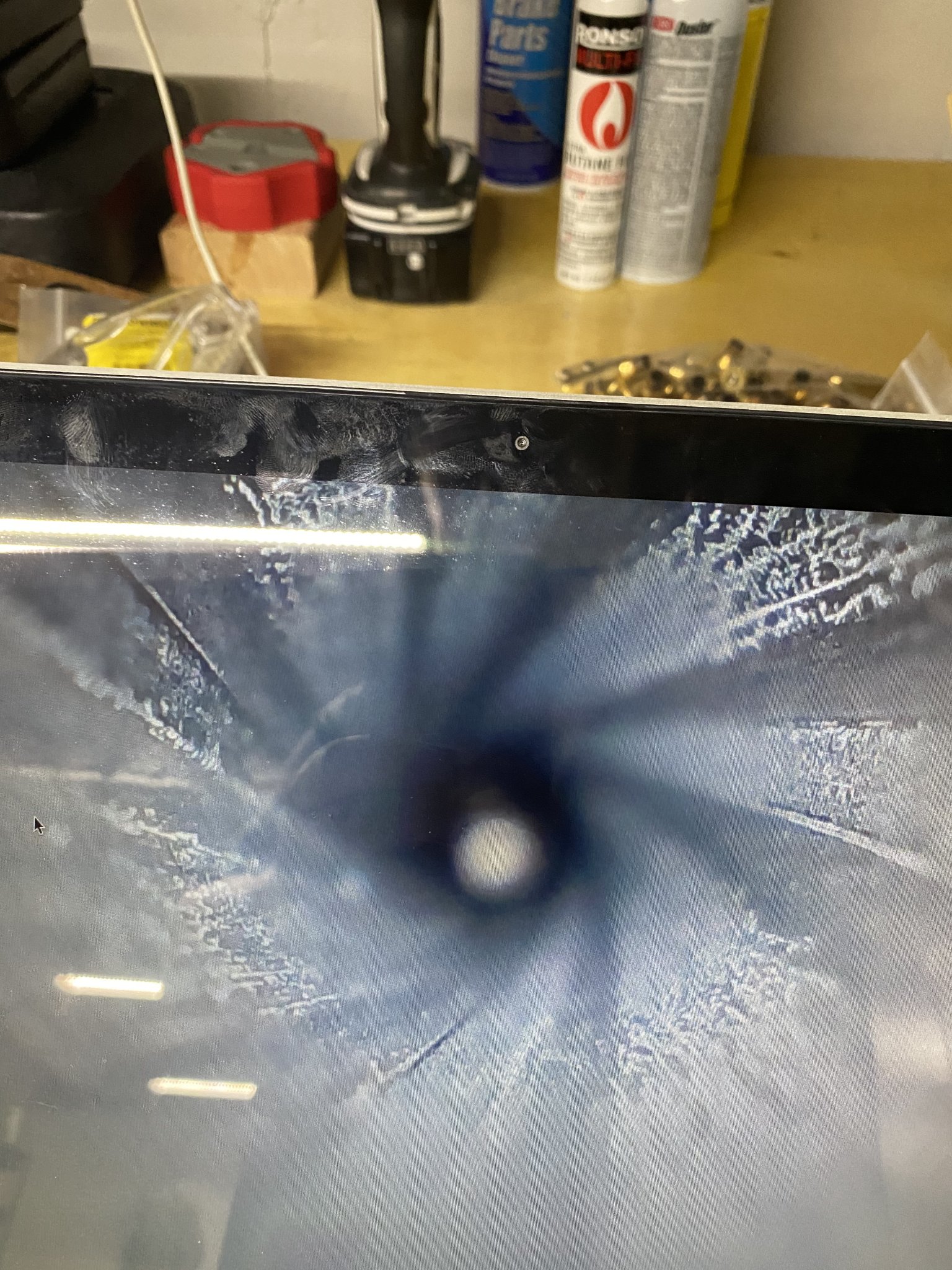

The bore scope is here,what should I be looking for?cracks?
Reactions: AllenOne1
5 shot groups

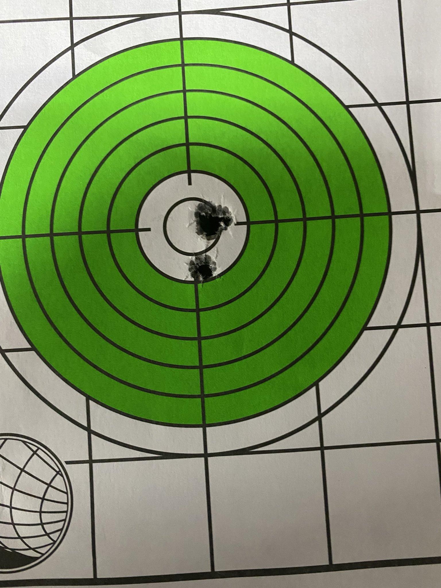

3 shot groups

Looks like you have checked all the obvious things: loose base or rings, different ammo lot, etc. Assuming you are consistent with recoil management, cheek pressure, etc, we’re looking at low probability problems like a loose barrel. As Feniks Tech said above, could be chassis or burned out barrel. Have a competent gunsmith look at it
