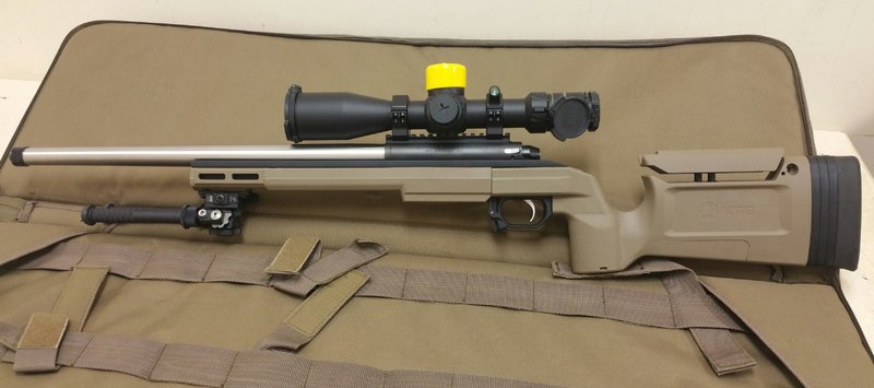

You can move scopes around in a good set of standard rings like Seekins but it just so happens my AMG sits in a Spuhr mount now. Here it is on my 6.5 Creedmoor match rifle but will be going on the V-22 soon.
Yes a little bit as the lowest Spuhr is 1.18" but it's not too bad. You could go with lower rings with a 50mm objective scope. Something around .87-92" depending on baser and barrel contour.
