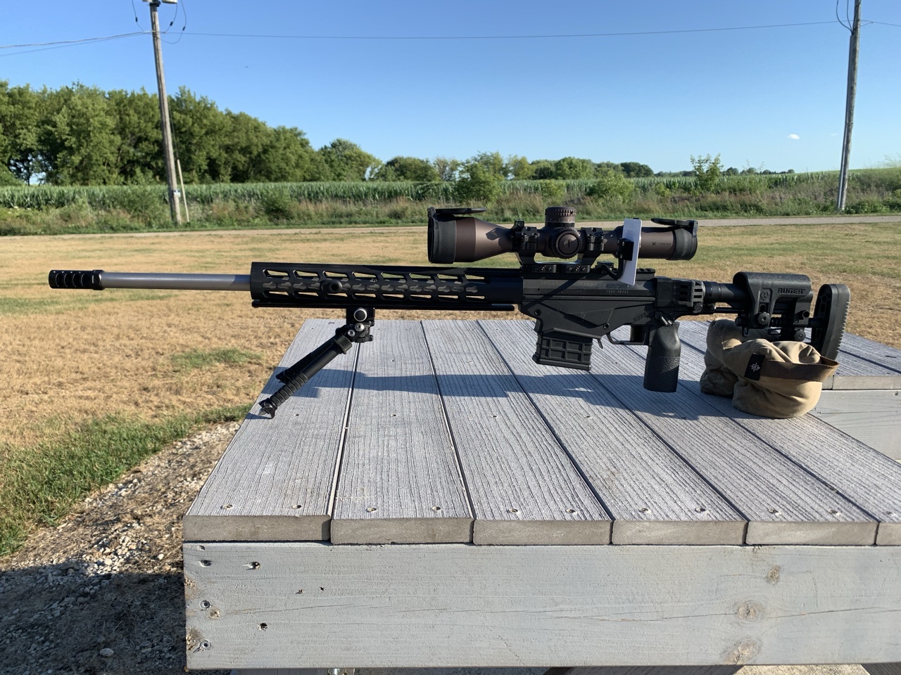

I use Athlon and Vortex/Seekins PMR rings to mount my 34mm tubes with 56mm objectives. They can be found reasonably priced and have held the scopes perfectly on my 6.5 Creedmoors. My rifles don't have forward hand guards so the height requirements are probably different, but I've used the versions running just over 1" high on mine and have plenty of room for scope caps. RPR has a 70° bolt throw so bolt handle clearance shouldn't be an issue for you.

Burris Signature XTR rings. 6.5CM RPR/Athlon Ares BTR and a .338LM RPR/Chronos BTR. No problems and no marks.
Are you using the shims to grab more elevation or running them flat? I'm looking at doing a Cronus or Ares ETR/56mms and have XTR Signature rings. Would be grateful to know just how much cant you are running total b/t rail and rings and subsequent clearance. Thanks
I'm just running zero angle on the ring inserts. I'm not going to be shooting farther than either rifle/scope combo will handle with the 20 moa built into the rail on the RPR. I'm able to shoot 1200yds and quite honestly I'm more than satisfied to do that.
