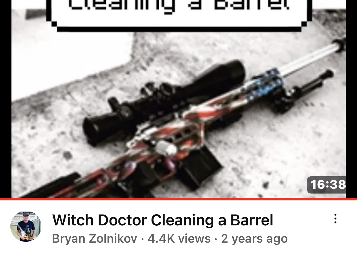

I follow Bryan Zolnikovs method. I’ve tried literally hundreds of different products and procedures. His method is definitely the best I’ve found, for maintaining benchrest accuracy. I don’t know how to link videos but here’s a screenshot of his YouTube video.

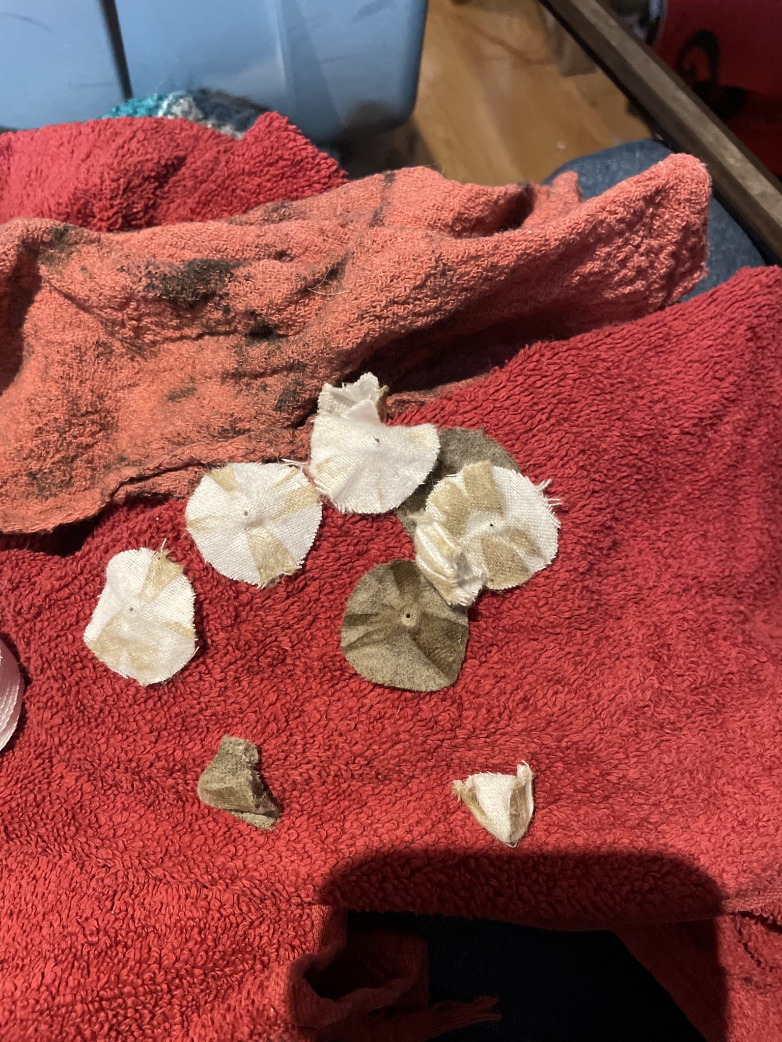

Just don’t let it get this bad.
This is the second cleaning on a new acquisition. 140 years of? Who knows how long it had been since it was last cleaned.
