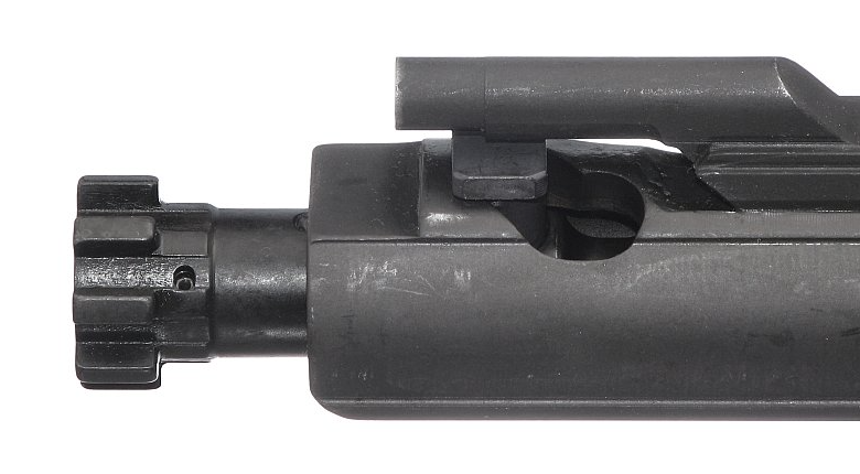

At the indoor gun range this morning I fired 10rds from my Aero PRecision AR15 and after the last shot the BCG locked back but the bolt did not retract. This prevents me loading a full magazine. This is a new development on the new AR15 which has only been shot a total of 70rds. I used same ammo PMC 223A as before when there were no problems. I have been lubing both my AR15's with Mobil 1. The PSA AR15 has a PSA BCG and runs perfectly with this lube. The Aero Precision, with an expensive Tool Craft Nickle boron bolt and BCG, is the one giving me the problem. Perhaps I did not give the BCG enough lube. I need a little advise have from the cognoscente.
I'm having trouble imagining what's wrong. The BCG locked back as in, the bolt catch held the BCG to rear? The bolt should be in the extended position (cam pin forward) when the bolt has unlocked and the BCG is traveling rearwards.
The bolt is in the compressed position with cam pin in the rear position when the bolt has locked into the barrel extension
"Did it lock back on the carrier and not the bolt?"
"yes"
There's your problem. The BCG should travel far enough to the rear for the bolt catch to catch the BOLT, not the carrier. Also, it SHOULD be impossible for the bolt to retract into the carrier unless the BCG is in the forward position, so there's nothing wrong with the BCG.
Your problem will be not enough gas for some reason, very likely the weak PMC ammo mentioned previously.
Also mentioned previously--you need to make sure the BCG is mechanically CAPABLE of retracting fully to the rear enough to lock on the BOLT, not the carrier. This is easy-insert an empty mag and pull the charging handle as far as you can until it stops. It should lock back on the bolt. If it will not do this, you have other mechanical problems like the wrong spring/buffer combination etc.
If it WILL lock back when operated manually, then the gas system may be at fault. But the first thing to do is try different ammo. Also, the BCG needs to be kept wet with oil during breakin, especially inside where the gas rings are. A couple drops in the exhaust holes on the carrier periodically will do.
