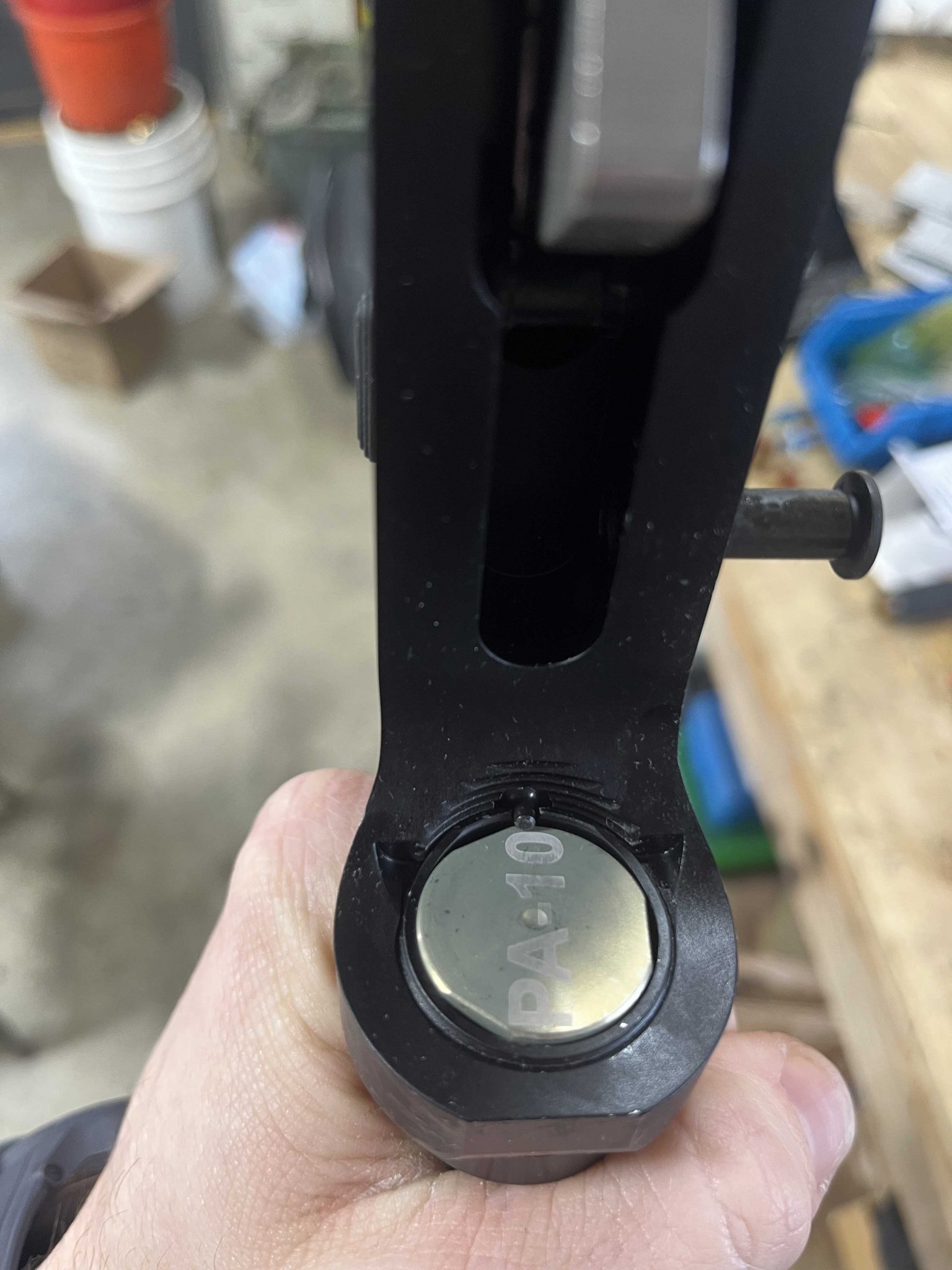

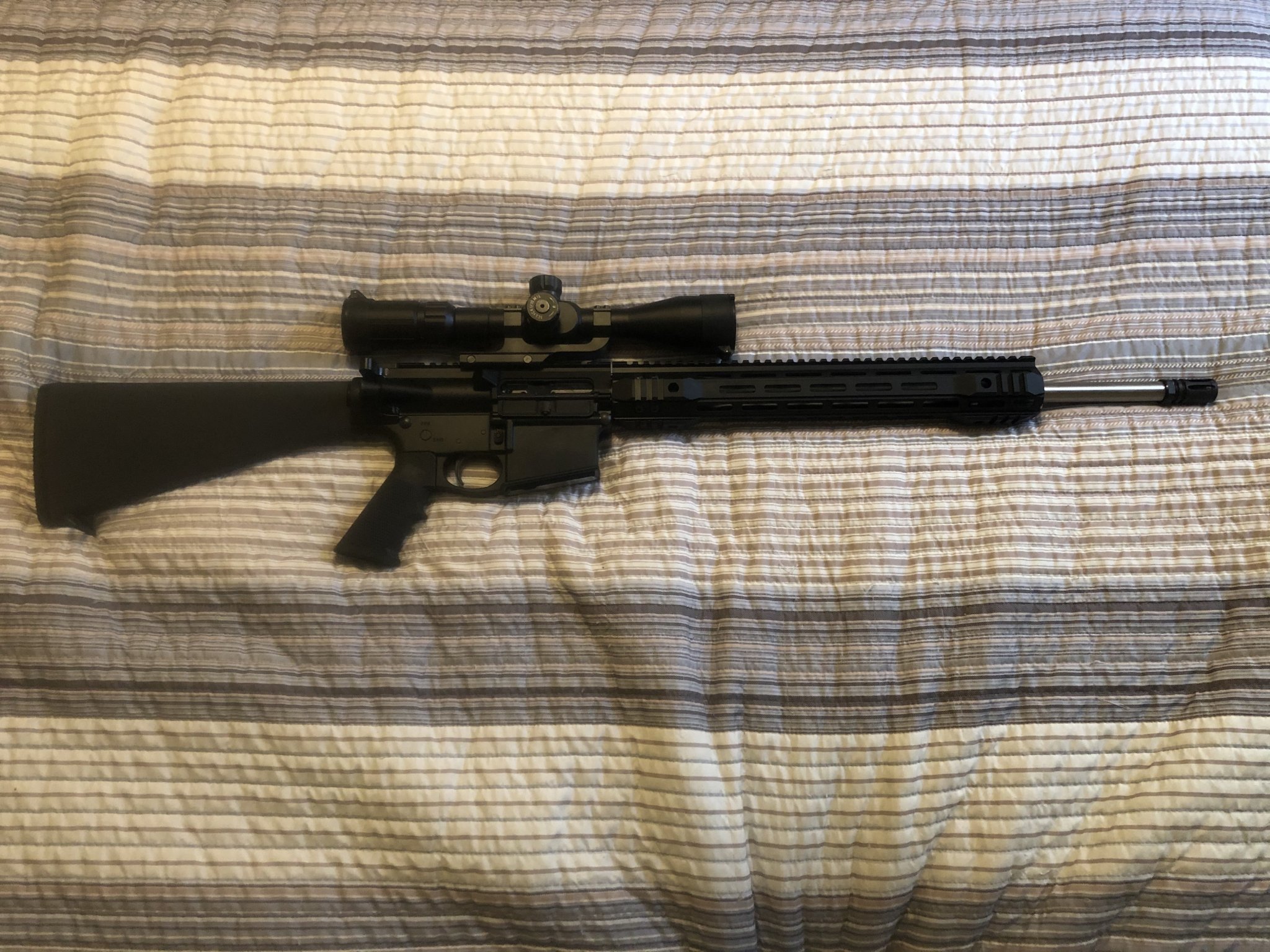

***UPDATE***​
Got the lower in today and assembled it. Lower looked very clean, no issues I could see. Looked like any other quality "value" lower. Everything went together just fine with the LPK. I greased up the trigger kit and honestly its not too bad. I've had wayyyy worse "milspec" triggers out of the bag. I believe this is the milspec Nickel Boron trigger kit.

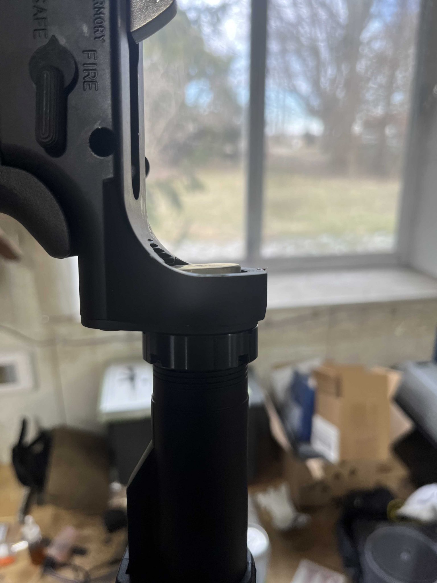

The weird shit started with the buffer tube assembly. The tube they send has a little U notch cut into the threaded area of the buffer tube. I was always taught to run the buffer tube until it is flush with the internal receiver wall, and has more bite on the buffer retaining pin. So thats what I did, and the notch fits perfectly around the buffer pin. That did not end up working out. The rear of the carrier was hitting the tiny portion of the buffer tube that was just a hair past the receiver wall. It may it hard to close and open the upper onto the lower and felt off when you charged it.
So I took the castle nut back off and unscrewed the buffer tube one rotation and tried again. That worked and everything went together ok. However, the short buffer and backed off buffer tube, makes the buffer a little off balance and the carrier hits it when you close the upper onto the lower. I was worried backing it off might push the carrier closer to the receiver wall, but there is ~1/8" of space.

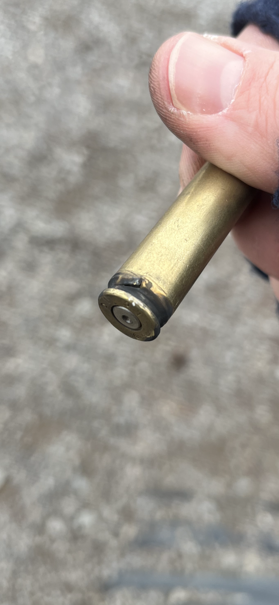

I got her all together and took out 4 mags of ammo. 2 mags were some remanufactured "M80", which I knew is sort of low power, and some Korean surplus that has some serious zip to it. Very good ammo, but feels/shoots on the high end of 7.62 ammo. Ran a little over a 100rds without a single hiccup. I can understand why PSA went to the AGB's, and I will say, it was probably a good idea they did, especially for the average owner of a PA10 who doesn't get into them like someone on here might. I set the AGB to what the card recommended. 17 "clicks" in from zero for .308 Winchester. Wayyyy over gassed. Even the reman'ed M80 was spitting hard at 2 o'clock, and the Korean surplus was at the 1 o'clock and erratically bouncing around.
I walked back to my shop (200yd range in my backyard), and adjusted the gas block 5 clicks toward zero. Ran half a mag of the M80 and it wouldn't cycle, but just barely. Went two clicks back open and was able to run both the M80 and the Korean hot surplus just fine. Both brands were a nice 3 oclock pattern in a smaller pile. Ran 3 rounds of PPU 168 BTHP that I had laying around and same thing, same pile.
I got the RT-6 field zero'ed and clanged some 66% IPSC steel at 100yds. Going to try and hit a range day at our club next week if its nice and try to do some of the accuracy testing. I've got some Federal Berger 168's, 175 SMK's, Fusion 150's, and M118. I'll most likely just go ahead and put the Armalite buffer system on now. Stock kit ran fine, but I'd like to see how the nicer setup effects it at all.

I had to cut my own U-notch into my Armalite tube in order to get it fully screwed in. I tried installing it, noticed the problem, and backed the tube out enough to remove the buffer retainer. Then screwed it back in where it needed to be, checking alignment with the end plate and tightened to castle nut hand tight. I marked exactly where the notch had to be and removed the tube. Used a 1/4" chain saw file to do the notch.
So I guess I can add this problem to my list of "Short buffer drawbacks". I do remember this when I was running my short buffer but I just went with it and didn't have any problems with that. The Armalite buffer doesn't tilt downward as much as your picture from the side shows, at least not in mine.

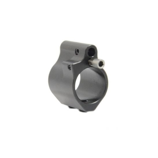

Is this the Adj. GB you have ?
https://palmettostatearmory.com/psa-custom-750-diameter-click-adjustable-gas-block-7811021.html
Interesting description of it ... 5 clicks per 360 degree rotation , but a total of ( I can't remember what you said. )
Is there anything stopping you from backing it all the way out ?

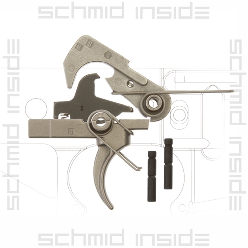

And BTW, the PSA 2 Stage Nickel Boron Trigger is a Schmid Tool product, LOTS of manufactuers use / sell them under their name. Good triggers.

Verifying that the carrier doesn't strike the receiver extension hub, like you did, is important, especially when using non-OEM parts. Another dimension to check is the distance between the bolt lugs and the bolt catch at full pull-back of the charging handle.
Yes thats it. Ya I counted 27ish clicks. The paper said 26. I did not back it out, but did screw it in until it stopped, then went 16 clicks open. I ended up at 13ish clicks open. They say 5 position? Who knows.
My trigger is a single stage but its coated in something. Looks to be a hazy nickel boron type coating, as its definitely not phosphate or the standard black/gray. I just assumed nickel boron. Its smoother than most milspec, so it breaks a little cleaner. Still probably 5-6lbs though; I don't have a gauge.

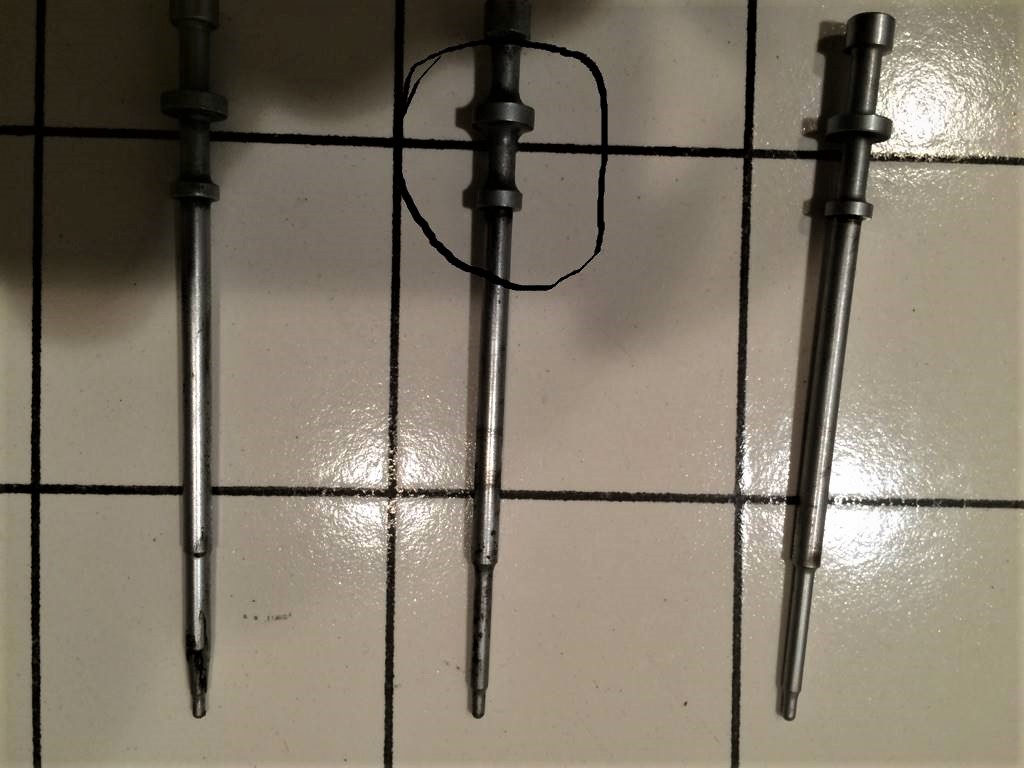

Do you have the means to measure the firing pin tip size ?
Adj. GB wise, as long as it works, Lol ... I would prefer the "26" clicks over just 5 though.
If the trigger has a "S" stamped on the hammer, it is probably Schmid Tool as well

I do, I can check it with my Starrett calipers. Appears to fit very nicely in the bolt head though.
I just get hesitant with the parts that see the most action (heat/pressure/repetitive motion/etc). PSA does charge $50 for the gas block, so its not dirt cheap, but $30-$50 away from the name brand competitors. Maybe it works forever, maybe it breaks, but generally I prefer to upgrade to something more reputable in that area. It DOES currently function as intended though.

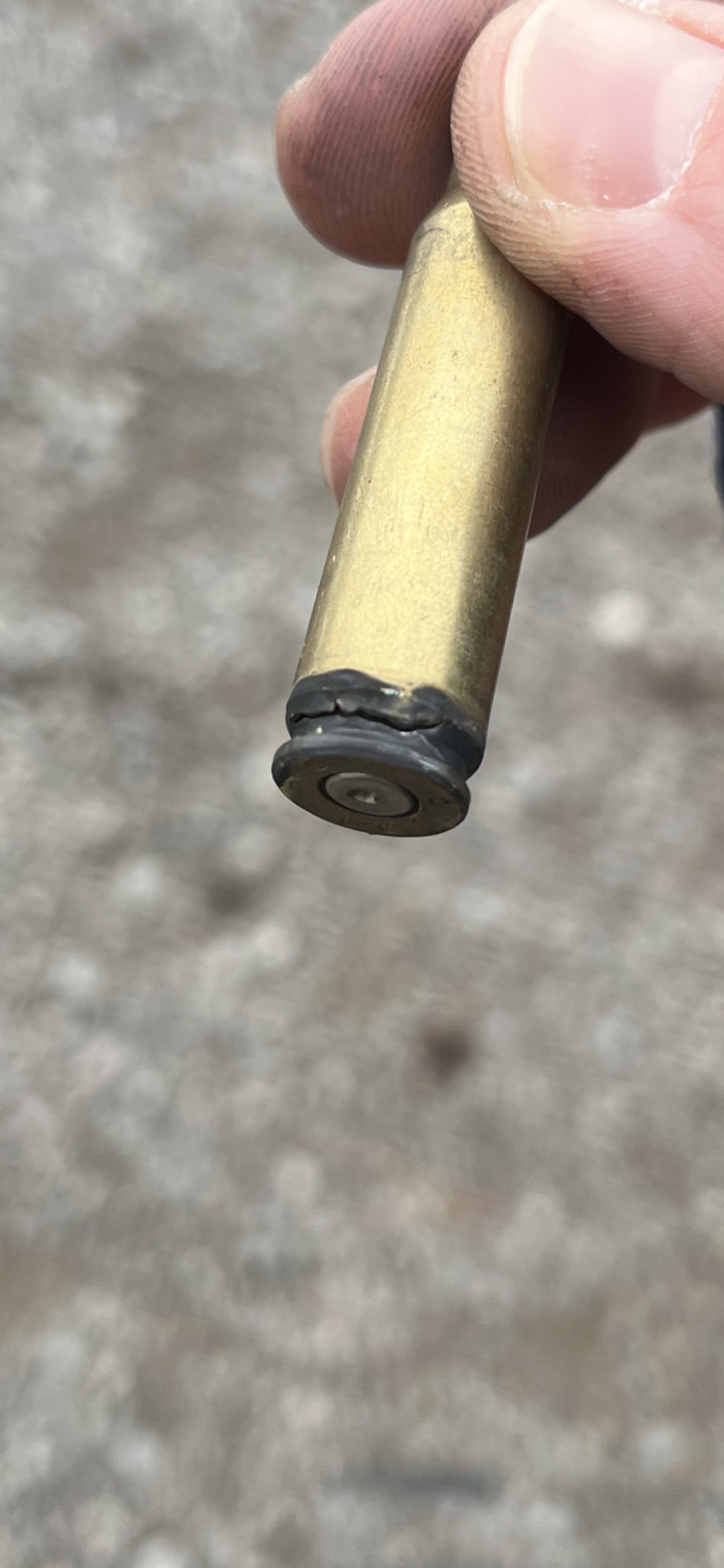

One interesting note is both 175gr ammo would not fully cycle at the current gas setting. I had to open the gas block up 2 clicks to feed the 175's correctly.
The Federal 168 Berger "felt" like the heaviest recoiling ammo I shot. I did not get chrono data but hope to next time.

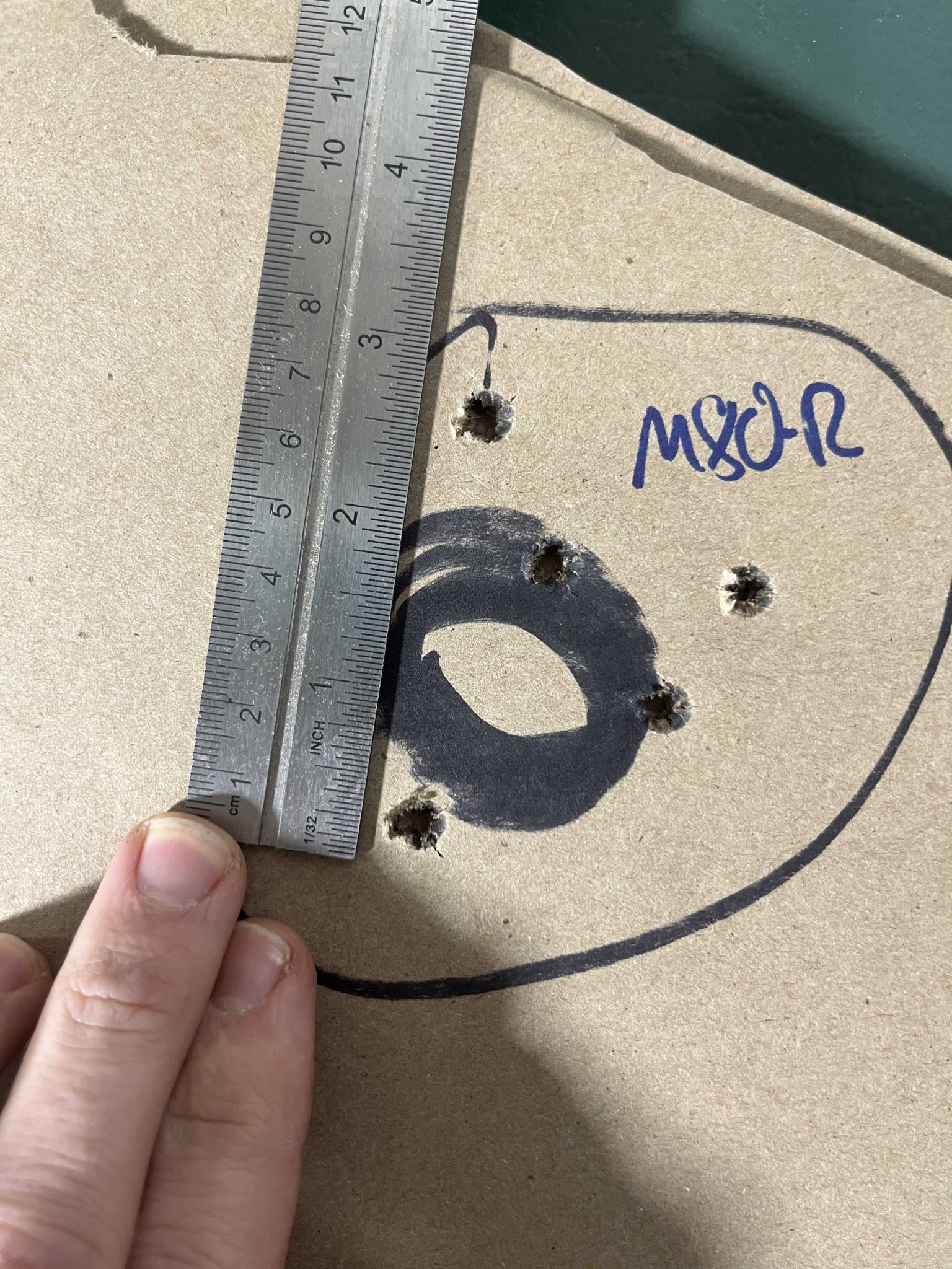

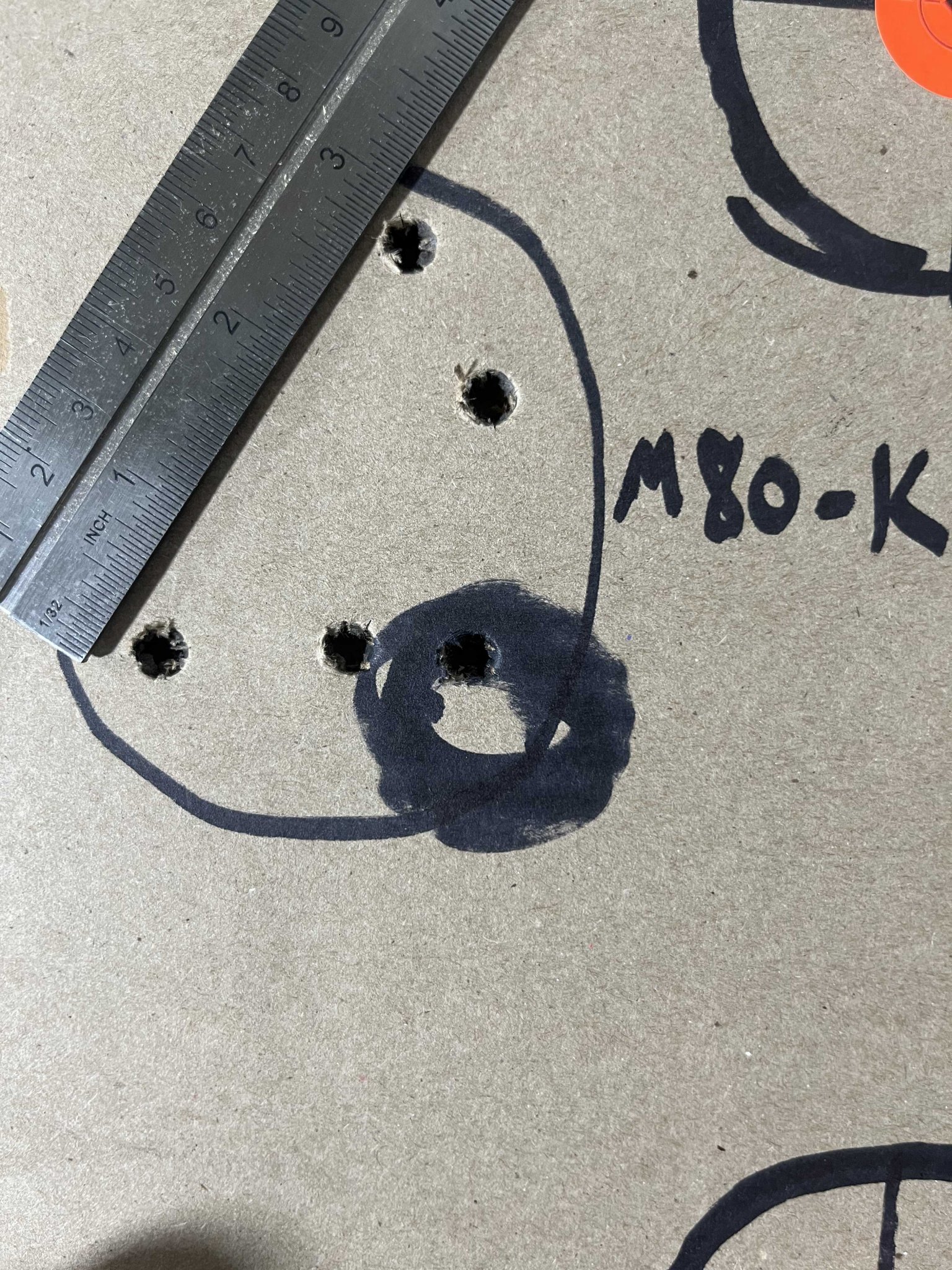

Korean M80 - Both groups were right around 2.5-2.75moa Reman. M80 - Basically the same as the Korean M80 (2-3moa)

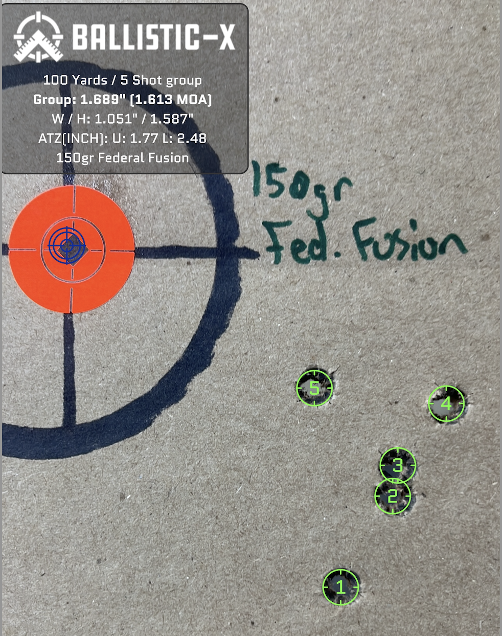

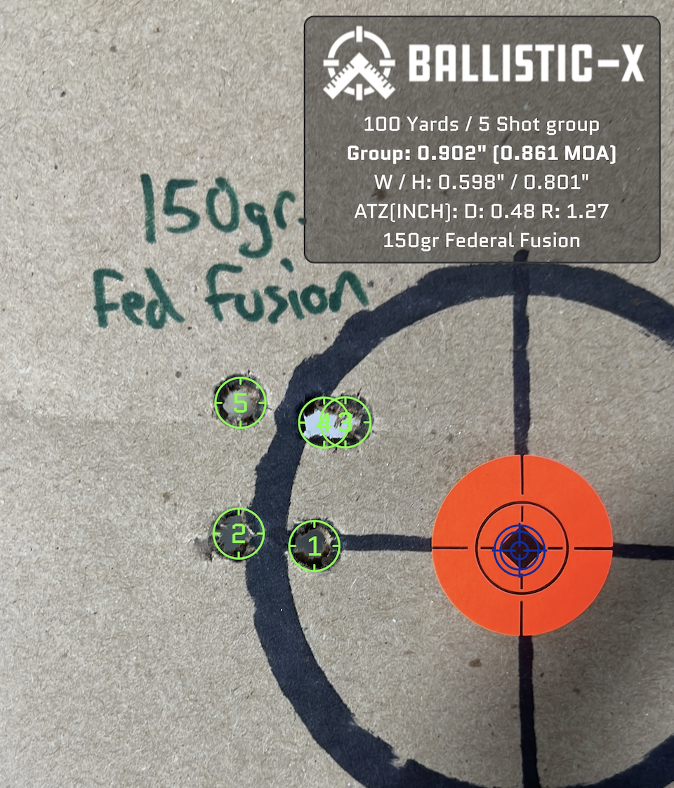

Federal Fusion 150gr. -- Smallest group of the day at 0.8moa. But also biggest group at 1.6moa. May have been me on the first group​

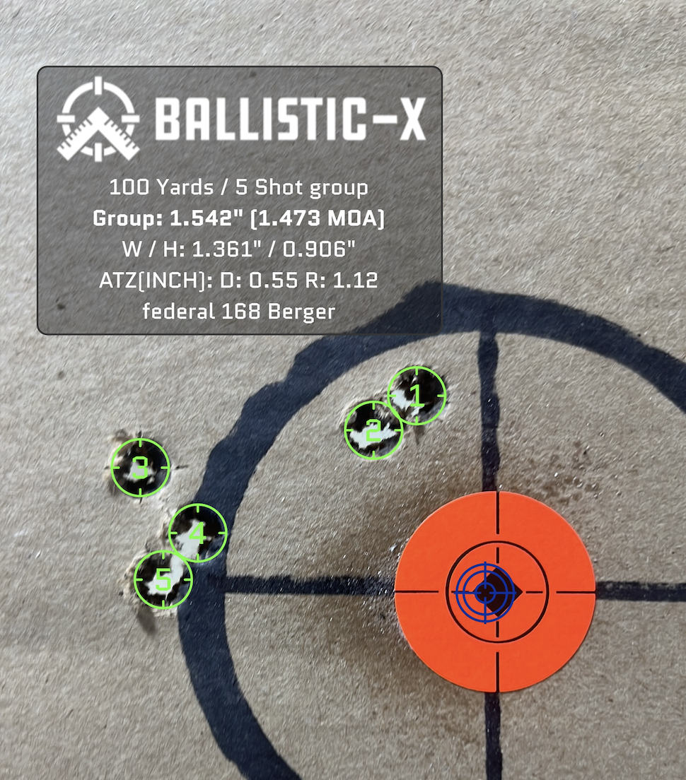

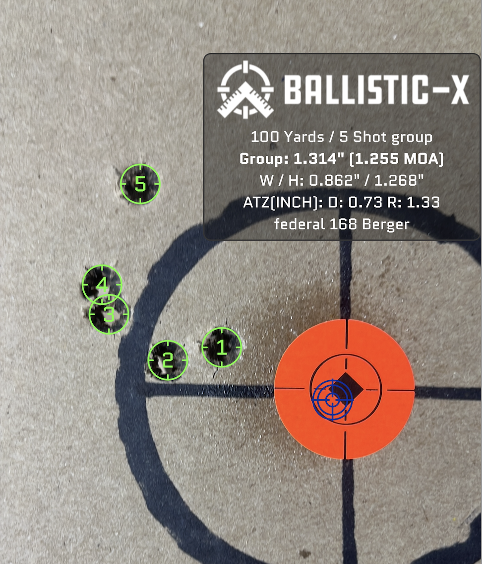

Federal Match 168gr Berger -- I thought this may have been the best, but fell right into the "average".​

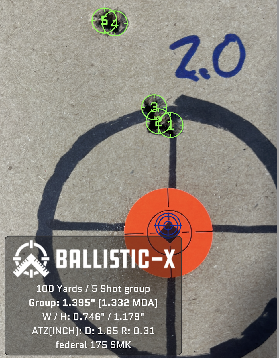

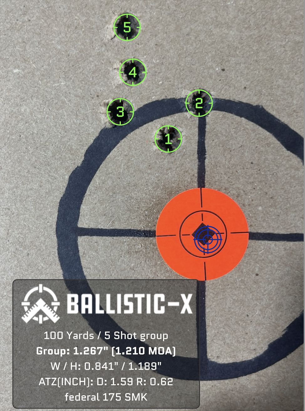

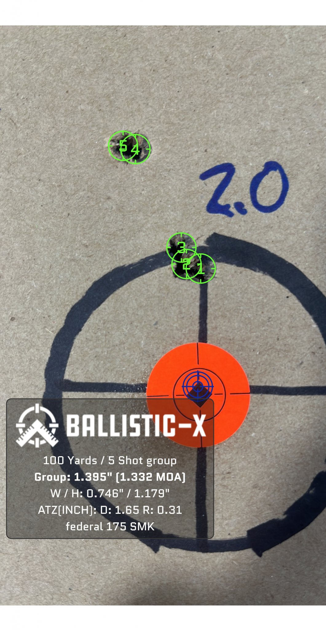

Federal Match 175gr Sierra Matchking -- I felt overall, the 175's performed the best. The first group was when I found out the gas setting was quite right. I shot two, adjusted the the gas, then shot 3. Probably my fault.​

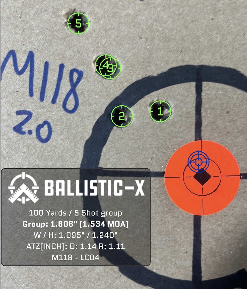

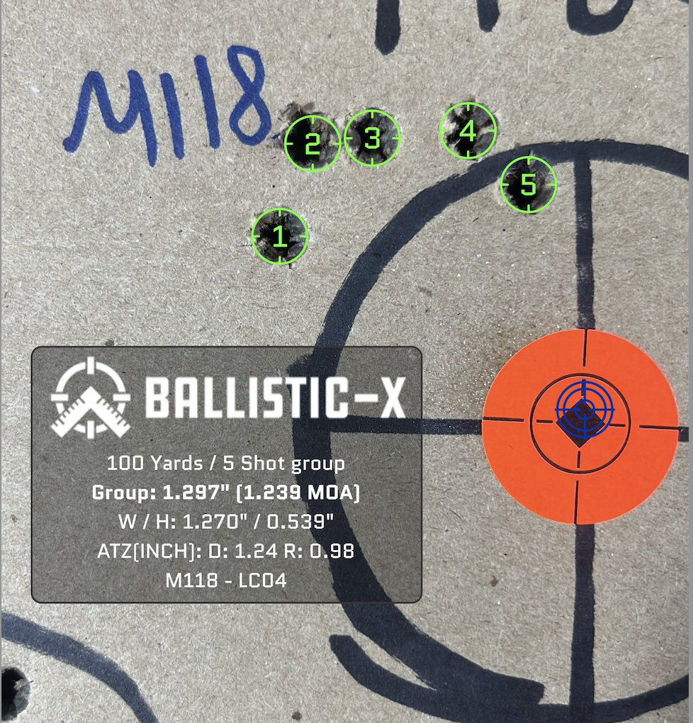

M118 (LC04) -- Shot better than I thought, but then again I have no experience with M118. 2nd group, 5th shot was called flyer. That group was shaping up to be pretty good too.​

In the end, I thought it was pretty decent for what it is. With match ammo, it's easily a 1-1.5moa rifle. I think with a better shooter, some tuning or maybe handloads, it'd be a solid 1 moa shooter.
The buffer change mid session did result in a little better average group size, not that I would attribute it to that entirely. After a few groups, I felt more comfortable, but then again, the last groups start to wear on you. Recoil impulse change was noticeable. Recoil felt more drawn out, and not so snappy, which I figured would be the case. Ejection pattern direction was the same for each ammo type, however the distance travelled was less after the buffer change. Ejection went from about 10-15ft to around 7-10ft.
This reaffirms the idea that an AGB is not the ONLY thing to be adjusted to make a rifle shoot better/smoother. This seems to be especially true on large frame but applies to small frame as well.

    Ballistic-X-Export-2023-02-10 15:18:25.465556.jpg
The American Marksman M80 Reman'ed ammo is super cheap, comes bulk packaged, and is dirty ammo...as if it was never tumbled. However, it does come with LC brass and it performed just as well as the other surplus M80 I had did. So I'll probably buy more, and might try their M118 reman'ed. I did have one case blow a case head on me though, 3 shots into the day. Thought my magazine caught fire cause it was smoking so bad. First time for that ....

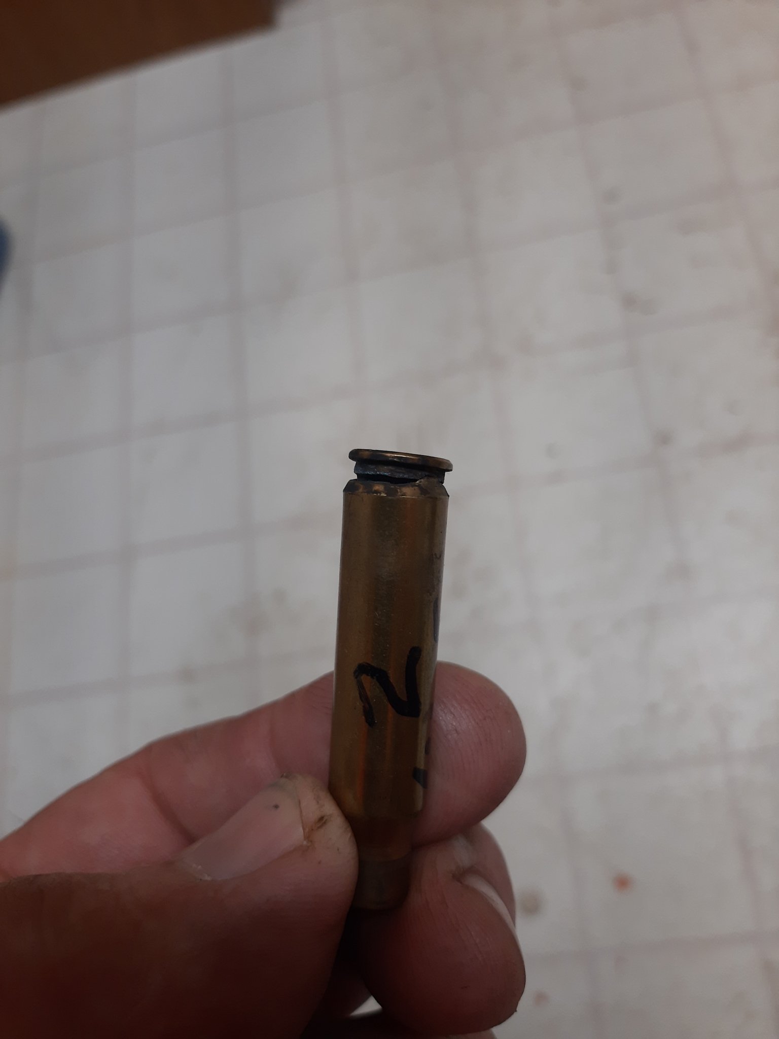

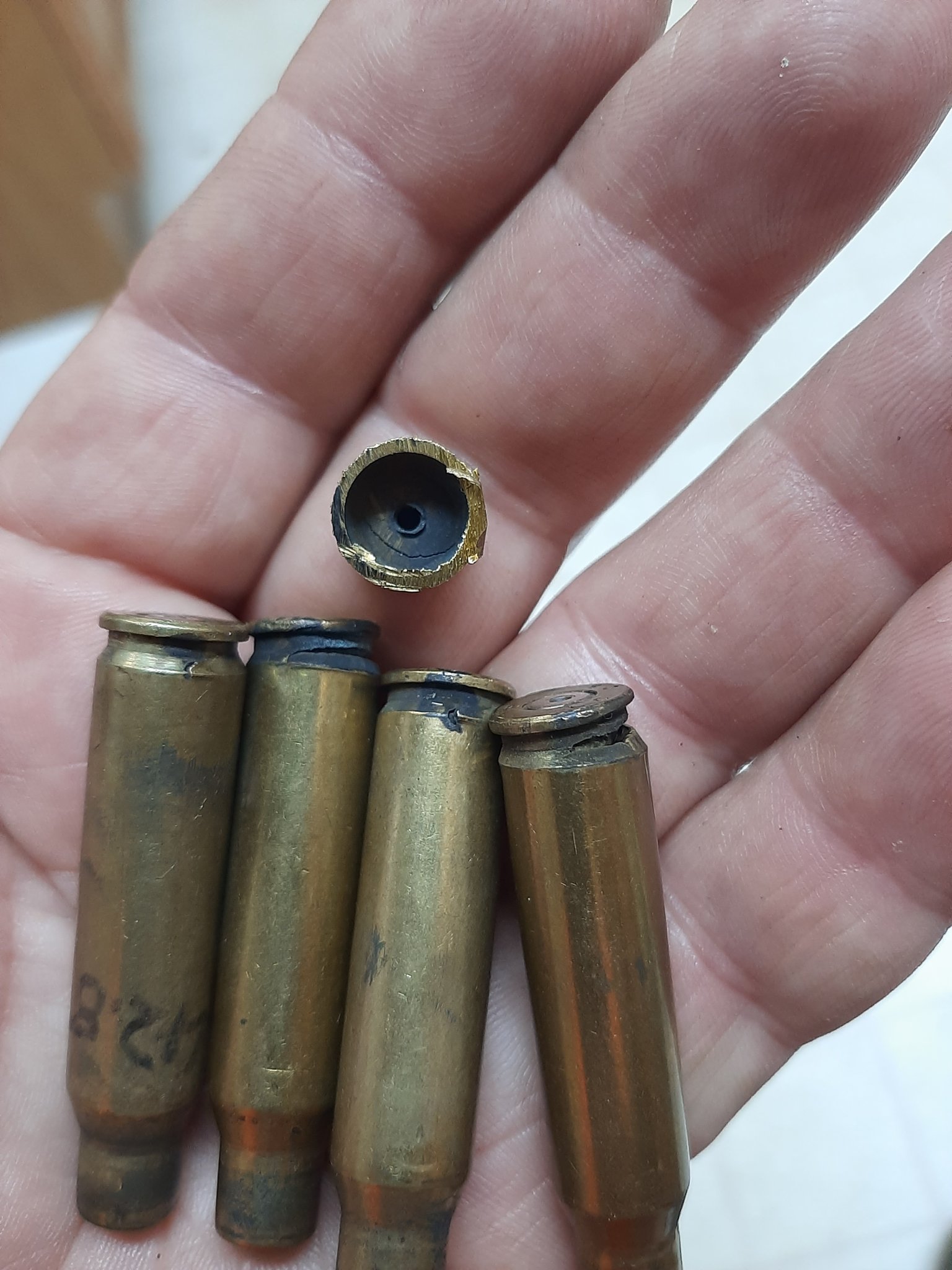

THIS BRASS!!
That's NOT a case head separation. I had the same problem on a bunch of LCbrass from Top Brass I bought in the early 2000's. Those cracks are in the solid brass portion of the case head. It's a failure of the brass itself. I also experienced this during my journey to reliability with some of my reloads. It threw several major monkey wrenches into my troubleshooting process by giving me false indications of faulty reloading practices. Set me back months.
I bought the brass sometime before 2010 but didn't use any of it until 2015 or so while I was loading bulk ball ammo. I don't have any idea how much of this shit is still scattered amongst about 1500 rds I have already loaded.
I never contacted Top Brass because it had been several years since I bought it. I don't know if this is a fault of the LC brass or somehow damaged during processing, but I really don't see how processing once fired brass could do this without any other visible damage.
Cut the head off that case and you'll see big cracks in the head around the primer flash hole.

THIS BRASS!!
Oh damn. Thats not very reassuring considering its LC brass. I wonder if there was an issue with a batch of the components to make the brass or wrong combo of metals or something. Weird.
I kinda thought the brass may be too brittle etc. After I found this problem, I found out I could weed out most of it by inspecting the interior of the case with a light BEFORE loading it. There will be very visible cracks in the base. I used a mini maglite with a the curved fiber optic attachment. I think I weeded out around 75 rds of brass out of about 300 I had left. Trouble is, I loaded about 1500 rds of bulk 145 gr fmjs and put them up in ammo cans for future use. If you notice the headstamps they span multiple years, so I don't think this was limited to a small lot. I saw a few posts on other forums about the same problem and they all eventually arrived at the same conclusion that the brass was faulty after a long discussion mistaking it for case head separation.
To anyone reading this I want to make it clear that I am NOT blaming Top Brass for this. And the cracks are apparently present and visible before the "once-fired" brass gets reloaded.
We'll see. I have another 100+ rds or so of it. It's so damn cheap and doesn't shoot bad, I'm tempted to chance it and buy more. Of course, this ammo was bought about 5-6 years ago, so hopefully the newer stuff would be good.

I assembled a PSA Gen 1 PA10 lower and then purchased a complete 20" PA10 upper for it back in 2016. It is definitely over-gassed but I have not had any issues with the rifle. I have not spent the time yet to find the most accurate factory ammo for it yet. I have mostly just shot Winchester White Box ammo with it and get 1 1/2 MOA at 100 yards using a Primary Arms 4-14 HUD DMR scope.
My Savage Model 12 shoots the old Norma Tactical 150Gr FMJ extremely well so I thought I would try it in my PA10. That was a mistake and waste of good ammo. The PA10 did worse with the Norma Tac than it did with the Winchester White Box.
I need to try some of the Federal Gold Match 168Gr and 175Gr ammo in it along with seeing if I can tame the recoil down some. If none of that pans out, then I will look at changing it to a different caliber with less recoil.

I am using a 308 rifle length buffer that came with the build kit from PSA.
Here is a photo of my PA10. Not in the photo is the MagPul PRS3 that is currently on the rifle.
I don't know if I want to spend a bunch of time and money on this to tame the recoil until I know how it shoots with premium ammo. As it is, the rifle has been 100% reliable for me.

Gustav7 , I don't remember if you were able to measure the gas port size ?
I am curious if they have gotten smaller over the years. And the firing pin tip size ?
I did not measure firing pin tip yet, I can tonight if I remember.
Gas port was ~0.074-0.077"

I am no expert, but in my experience the adj gas block has done nothing to cut down on recoil. It's all in the heavier reciprocating mass and the spring rate to make it work. If anything, cutting back the gas while still using the too-light buffer made the gun too finicky about ammo and less reliable. There was a very fine line adjustment wise between running reliably and short stroking. When the gun didn't cycle properly, felt recoil was greater.
The heavy buffer and spring changed all that. My 308 recoil now is similar to a 556. IMO, buffer and spring are the first step, then fine tune with the gas block, if needed. If I had a bum shoulder though, I'd just go with the small frame and be done. Regardless of the caliber on a large frame, you'll still likely have to go through all these experiments to get everything right.
Longer barrels and gas systems are out of my very limited range of knowledge though so YMMV.

Mine are ( from my old thread, 2017 ) SS 18" Mid-Length .070 GP, and the Nitrated 18" is .066 GP , also Mid-Length
I will have to dig out the FP tip size, I thought I had that written down, but that wasn't it... the one I had written down was for a "experimental High Pressure FP" with a tapered shaft at the front.
Left hand one, .068 tip
