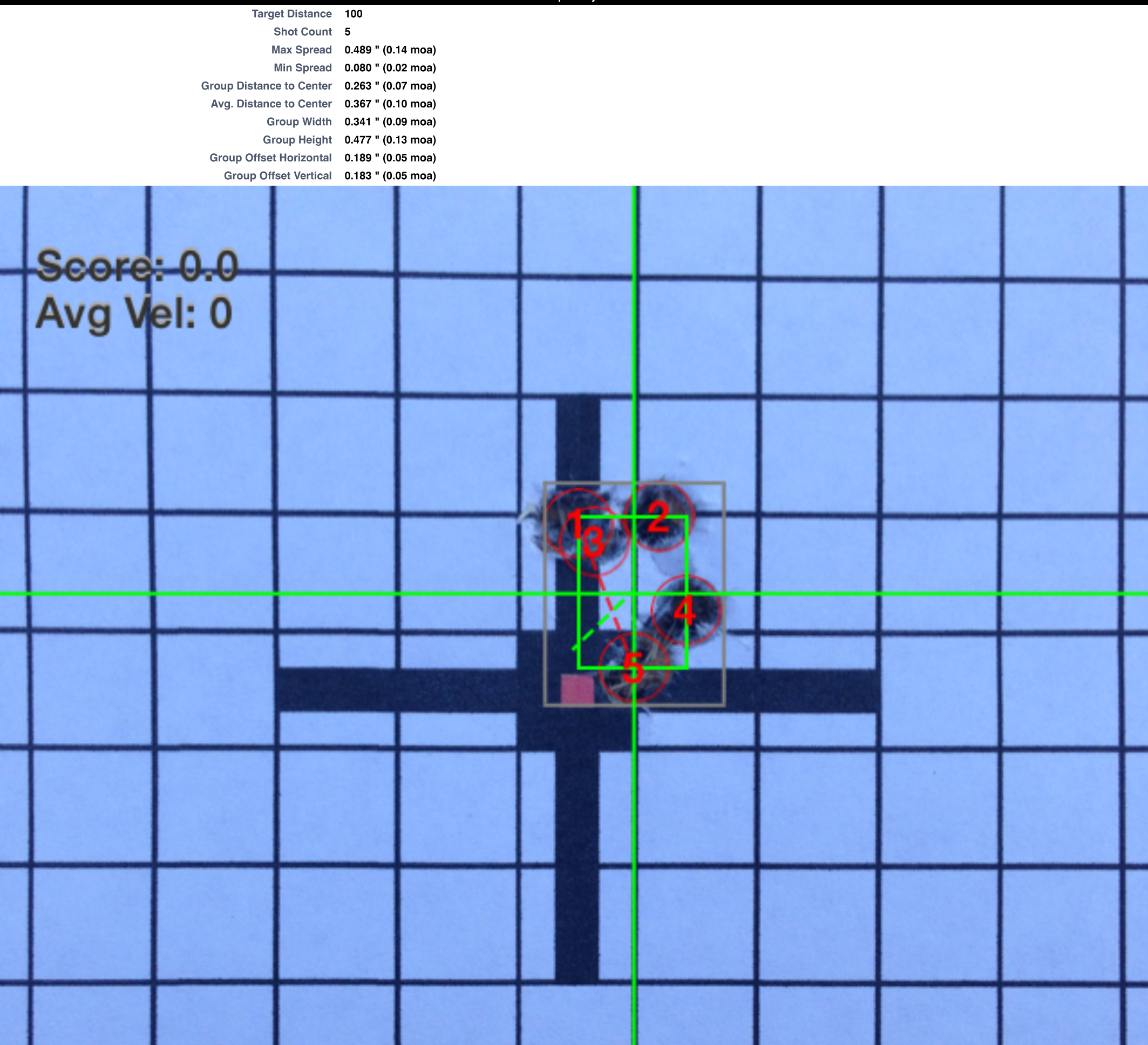

I use 23.8g of 8208xbr with 77smk in LC brass and CCI 400 primers. Shoots sub .50" at 100. I also use 23.5gr H4895 with the 77smk which is really accurate. Picked up some Hornday 75gr BTHP Match to load up and test the other day.
69Gr SMK, 25.4 Varget, F205m, Win brass.. 2840-ish out of an 18" 1/7 Wylde. Chrono was giving me grief that day.. but dope at 600 was damn near spot on, so its close.
