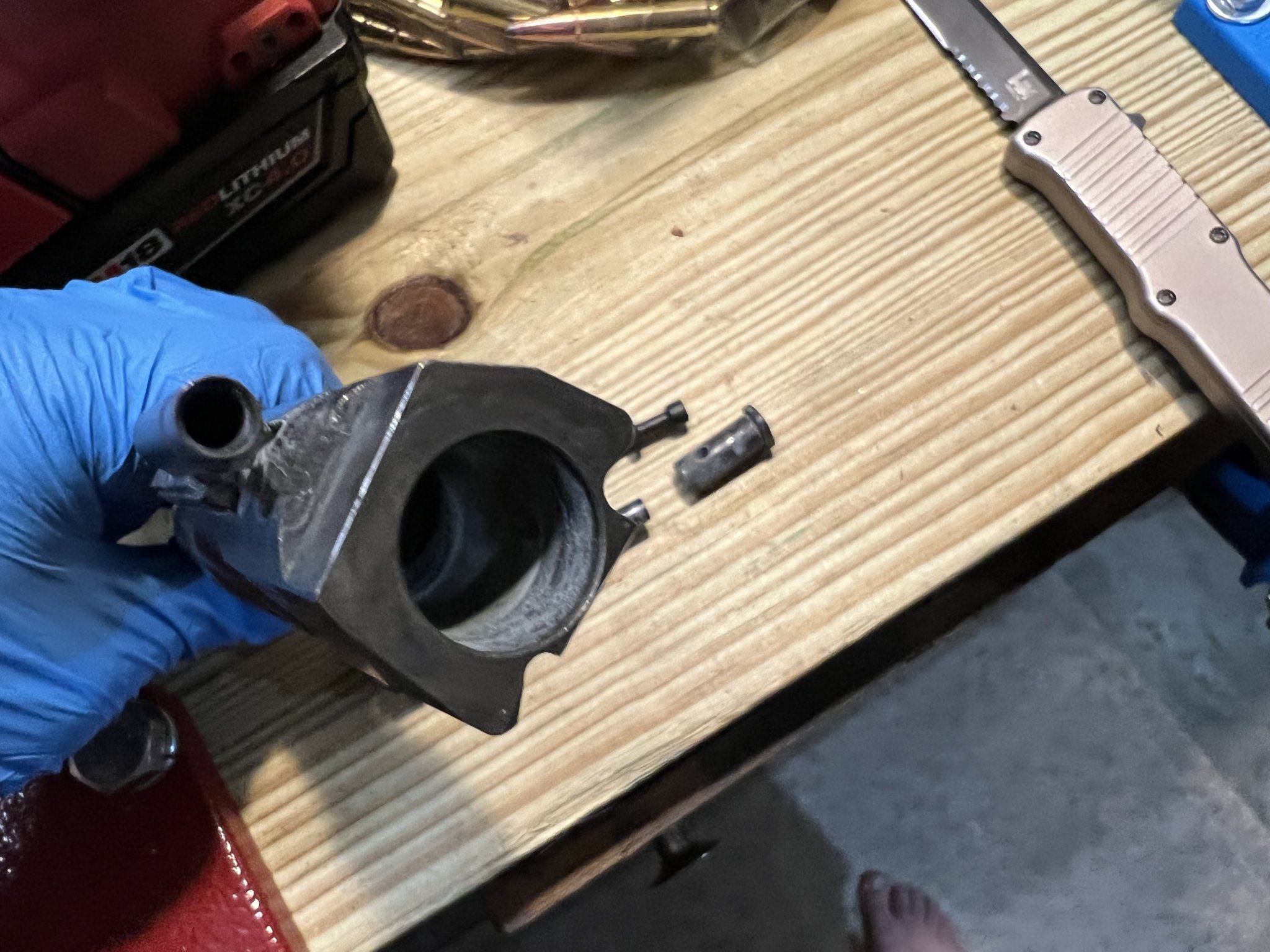

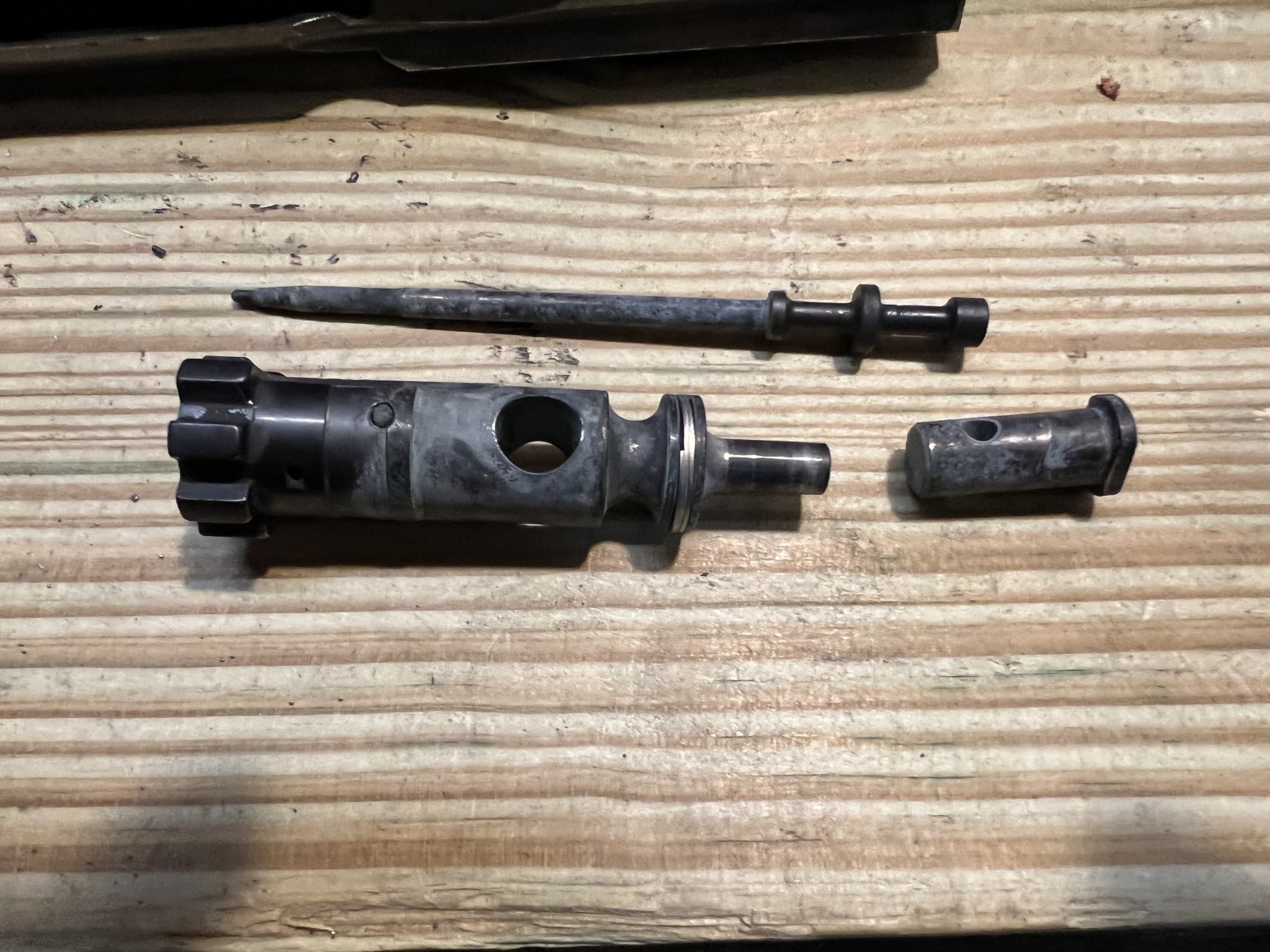

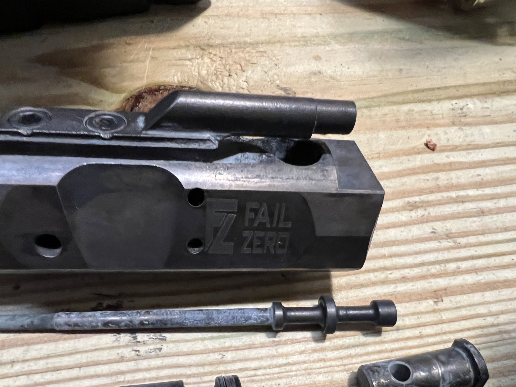

    Hey, opinions welcome on this buildup vs corrosion on my JP high pressure AR10 bolt, cam pin and firing pin.
    The BCG is Fail Zero.
    Lube was only used of friction surfaces and was Lucas Extreme Duty gun oil.
    This first happened after not cleaning the bcg and shooting less than 50 .308 rds. I put the gun away and took it back out in a few weeks and it was approx 35F outside. I attributed it to not cleaning it and the cold. My mirror set-up did the same thing in AR15 but to a lesser extent. The AR10 bcg was stuck in the gun and took was elbow grease to get it out.
    Since then, I’ve used the same M-Pro 7 gun cleaner on the bcg I had been using but now after every range trip. I also switched to Slip2000 EWL prior to this happening.
    I didn’t fully break down the bcg, just sprayed it and wiped down thoroughly and lubed. I’ve done this for years with all my ARs and never seen this whitish build-up. Never had a problem using various lubes and cleaners, albeit mostly M-Pro 7.
    Any thoughts? Thanks 🍻

    M-7 was wiped off and then friction surfaces on bcg lubed. It’s not greasy at all. It’s dry and binds the parts together making them difficult to assemble. You still might be right as it would be on those parts shown as they were not wiped off since I didn’t break it down. Weird none of my other bcgs have done this. Maybe the coating Fail Zero uses. But it’s on the JP bolt although none of my other ARs have JP bolts so…

    I’ll try and clarify:
    After shooting 50ish .308 rounds:
    Removed BCG but didn’t break it down (never have as a routine previously on other ARs).
    Sprayed BCG w/ M7 (used it for 10+ years no issues) then wiped it down, lubed with Lucas Extreme Duty (this lube came with a Christensen rifle and after researching, it seemed like a solid product so kept using it).
    After sitting in a climate controlled gun room for a few weeks those are the pics.
    I cleaned the BCGs up really well and then changed to Slip EWL to see if that variable on these new Fail Zero BCGs might have been the culprit. Same process after shooting a second time, but now using Slip, and the same corrosion/buildup happened after a few weeks of not shooting those two guns.
    Thanks for help.

    Slip2000 EWL - Calcium sulfonate (corrosion inhibitor). What they call their proprietary calcium complex. (5-25% by weight)
    Lucas Extreme Duty Gun oil - Zinc Alkyldithiophosphate (corrosion inhibitor, 15% by weight)
    Most likely both of these oxidized (created an oxide layer) in your storage environment.

    Update.
    Stripped down BCGs. Cleaned w/ C4 in a ultrasonic cleaner. Now only wiping down with M7-Pro as opposed to spraying directly on the BCG. Slip EWL after. No further issues. Also, it’s much warmer now than then but so far so good.
