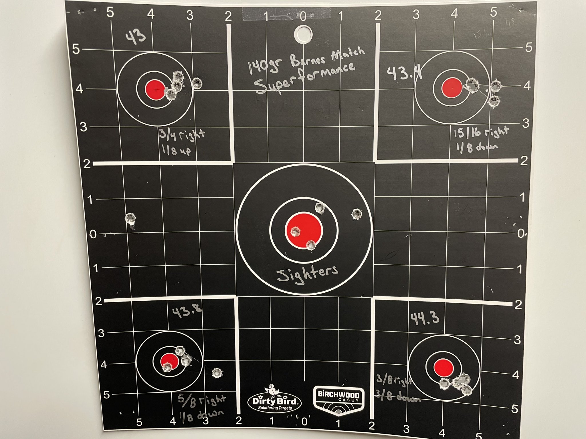

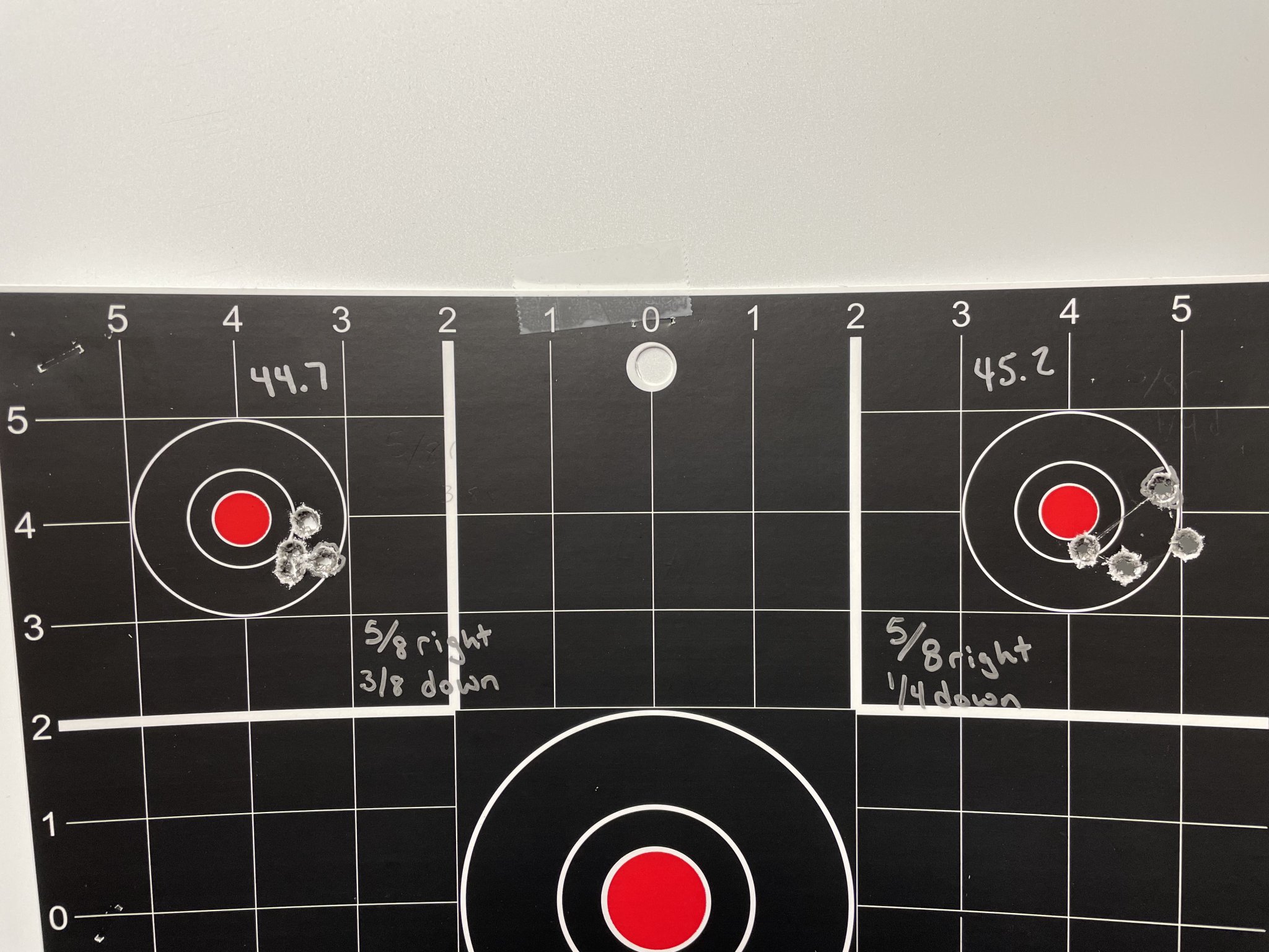

Hello,
I’m new to the reloading side of things, I went with the OCW test.I’m using 140gr Barnes Match with Superformance. I full length sized the cases prior to using and used the OAL recommended by Barnes.
My charges were as follows:
43
43.4
43.8
44.3
44.7
45.2
I choose 45 as my max powder charge, .5 less that the maximum that Barnes recommended.
I feel as if 43.8, 44.3 or 44.7 could be the OCW, but would prefer insight from folks with more experience. Ive attached the photos of the targets below. If any other data is needed let me know.
Thanks!

Mirrors my thoughts but I’d test 5 shoot groups in .1 increments at those and in between to satisfy my curiosity and boon my confidence.
Ok, I’ll give this a go. Would loading up one, five shot groups at each increment suffice? Or would I be better off loading up a couple five shot sets at each increment?
At this point am I looking for repeatability/best groupings?
Use a chrony?
I do not.
If you trust your shooting abilities then one test is all you need. If you suck then you may need to do it a few times to trust the results. So I can’t really say for sure
Reactions: redx
Sounds good, one test it is then! Thanks!
Yup the POI avg of the groups would indicate a node at 44.5. You can probably tighten up the groups by fine tuning bullet seating depth and primer seating depth.
