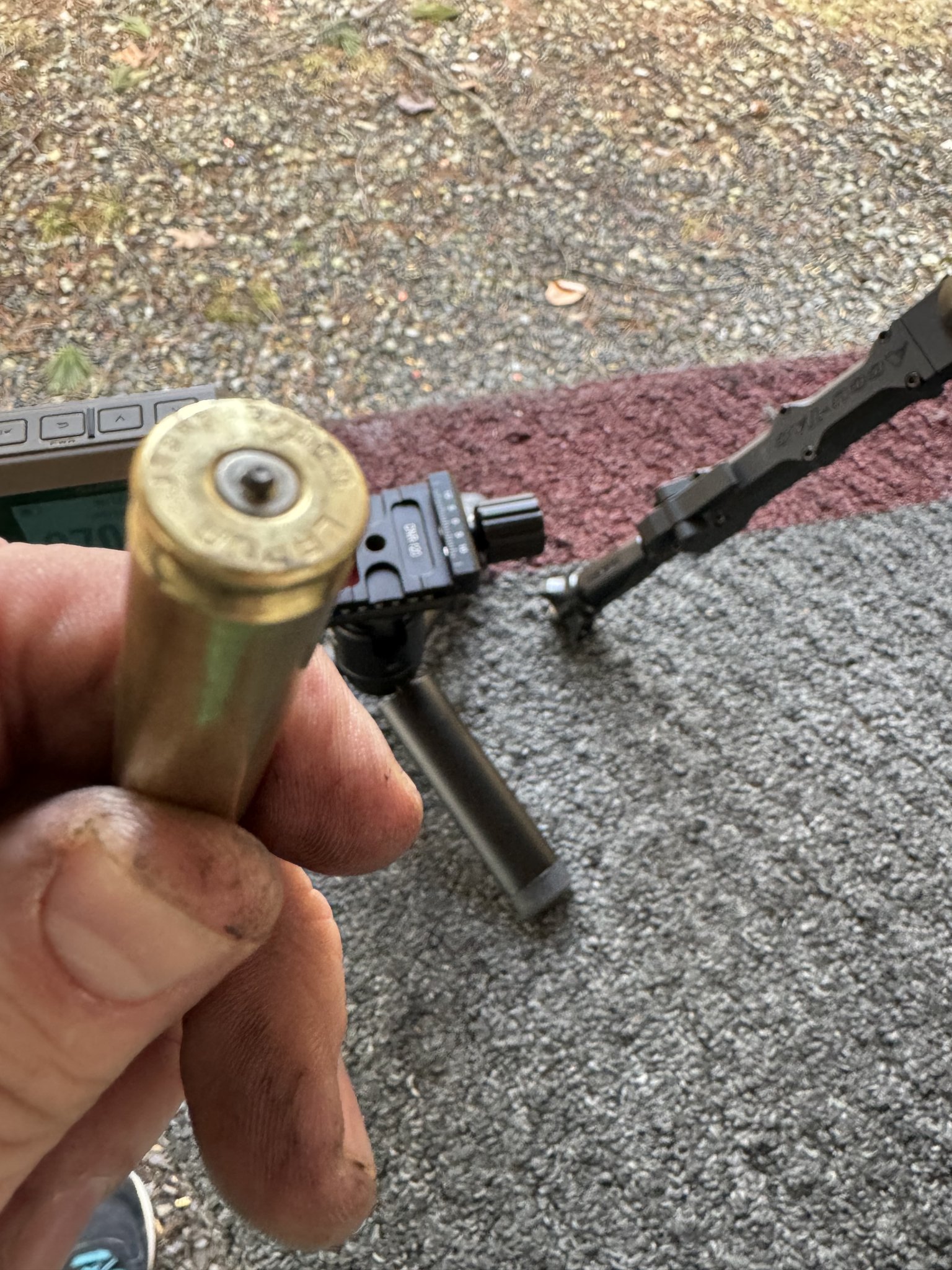

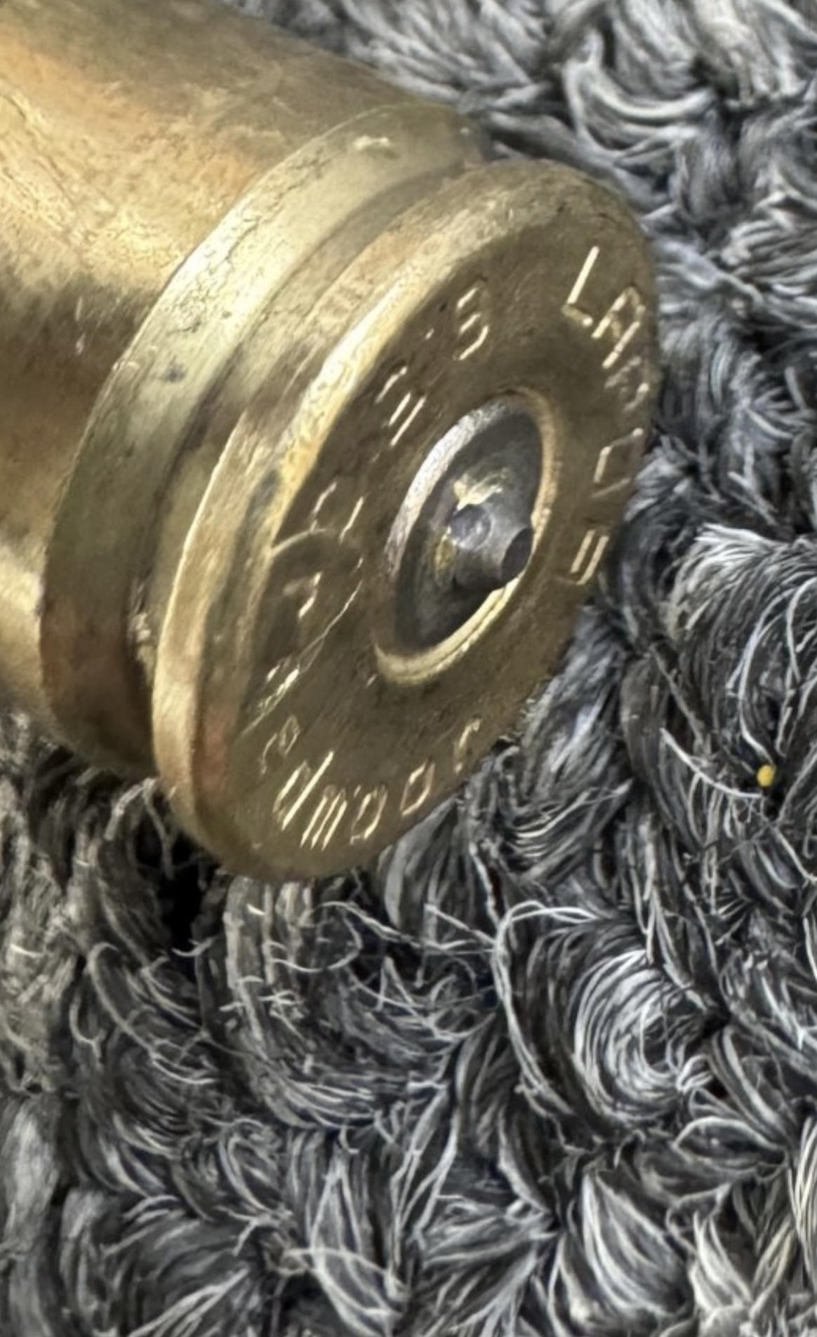

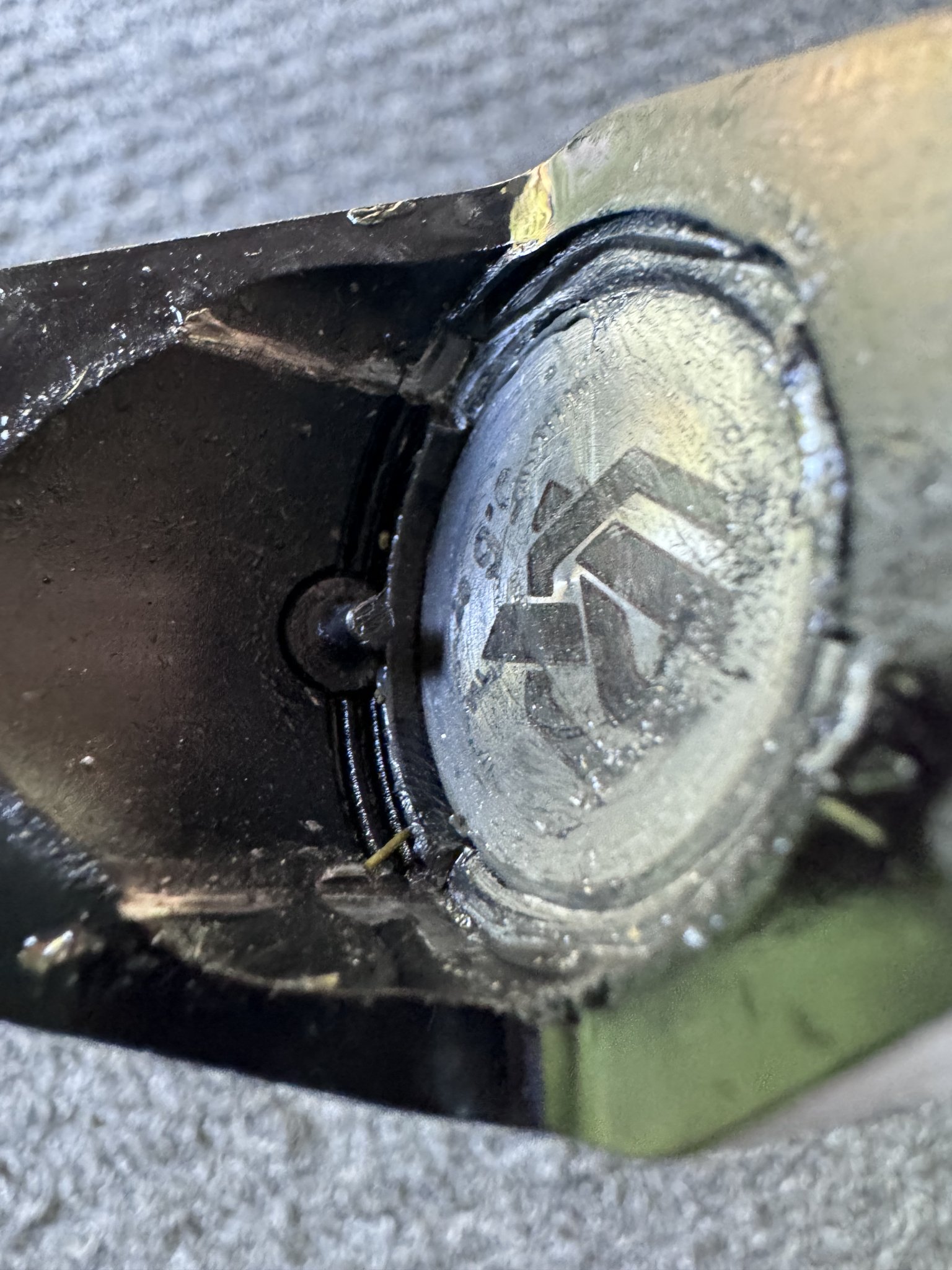

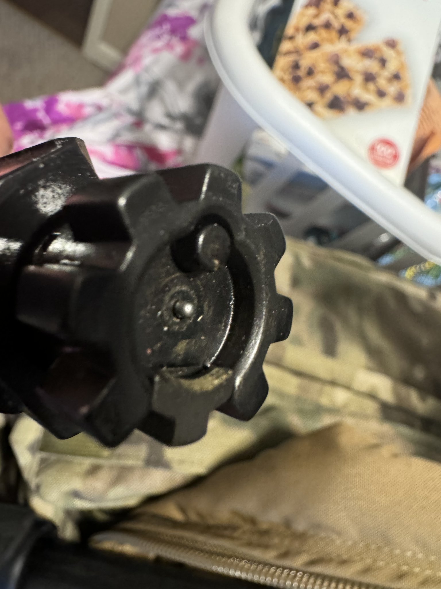

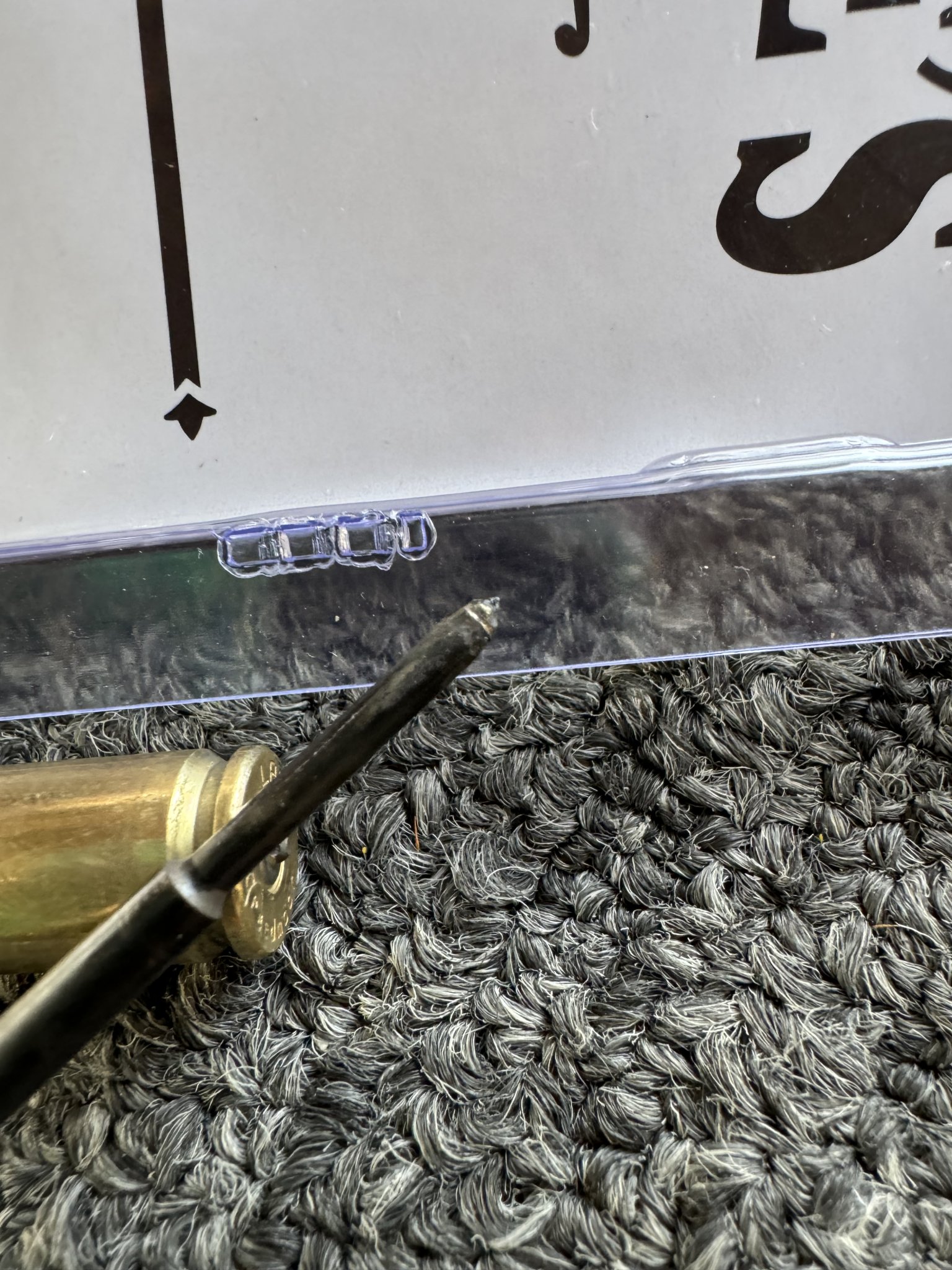

    My Seekins AR10 firing pin seems to get very dirty quickly shooting 25CM suppressed. It was cratering 210M primers also. I bought a V Seven titanium pin and it broke off in several primers today. Not sure what’s causing this. Any help appreciated.
    Can you accurately measure the bolt face firing pin orifice? It would also help to have the firing pin tip diameter, measured at around 0.050" from the end, if you can remove it from the primer.
    I can give it a shot with my Mitutoyo’s.
    Additional info should include I don’t have any issues with the same BCG and same primers in my .308 upper with Varget and Bergers or in 8.6 Blk upper with 300gr SMK and A1680. All Seekins. The 25CM upper did not always crater primers. I didn’t change reloading formula just seemed like it started one trip to the range, prompting buying the new firing pin after reading that may be the issue.
    You sure that's the pin and not the primer anvil blown through the cup?
    I bet you’re correct. It doesn’t make sense that 4 cases all look the same (just like your picture) because there couldn’t be enough metal lost from the firing pin to leave that much metal in every primer. It would be too short to even make it through the bolt orifice. Is that from a pierced primer?

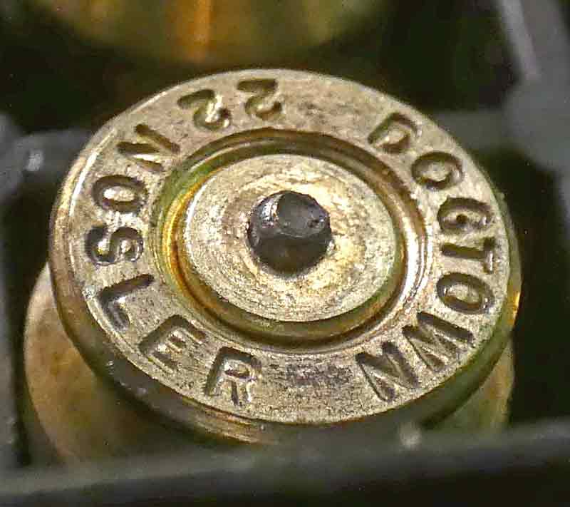

    Notice that the case in my pic, the dreaded 22 Nolser, doesn't show signs of pressure other that the pierced primer. Gas port stripped some copper from 88 ELDs and little pressure spike from bullet hitting port blew primer. Did a few before I noticed brass.

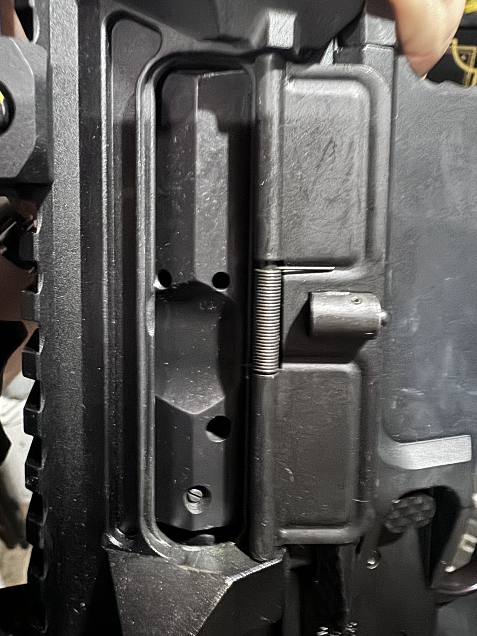

    Are you using a HP bolt typically found in 6.5 CM AR10s? If not, that is likely your fix.
    It explains why it doesn't happen in your 308 and it's exactly what happens in many 6.5 CM AR10s (or even some bolt guns) that have the firing pin hole that's too large for the cartridge.

    Edit. I am still using the JP HP Enhances bolt in the Seekins carrier. Firing pin 0.0580” at tip.
    0.0580” at the tip. It’s got some carbon fouling although I wiped it down. Maybe that’s the 0.008”

    The V7 got chewed up at the tip when this all started. That’s the picture above probably. I’m still having the issue even after changing the firing pin.
    The Seekins or V7 never would have been able to protrude and hit the primer if the bolt had the small firing pin opening. The JP HP bolt comes with its own firing pin because of this.
    Id double check to make sure you have the JP HP bolt or just the JP enhanced.

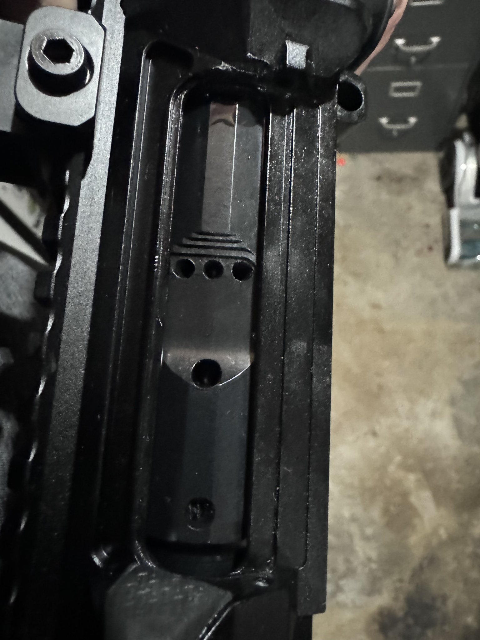

    I found the order in my email from 2021. It is a JP enhanced bolt and not HP Enhanced. I didn’t realize at the time. Thanks. I’ll start there by getting a proper one and proper JP HP enhanced pin. Also, several engineers at Federal are stumped and said they’ve never seen the anvil come through like this. They have requested the used cases and old titanium V7 pin to evaluate. I thought that was pretty nice of them.

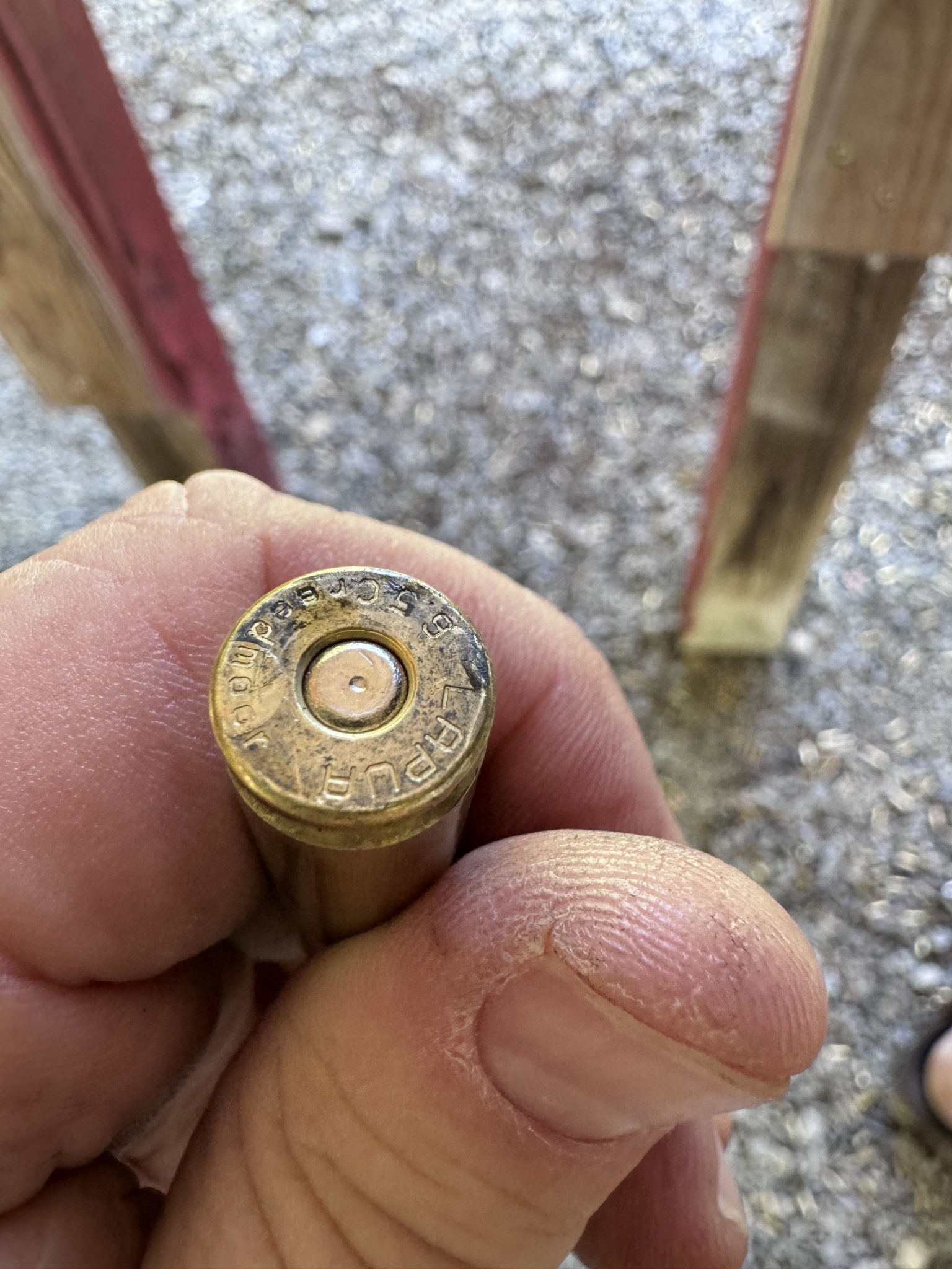

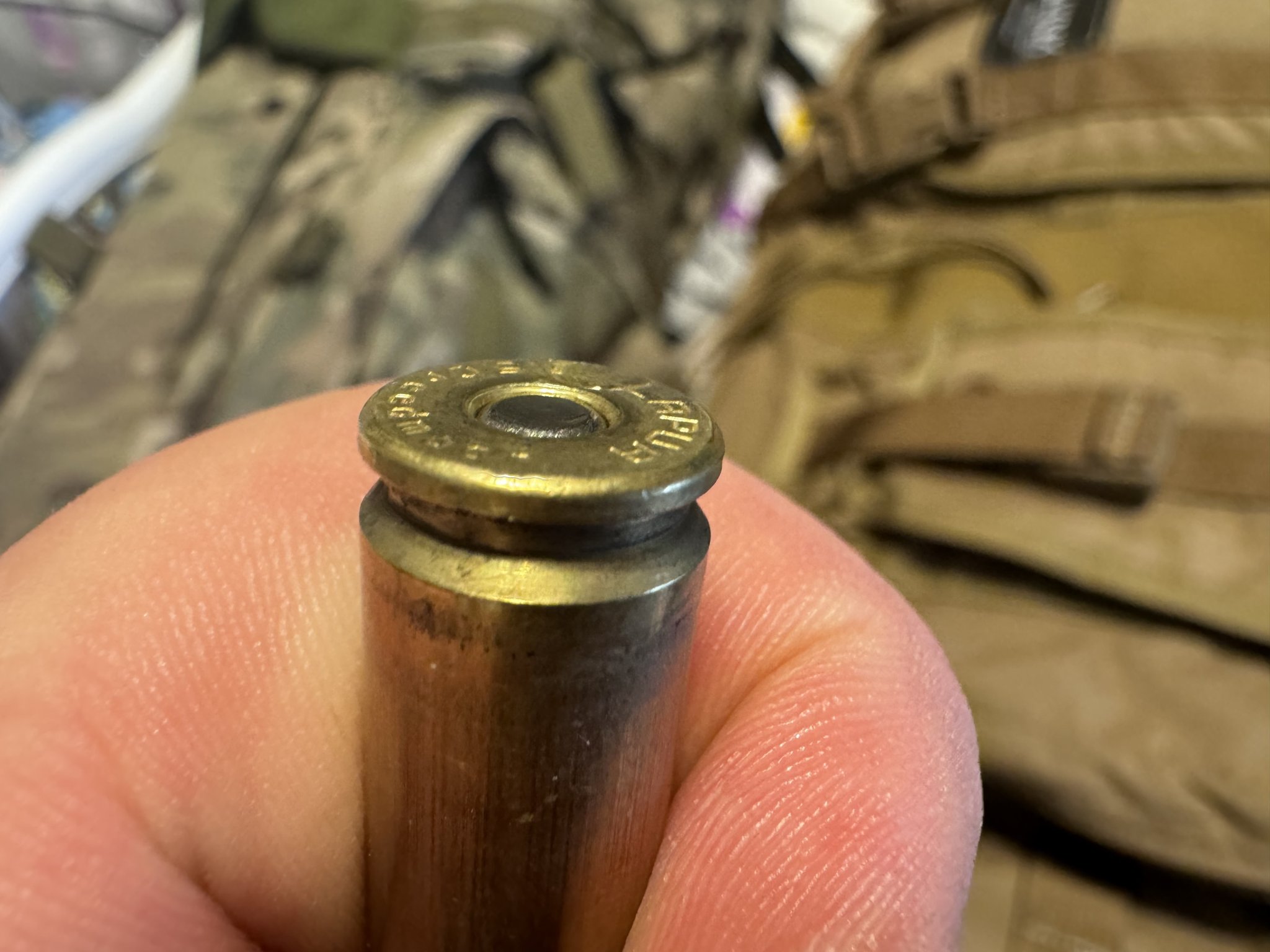

    Also, after reading the rest of the thread, you have at least two ejector marks on your case head (post 24). Honestly, it looks like three.
    How hot is that load?

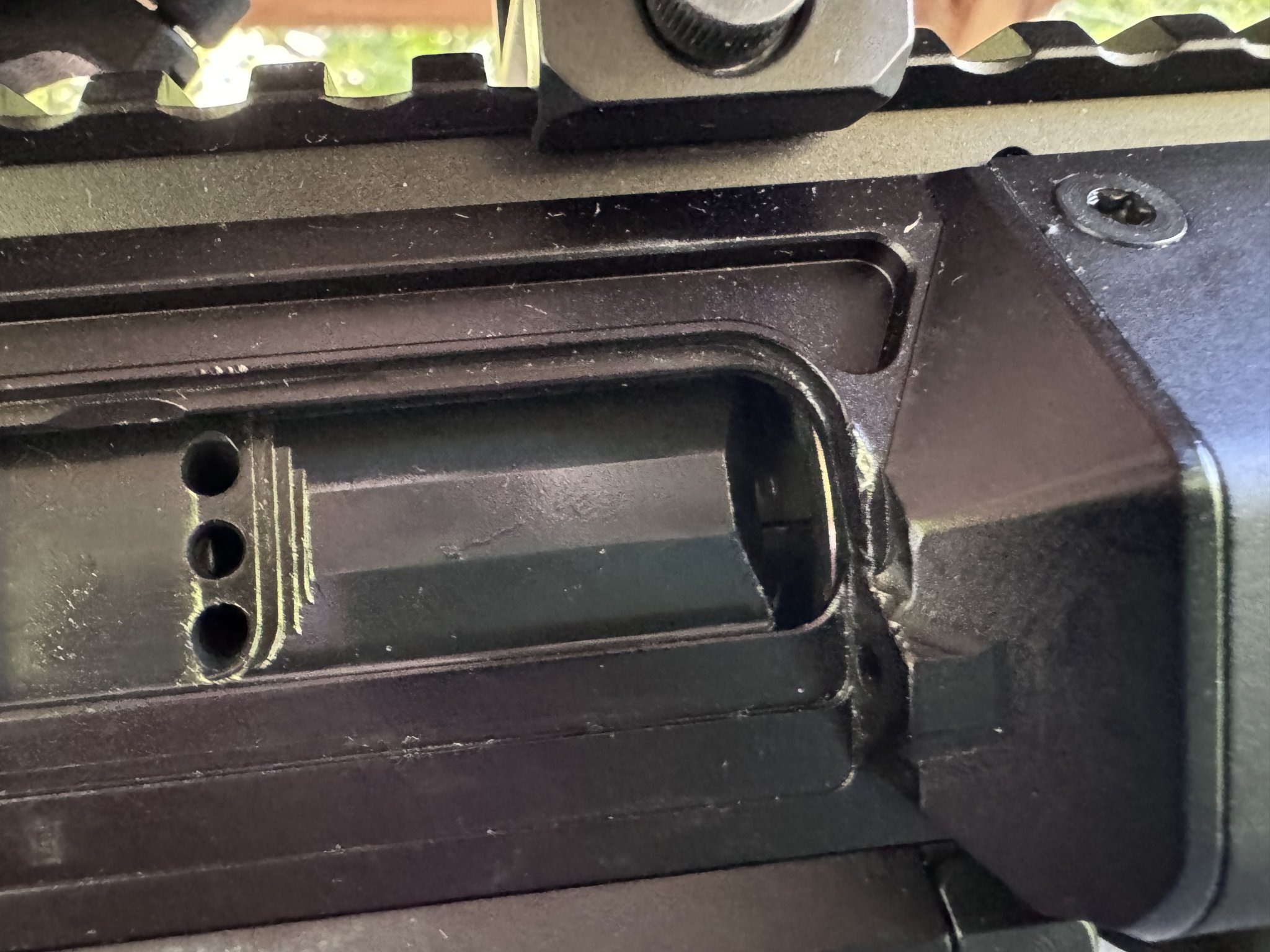

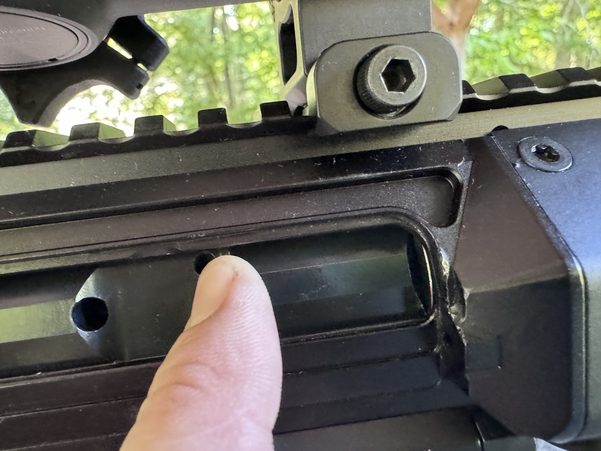

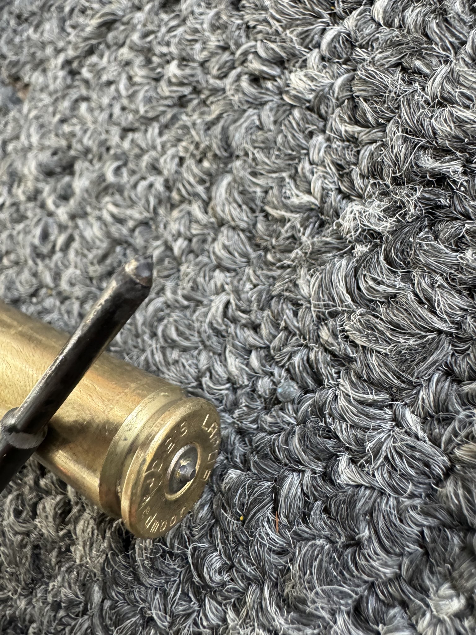

    So, this was the issue. Noticed the carrier not al the way forward and I could physically move it back and forth 1/8” or so.
    Then noticed the buffer was not coming all the way forward to the detent pin. It was catching on some metal that had somehow created a catch.
    Also then the pin had sheared down as well so replacing that and the buffer tube.

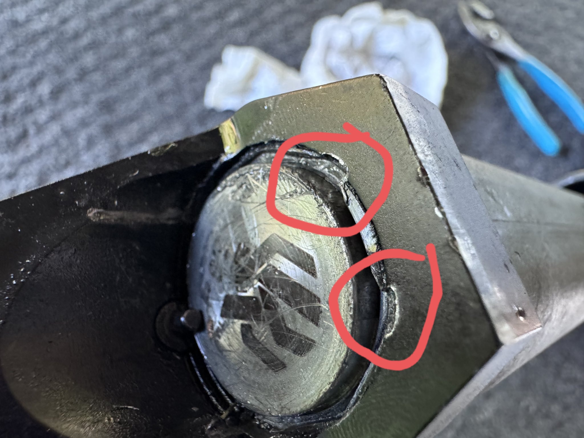

    Check your buffer/tube/spring combo. Something isn't right length-wise and is allowing your carrier to travel too far into the tube. The deformation circled is the carrier's bearing surface contacting the lower. Its likely what caused that burr the buffer caught on. It can also destroy your bolt catch over time because the BCG and buffer have more forward momentum before the bolt catch stops it.
    Typically it's caused by mismatched buffer/buffer tube or a buffer that has a stop that's deformed or broken down.
    Reactions: bfoosh006
    Thanks for the info. It’s almost certainly the 2.5” KVP 5.6 oz buffer in an A2 rifle tube. For carbine I see now. 🤦‍♂️
