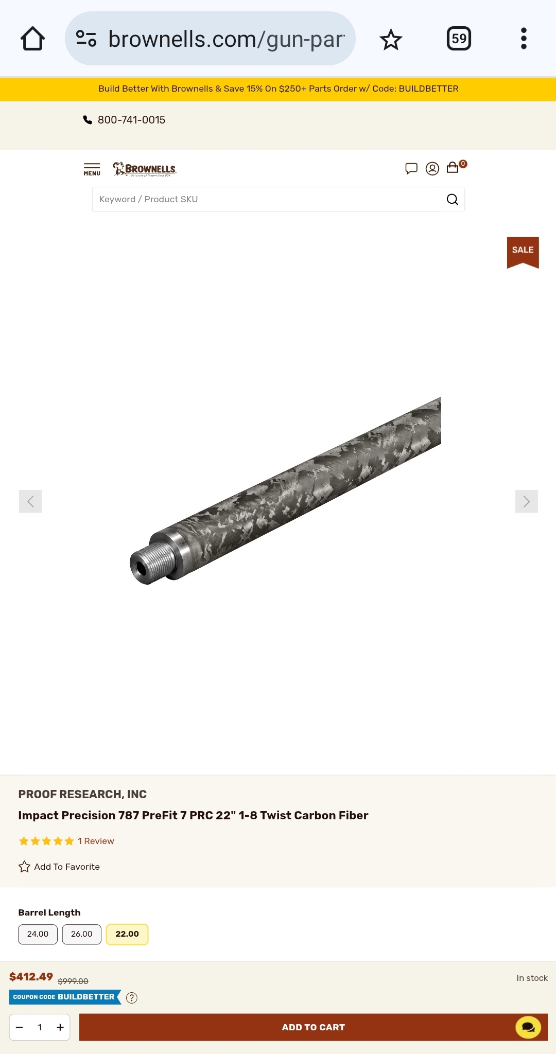

Looking for some knowledgeable impact people. Was eye balling the 7prc proof prefit barrels on Brownells.com for $350 shipped and trying to find out what the scoop is on the 787R.

I’m seeing a proof barrel for $480 on there but no other barrels. Is that what you’re looking at?if so, that’s an unreal deal and I would recommend that.
Coupons for 15% off and free shipping.
I’ve talked to Tate at impact before when I had my 787.
The 787 is just more robust and able to take the lapua bolts as mentioned earlier with the larger diameter bolt.
The 777 did not replace the 787, however they don’t make very many 787s anymore because it wasn’t a big seller for them (compared to the 737 respectively), so they came out with the 777 as a general long action option for people who didn’t need such a majorly stout action.
You’ll see deals on barrels prefit for it simply because they’re not flying off the shelves due to a limited number of people with that action. Definitely an absolute steal and I would do that as I love the 787 action and it would be great for a hunting rifle that’ll never fail.
