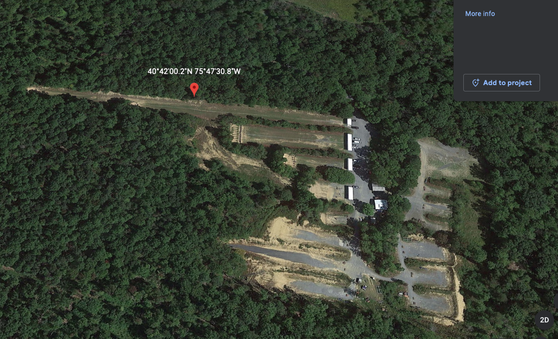

Hello,
My local range has a 200/300 yard range. Current rules require targets to be placed at the berms. The reason I’ve been given is to avoid rounds skipping past the 300 berm.
I want to convince them to allow intermediate targets for 22LR shooting. I’d like to be able to provide some supporting facts with my request. Basically, I don’t think a 22lr round has enough energy, especially at the downward angle for distances beyond 150 yards, is enough to skip over the 300 yard berm let alone all of the trees beyond the berm.
I’ve done some searching, but haven’t found anything I thought was useful. If anyone has anything they think would be useful, I’d appreciate a point in the right direction.
I can’t post an image of the range, it’s too big of a file. But here is a link to a google maps pin on the 300 yard range:
Dropped pin

Ok, before I respond in detail, for full disclosure I am a life member at this specific club and joined back in 1981 as part of the jr rifle team. Was active until I moved out of state in December 2009.
The 200/300 yd range has target backstop berms at 200 and 300 yards. It is a relatively narrow range.
The issue with intermediate targets on this range is due to safety. If my memory is correct, the range has a slight uphill grade. The ground has a high shale / rock content and as everyone knows ricochets are anything but predictable. It may just be a .22 but they are dangerous to 1.5 miles as listed.
With that in mind, take a look at the satellite view on google maps. Drawing a straight line through the center axis of the 200/300 yd range towards the north, what do you see past the 300 yd impact berm?
A house.
A .22 with a relatively low skip can clear the range. I have shot on many ranges across the United States - in excess of 500k rounds, and I can honestly say I would deny intermediate targets in this situation.
Now, if a temporary/ movable steel enclosed trap type backstop was fabricated - it may be a possible solution. Not a cheap solution nor easy to move, but at least a suggestion.

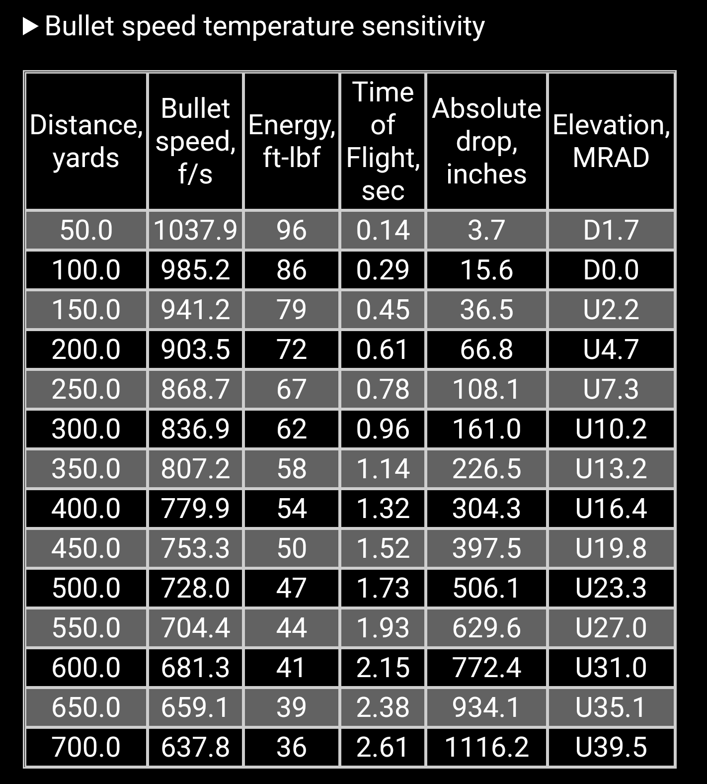

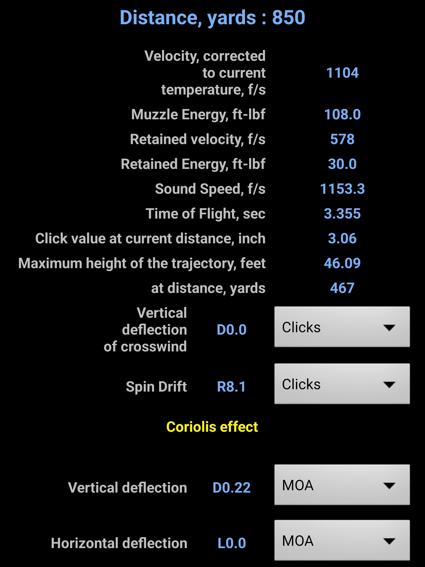

Considering the house 850 yards from the firing line. What angle up is required to get a round out that far (JBM can give me that)? Now, does a round bouncing off the ground at 250 have the energy to go that far? And can it bounce at the angle needed to do that? That’s my challenge - to prove that out either way.
My SK Long Range at 700 yards has a 1113.8 absolute drop in inches, or about 93 feet. Strelok wont let me key in 850 in the data table to see the drop for your distance
Kestrel is telling me to dial 53.8 mils for a target at 850. Even with my set up, if I max out my dial at 22 mils (60 moa scope base), I would still have to hold over 31.8 mils to attempt to hit that target. My reticle allows me to hold 14 mils.
I would probably need a Charlie Tarac or some other prism to be able to get that elevation for 850 yards with my scope.
You would have to be purposely malicious or really reckless to point the barrel that far up to overshoot the berm at such angle.

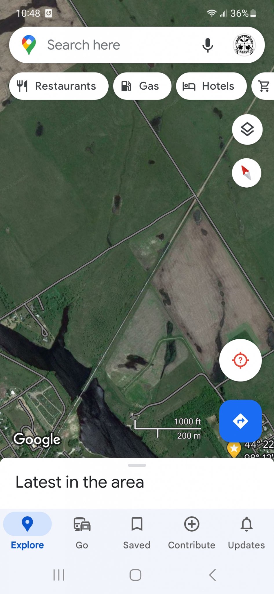

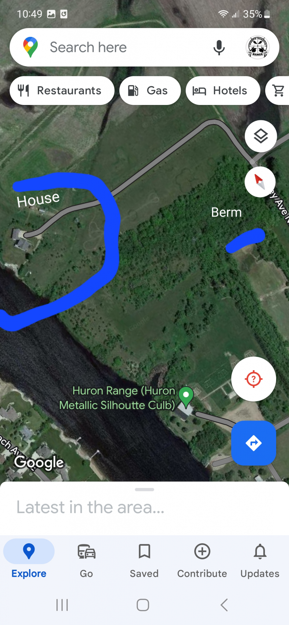

Below is a pin to our 600 yard range. If you look to the right, you'll see a farmhouse. The club now owns the farm after settlement with the owners who claimed rounds were hitting their dwelling. The berm at our 600 is I believe 90' one.
Dropped pin

If you use the single target menu in Strelok you can click the icon that looks like a target with a note pad, it will give more details including max ord, remaining velocity etc. To go past 850 on the chart click the gear icon there and change your end distance.
ETA:
2658.7" of absolute drop is what I get for SK Std +
78.28 ft max ord @ 499 yards
365 fps remaining velocity, 12 ft/lb energy

I like this idea. Use JBM to show that a minimum target height from 50 to 190 yards results in an impact on the berm at 200. Repeat for 200 to 300.
I think I’d have to run the numbers for a spread of subsonic to some hyper velocity 22LR. Maybe just stipulate that 22 shorts are not allowed?
Let’s say I run the numbers for a 6 inch target (very generous for 200 yards, but no one believes it’s possible to hit a target that size beyond 100 yards right now), what is a reasonable miss under the target? 6 inches? 12 inches? Missing to the side or over top shouldn’t be an issue.
I think I’m talking myself into this being a feature that requires some sort of pre-approval. At least show the RSO that you have data for the distance and it roughly makes sense. (We really should do this for every one at 300. We have a lot of hunters refusing to believe their 308 drop is more than 4 inches and they skip rounds into the berm. See it every fall.)
As I type this, I realize I need to be very careful in how I present it. If I’m not careful, all I’m going to accomplish is to show that 22LR is not safe at all on these ranges. I don’t want to go backwards and get restricted to the 100 yard range. The bottom line is that no one can guarantee that a shooter will always remember to dial or hold over the target. Or lose track of where they are in rotations for elevation. That’s going to happen regardless of where the target is relative to the berm. So I need to propose a safe method without making it seem like what is happening today is unsafe. That feels like a really fine line at the moment.

Hello,
Dropped pin
Thanks,

A couple of thoughts on your question...
How far back does the club property line go behind the berm? In Google Earth, there is quite a distance from the berms to the nearest structure, with dense trees in between.
If you allow sighting in of high powered rifles on the same range, the "skipping" issues would be the same, but with a much more powerful round. Why would that be allowed but not allowed for .22LR rounds? Not to be argumentative, but to be comparative.
Also, why not put a 4-5 ft berm at one intermediate distance, and use that (as a proposal to the Board)? You have a very tall berm in the back (30ft+?), and if you shoot targets in front of the intermediate berm, under normal conditions, this should work.
Now, how to deal with skipping rounds. The risk is already present with high powered rifles at the range, so with a .22LR, the risk would be lower, due to less energy of the round.
At any range, with any configuration, you run the risk of folks shooting in the air, or skipping rounds off the ground. You need to take appropriate precautions, and make sure shooters are informed of the risks of their actions. Otherwise, if you go down this path, you can rationalize why any range should be closed due to the risk of rounds leaving the property (already, not just with the intermediate berms for .22LR shooting).
The house, if I remember correctly is about 700 yards past the berm at 300 yards on an uphill grade from the range.
The current target frames are immediately in front of the impact berms at 200 and 300 yards. Midrange shooting is not allowed. Unless there is an accidental discharge, by having the impact berm immediately behind the target there is no chance for a round leaving the range.
It boils down to the fact that a mid-range shooting rule had to be implemented due to the house being built behind the 200/300 yard backstops.
From the club’s perspective, you are asking to risk the outdoor ranges or it’s possible existence with a potential significant capital investment with no realistic ROI. Unless you convince the Board that additional midrange berms or sizable movable bullet traps are worth the investment and can be SAFELY implemented, it is an uphill challenge.
I would think that the home owner had to know that placing their structure that close to an active rifle range was a potential risk. Someone at some point brought it to their attention. County Ordnances should have addressed its building (or the ranges...whichever came first) to keep its populace safe.
We had a guy build his fancy place under 300yds from the long long standing rifle ranges rear most berm. He had to sign a bunch to clear it with the city.
^Note the scale at the bottom.
I've updated the Google Earth screen shot to include an estimate of the distance from the end of the 300 yard berm to the first structure in the line of shooting... Looks like that structure is about 565 yards past the end of the berm, with dense trees between the two locations.
FYI only.
