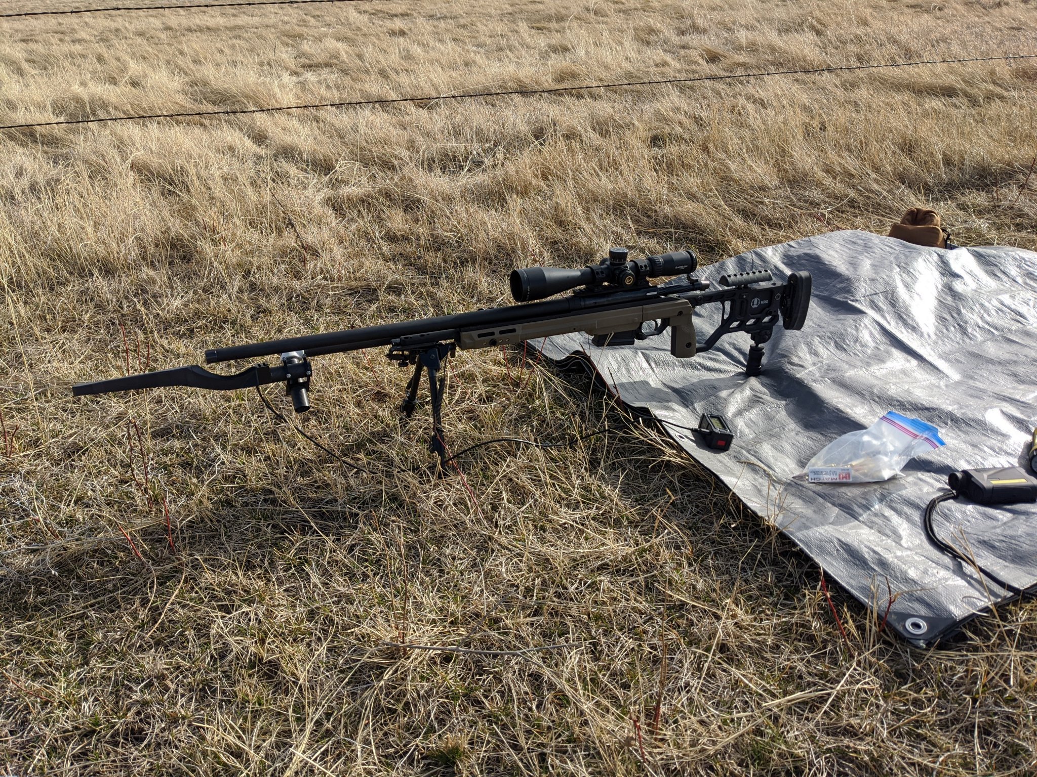

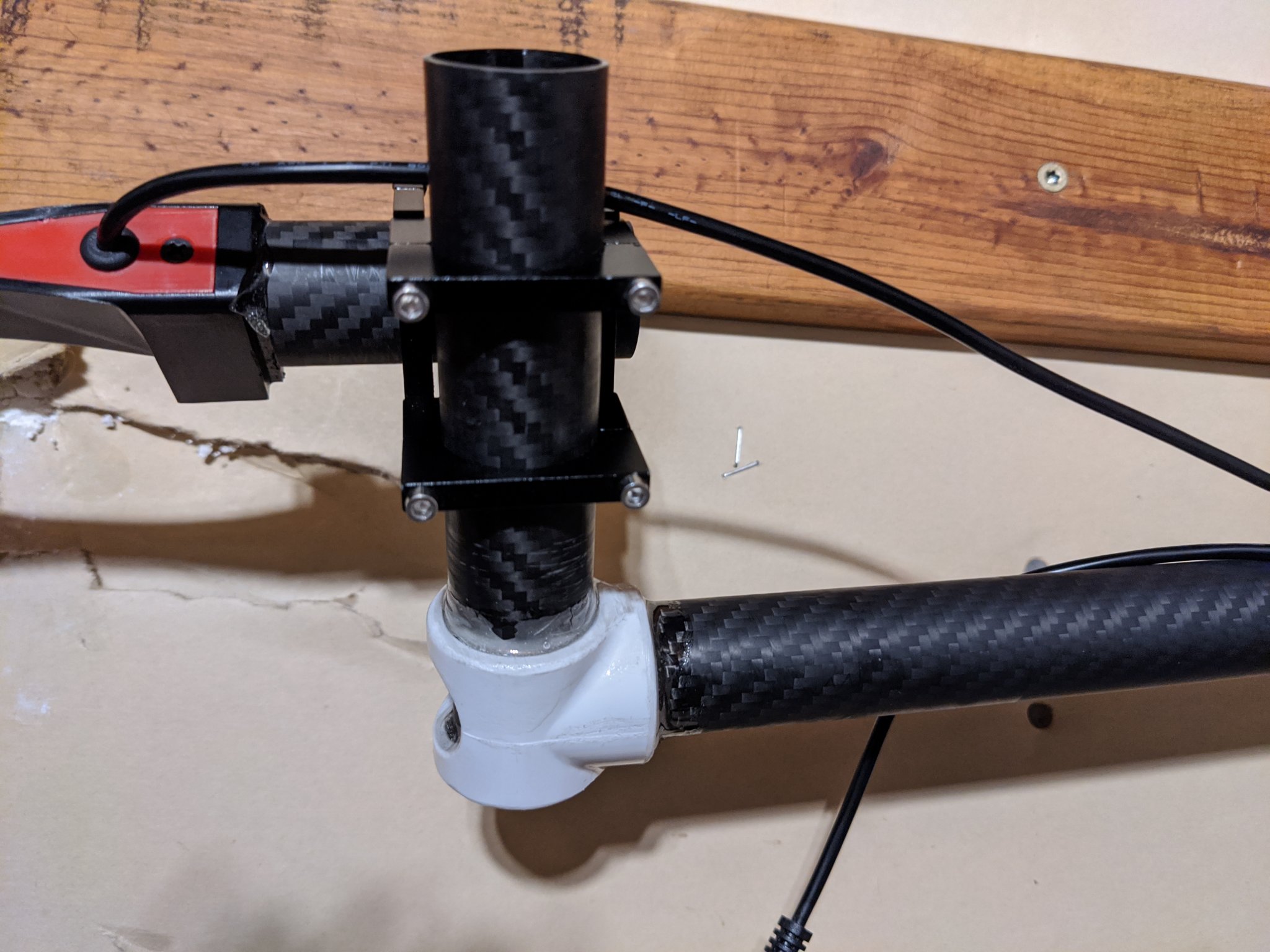

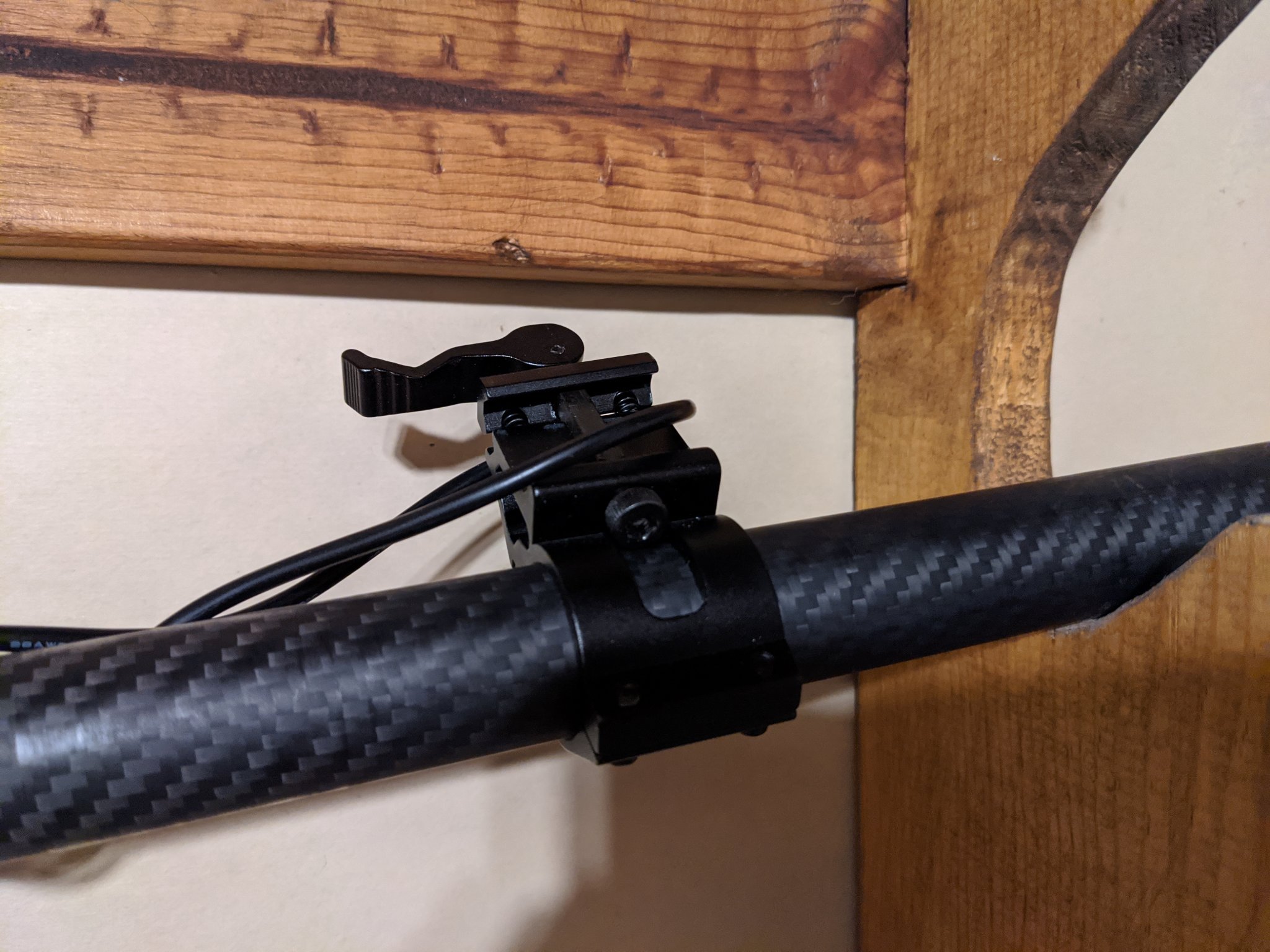

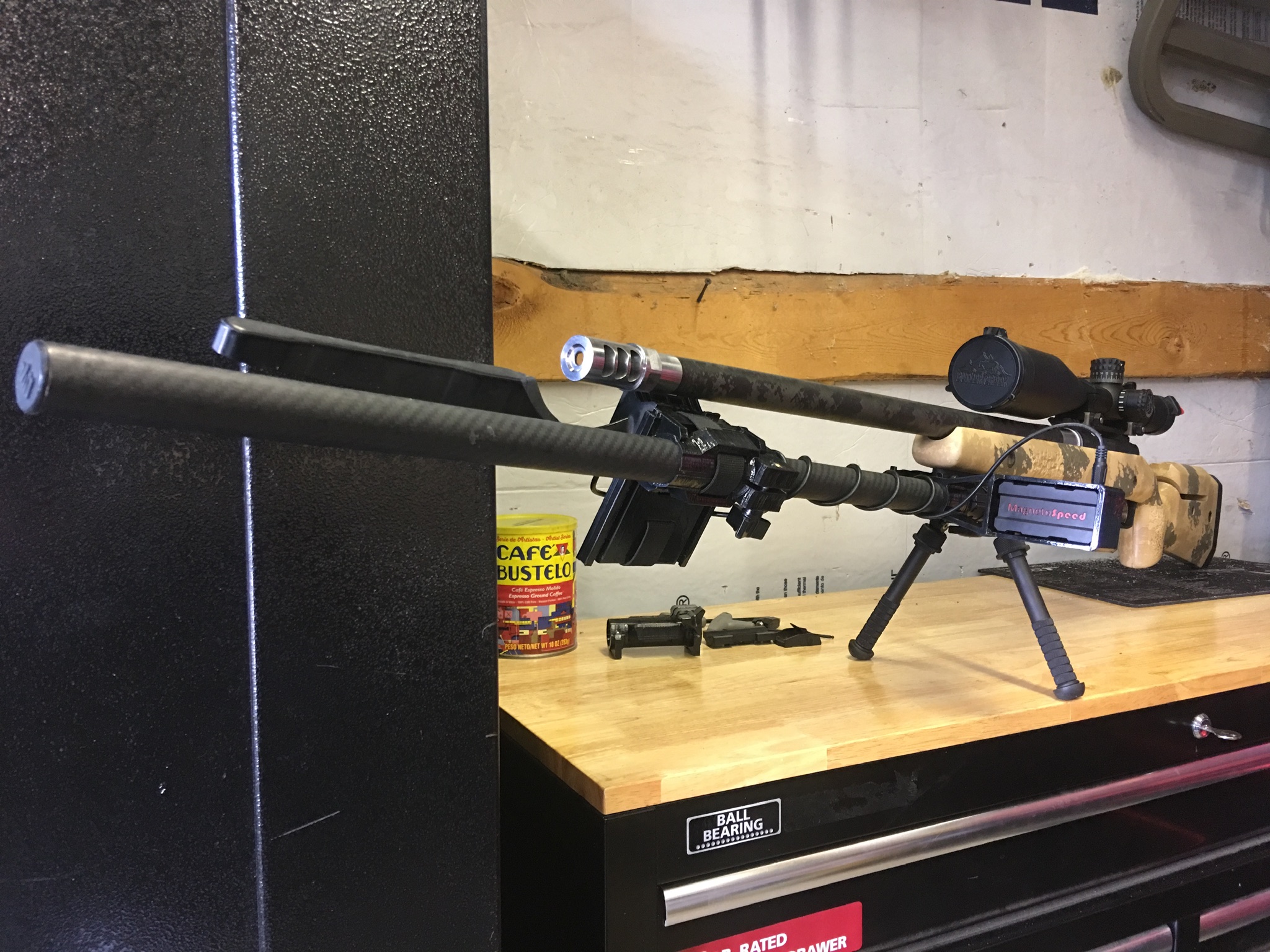

Pretty much bought everything on Amazon. The PVC t you can get at any hardware store and I dremelled it out and epoxied it together. Also, bought a brand new magnetospeed and cut up the mount and glued it into a short piece of CF.
