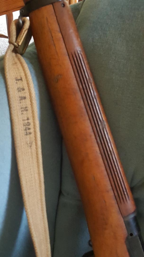

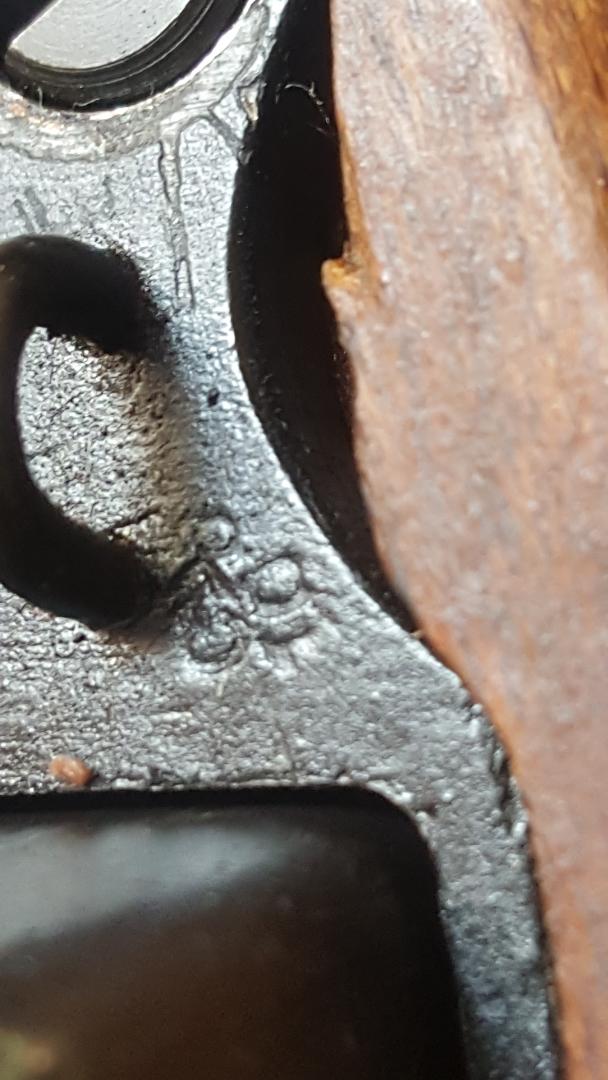

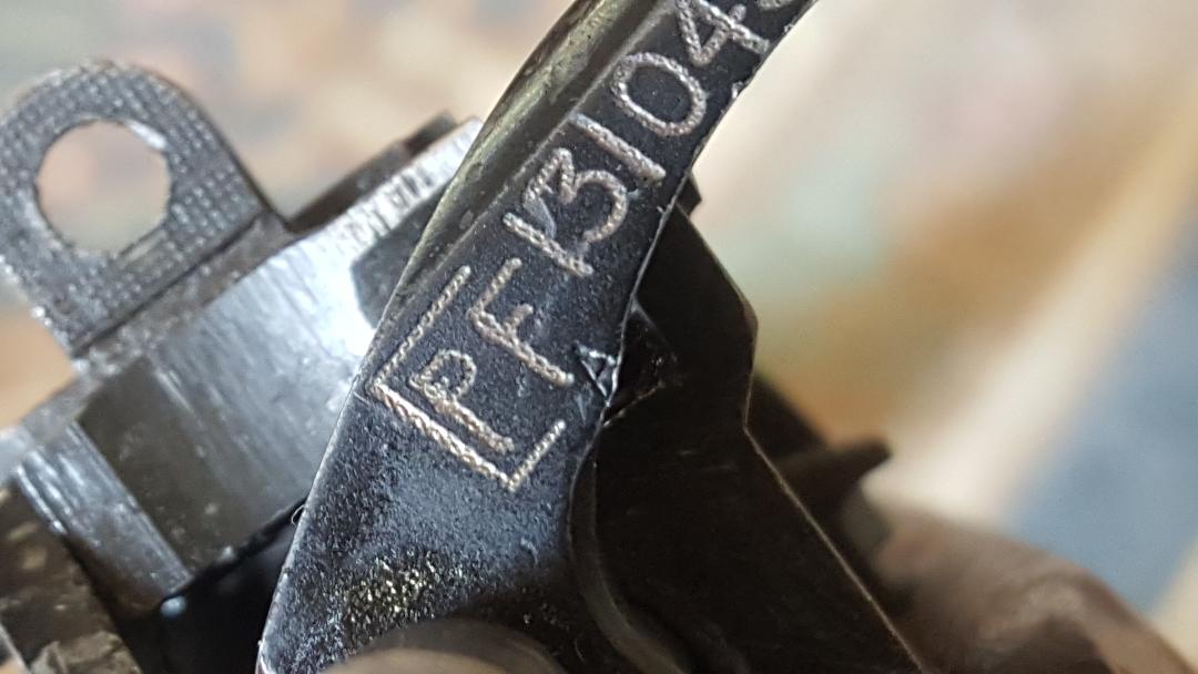

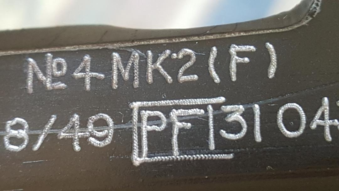

I have a No4 Mk2(F) that I was hoping someone could give me some history on. I know it was built in 1949 and has numbers matching receiver, bolt and stock. The mag is not numbered. It appears to have been in conflict somewhere as the foregrip of the stock is somewhat banged up and the bore looks battle worn. The first two inches or so of rifling past the throat appears pretty flat. I have scoped the bore but have no way to take pics of that. It functions properly but I would not say it is accurate with factory ammo. Early research told me that there was alot of variance in bore diameter and my dial calipers tell me this bore measures .308 inches. I have reloading dies and loaded up some 308 cal 175gr SMKs by pulling the expander mandrel out of the 303 sizer die to give better neck tension on the smaller bullets, and it shot quite a bit better but not great. The bore copper fouls the worst I've experienced. I spent hours cleaning the bore with various cleaning solutions including multiple applications of Sweets. Once the copper was gone, I then polished the bore repeatedly with JB Bore Bright. Now that the bore seems to be ultra clean I'm thinking about using Tubb Final Finish bullets and a fresh crown to see if I can improve accuracy. Not trying to make a precision rifle out of it but it came to me as a 8 MOA rifle or worse. As Larry Potterfield says, "Only accurate rifles are interesting rifles."
Its serial numbered PF131XXX. I've included pics in hopes that someone might be able to tell me country of manufacture, and maybe where it fought. I see no markings on the gun anywhere indicating origin including the "wrist band". Maybe you guys can help??

Yours was made at Fazakerly in Great Britain sometime after 1951... It's an Irish contract rifle based on the prefix and serial number range (PF 309348 - PF 359347).
So how can you consider 131xxx in the range of 309xxx to 359xxx? Not arguing just looking to get educated.
My apologies, I misread the first number as part of the stamp...
Your’s would have been from the first batch (PF 118000 - PF 217999), probably made in 1949. Therefore, not a contract rifle and meant for the British Army proper.
Reactions: camocorvette
That makes more sense. Any way to tell where its been? Seems to have been shot alot. I read that the thin contour barrels were easily bent by bayonet use which may explain why my front sight needs to be drifted quite a bit.
Not really... The No1 MkIII’s had unit discs that could help narrow things down, but unless you could get your hands on and wanted to go thru old inventory unit records I don’t know how.
Never heard that about the bayonet... The barrels really aren’t that thin. They’re actually significantly heavier than the barrels on the No1 rifles and heavier than most other rifles of the era.

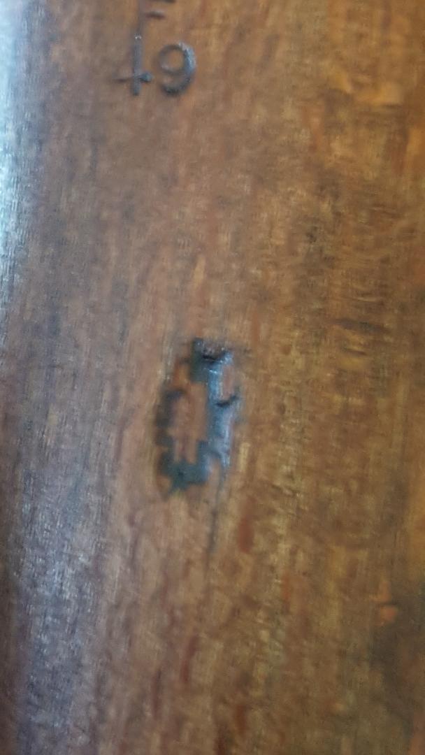

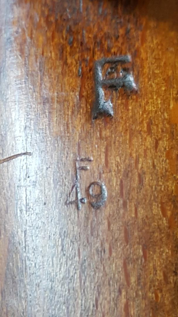

Evening from new Zealand. I collect Enfield so have a little bit of knowledge on them. The 8/49 marking is the month and year of manufacturing.

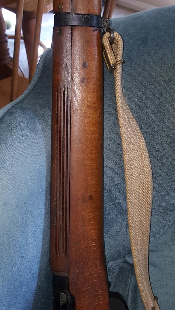

Have you investigated the bedding? These rifles can be very sensitive about the fitting of the forend. For starters, the barrel should bear down on the tip and should be free to move up with about four pounds of pressure. There's a lot of info about this on the interwebs. Milsurps.com is very good.

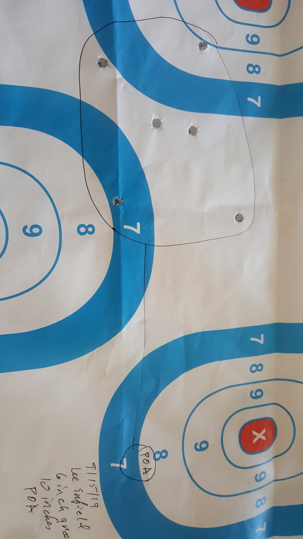

The first, and insanely biggest, problem is not using 311 projectiles. A No4 will hold a nice 4 inch group from prone sling at 100m using Sierra 174 grain SMK or Hornady (FB). ADI's 2209 with 44 grains gives a good load, although 2208 (Varget) is often preferred).
Using Sweets will cause more, not less, coppering. Use Butch's or Bore Tech and do not worry.
Get a nice single point sling set up, and hold tight on the centre of the seeing mass. And do not start trying to free float the barrel.
Before doing anything else, get some Sierra 174 Matchkings and try a few loads. My No4 has printed a 1.5" 5 shot group at 100 yards, which is probably the limits of my use of iron sights more than the rifle. It does have a Parker Hale diopter rear sight which helps. I have the 174s loaded to around 2450.

My initial firings of this rifle were with PPU 303 British ammo. Accuracy was no better than 6 to 8 Moa and it was shooting considerably to the right of poi. Copper fouling was terrible.
I purchased dies to see if handloads would work any better but they didn't. I then went back to the Lyman 48th Edition reloading manual and started from scratch. The manual indicated significant differences in bore diameter. I measured my diameter at several points within the Barrel and the largest measurement that I got was 308 in. I loaded the 303 British cases with 308 bullets and accuracy immediately improved. Copper fouling was still terrible so that's when I got aggressive about cleaning. I also reviewed several YouTube videos and one indicated that the rifle is designed to have upward pressure from the Fore grip but no contact with the grip on the top or sides. That's when I discovered significant pressure from the left side of the grip at the muzzle. In fact the left side of the barrel had a bit finish worn off. Below is a picture. The contact seemed to be coming from the metal at the end of the top foregrip so I removed some metal from this area and reattached the grip. I will try to get out to the range tomorrow and see how it shoots and report back. Thanks again for everyone's help.

Quick update - I shot the Enfield this weekend and it still shoots like crap. 6 inches or so with 6 rounds.. Gonna get it to the gunsmith to have it slugged and crowned, then will try some Tubb final finish bullets. Nothing to lose at this point.
