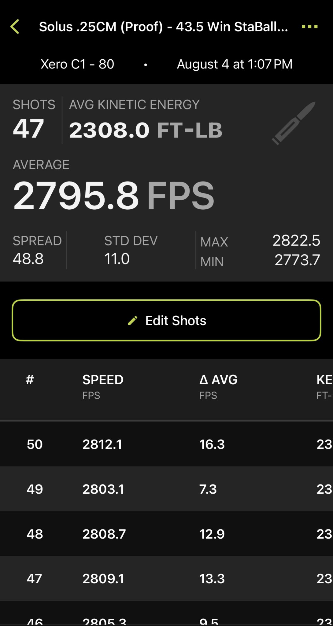

.25 Creedmoor is an awesome round with the Berger 133 Elite Hunters. I love mine. Zero recoil, and pushing 133's at 2,800 FPS MV from a 20" barrel is moving.

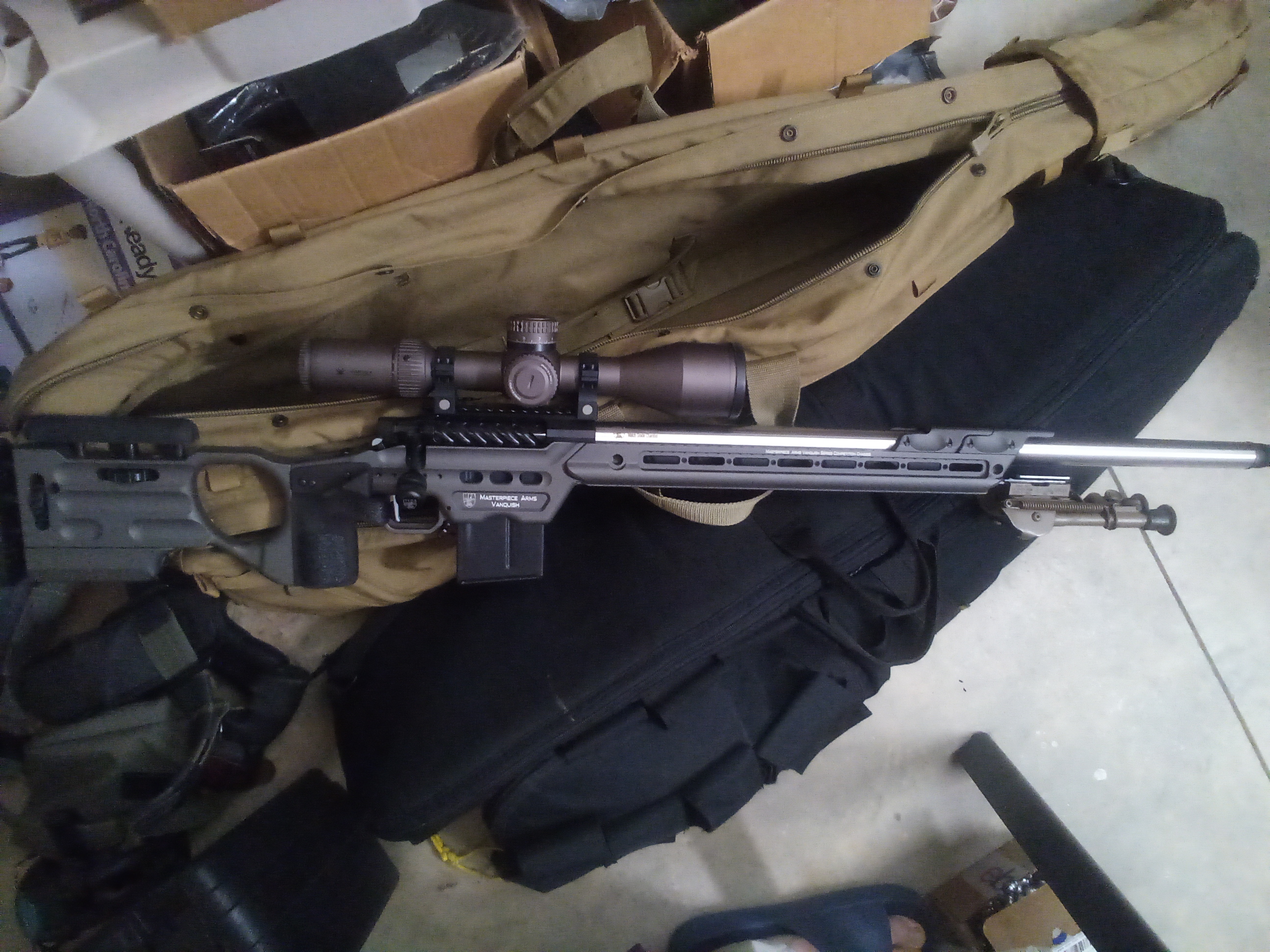

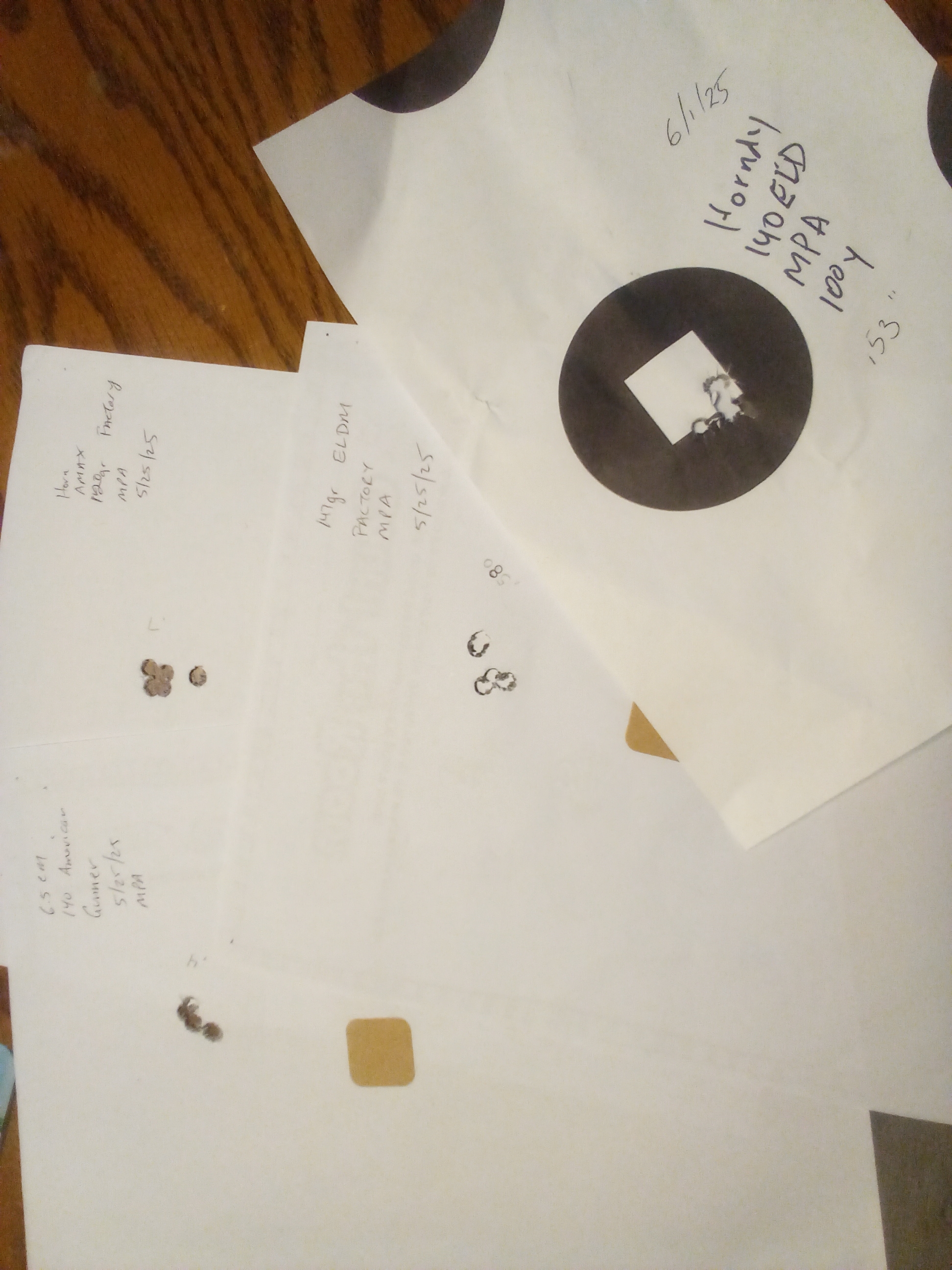

Update finally. I went with a MPA VanquishAndR 6.5cm. I ordered it Dec. 1 2024. They said it would be 4 months to build. I got the rifle delivered pretty much right at 16 weeks. Took me a week to pick up and another month to get scope, rings and ammo. Been busy with work and practicing mostly for pistol and 2 gun matches when I goto the range. Finally shot it last weekend and finished up this weekend.
So when I got it I wasn't too impressed. The bolt was not and still is not that smooth. I've run the bolt maybe 500 times, feels like a cerakote painted bolt. If I put too much pressure on the handle it will bind. Its better than a 700 or Ruger but my friend's savage was smoother and my 2 Tikkas were much smoother. Bolt lift was light and nice. The thumb wheel for comb and stock adjustment didn't feel good. One spun freely and the other barely had resistance on the detent. I took them apart and found one detent missing and the springs look like they were rough cut with pliers with bent open ends. I replaced both springs and ordered a ball bearing kit to replace the missing detent. The screw for the stock/chassis was not tight. One small screw on the side was crooked and not screwed down. Good thing is they didn't go in any further as it would have been cross threaded. The plastic grip panel was not trimmed very well. Looked like a free hand cut with a box cutter. The muzzle threads were relieved on the end so barrel shims will not center. Lastly the temp sticker on the barrel was coming off. It does not bend well to fit the contour of the barrel.
So for the good, the trigger is very nice. Perfect to me. Set at exactly 1 lbs. Tested it on electronic gauge breaks exactly 16 oz every time. I can get my finger on it with no problem and feel it without it going off. But when I want to fire I just think about it and it breaks. I ran a bore scope thru it as soon as I got it, chamber throat cut straight and bore looks very good, no pits, chatter, tears etc. Headspace was set to minimum. The rifle and magazine feed smoothly and reliably. And last and most important, how does it shoot? I fired 2 fouling shots at 25 yards to get on paper. Went straight to a 100 yards and was 2" high. I shot Hornady 120g amax, 140gr bthp American gunner, 140gr ELD and 147gr ELD. All factory ammo all 5 shot groups. There were no fliers no make up shots or cherry picked groups. Groups sizes were .7".4" .53" and .58". The barrel did not get any type of break in. The barrel only has 42 rounds thru it to date. BTW if I seem overly critical with my review, I was a full time general gunsmith for 9 years. I don't build guns anymore as I change professions as my family needs have changed. What does a large pizza and a gunsmith have in common? Neither can feed a family of 4 anymore. I apologize if this was hard to read, auto correct is screwing everything up and I'm older not keeping up with technology. Thanks for everyone's help.
Yeah I would not be impressed with what you described. But I have never seen a temp sticker on a barrel! Pretty sure I would not bother, kind of like using a pop up temp thingy on a turkey, not accurate and general waste of time.
