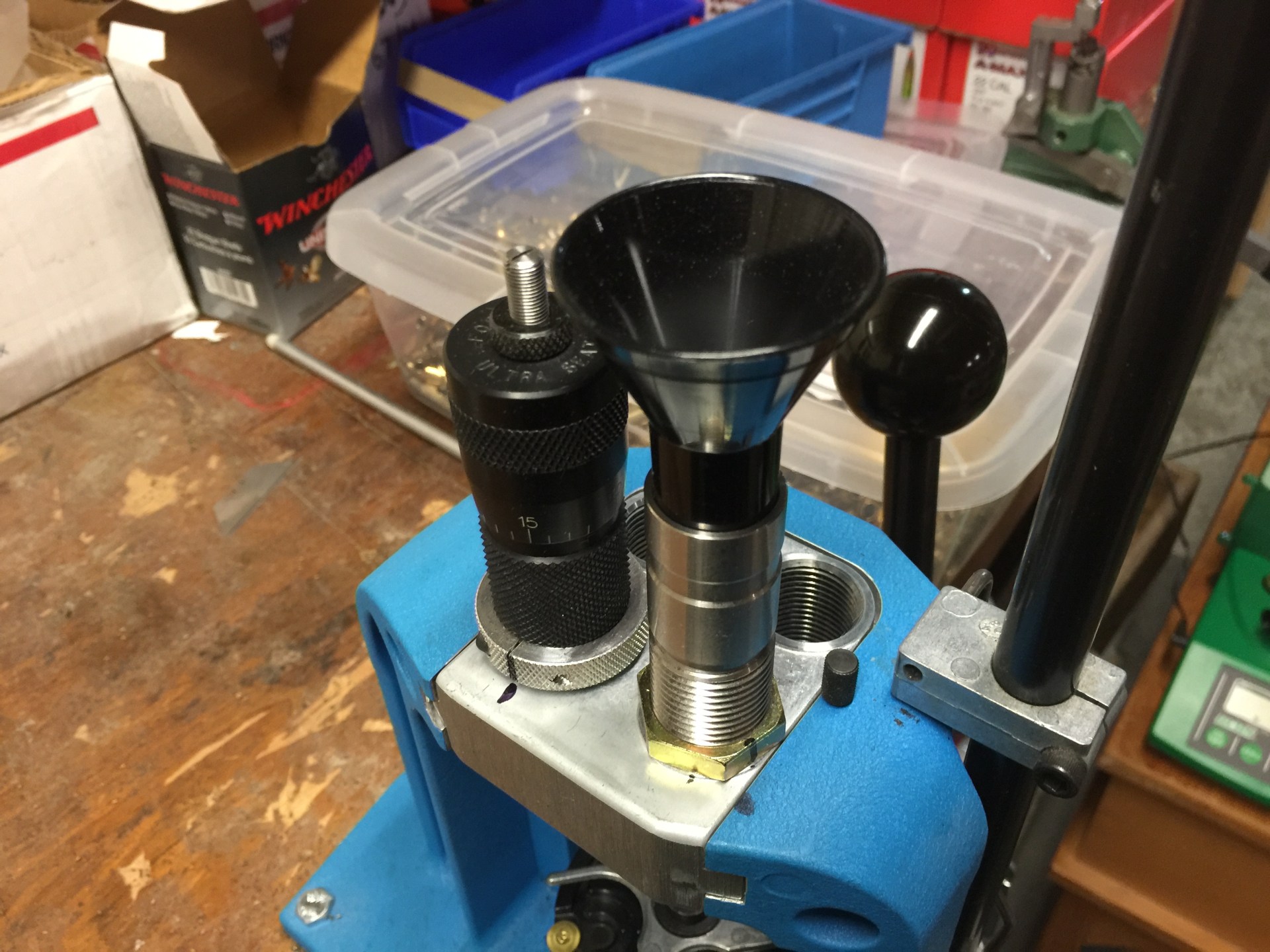

I assume you are doing something like the picture I have attached?
If you can't adjust the Lee one to work better, just get a Dillon one... it'll work.
