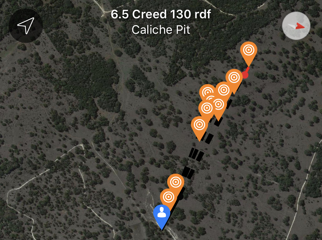

I put a kyl at 500 and 700 with random other steel from 400-800. I shoot the 500 kyl more than most everything else combined because it’s only 10 feet off the side of the road and it’s easy to get to so that’s also where I set my paper target board at. The 500 kyl is 5 plates from 12” down to 4” so it’s also a good challenge with plenty of space behind to spot a miss. My 700 kyl I have 6 plates from 18” down to 3” but it’s got some geography behind it that makes spotting misses tougher.
I bet you’ll move the stuff around several times as you add more steel and figure out what you shoot and what you don’t. I would put them all in the same general direction though just for ease, especially if you are adding shooting props.

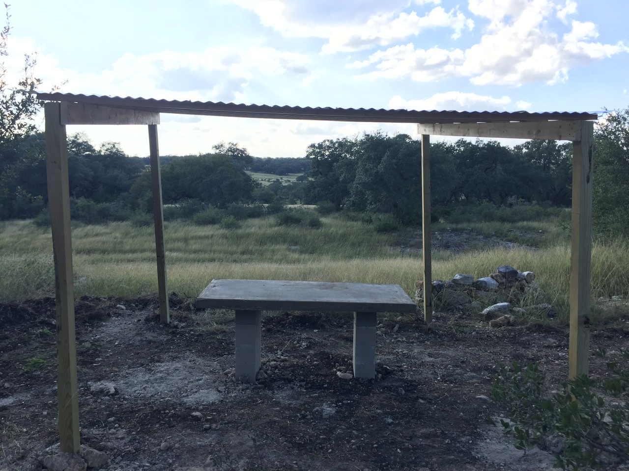

My favorite part is my bench and shade cover though. A little escape from the sun and rain so you can shoot in all conditions comfortably
