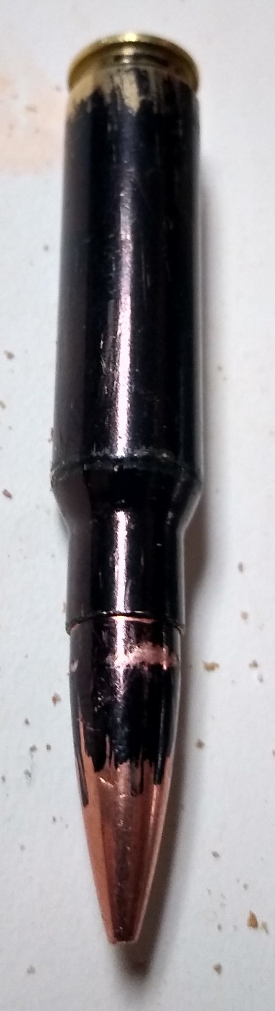

Background--using PPU 7.62 Nato Brass, once fired.
Lee Single Stage
FL resize 0.002 should setback measured. (Redding FL sizing die)
Trim 2.005
OAL 2.800 (Redding Micrometer Seating die)
168 gr Hornady BTHP
IMR 4064 41.5 starting load working up to 45gr.
No Over pressure--got fantastic SD/ES (first time single digits, 5 shot group)
Rifle Rem 700 Sendero (24 in bull barrel)
My problem--the Bolt is hard to close. in fact, sometimes its nigh impossible (I did not force it). Harder to close than open. Did some web-fu and marker'd up a round.
It looks like the bullet providing the resistance. This This is what i got and now I am mystified as to why it is the bullet (assuming on the lands, but I dunno) providing resistance
Need some help diagnosing and correcting. (I confirmed Factory ammo--no issue).

Does a piece of sized brass chamber?
I’m guessing from the pic yes.
There’s tools and methods to measure your chamber to see how far out the bullet can be.
That is where I’d look.
Measure a round and chamber it(in a safe manner:) ) then see if it’s shorter when you extract it.
Actually no. I pulled a bullet on a particularly bad round and still tough to close. Somehwo I F'd up sizing. /embarassed
