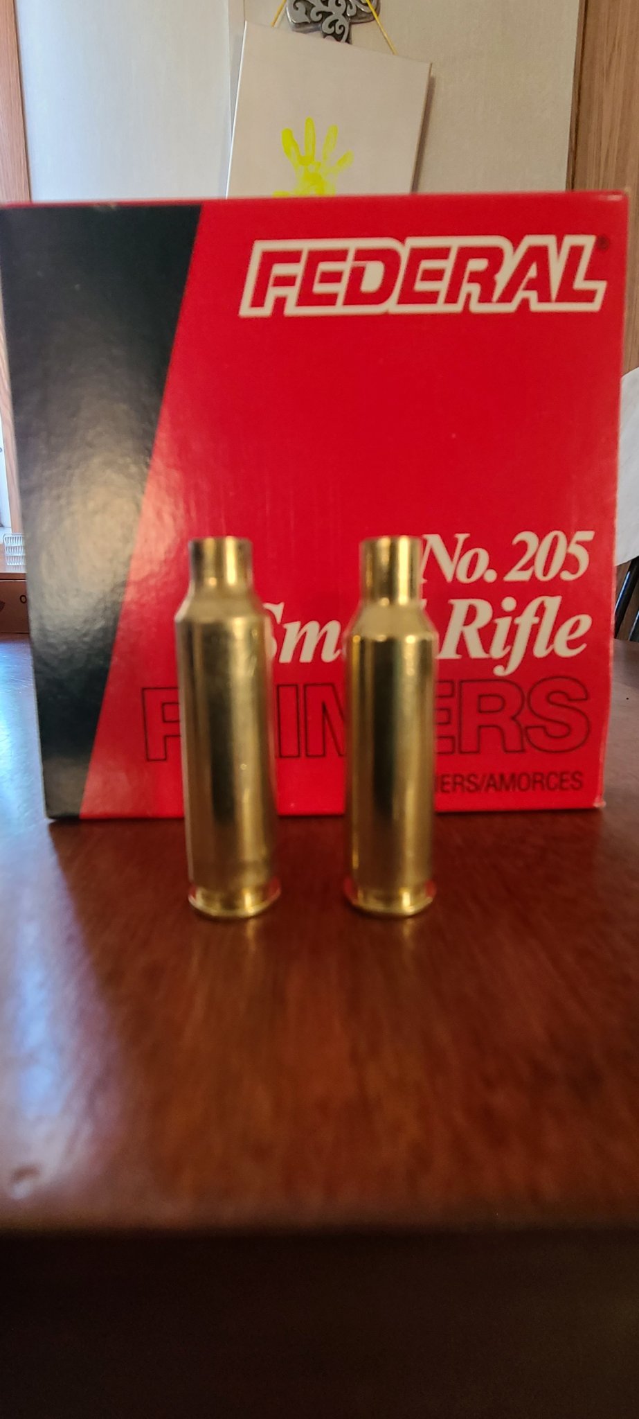

Help with round not going off....Bighorn SR3 & prefit barrel 224 Valkyrie

I've never set up a barrel nut before. I do have go/ no go gages. I believe the headspace is set per the gages.
I built a few handloads to see what we could do. The first one shot, no problems. The second round would not go off and the bolt could not extract it from the chamber. I went home and tapped that round out with a cleaning rod and the primer has absolutely no dimple from the firing on. I then confirmed the go / no go again.
I have no idea what is going on. Any suggestions?
The rim was fine. It appears the bolt never grabbed the case head. Bolt lift and removal was very easy. The round was fed into the chamber from a magazine though....
You either have a brass sizing issue, or your something may have come lose causing your headspace to change. There could be something else but I’d check both of those things first.
Let's hear how you set your headspace.... And if you chamber an empty shell by hand, and then close the bolt on it, will it grab the rim and extract?
When you say "could not extract" was that because the bolt extractor would not grab the rim and it cycled like it was empty?
Sounds like headspace is off, chamber is off or maybe you have the wrong bolt face?
That’s my first thought.
OP, are you sure this rifle is even set up for success or do you have the wrong parts in it?
Thank you all for the help, I appreciate it!
I screwed the barrel all the way until it hit the action, the un-screwed until the go gauge would close and the no go would not. I do have the 224 Valkyrie bolt head from Bighorn installed.
This is brand new brass. If I insert an unloaded case into the chamber, the bolt will close but it will not extract it. By that, I mean it appears the bolt never has control of the case. This is a Bighorn action though, which is a controlled feed action. Will it grab the case if I insert it by hand? Does the action need to strip it from the mag to gain purchase?
I do not know which bushing to use to measure headspace but I've attached a picture. Looks like i have an Ackley! 😉
  • Wow
Reactions: powdahound76
Understand what b6graham posted above. You may have set headspace off of gauges that weren’t under the extractor. You may have a ton of headspace now. In fact you may be able see this headspace by comparing your fired case to the unfired cases. This isn’t that hard to do if you aren’t sliding the gauge under the extractor first.
edit: bro, look at those two cases. You can’t see the issue? You just turned your valk into a 22-250! You should go buy a lottery ticket because you didn’t blow your face off. There was a lot of unsupported case out of the chamber when that went off.
I just slid the gauges in. I did not insert directly into the bolt! I bet that's exactly what my problem is. I'll try that and report back.
this is exactly what your problem is. the extractor will not cam over a headscape gauge
you must push the headspace gauges up into the bolthead like would happen from a magazine with controlled round feed
It sounds like you DON’T know what caliber/cartridge the barrel is chambered for, yet you are “reloading” for it. You are making fundamental, serious, and possibly injurious or fatal mistakes.
Please stop, find a good gunsmith, take everything to him. Have him sort it out and explain it in detail to you.
Be safe.
You MUST slip the gauge under the extractor rim.
You basically headspaced off the front of the extractor, which is well in front of the bolt face. The one you set off was a miracle it went off and a miracle you didn't get a face full of brass. It probably slipped under the extractor when it came out of the magazine, otherwise the firing pin would never reach the case.
You also MUST remove the ejector... edited, wrongly said extractor.
You honestly have no idea what these people are saying, do you? You're being told, hell, people are basically pleading with you to STOP! You are over your head, and I don't think you fully understand how lucky you are to still actually have a head. It's not pretty looking at someone who's face, neck, hands, and forearms have been literally torn and blown apart from an exploding Rifle.
Please have a Professional address your issue before you run out of luck.
Be safe.
You also MUST remove a spring loaded extractor ejector.

In the context of this conversation, this picture (from above) scares me;

If he dropped the go gauge into the chamber and closed the action, without removing the extractor, there would be room for the bolt to close on a round in front of the extractor...

Hi, just for clarification, I went and looked. It appears that the Bighorn CRF extractor will retract and slip over the case/gauge head on bolt closure. I was thinking M70 type claw extractor.
So, yes, you were/are correct.
Zermatt extractors don't typically slip over headspace guages. Without causing damage.
Also, no need to remove the ejector as its mechanical and will have no impact on headspace
