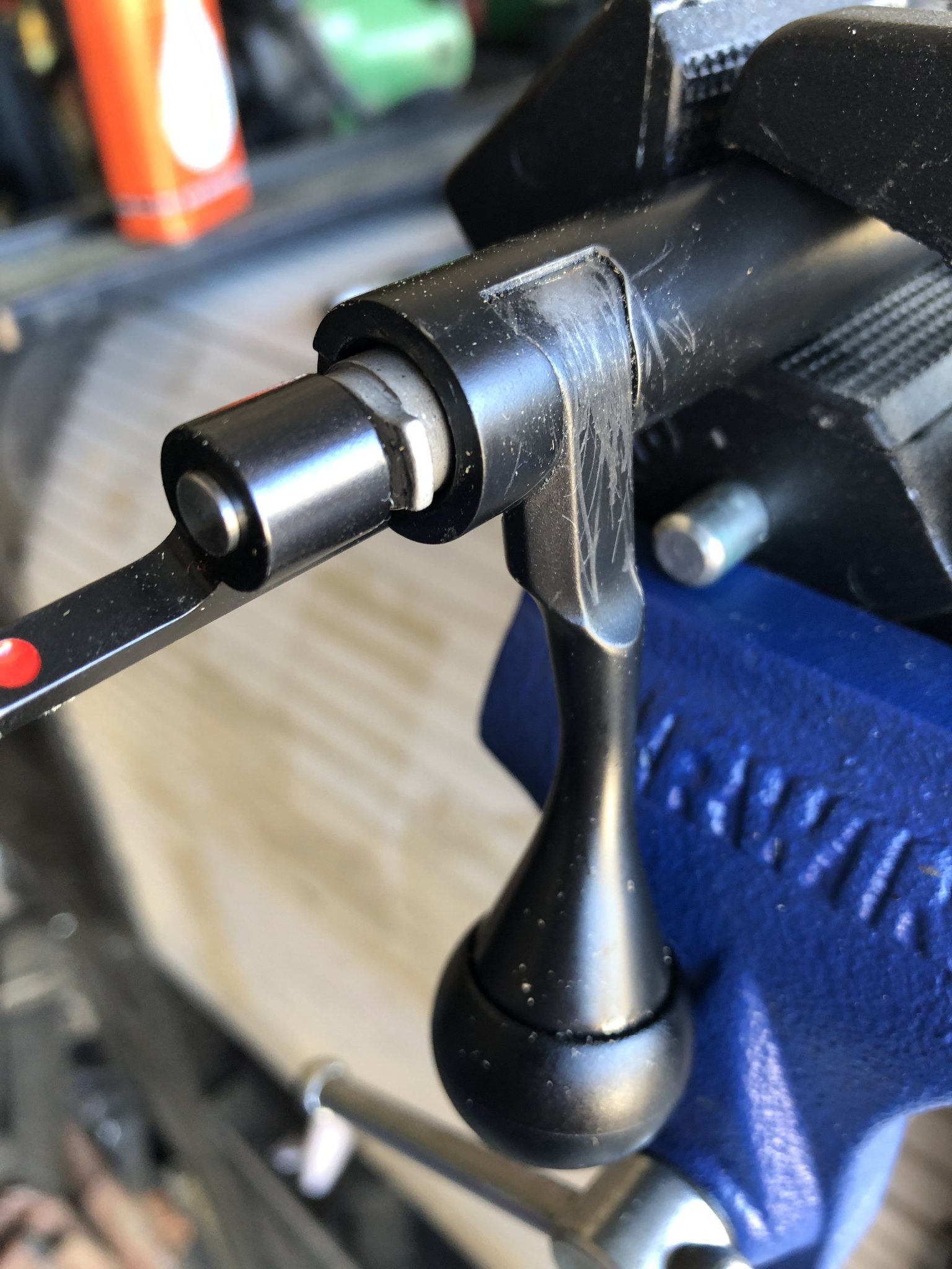

Recently picked up a tikka Tac A1. I am trying to put a Stark AInstyle bolt handle in it. This is my third tikka so I fealtnprety confident however this is my first T3x. The others were older.
I’m not aware of any major change but maybe I’m missing something. I can not get the bolt out.
I took the shroud off but the handle won’t release I’ve been able to move it about 1/8”
I tried soaking it kroil. I tried putting it in the freezer, I used a plastic and a brass punch. Got it to move just a bit.
Any ideas?
Thanks

When using a brass punch, are you using a metal hammer (and not a soft faced mallet)? You need the sharp impact of metal on metal to break the hold of the dovetail.
BTW, what are you using to keep the striker held back? In your picture I don't see anything (like an allen key) holding the striker back away from the dovetail.

It looks like you rotated the back by hand, without using an allen key (as shown in the video). What I've found was that if I use an allen key to thick or too thin, it makes it very hard to remove the handle. So maybe try a few different allen keys you have on hand and see if that helps.
You can tell from his picture that he has decocked the firing pin.
He's not going to be doing anything to it until he resets the firing pin back to the upper shelf out of the deep groove so he can even get an allen wrench/punch put in it to properly release the pressure....
