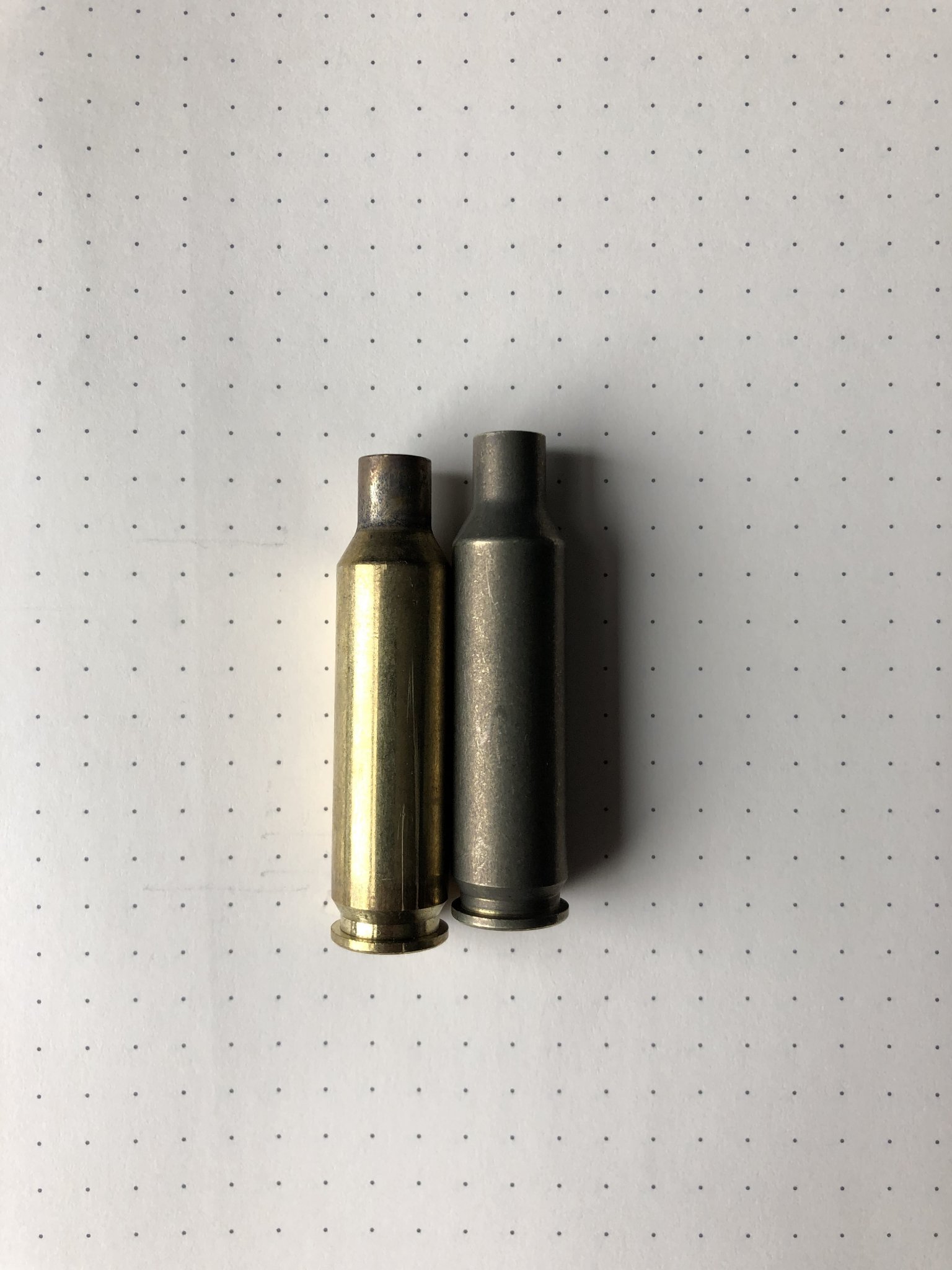

Wet tumbled my once fired brass for the first time today and brass seemed to come out dirtier than when I put them in. It appears that the tumbler just spread the tarnish from the neck to the entire case.
Details on equipment:
  • Hornady Rotary Case Tumbler (Item # 050220)
  • Hornady Rotary Media Sifter (Item # 050207)
  • Hornady One Shot Metal Polish (Item # 9993)
  • Hornady 6.5 Creedmoor Brass (Once fired, de-primed)
I tumbled 5lbs of brass with 5lbs of SS media pins (that came with the tumbler), 2 quarts of water and about 5 Tablespoons of the metal polish for 3 hours. Then I rinsed the brass with hot water while running through the media sifter. The attached image shows a piece of non-tumbled brass on the left and a piece of brass that was tumbled and rinsed on the right. If I rub the tumbled brass hard enough I start to see a little shine but I expected the brass to come out shiny from tumbling and rinsing.
Some questions I have now:
  • What am I doing wrong?
  • Did I not run them long enough?
  • Is the metal polish from Hornady junk?
  • Should I use Lemishine and Dawn instead or with the metal polish?
Most importantly can I resize the brass while it is this tarnished and tumble again after?

Yes, use dawn and Lemishine! I would retumble before sizing. But thats just me.
Not sure what you mean saying metal polish? I use about a 9mm case full of LemiShine and a cap full of ArmorAll Wash and Wax. Some guys use Dawn instead of wash and wax. You also need to tumble your pins in the dish soap to remove any oil before using them. If you have a steel case mixed in it can make for some funky brass too!
And yes, if the brass is not dirty and gritty you can size first.

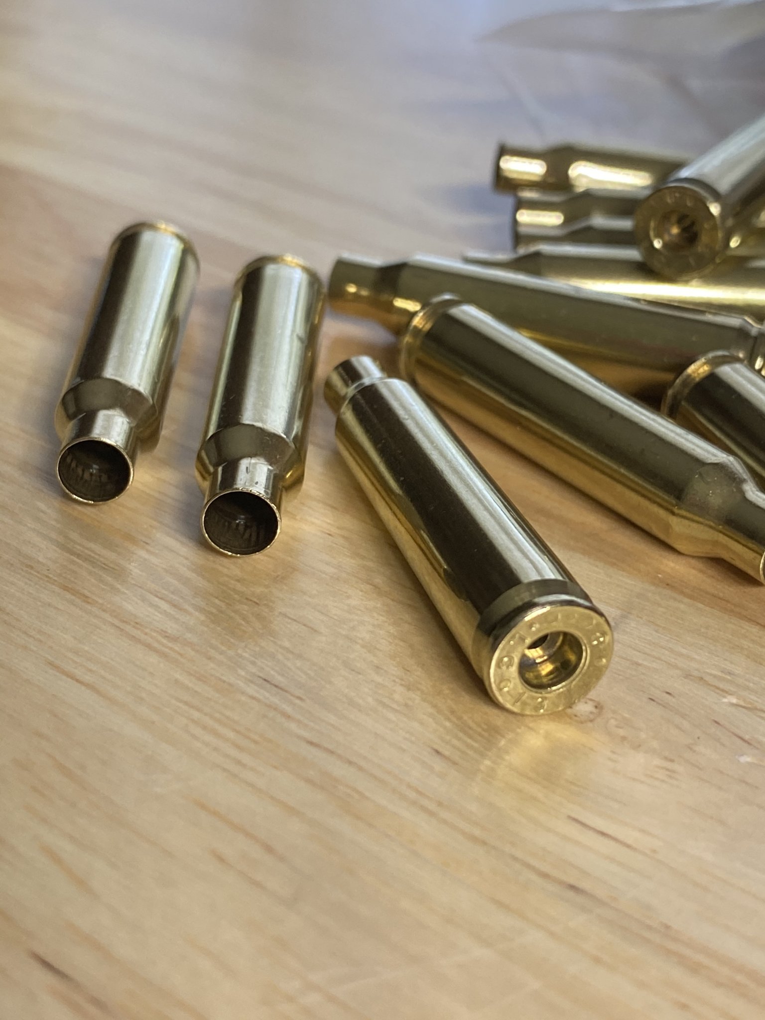

HOT WATER!! Dawn and lemishine !/2 hr to 45 mins and it is is in new condition. I'm using the lyman but have used the FA and RCBS versions also. Same results. Hot water makes it much faster to dry as well.
Don't overthink it.
I deprime my brass first because the spent primers probably have more gunk in them than the rest of the case. Hot water from the tap, a squirt or two of dawn and a small pinch of Lemishine. Run it for 45 mins. Then drain the water and start over. Another 30 mins or so and you're good. I do this for about 200 pieces of 6.5CM brass per run.
I think the Hornady case polish is for dry tumbling, not wet tumbling.
Reactions: caveman_actual
The metal polish you used was for a dry tumbler with corn cob or walnut media. These guys have you going on the right direction with Dawn and Lemi-Shine. The amount of Dawn isn’t critical, but if your brass comes out looking a little pink, back off the Lemi-Shine. I use no more than a 9mm case full, usually less.
The Hornady Metal Polish I mentioned in the post that I thought was made for wet tumbling.
Thanks all, I'll toss that metal polish I thought was for wet tumbling and go with Dawn and Lemishine. I also just cleaned the media by itself with Dawn and rinsed until the water was clear, hope that helps. Now just need to wait for the Lemishine to come in.

I do the dawn and lemishine combo. I started by tumbling, then draining the dirty water, and tumble again with clean water, and that was a waste of time. Now I just tumble, drain the dirty water, rinse and dump.
One thing I discovered, my friends who have water softeners, they can't get their brass shiny using that water, so they had to resort to using water that bypassed the water softener.
Hmmm??? I have a water softener and uses soft water and my brass comes out nice and clean AND shiny (using Dawn and Lemonshine).
How many 6.5cm cases can you wash at a time in the bigger Frankford Arsenal tumbler??
I was messing around washing some dirty gritty ones (no ss media) up before starting reloading. First batch was 300 about 1/2 full, had lots of tumbling, 2nd load was 600,pretty much full and was much quieter and not alot of tumbling in window. 3rd load was 500 and still didn't have a ton of tumbling but not sure how much tumbling is actually needed when cleaning with the ss media.
