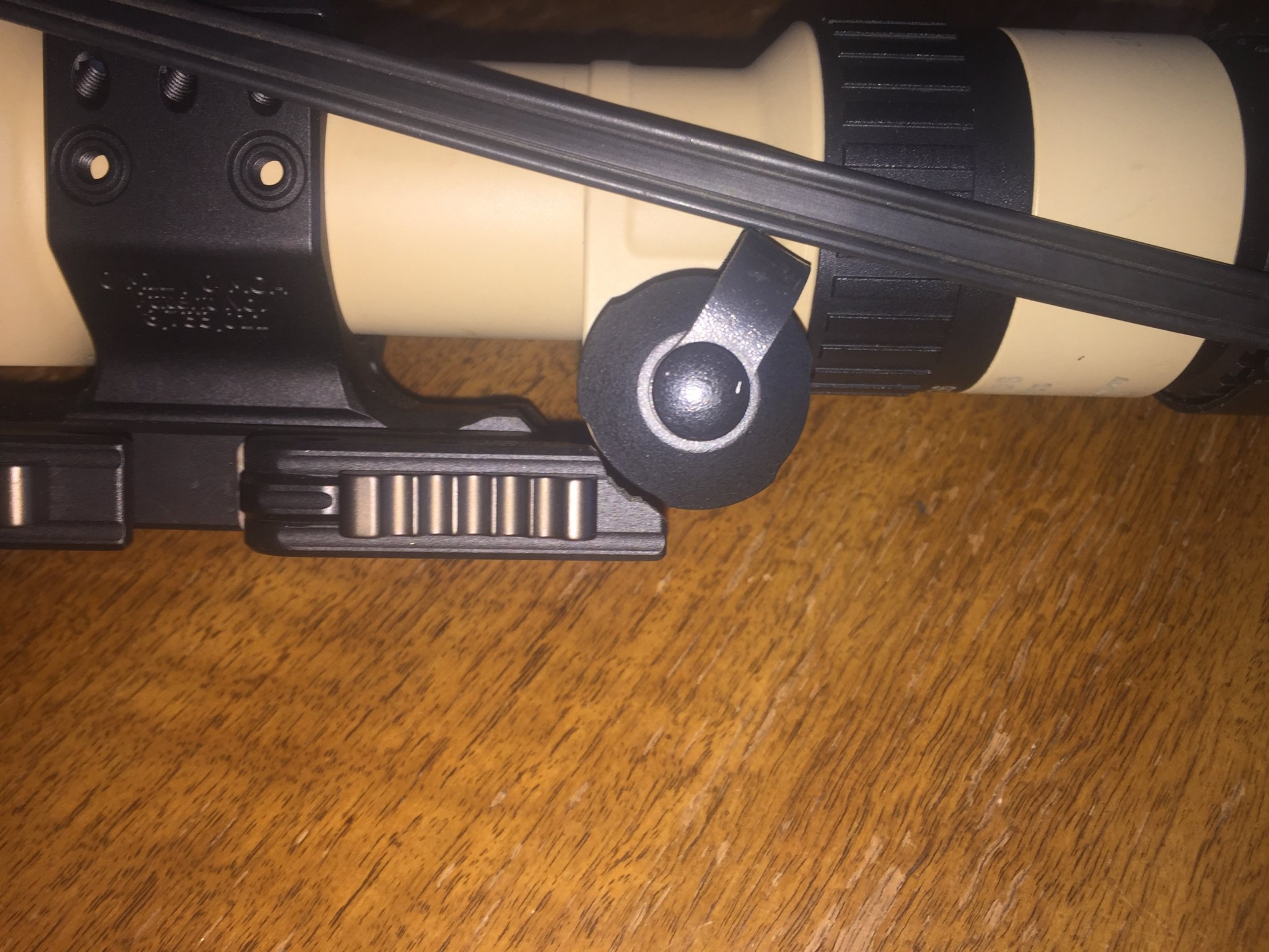

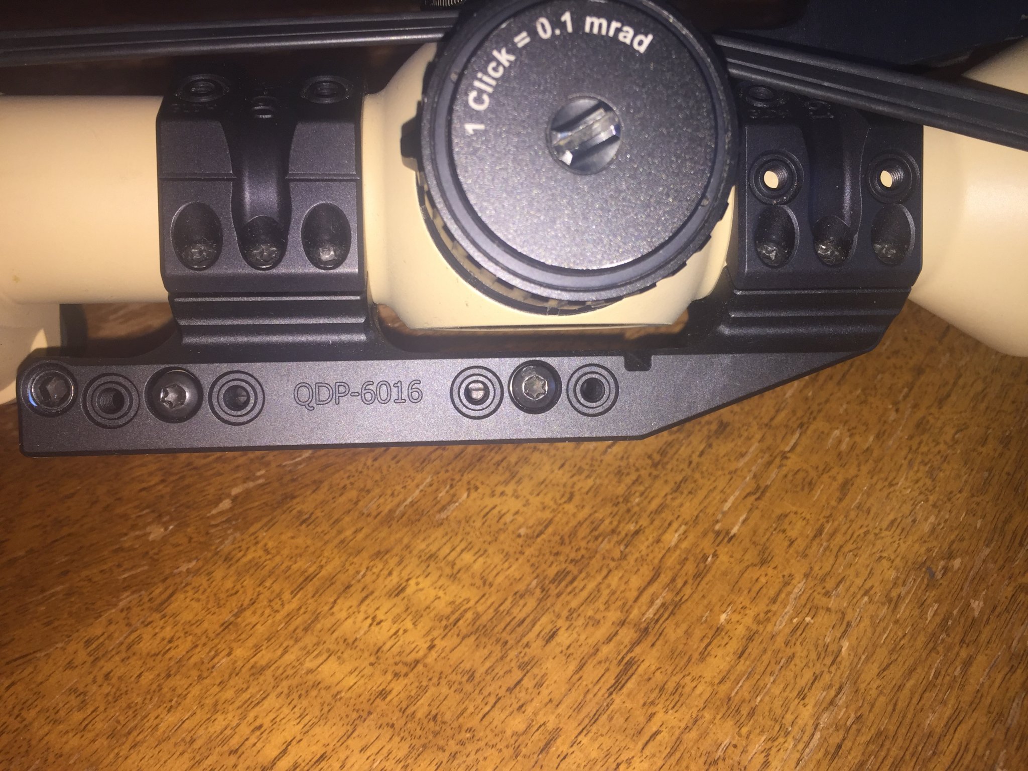

I run a 6016. The only place I had any issues is the rear throw lever and the battery compartment. Picture to give an idea of the turret clearance.
Reactions: rhsc and brand692
That explains it for sure. There is no way to get that turret housing in reduced height of the 6001 or 6601.
I would imagine the battery compartment would hit the picatinny rail if it got any lower. Just eye balling it, there is about 0.050-0.060” between the rail and the battery compartmen.
Have you checked to make sure the rings are not riding in the radius between the main tube and the front of the turret housing?
That's a pretty big radius and you're clear on the back but it's hard to tell about the front side.
The EraTac barely fits that area. I'll snap some pics too.
Looks like the SPUHR is an even tighter fit.
