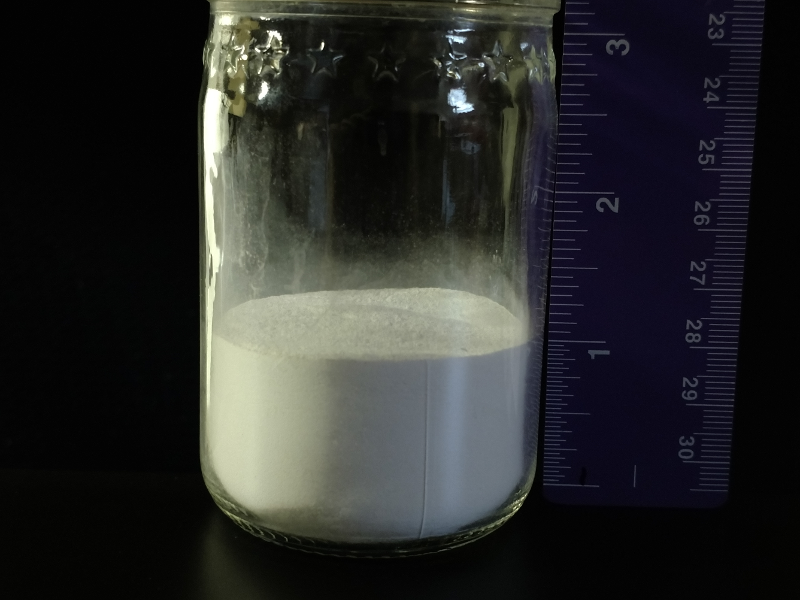

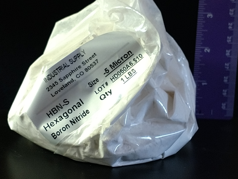

I remember when I first starting hunting this stuff back in 2010-2011. There were a limited number of sources and most didn't specify the particle size. Now, they've got the stuff on Amazon.
For reference, this is 1 ounce:
This is the 11 1/2 ounces (including plastic bag) I have still, after processing around 10K to 11K bullets:
I can't remember if the "-5 micron" is supposed to be 5 micron or .5, but the stuff has worked great for me.
