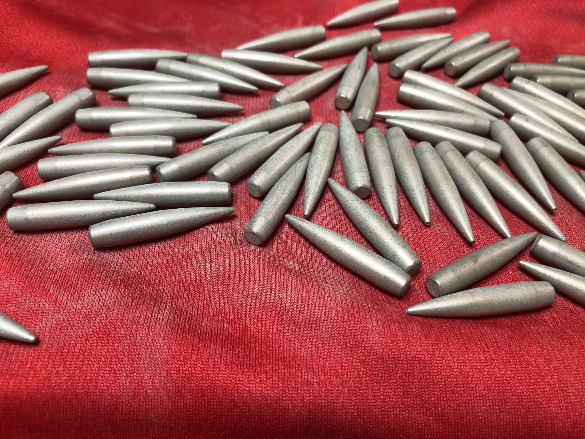

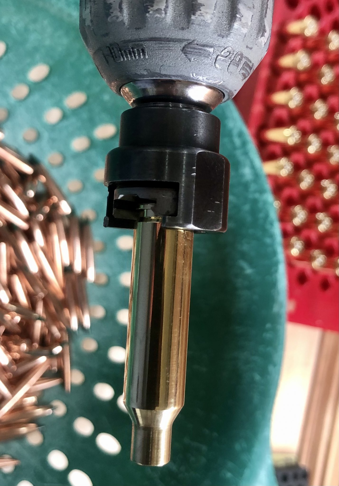

To give some hard learned lessons. I coat ALL my bullets with BN. When I first started several years ago, I tried 2 different brands trying to find something cheaper then Tubb’s...(maybe NECO? Was one) but quickly found they took much more work to come out correctly then Tubb’s and to me did not perform as well. After looking into it a little furthe, I found Tubb spent years getting specs on his powder where they needed to be. That is why his can be applied so easily without the use of steel pins or balls for impact which causes problems of their own. With Tubb’s kit put bullets in container (Sierra and Berger’s do not need to be washed first)add powder, tumble in vibratory tumbler for 1-2 hrs and done! Worth every penny to me....I love the stuff and was surprised to learn that Speer coats their Gold Dot BULLET line with HBN...makes sense.../

I picked up 1000 coated DTACs and some "TBN" powder from D Tubb. I'm starting with a new Proof SS 6CM barrel. This is my first experience with bullet coatings so I'm learning as I go.
The plan is to shoot 50-100 SMKs tumbled in the HBN and then start load development with the DTACs.
For tumbling, I'm using an old 1lb. canister of Hodgdon powder and a Frankford Arsenal rotary tumbler. I packed the tumbler with shop towels and placed the canister in the center. Bullets were tumbled for 1 hour.

Coated a box of bullets with the Tubb TBN powder. Different batches had way different color, from nearly white to almost invisible, not sure why. Bullets are very slippery to handle, so friction is clearly way less than before, regardless of color.
Called the Tubb support line and they were very friendly: They don’t ship BB shot with the plastic bottle anymore, apparently it is not needed. Also the tech did not recommend coating the barrel with a mixture of alchohol and HBN, “just shoot 50 cheap bullets, and then the barrel will be seasoned”. Fair enough.

Tumbled for 2.5 hours, after wiping off the excess. The tumbler was running on a timer:
Have subsequently tried to coat 1/3 of a bottle, and it came out way different (very light coating). You do seem to ALWAYS have to keep the amount of bullets at 70% of the available volume. Better to mix 120s and 144s to fill the bottle to 70% and then separating them afterwards, compared to running a half empty batch when you get to the last few bullets in a box.
Got best results during the daytime with the tumbler with its transparent lid in direct sunshine all the time, with no BBs. It got fairly warm in there.
A batch run for 9 hours overnight did not come out right (patchy coverage). Either run for too long, or it was too cold, or both, not sure. [It seems you actually have to follow David Tubb’s instructions!]

You are probably already set, but if you like, you can easily remove any undesirable residual coating (even hard burnt-on carbon streaks) with a fine 3M scouring pad.
Cases fired at low pressure like fire forming new cases, or using starting loads tend to leave carbon on the case shoulder, and sometimes even the case body. Sometimes it wipes off with a cloth, but can occasionally be hard to remove. I wet the scouring pad with Ballistol.
Just chuck the cases in something like this K&M power adapter/case holder, use a drill to spin them for 20 seconds each or so, and hold the scouring pad between thumb and forefinger against the outside of the case body, shoulder and neck. [It is meant for case neck turning, a BR trick not needed in most instances.]
Case holder:
Sanding/scouring pad:
