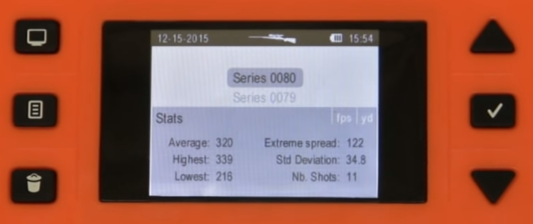

    So for the display, I was watching a video and the guy said one of the things he doesn't like about the LabRadar is that the display will only show one shot at a time? This seems a bit counter intuitive, can anyone with a LR verify if they've fixed this in a firmware update as it would be really beneficial to see all shot velocities from a string, along with average and SD/ES on the same screen. One of the biggest pains with the Magnetospeed is having to go through the menu system to switch between SD and ES.
    Pretty sure that on the display itself, it only shows one shot at a time, until the sequence is completed. The app may allow seeing them all as they are collected, but I haven't tried that before(?).
    The display only shows the last velocity. When it's in active mode.
    When you are done shooting you can either go back to a different menu or on the app and see the shot list and scroll through your last string. It's not as clean or simple as I would like but it does work.
    I'm not so concerned that it shows one shot at a time while shooting a string, but when I'm done with the string (say 5 rounds) I'd like to be able to show velocities for the entire string (all 5 shots) and then be able to see High, Low, Average, ES, SD... is that possible?

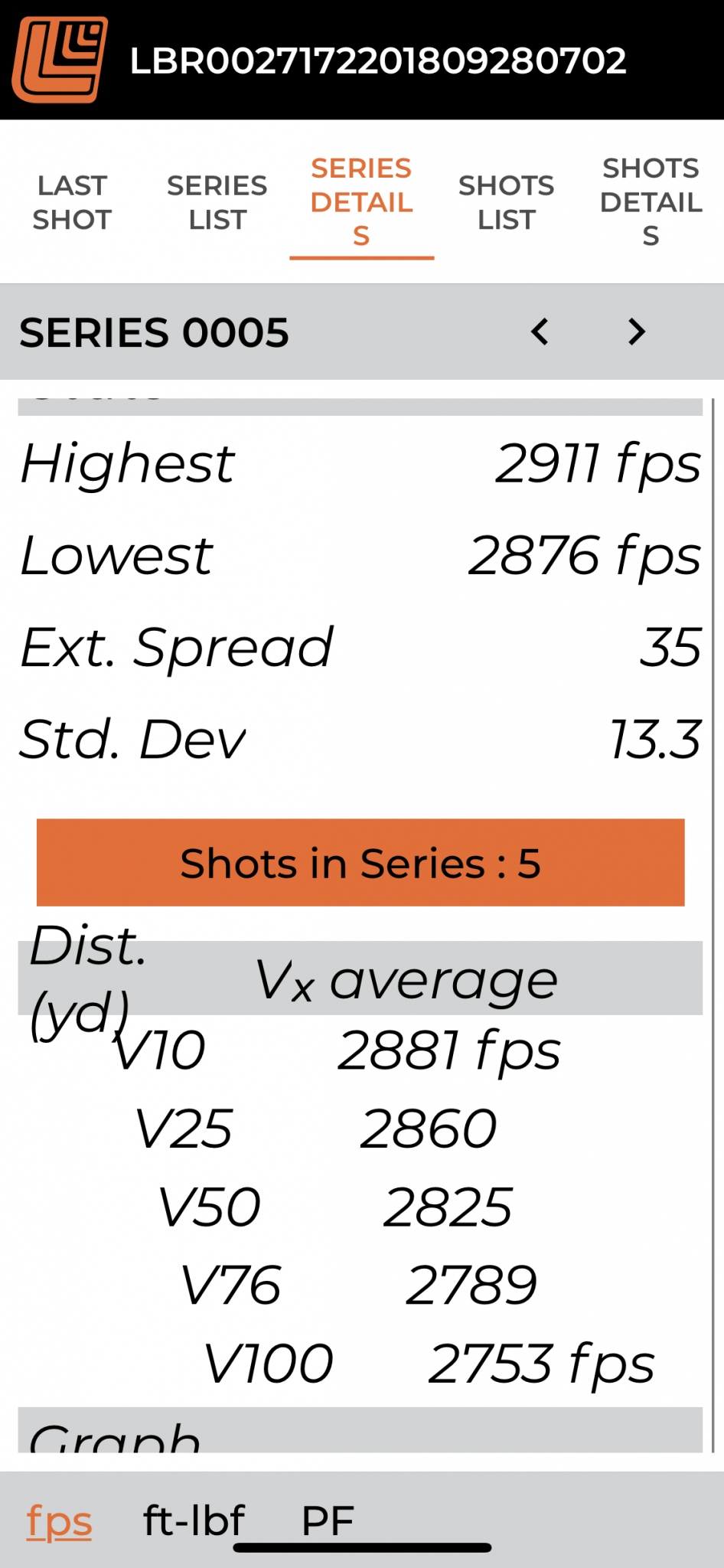

    For those who use the app, is this easier to see with the app?
    It is easier to review shot strings in the app in my opinion.
    Just saw this in one video, this is exactly what I was hoping for, how easy is it to get to this screen after shooting a series/string?
