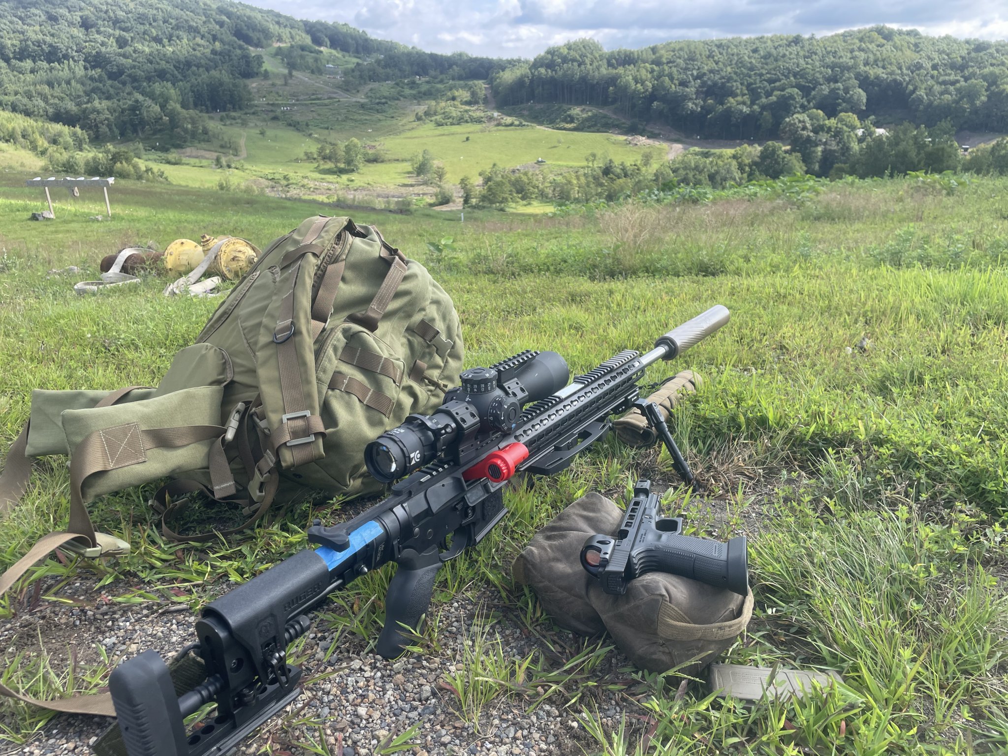

    Build deets? I see an rpr stock, was that one listed in the px last week or so?
    Bought that a few years back. Guy built it to shoot hot 77s
    Saturn cut rifled 20”
    AGB
    Law folder
    G nm trigger.
    RPR stock. (I really like that stock )
    He set it up right. Feels like shooting a 10/22 and the most accurate AR I have shot and I’ve shot a few. I added the arca/can/bipod/scope
    Pistol has a zev upper and magwell kkm barrel. Comp. not sure what else inside. I added the sro. Sweet shooter.
