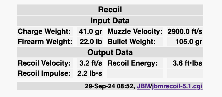

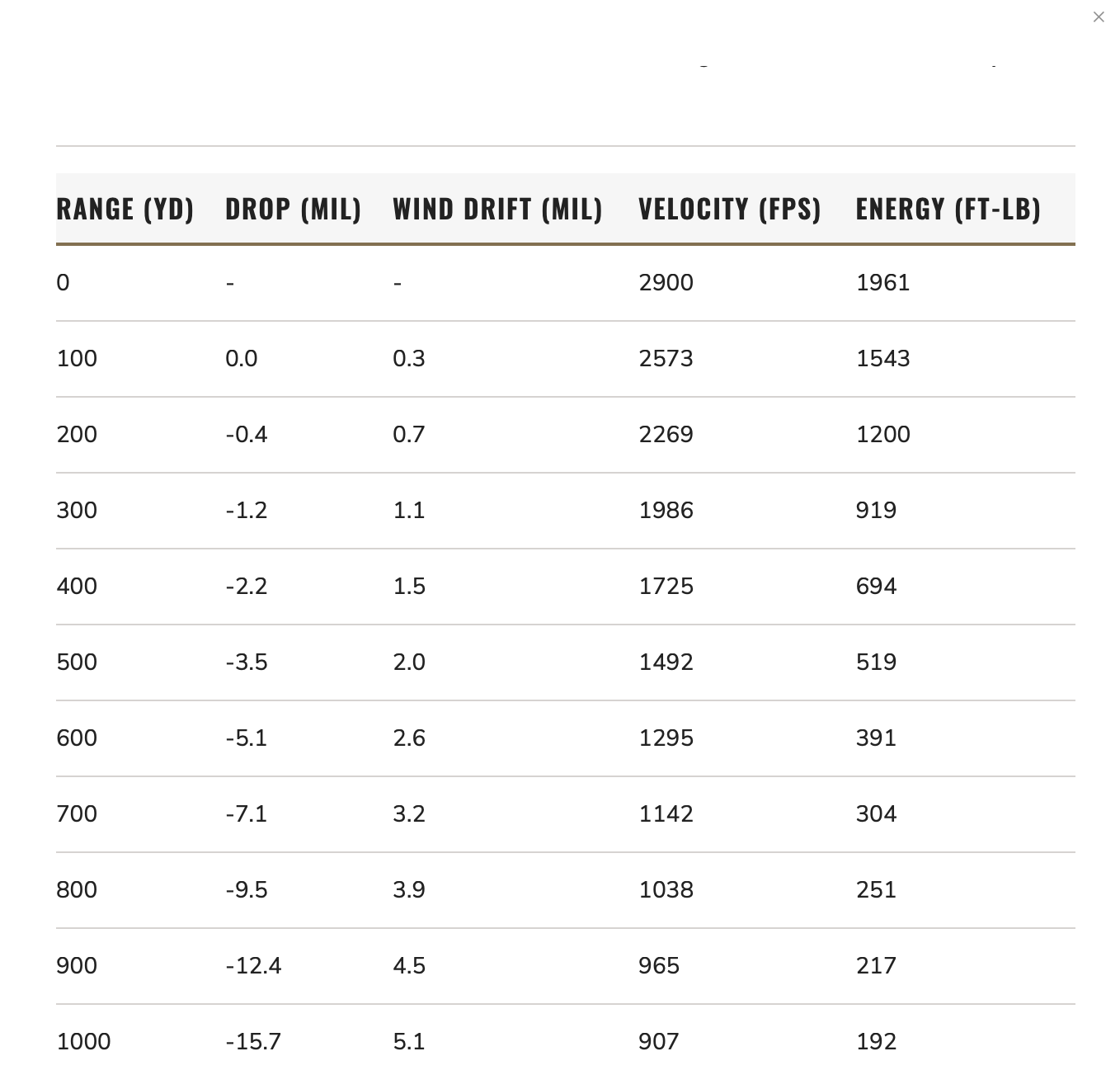

    For example, with a 6CM, and a faster 105 versus a slower 115, things will look/feel like basically a wash until ~500 yards as far as retained energy, hit or miss, impact/splash. But at 600 and past that... out to 750-1000+ the 115 is going to yield more signature downrange due to more retained energy (and since you can use nearly the same charge for either, there isn't much of any real penalty in so far as having to deal with more recoil using the heavier 115).
    6CM, 105 .280BC, 2900fps, 41gn charge:
    Screenshot 2024-09-29 at 9.50.10 AM.pngScreenshot 2024-09-29 at 9.53.05 AM.png

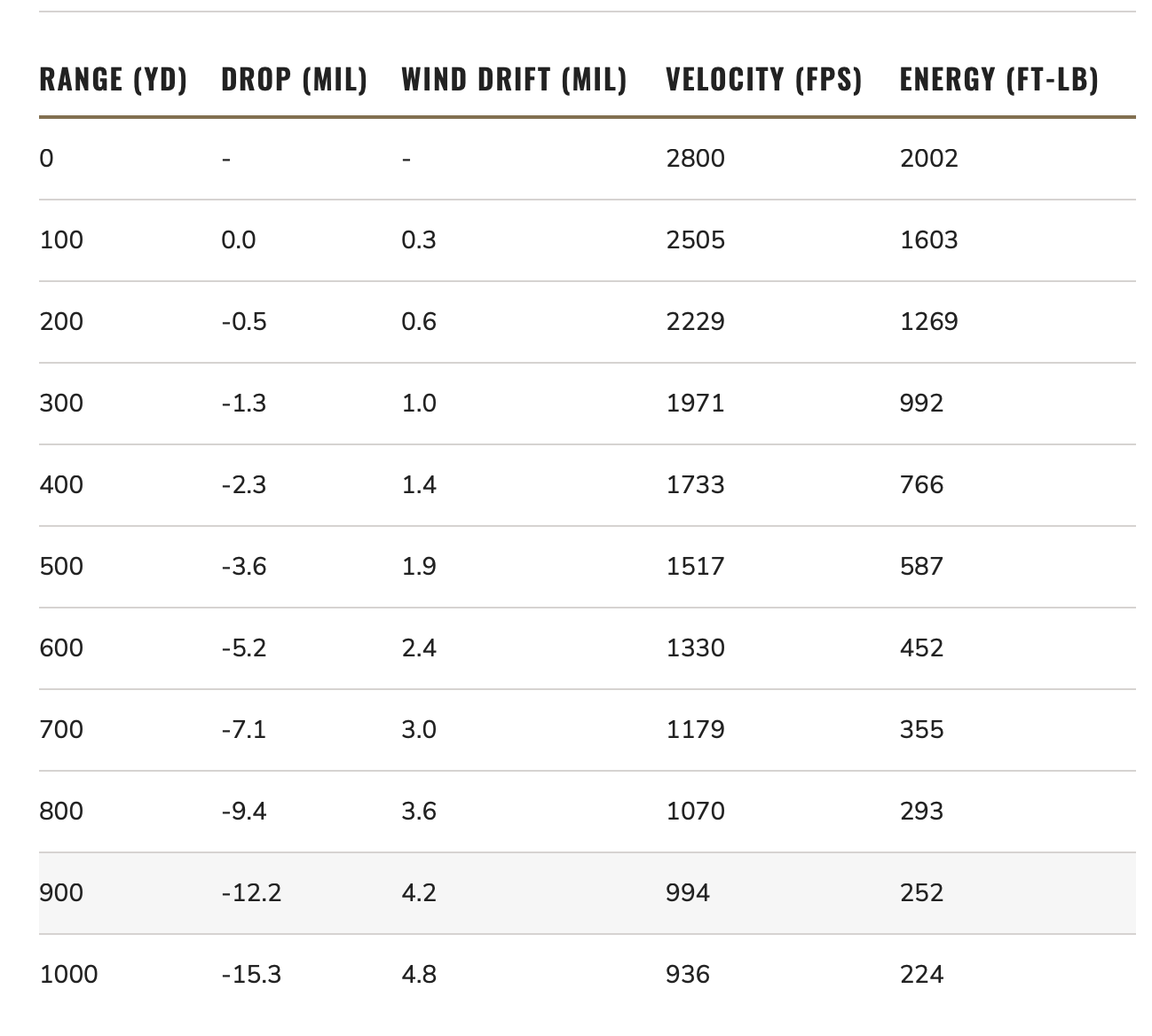

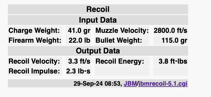

    6CM, 115 .305BC, 2800fps, 41gn charge:
    Screenshot 2024-09-29 at 9.51.00 AM.pngScreenshot 2024-09-29 at 9.53.35 AM.png
