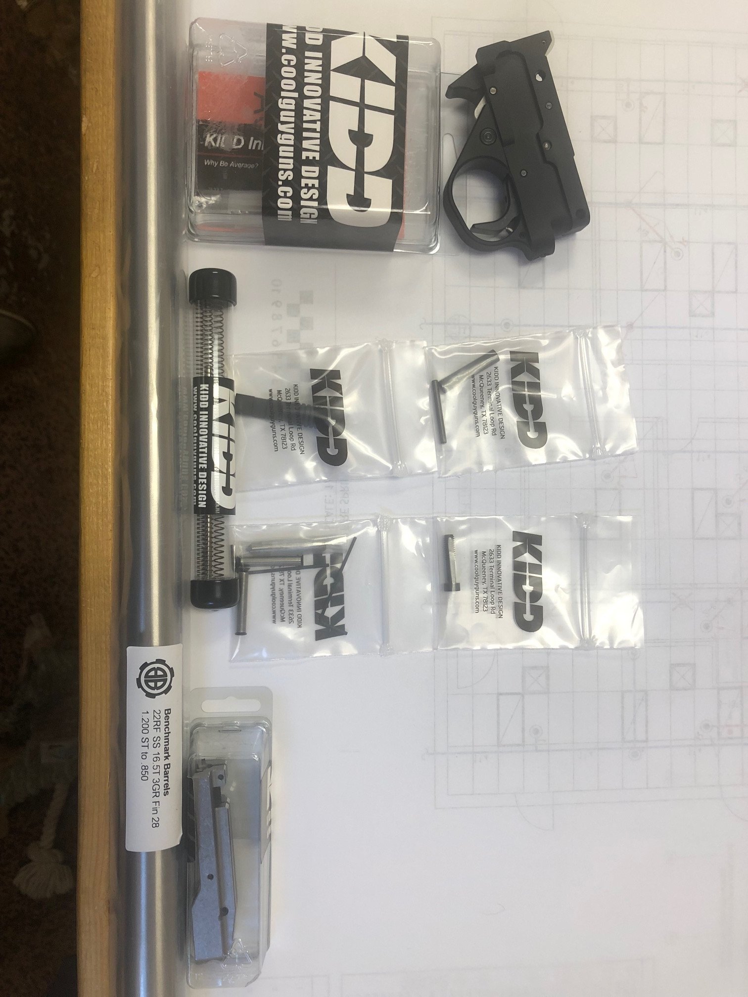

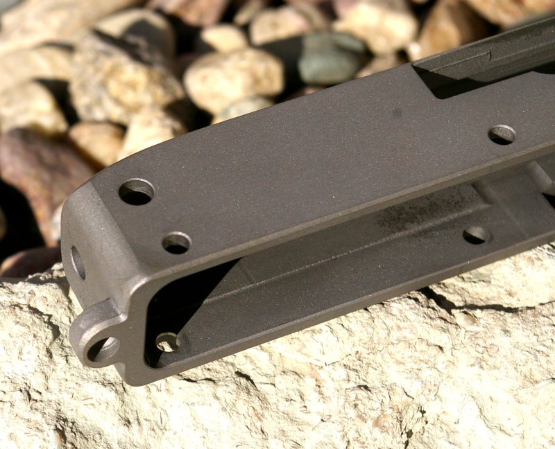

    Decided I hate $$ and am going all in on a build for BR and NRL matches.
    SO far components I have and price
    $340 - Benchmark SS 16.5t 3GR 1.2-.850 taper
    $250 - KIDD Single stage trigger unit 1.5 lbs
    $99.95 - KIDD Bolt
    $6 - KIDD Takedown Screw
    $29.95 - KIDD Threaded Receiver Pins w/Countersink tool
    $29.95 - KIDD Bolt Handle Charging Assembly w/Guide Rod & Springs (Black Ring)
    $5.95 - KIDD Bolt Buffer

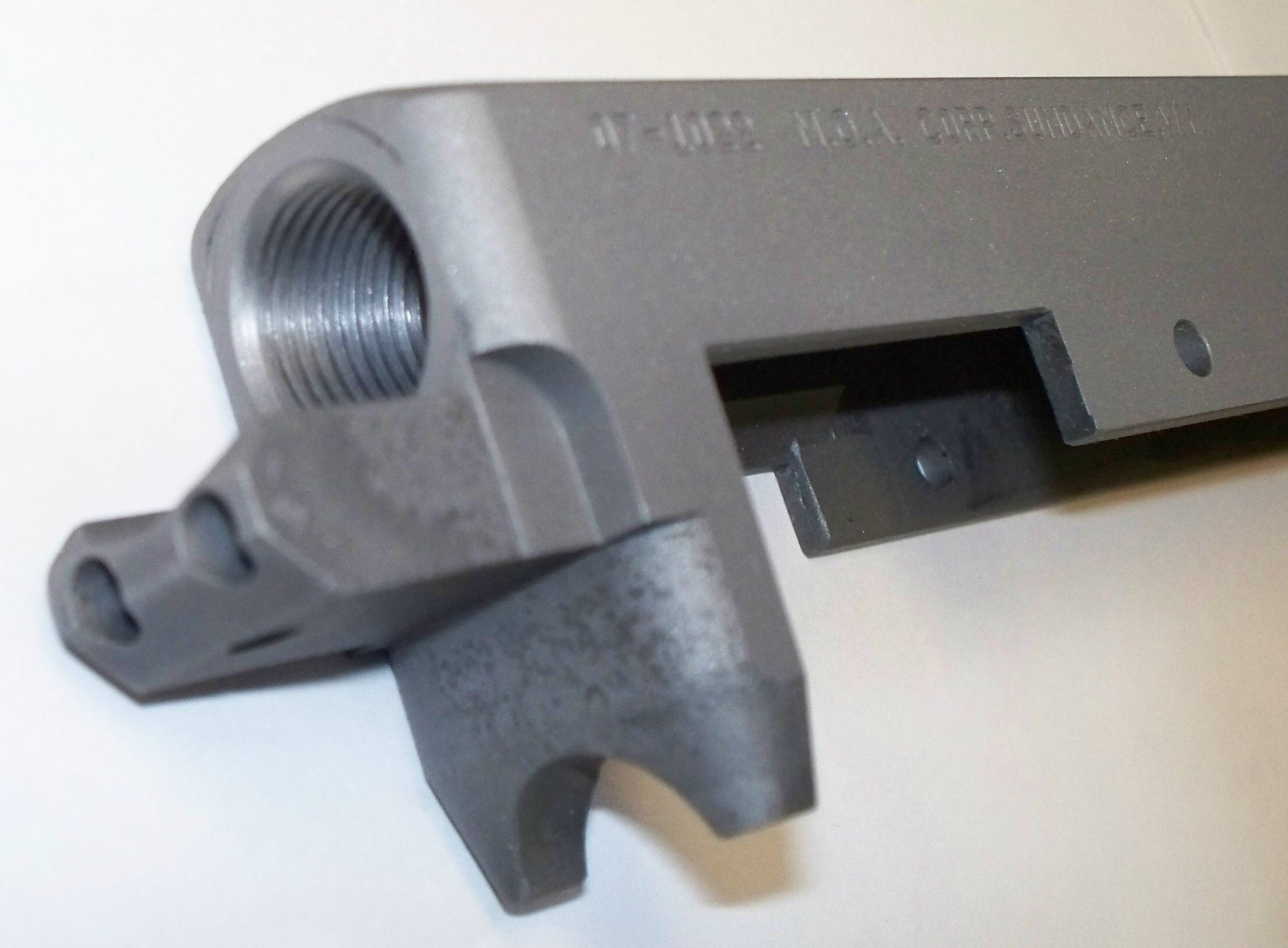

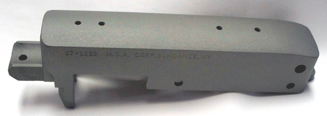

    $200 - MOA Corp stainless receiver
    Yet to order - Mcmillan A5-22 stock. Honestly looking to save by getting a used one but ends up they are pretty rare. Have a line on one but havnt pulled trigger yet.
    Stock - $500 +/-
    Chamber job barrel finish at 24" - $250
    Bedding - $200
    Tuner - $250 (leaning towards CHacons PRX II tuner)
    Thought process is this. Why not use a semi auto for NRL? All targets are inside 100 yards for the NRL required COF and there are a lot of position changes as well as mag changes. A semi auto will really shine on time. The only stage where I could be hurt is the KYL rack. If the accuracy isn't there, I guess I just don't go for the smallest plate. The last match I was at I kept missing the 4th plate anyways with my 40x so not a huge deal breaker. Second, I have a Stiller 2500X single shot for BR shooting. I want to take my Dad who is getting older now and then so I will let him use the Stiller and I will use the 10/22.
    On the rifle itself. Why the action and components. I will get a lot of questions of why wasting time with threaded receiver, as there are more accurate rifles with screw and press fit barrels. While jumping/banging/moving/falling around on NRL type stages, I don't want any issues. Ever. I believe threaded is the only way this will happen. The MOA action also has a threaded rear tang screw. I don't know how this cant be a plus.
    As for the internal components, KIDD obviously has something figured out to have the success rifle after rifle. I get it that most people aren't used to anything considered accurate with factory Ruger 10/22's or rifles in general so even a small upgrade is worth the change, but KIDD gets it right time after time. That being considered, I decided for all KIDD internals. Quite happy there.
    I will update as project progresses. I will be bitterly disappointed if Im not able to score at least a 245/250 on a IR 50/50 card. I plan to send it off to the Lapua testing facility to get ammo matched up for it.
    pics of MOA receiver and A5-22 stock are off internet.

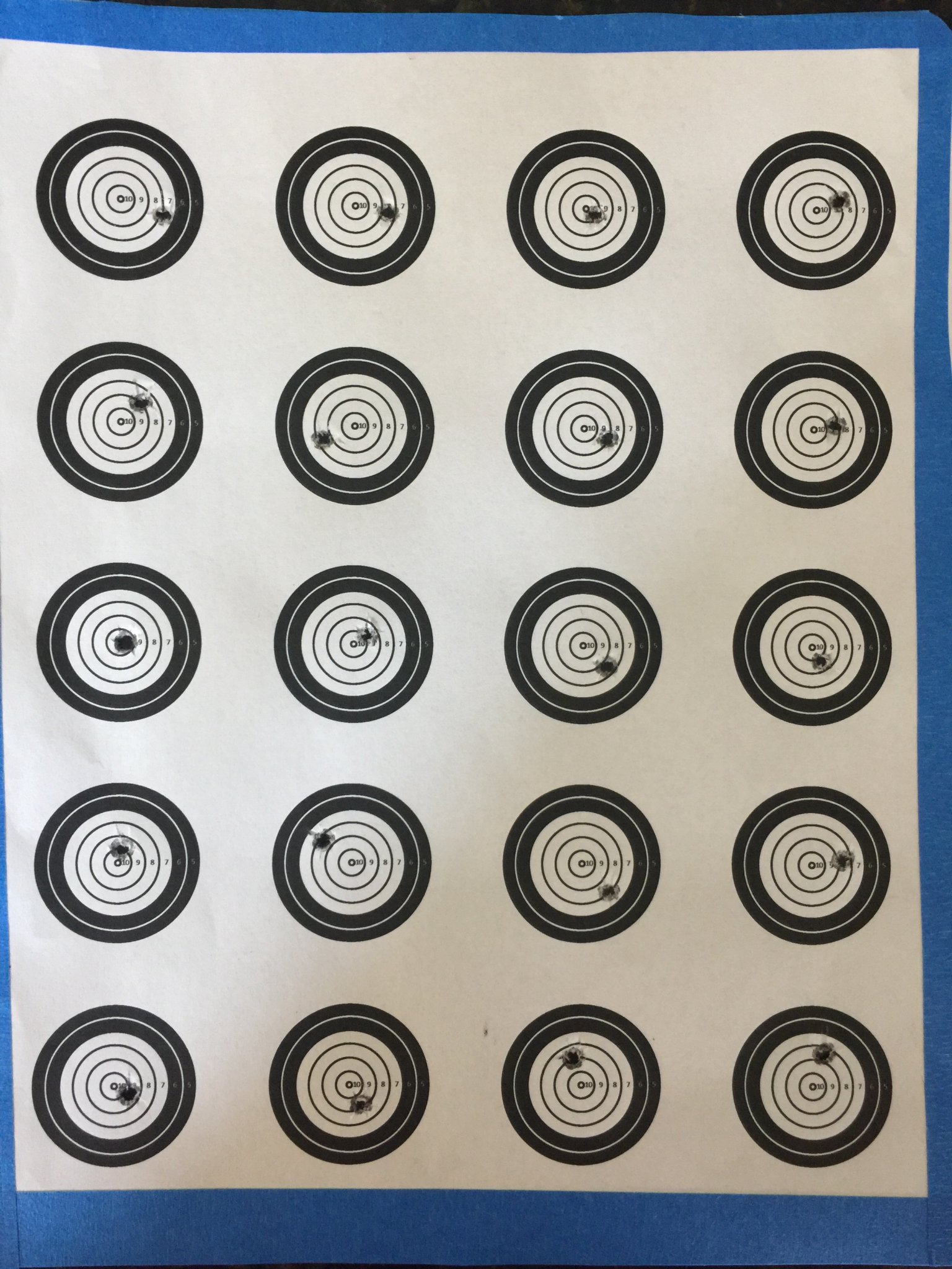

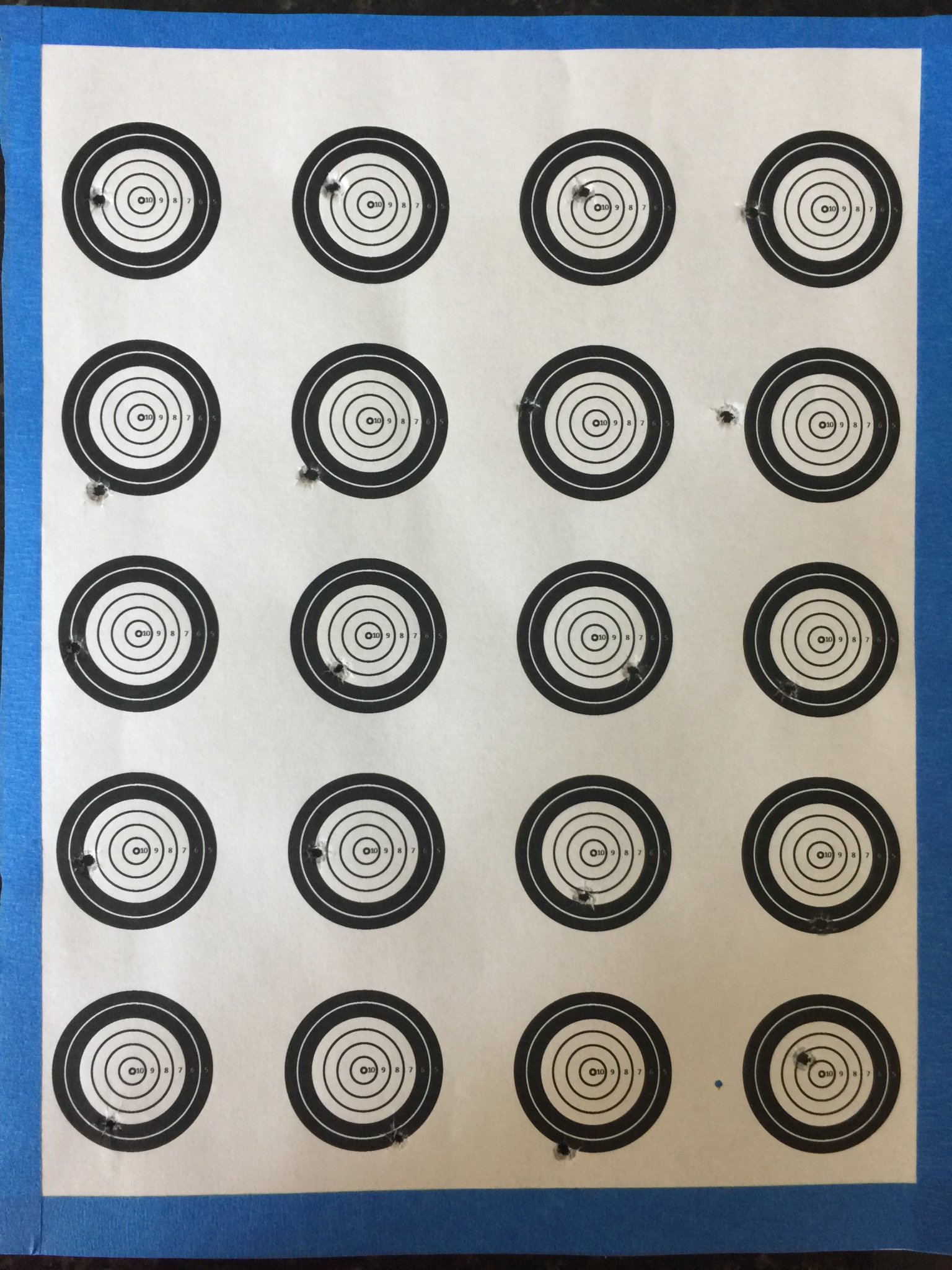

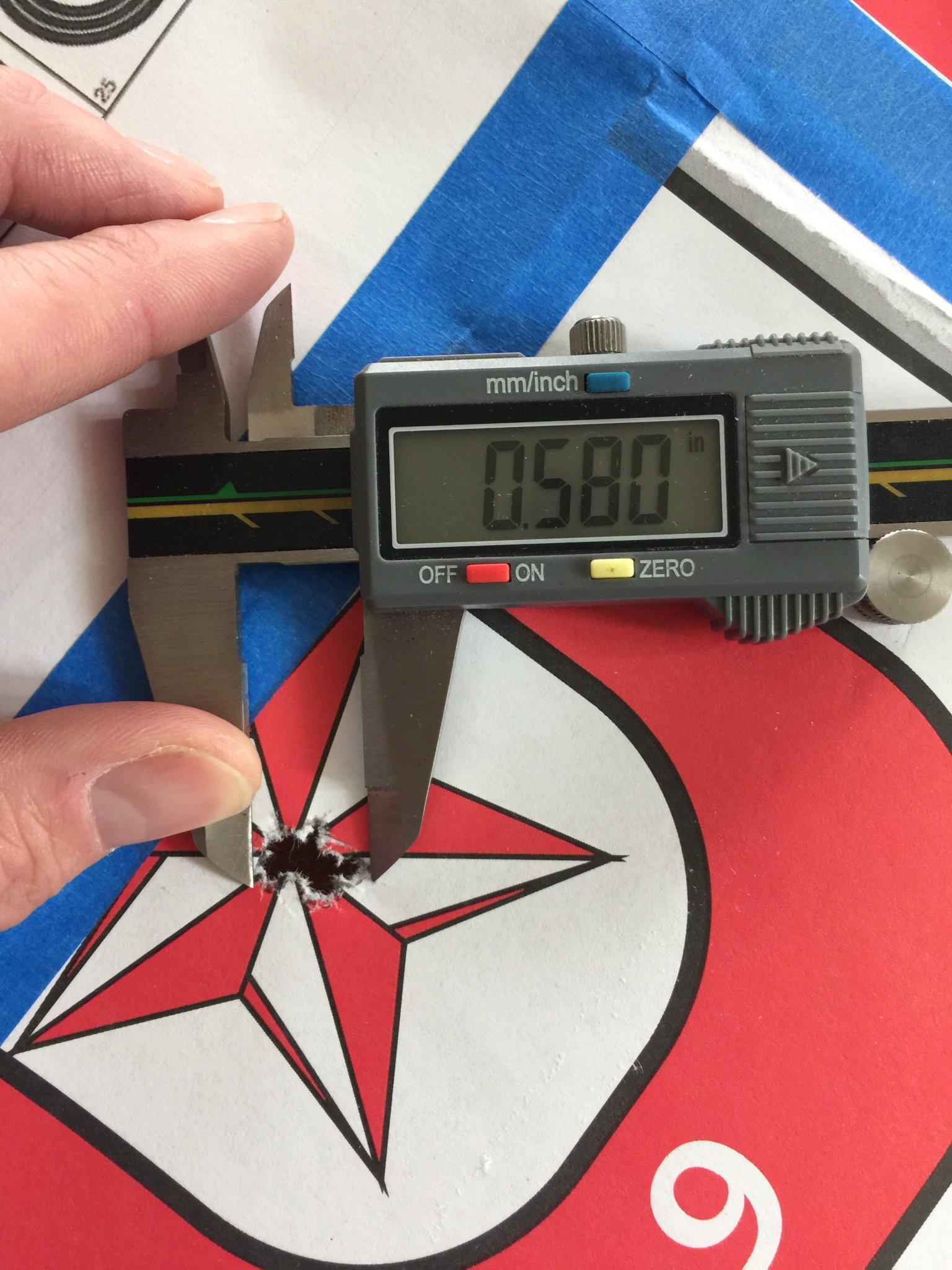

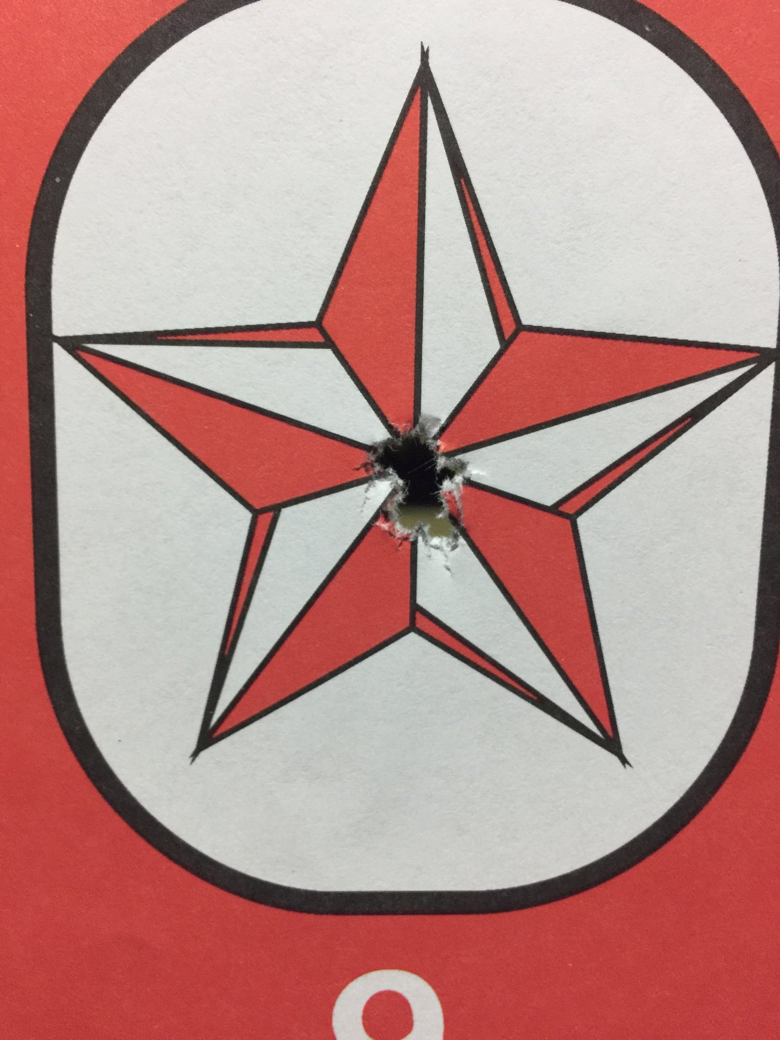

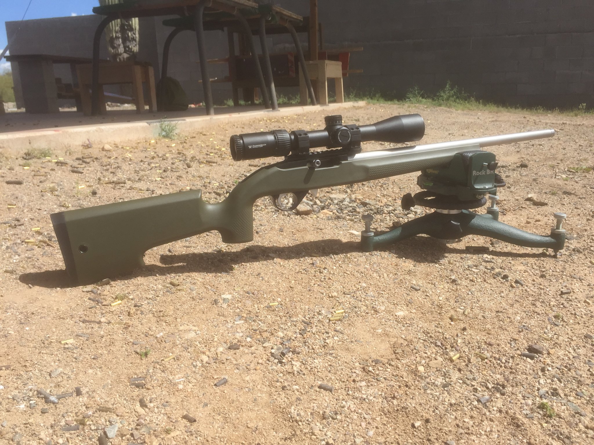

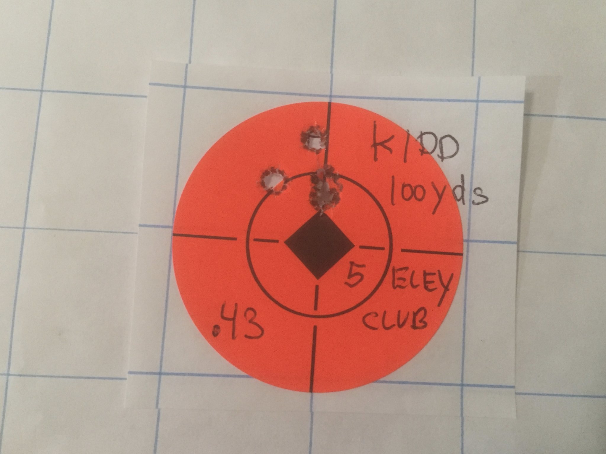

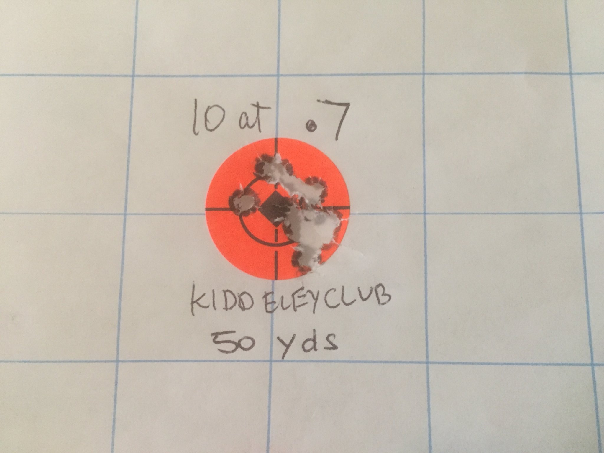

    I opted to go all KIDD
    $459 Barreled Action
    20" SS Straight Taper Bead Blasted
    $6 Bolt Buffer
    $100 Bolt Silver
    $30 Charging Handle & Assembly
    $200 Single Stage 3LBS Trigger
    $186 Victor Co. TITAN 10/22 precision rimfire stock
    Vortex Precision Matched rings Low

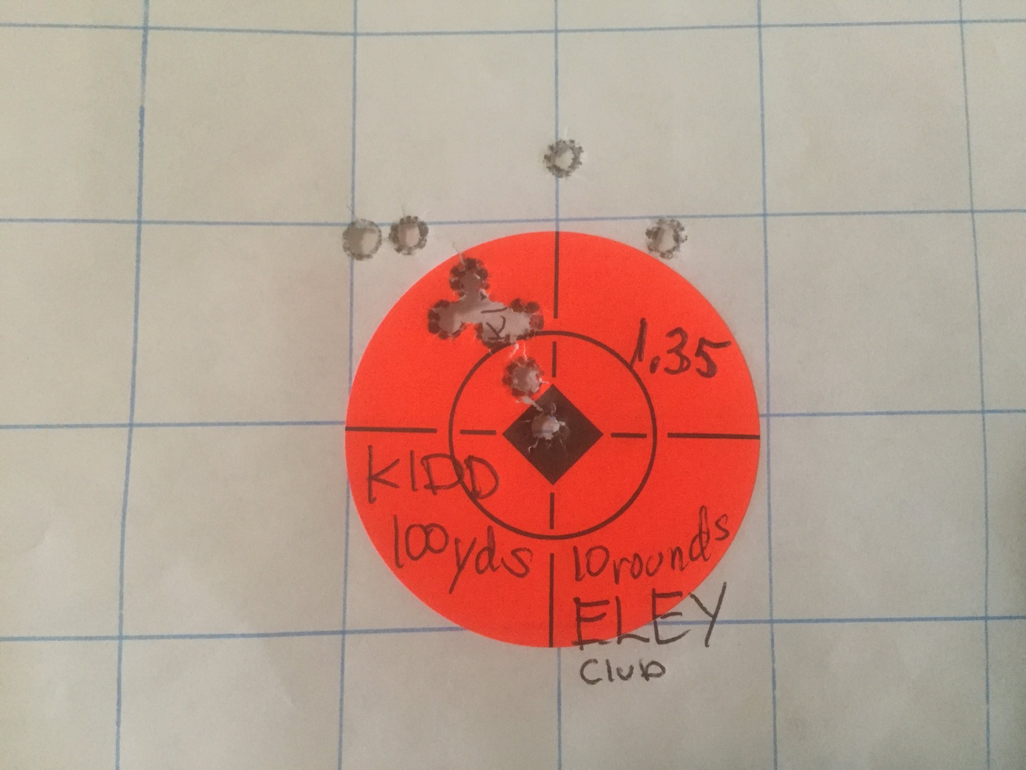

    Vortex Diamondback tactical 4-16X44
    67 deg 1900 DA winds light & variable 28% humidity Eley Club
    At 50 yards 5 at .5
    5 at .51
    5 at .59
    10 at .7
    5 at .85
    At 100 yds 5 at .43
    10 at 1.35
    .... The semi is definitely is a high time saver as I don't have to break the hold. I don't believe I am far behind if at all behind a bolt out to 100 yd in regards to accuracy.
    My thoughts exactly.

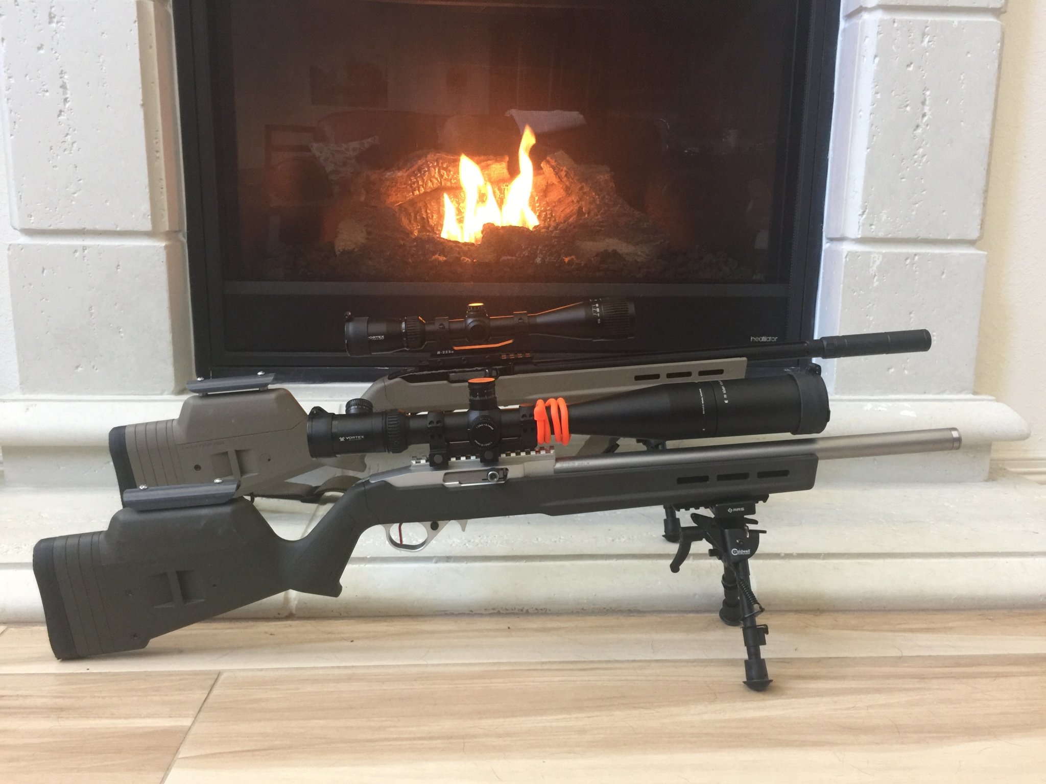

    I have a similar build for NRL22, where only the receiver is still Ruger and almost everything else is Kidd parts.
    I found I needed to compensate for my poor skills in the unsupported positional stuff, so I went with the Kidd ultralight fluted barrel at 16.25" length. It's only 1 pound and every bit as accurate as my CZ 455. Maybe it's just me, but I cringe at the thought of a solid 24" barrel for standing unsupported.

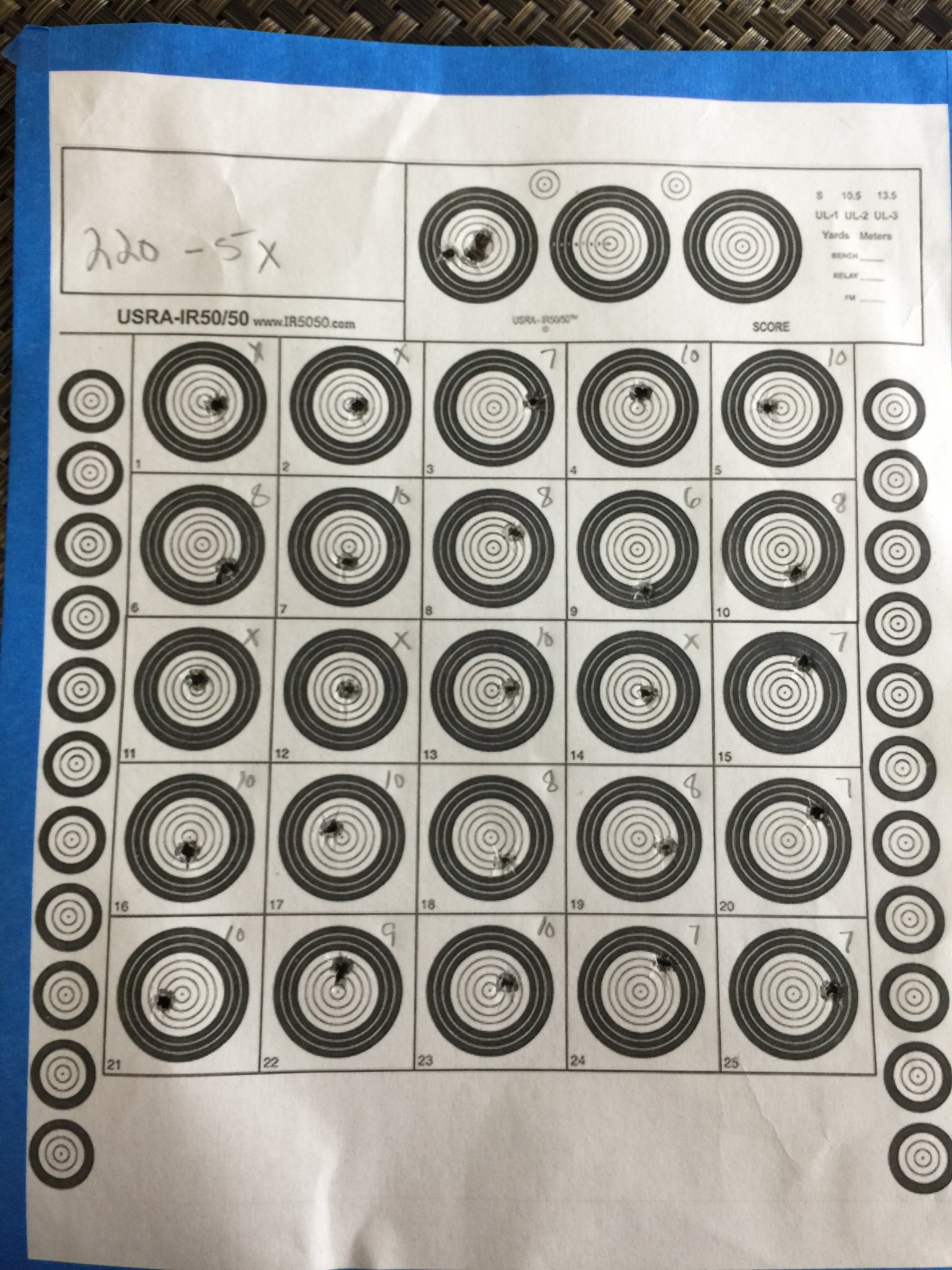

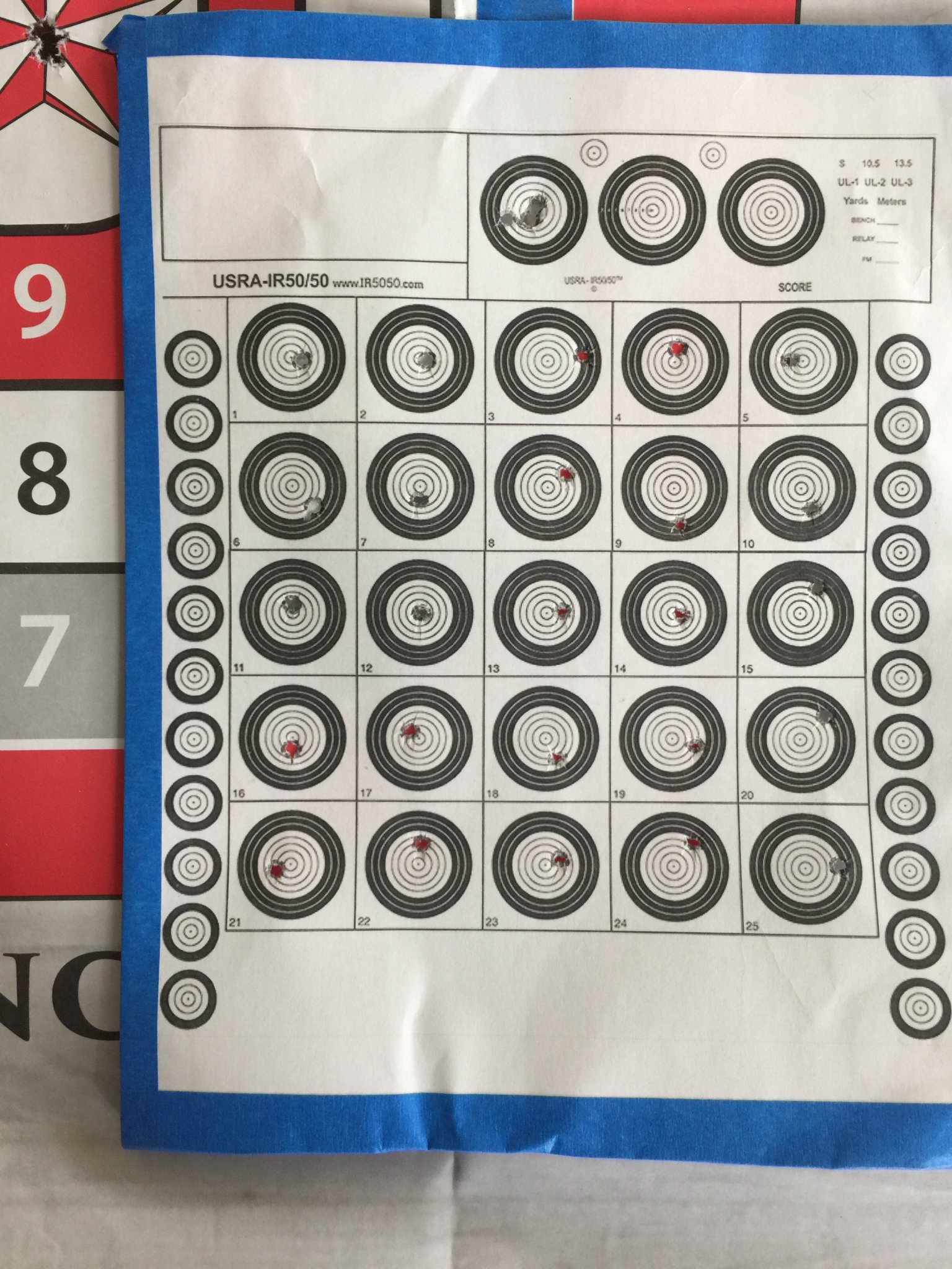

    Please shoot the IR 50/50 card or any other 25 individual with your best supergrade and post up. Eager to see.
    DT

    Here is a target I like to print off and screw with. You can order the real target off the IR5050 website. 1 shot per bull. 25x. SHOOT AT 50 YARDS

    Ok, so I took the target posted above to an indoor range with my Kidd Supermatch 22lr rifle.
    18" 0.920" diameter match barrel
    2 stage Flat blade trigger, light field weight (1 lb / 1 lb)
    Vortex Viper PST scope 6-24x50 ERB-2C reticle
    Lapua CenterX ammunition
    The range setup was not conducive to prone or bipod shooting (rather narrow bench), so I used a fortune cookie for a front rest (more like in the middle of the stock) and a red tac gear 1/2 pint under the grip.
    I started with a 10 round group, as I pulled a bore snake through the barrel after the last 22 match.
    7051737
    7051738
    That 0.580" is an outside to outside measurement. Taking into consideration the bullet hole diameter of 0.215", we have a center to center measurement of 0.365".
    The 10 shots above were the last 10 from one lot of ammunition that I had, and I was digging into an as yet unshot lot of ammunition for the 25 rounds in the test. I put 3 into one of the top targets to confirm that my zero had not shifted, then went to the task at hand. When I printed out the target I was unsure of the size, so I just sized it to fit on a 8.5X11" piece of paper. The 10 ring is 0.150" in diameter- according to my caliper. If the grey mark left by the bullet broke a line, I counted it as that value.
    7051739
    7051749
    I don't shoot bench-rest, and this is the most paper I have ever shot with this rifle so my scoring may be off by a point or 2. If one were to stack all of the targets on top of each other, shots 20 and 21 are the 2 furthest from each other. I get a measurement of 0.753" as an outside to outside measurement on them- 0.538" center to center. So, I guess this Kidd Supermatch is about a 1 MOA gun- at least today it was.

    I looked around for the scoring ring diameters for the IR5050 target, but couldn’t find them on their site. Further investigation suggested that the IR5050 target is the same as the World and European Rimfire and Air Rifle Benchrest 50 Meter/yard target. They have ring diameters in their rule book.
    X ring 0.0312”
    10 ring 0.2500”
    9 ring 0.5000”
    8 ring 0.7500”
    The WRABF 10 ring is the same diameter as the 9 ring on my target.
    The WRABF 9 ring is the nearly the same diameter as the 7 ring on my target.
    The WRABF 8 ring is 0.04” smaller than the 5 ring on my target.
    Taking the above into consideration and then employing my calipers to measure distances, hits scored as 7 and 8 are 9. Hits scored as 6 are 8. 9s and 10s are 10s. The x ring is sufficiently small that I didn’t bother measuring. But, that brings the score up from 220-5x to 239-5x.
    I also bought a Kidd Supergrade barreled action and put it in a Titan Stock with the Kidd rear tang.
    Mine is a 20” barrel with a double stage Kidd 3oz/3oz trigger. That trigger is really nice!
    I haven’t played with the torque settings and haven’t shot it much, but with ammo it likes it shoots in the 0.3s at 44Y
    I’m pretty happy with the setup.

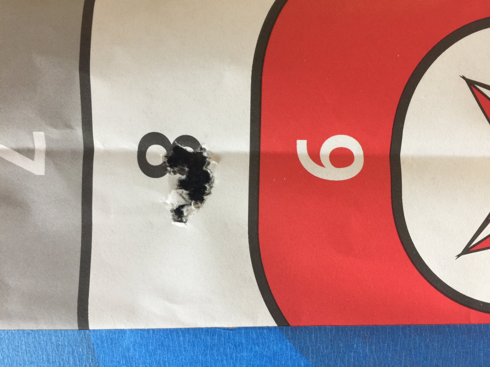

    How is your build coming along? I took my mostly stock 30 year old 10/22 and my Kidd super grade back to the 50 yard indoor range and shot some targets. 20 targets per page, one shot per target, 10 ring is 0.25" diameter. Unfortunately, my printer shrunk the target slightly. The outer diameter was supposed to be 1.5", but is actually 1.43" in diameter. Oh well.
    Stock 10/22 with federal "target" ammunition...
    7074824
    I scored this as 137 out of 200.
    Next, the Kidd supergrade with Lapua center x ammunition...
    7074830
    I scored this as 186 out of 200...
    I also shot a 12 round group- to finish off the box...
    Zeroing the calipers on the hole diameter, I got a center to center measurement of ~0.65".
    7074832
    There's a lot of lateral dispersion, which I take to be my shooting. I don't think I would have cleaned a 50y KYL today. Anyway, another datapoint for your quest.

    Have you managed to get your hands on a MOA receiver? I can’t get any response from the e-mail or the phone number.
    Havnt done a thing to this build since last post. Bills and Christmas and bills have been kicking my buttttt.
    I have a MOA receiver but its not from them. My gunsmith friend has a one of them from many moons ago. Pretty sure the company that made them is out of business.
    Honestly I have been getting some cold feet about putting this kind of money into a semi auto when I can get a Vudo for the same so I am at a stopping pt...until I get some $$ saved. or until I convince myself I wont be giving anything up shooting a semi to the bolt.
    $99.95 - KIDD Bolt
    Stock - $500 +/-
    Bedding - $200
