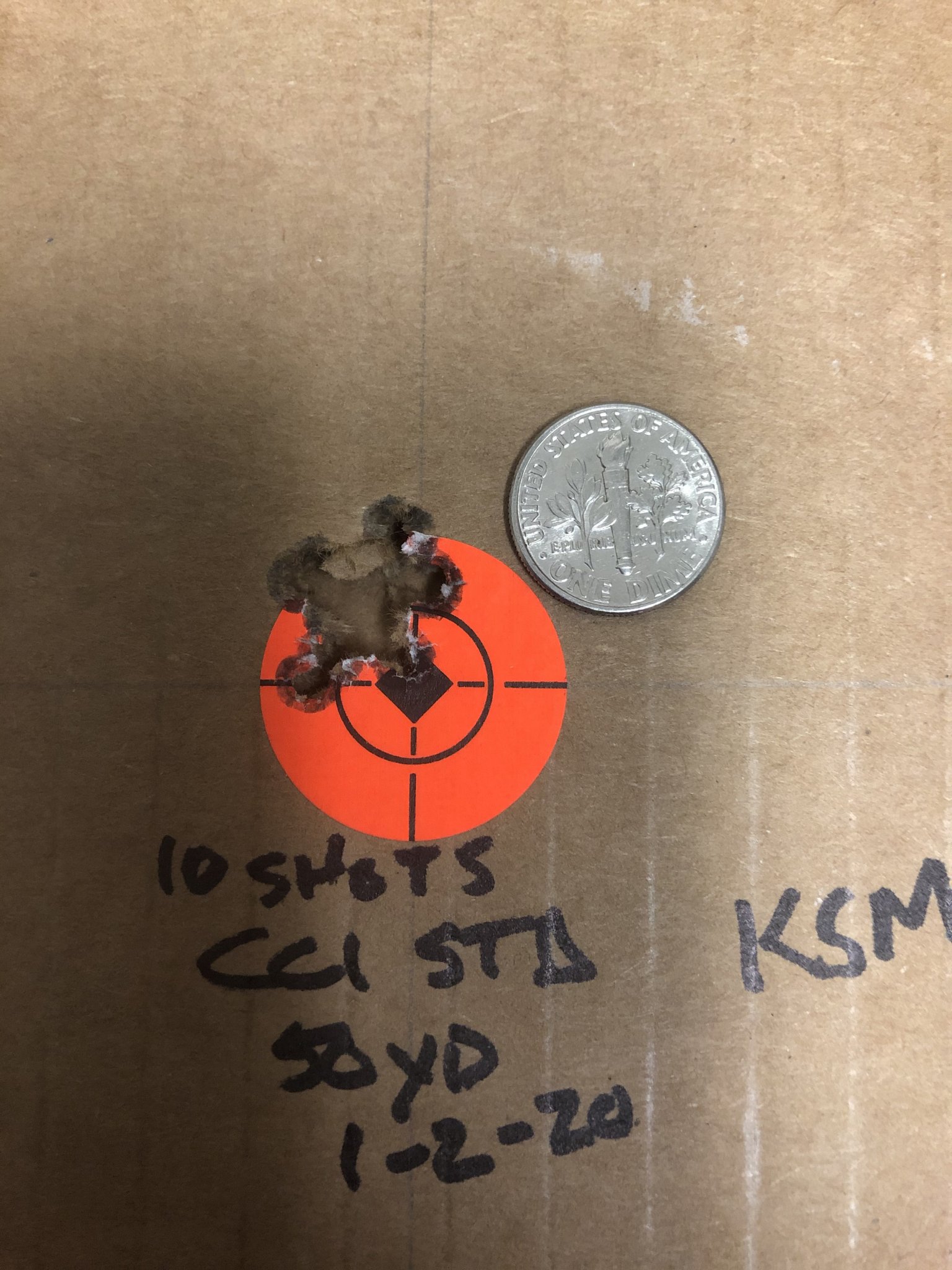

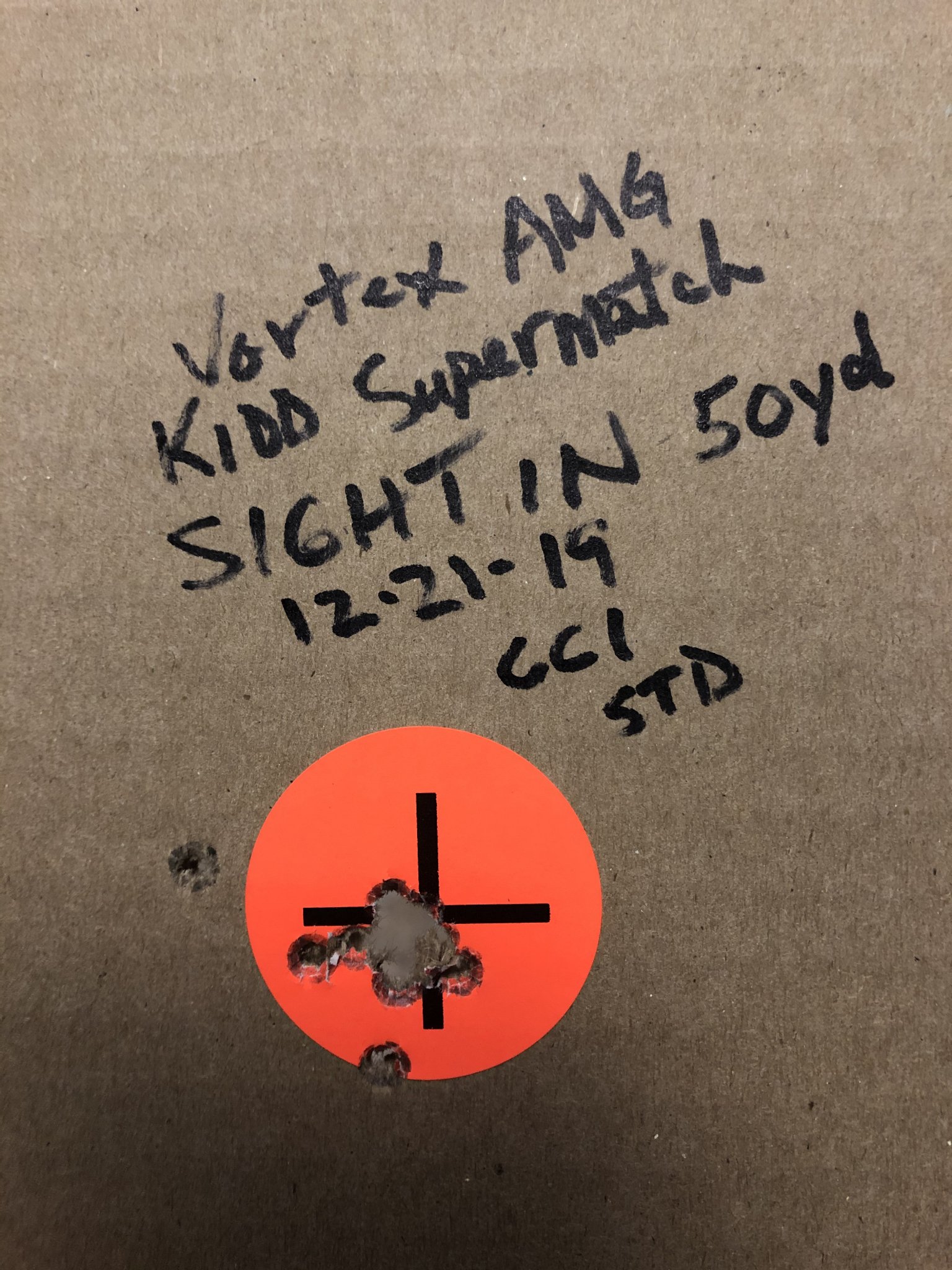

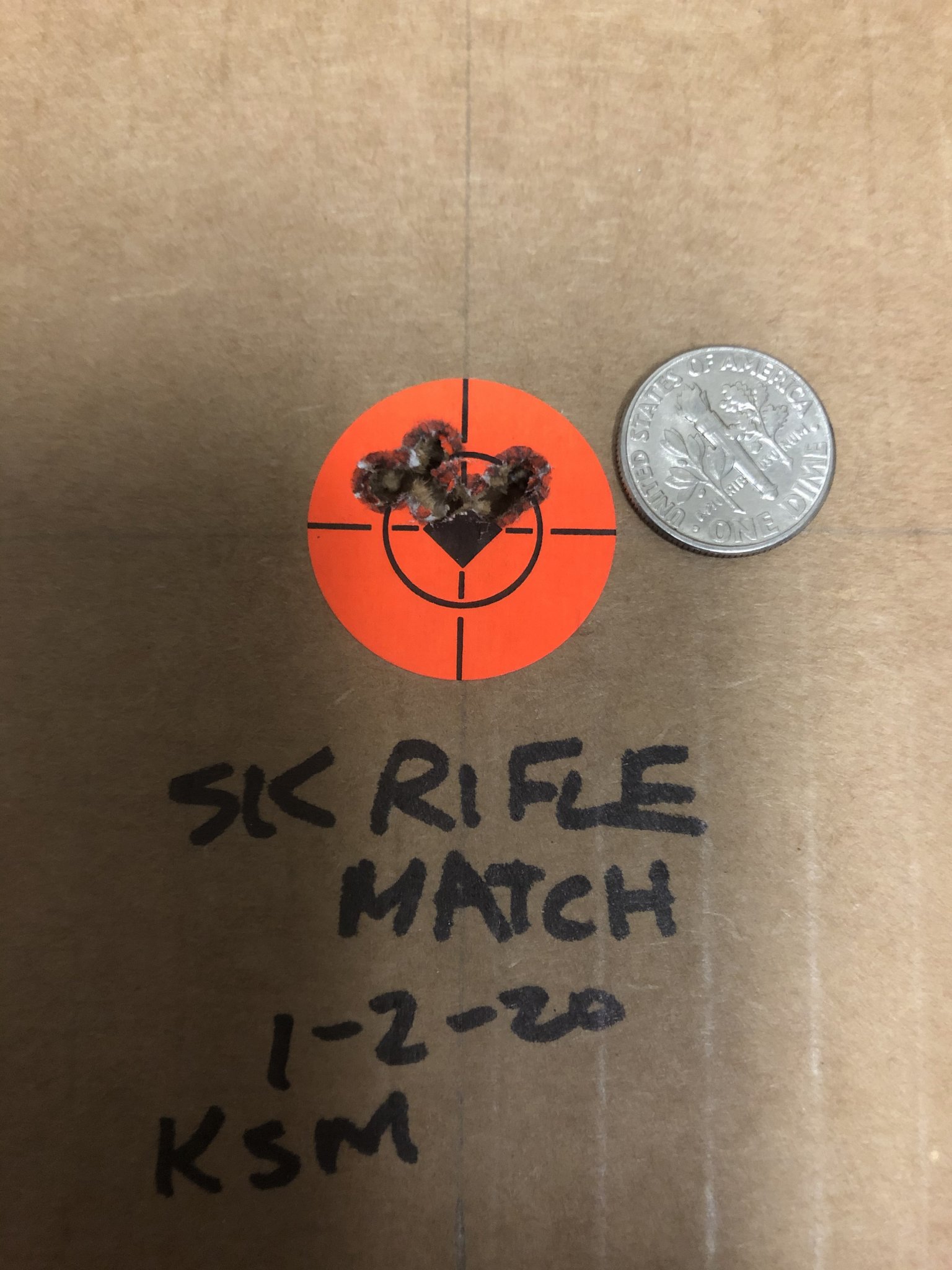

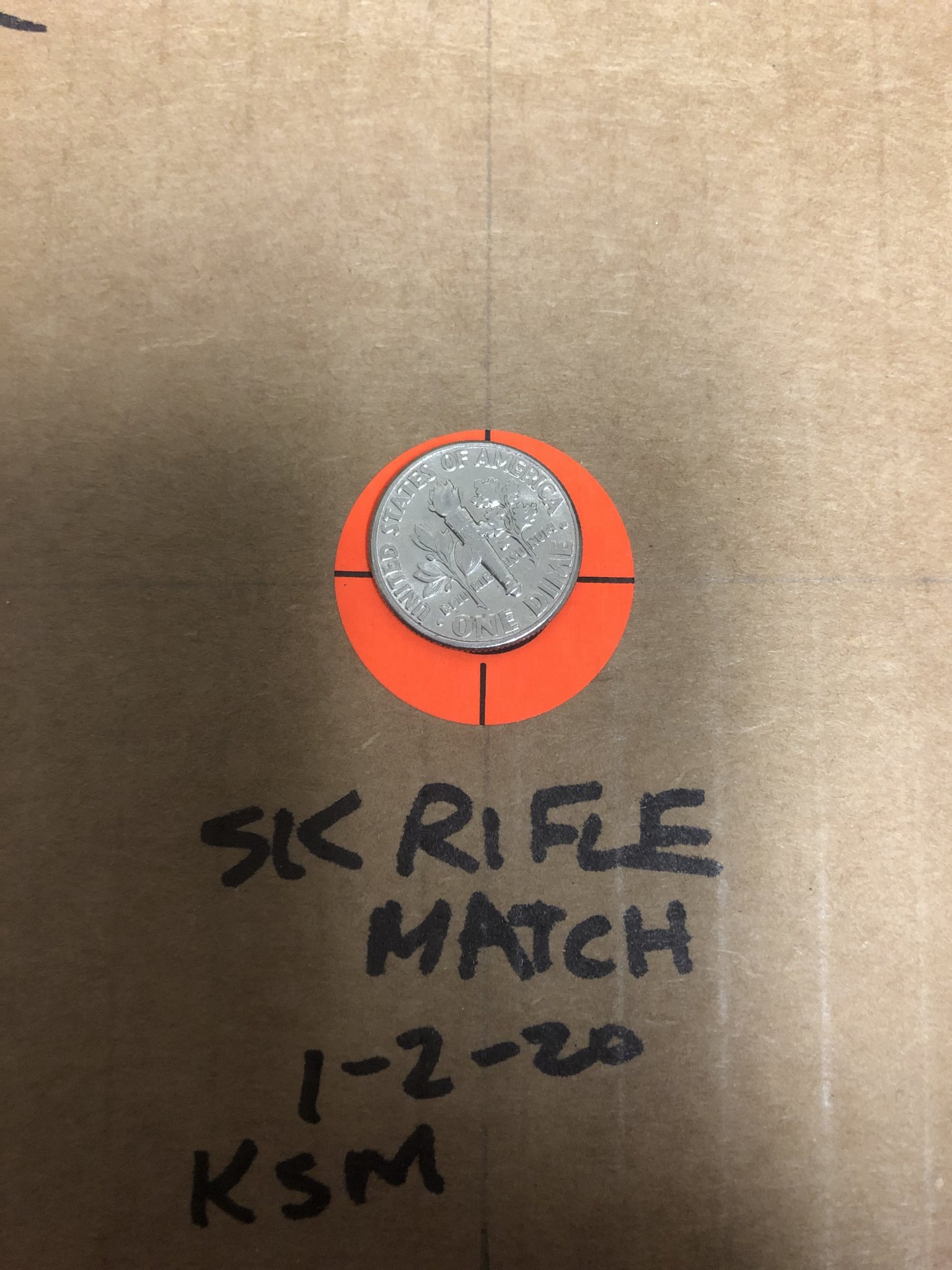

I'm just an old guy that likes to shoot..... I was looking at getting a V22, but the prices I seen were 2K+, so I went with the Kidd Super Match because it was much less and barrel swaps are a so easy. (like one minute easy) I picked it up a couple weeks ago. It's got a Kidd /2 stage trigger. I just started testing different ammo brands today. I don't know if my rifle will hang with a V22, but it definitely will shoot CCI SV and sk rifle match inside a dime at 50yd. The orange sticky dots are 1" and the rifle keeps CCI SV, SK Rifle Match and Ely Force well inside the orange at 100yd. Those three brands have grouped the best of the brands I have tried. I should mention that Federal HV match looked pretty good at 100yd too! a couple of sample pix attached. PS.... my grandsons love this rifle.

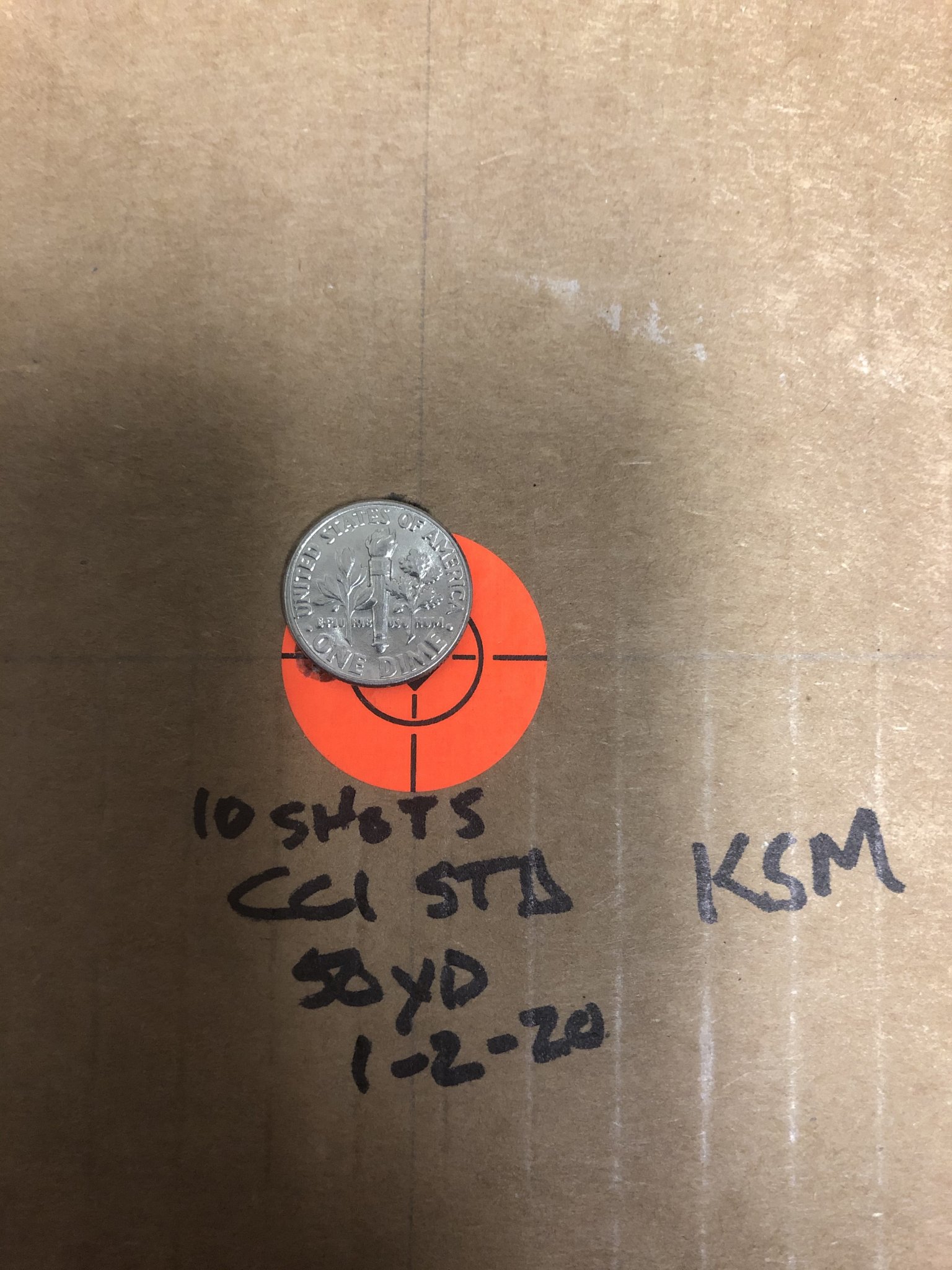

Thanks, I am impressed with this little rifle. The barrel makes it so worthwhile.....for cleaning or swapping. The first group out of the Kidd SM with CCI SV was impressive......literally 3 shots (see attached) o dial and 7 through the same hole. The Kidd 2Stage trigger is incredible.....really fun to shoot this rifle.

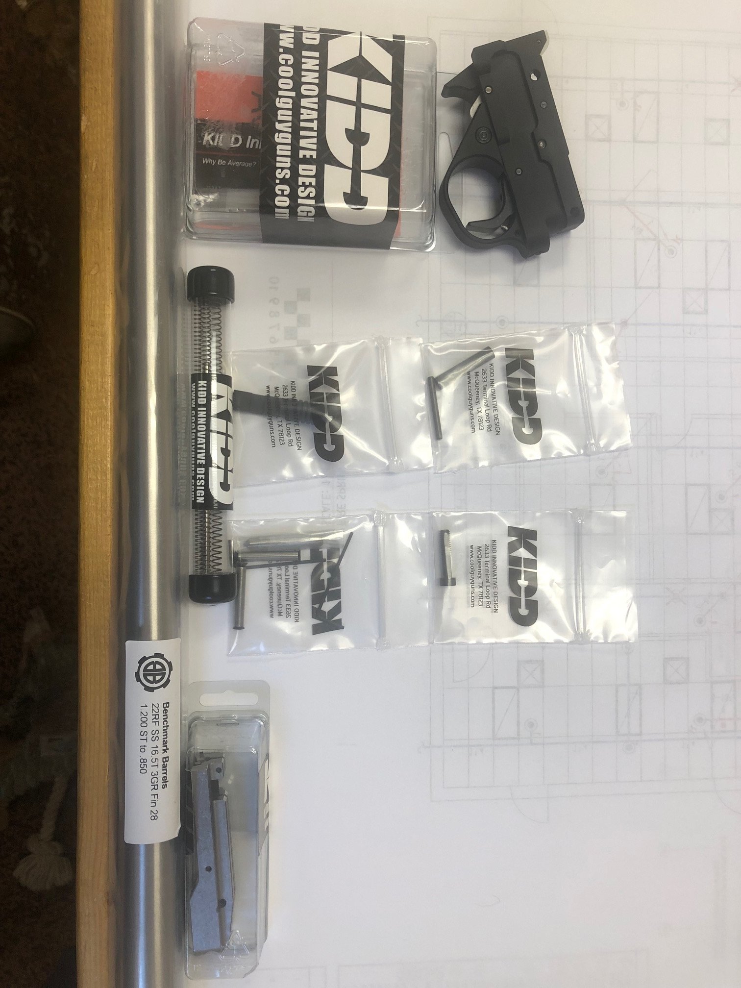

Decided I hate $$ and am going all in on a build for BR and NRL matches.
SO far components I have and price
$340 - Benchmark SS 16.5t 3GR 1.2-.850 taper
$250 - KIDD Single stage trigger unit 1.5 lbs
$99.95 - KIDD Bolt
$6 - KIDD Takedown Screw
$29.95 - KIDD Threaded Receiver Pins w/Countersink tool
$29.95 - KIDD Bolt Handle Charging Assembly w/Guide Rod & Springs (Black Ring)
$5.95 - KIDD Bolt Buffer
$200 - MOA Corp stainless receiver
Yet to order - Mcmillan A5-22 stock. Honestly looking to save by getting a used one but ends up they are pretty rare. Have a line on one but havnt pulled trigger yet.
Stock - $500 +/-
Chamber job barrel finish at 24" - $250
Bedding - $200
Tuner - $250 (leaning towards CHacons PRX II tuner)
Thought process is this. Why not use a semi auto for NRL? All targets are inside 100 yards for the NRL required COF and there are a lot of position changes as well as mag changes. A semi auto will really shine on time. The only stage where I could be hurt is the KYL rack. If the accuracy isn't there, I guess I just don't go for the smallest plate. The last match I was at I kept missing the 4th plate anyways with my 40x so not a huge deal breaker. Second, I have a Stiller 2500X single shot for BR shooting. I want to take my Dad who is getting older now and then so I will let him use the Stiller and I will use the 10/22.
On the rifle itself. Why the action and components. I will get a lot of questions of why wasting time with threaded receiver, as there are more accurate rifles with screw and press fit barrels. While jumping/banging/moving/falling around on NRL type stages, I don't want any issues. Ever. I believe threaded is the only way this will happen. The MOA action also has a threaded rear tang screw. I don't know how this cant be a plus.
As for the internal components, KIDD obviously has something figured out to have the success rifle after rifle. I get it that most people aren't used to anything considered accurate with factory Ruger 10/22's or rifles in general so even a small upgrade is worth the change, but KIDD gets it right time after time. That being considered, I decided for all KIDD internals. Quite happy there.
I will update as project progresses. I will be bitterly disappointed if Im not able to score at least a 245/250 on a IR 50/50 card. I plan to send it off to the Lapua testing facility to get ammo matched up for it.
pics of MOA receiver and A5-22 stock are off internet.
