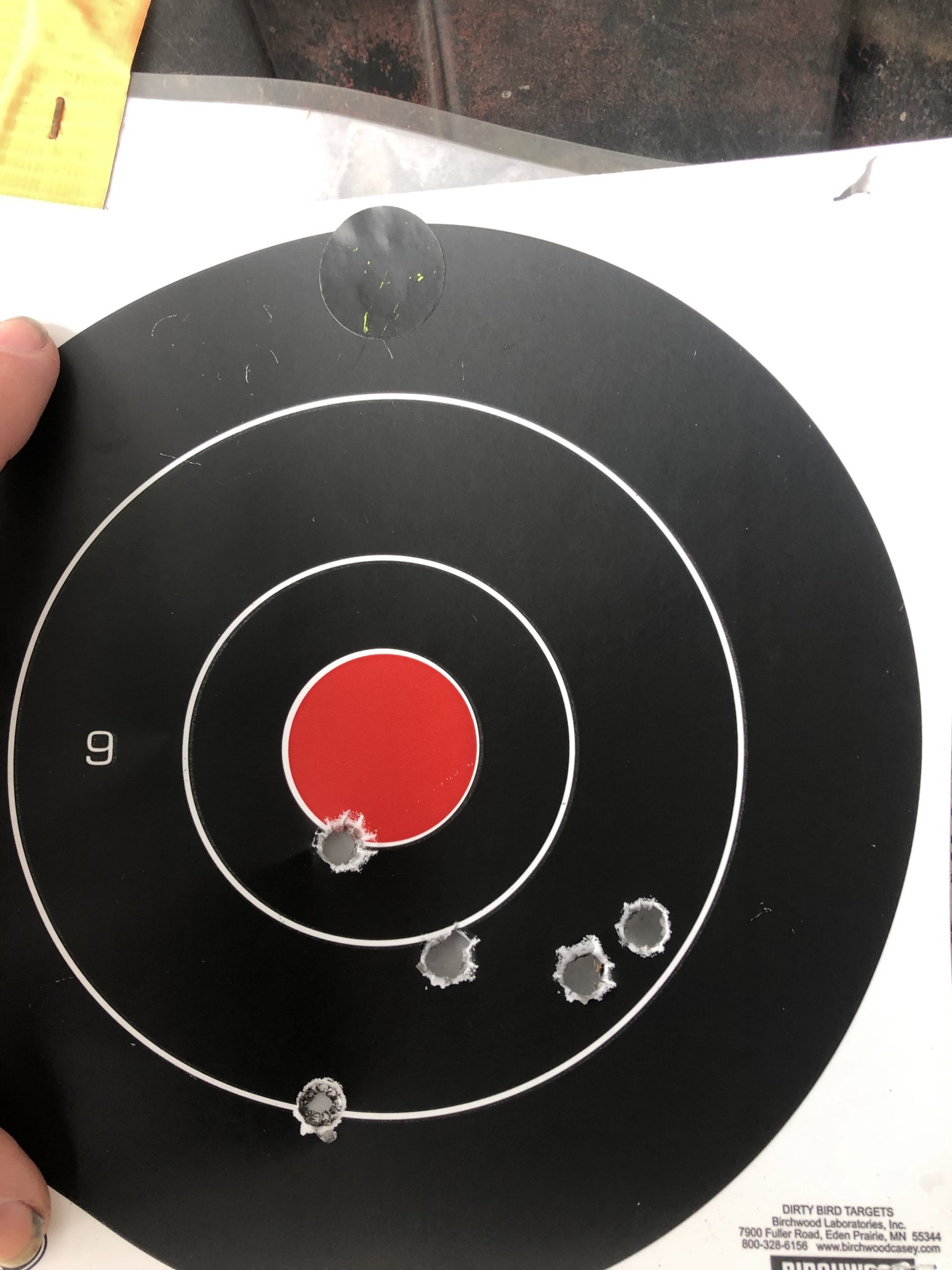

Hello,
I’m relatively new to posting but have been shooting for several decades
I have a high end rifle but don’t want to bash the company so I won’t post the manufacturer. Need less to say I’ve put $10k into this setup. Bartlein lapped barrel. Nightforce scope .
I’ve been reloading for a 338 lapua. I’ve shot hundreds of rounds now through it and have found a good speed node. SD are always under 10. The best group at 100 has been ,75”. My friend whom has been shooting long range for decades shoots it the same.
My hand loads are all weighed individually within .1 grains of h1000. Same brick of CCI 250. I’ve used a comparator on all my measurements and the shoulders are bumped back .002”. Base to ogive are all within .0005. In groups of five I’ve seated from touching the lands to ten thou off in .002 increments. I’ve tried 250, 300 and 285 all with these methods. All match grade. I even bough a concentricity tool and none of them are over .0002. All Lapua brass. All Redding full length sized with .002 neck tension. I even wipe them down before single feeding them
I torqued all the bolts, rings, scope bases to the manufactures spec. No brake strikes. Put a bore scope down it and can see anything other than minor scratches. I cleaned it too.
i can hit a 3” gong at 500 with my 6,5 Tikka very consistently. I’ve had 1” groups at 400 under ideal conditions with my Tikka. I don’t think it’s shooter error. I use my parallax correction religiously.
I think that’s as thorough as possible.
i took them out to 200 thinking the group would improve due to the fact the manufacturer claim it’s yaw but at 200 the best group I got was 2.5”. Some are over 3” 🤬 At 500 I’d get a hit and then the next shot would be way over a foot off. 2km winds.
Am I just burning money and have a bad barrel?

I don’t generally shoot 25 rounds or less and take breaks after 5 shot groups. I have a good brake and the rifle is quite heavy. It’s a bit loud but I don’t seem to feel effects of recoil fatigue. I honestly enjoy the blast.

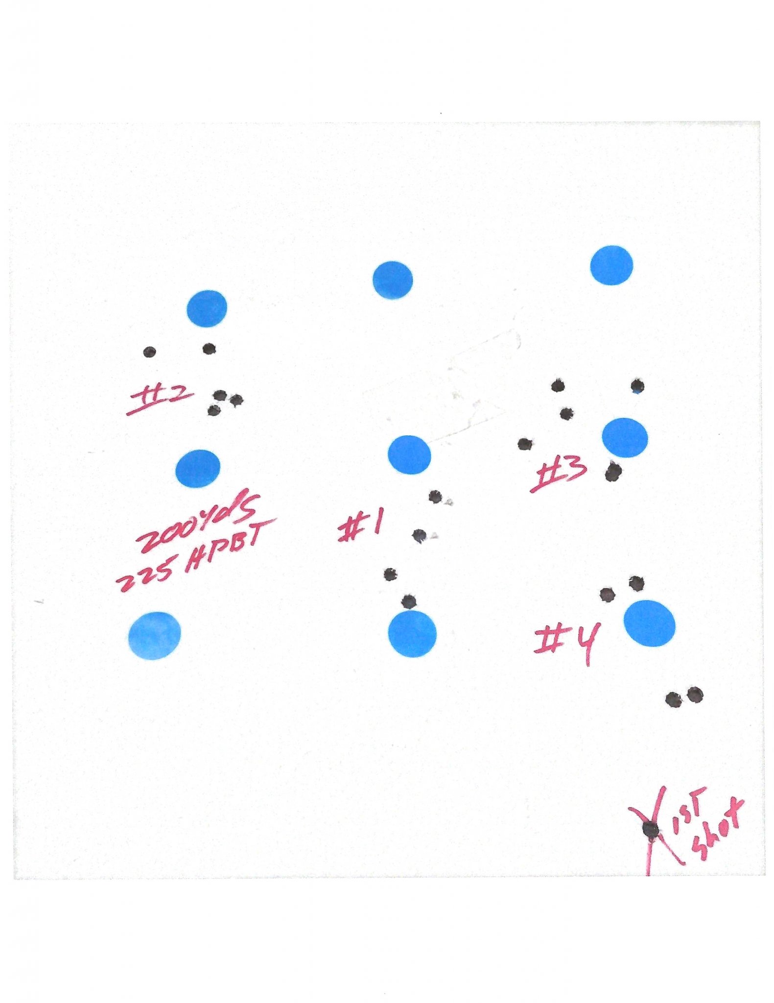

This is what a bad barrel does. Look at the picture. I cannot give out all the details other than to say it's not our barrel. Testing was done by both the shop that put it together for the ammo/bullet maker for testing of a relatively new cartridge at the time during PSR2 and ASR. I was at the range the first time the gun was shot and the set up being tested and it was tested at both a 100 yards and 1000 yards. It's a big magnum round I won't give out the caliber/cartridge. Then the gun went back to the shop that did all the work. They checked everything and went and tested the set up again. They said doesn't happen often but it's a bad barrel.
The set up was rebuilt with our barrel. Same chamber reamer etc...gun went right to shooting.
So back to one of my comments earlier...if the gun is shooting consistent groups of .75moa. It's not a bad barrel. There is something else going on.
That looks like the groups (patterns) from my CZ-527 6.5 Grendel.
Inconsistent impact points. And groups wander around.
It's not bedding, it's not the loads, it's not the optic and most likely not the nut behind the butt.
I scoped it last month and the view from the inside reminded me of a Savage sewer pipe.
Most Savages will still shoot looking like that.
This is the only CZ I've ever encountered that didn't hammer.
Eventually it'll get a new barrel because it's too pretty to send down the road.
But yeah, what Frank said

I put the brake on to manufactures spec. 45lbs.
The groups you showed were just like mine at 200. My buddies 300wsm shoots better groups than this at 500.
