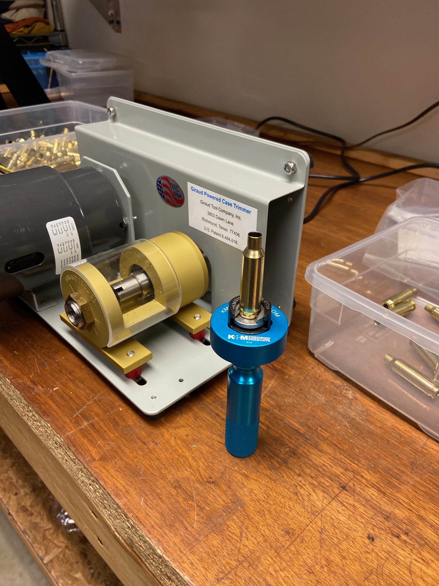

Not so much es or sd, but time. I can trim brass in my giraud crazy fast. It takes me like 15-20 minutes to do 500 pieces. Iv never actually timed myself but it’s so fast I just do it everytime because why not.
I use a Giraud as well and the speed, consistency, and convenience are worth it for me. It chamfer both the inside and outside of the case mouth and does a great job. Haven’t used a Henderson but it looks like a sweet tool as well.

I use a giraurd. It is very worth it to me for the speed. I don’t fall into the category of thinking that every case needs to be trimmer to within .0001” of each other to perform well. I know I have measured consistency in the past with the giraurd but don’t remember the exact numbers. It has slight variances but plenty consistent and I don’t notice a difference on target.

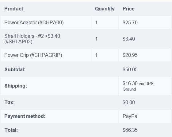

I have a Giraud and am extremely happy with it. However, I suggest that anyone who gets a Giraud spend another $66 including shipping (and yes, they rape for shipping) and get the K&M Power Adapter (etc, shown below). This a very quick collet type hand tool to keep the vibration out of your fingers. Sort of like the Henderson in that respect. Its great quality, not much money, and works extremely well.

My Giraud trimmer is the one single piece of equipment I cannot do without. I no longer compete and need to trim 5,000 or so cases per year but that trimmer is indispensable to me.
