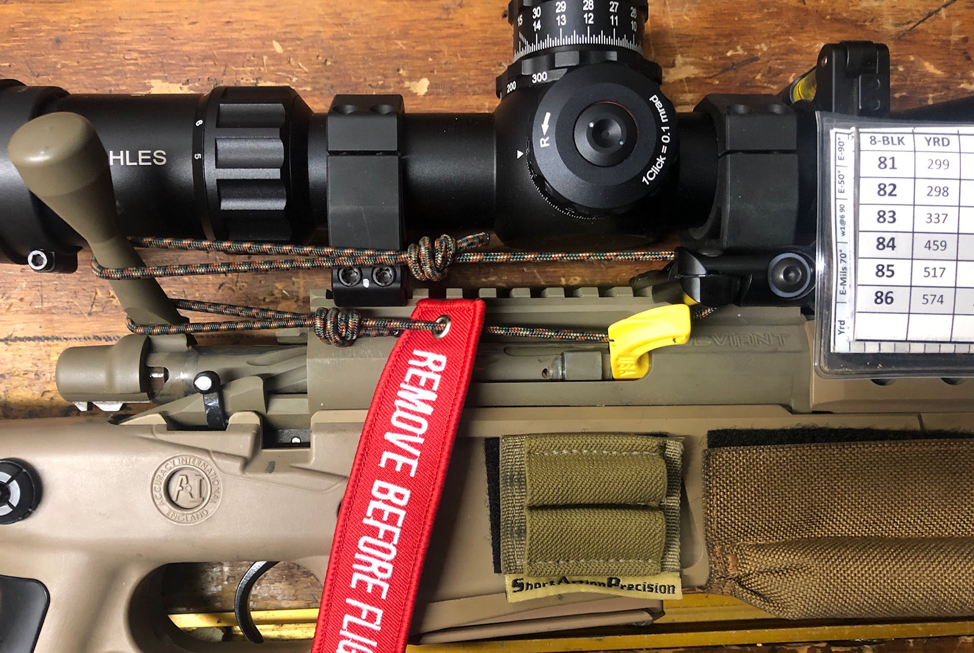

    I steal a hair tie bungee from my wife then wrap it around the bolt handle and windage knob on the scope. Keeps the bolt handle in the up position and pulls it forward against the chamber flag.

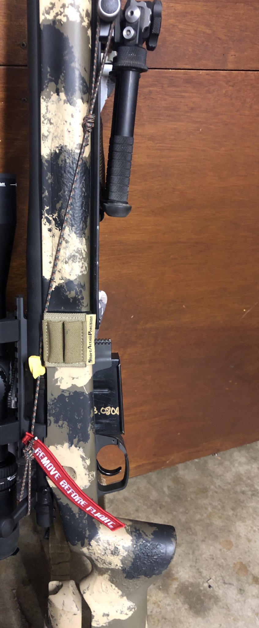

    Yeah that’s kind of in the pictures. I also run the scopecoat. Maybe the bungee to the windage is enough. I just looped it on the bold handle in through the chamber flag and up to the bipod. But it looks weird

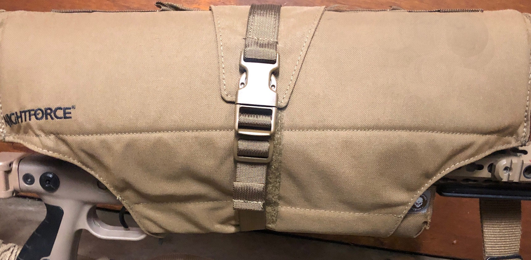

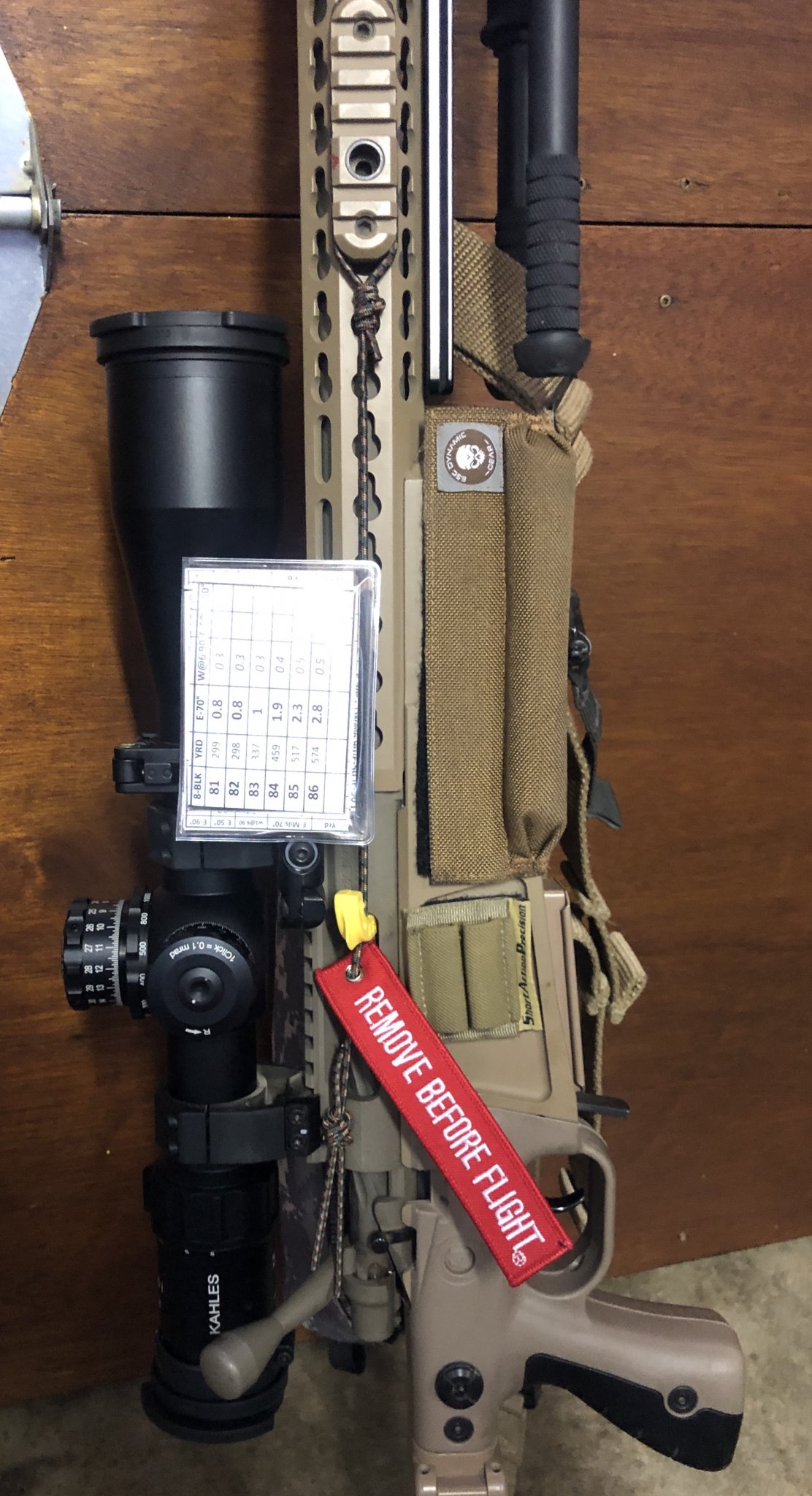

    FYI here is what I ended up with. but still open to ideas.. Modified Per Sheldon N 's "over the windage knob suggestion and the Night Force 19" scope cover.. The cover isn't ideal, but probably good enough and covers the open bolt
    Also tried the Sunrise but it is really baggy..
    The remove before flight is only to help me find the damn thing in the weeds or powdery dirt if I step on it..
