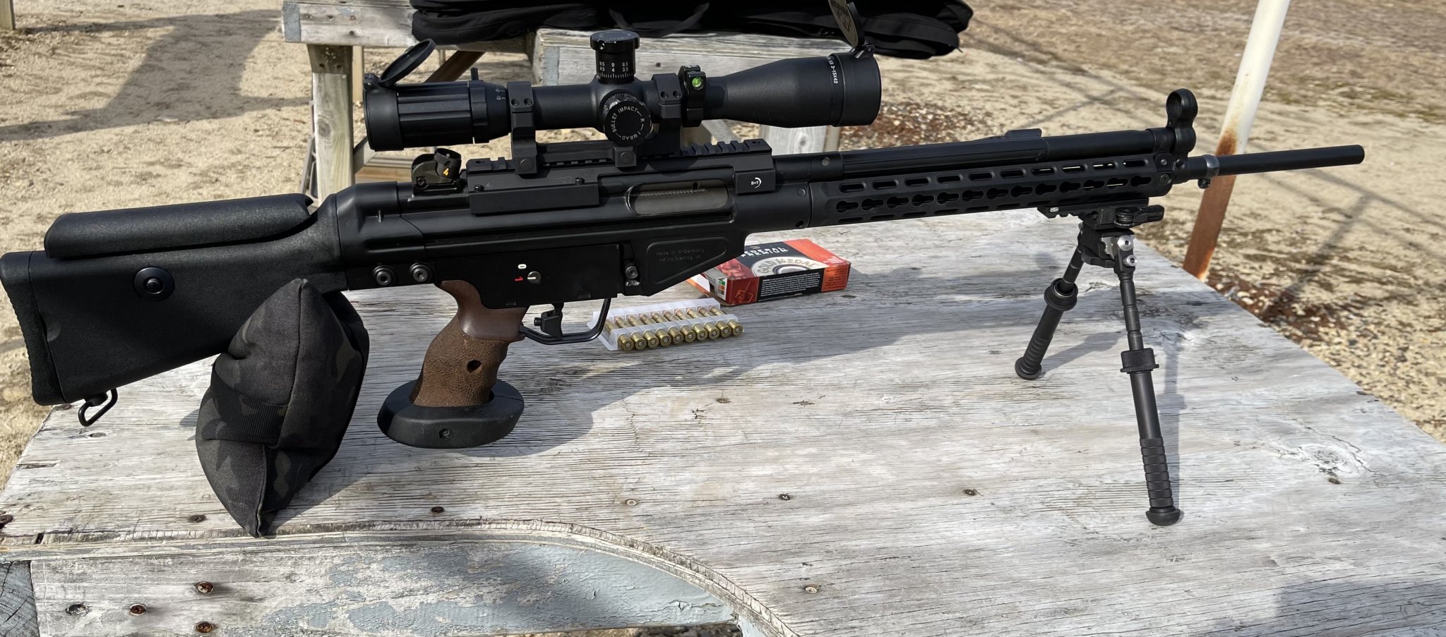

    So I have owned this rifle since I purchased it new in 1994. I have never fired it because the original forearm could not accommodate a bipod and the available scope mounts placed the optic in a position that was impossible to get proper eye alignment (at least for me). Thought about selling it a number of times but I decided to keep it and figure out a solution to both issues. BT in Switzerland finally solved the scope issue and another company provided a compatible forearm assembly that could accept the ATLAS. I got the parts a week or so ago.
    Lots of angst about how it would shoot. I am happy to say that it was a fun day. I threw on a spare SS 3-15 and fired 20 rounds of FGMM 175 grain ammo. It was grouping slightly less than 1 MOA! Next time, I will shoot from prone and dial it in.

    I didn't find the recoil all that bad at all. I would assume that the scope cut was a result of the "claw" mount which was a fundamental reason I never shot this rifle in all of the years I owned it. The B&T rail and Badger mount gave me great eye relief. It also prevents the reticle walk you discussed because it is a machined piece of thick aluminum. It provides a clamping force along the top surface of the stamped receiver to prevent flex. The groups I shot today were averaging about 0.85 MOA which is mediocre for a bolt gun but not bad for a semi. I am actually looking forward to shooting it prone against my KAC and Larue AR10s. I think the PSG-1 trigger is hugely better than the stock trigger. I have heard that the Williams set triggers were even better. Would love to try that out.
    I agree that cleaning seems like a bitch compared to AR rifles but haven't tried it yet. The roller system certainly destroys brass but that isn't a biggie for me as I only shoot factory.
    All in all, I enjoyed shooting it and will continue to do so. SR9Ts sell for 3-4X what I paid for it in 1994 so that is nice as well but meaningless as I don't intend to sell it.

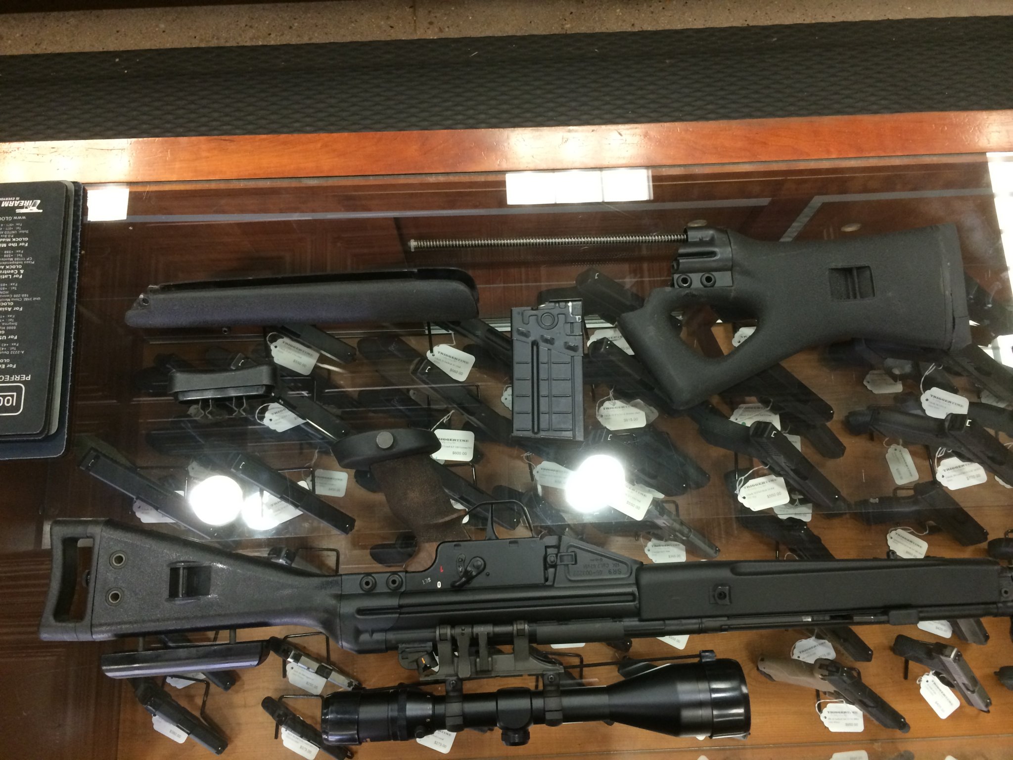

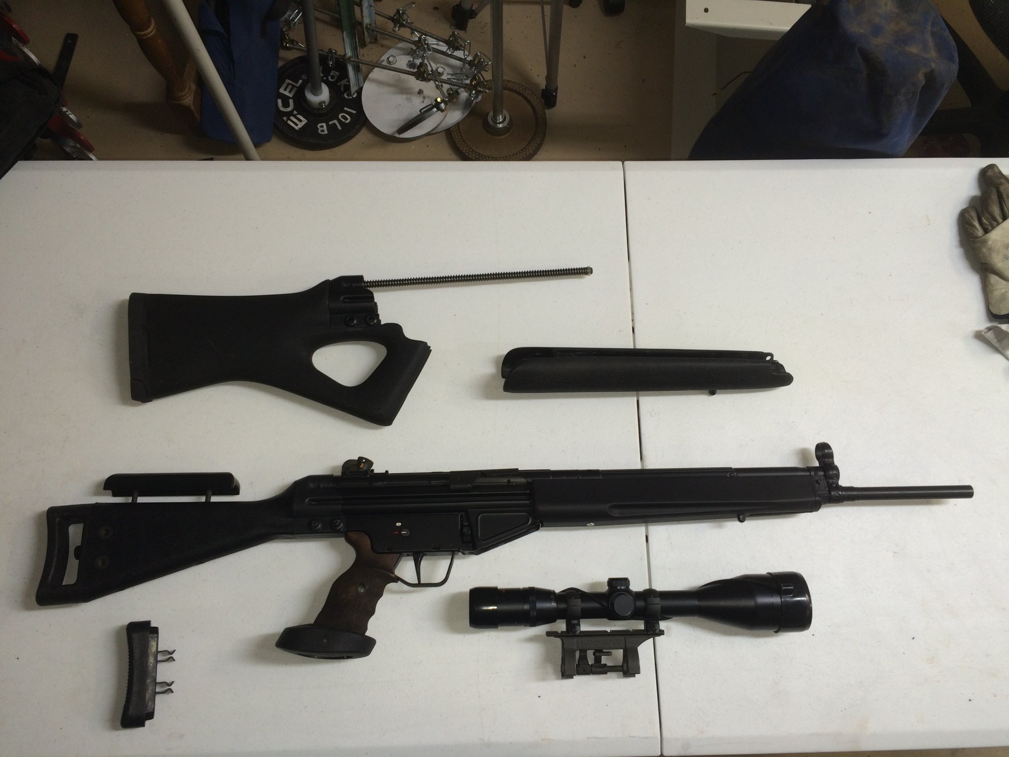

    Pics from just before selling it. One at home, one on the lgs counter. Originally came with the “foam” enclosed stock and forearm, replaced those with real HK wide forearm and adj cheek stock. Think it was a GG&G claw mount with a Springfield Armory 1st gen scope 4-14x w/internal level, illumination and rangefinding reticle, lol. It’s neat to see it on display once or twice a year when I go into that shop. Reality was that I hadn’t shot it in 24+ years and it filled no purpose with my current matches and just was a safe queen. Now ppl get to look at it and it is in good company as it sits next to a bonifide PSG-1 on the display shelf.

    That claw type scope mount in your top picture is the one!! Whatever engineer thought that one up should have had his head examined..I keep the one I have for nostalgia sake.

    it was designed to allow the iron sights to be used while the scope was mounted. Hollow underneath. This was a battle rifle. Optics covered in mud you could use the iron sights.

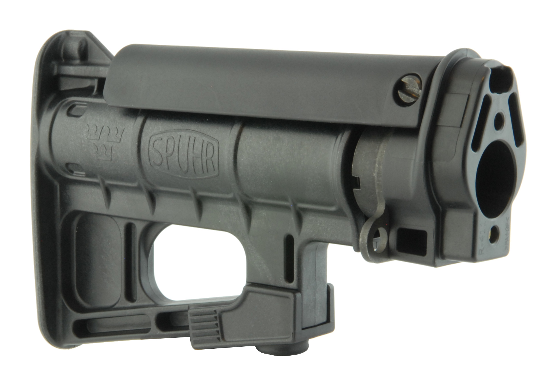

    It may but the stock on my SR9T has an adjustable cheekpiece so I didn't need that
    The adjustable lenght plus the raised center of the Spuhr‘s stock reduces the inherent muzzle rise in all the hk stocks. the Spuhr‘s center column allows use of the 21e extra long buffer. I have a sg1 stock and a A3 and the Spuhr is worth the investment for those three reasons. I also added a limbsaver buttstock pad to the Spuhr which required moving the adjustable stock farther forward.
    so adjustable height. Three different cheek pieces. raised center of forces vector which reduces muzzle rise which allows control in FA and the adjustable length which allowed me to locate the various optics as needed in their mounts and then their position on the Spuhr top rail. Hakan fixed all the issues.

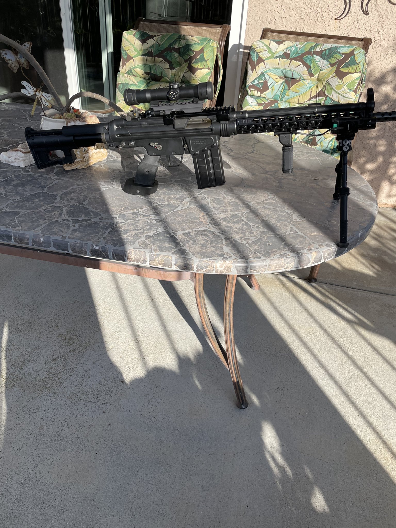

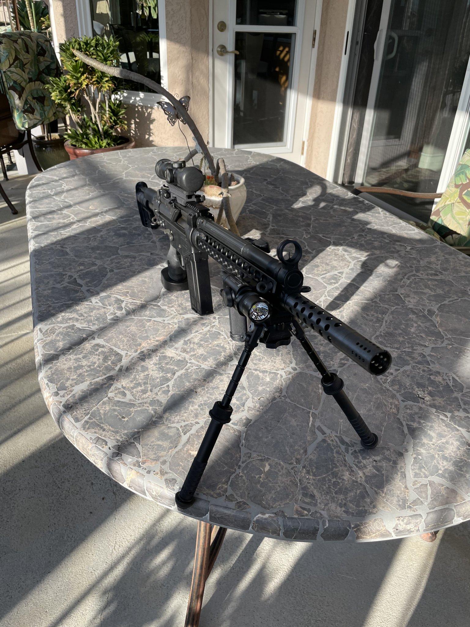

    Here is a not very good picture of my 911 with a arms #63 QD mount on the Spuhr top rail.
    i have Another arms #63 QD mount with a set of weaver 6 point low mounts and a 5x25x50 vortex pst ll scope.
    if i mount the vortex I change the Spuhr cheekpiece to their tallest one and even though the scope is 15 inches long it is high enough to clear the front sight and allow the charging handle to still be worked ok.

    169 grain bullets , 5x25 scope. Better bipod. Better stock. Better recoil buffer. Better QD scope mount. Better top rail. Better light/laser with remote pad. Better forearm.
    bet i can get to .75 MOA or better with the better BC 169 grain Sierra BTHP Match King. Reports are that they will stay supersonic past 1,000 yards.
    all this from a 32 year old battle rifle. Sniper grade it turns out.
    oh on the iron sights? I agreed somewhat on their lack of distance shooting ability.
    WTS mentioned that the front sight pillars width was set to be a torso width at 75 yards. They suggested narrowing the width of the front sight s verticle pin. Which i did. Tried 1/3 less width in total. Good to 300 yards then the pin blocked the target view.
    went to 1/3 the original width. That was good for well past 400 yards.
    See my photos as the narrower front sight pin is visible.
    easy to drive the pin out and remove the inner part of the sight. Circle with the pin sticking up.
    one could have a stock width and a 2/3rd’s and a 1/3 width.
    I also mount a vortex holo 1 MOA laser sight and a 6x vortex flip magnifier
