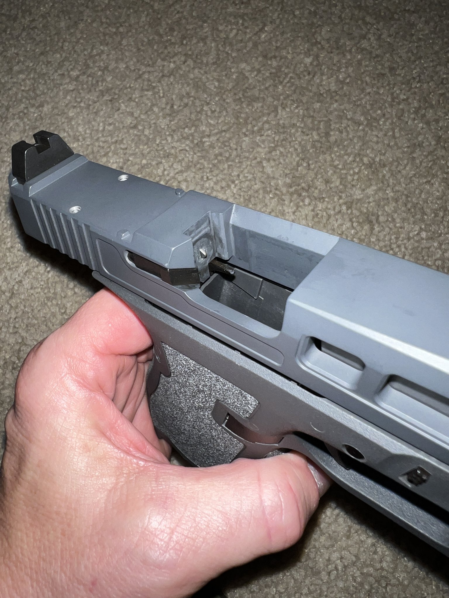

mikeinfwa Que Chimba Full Member Minuteman Mar 20, 2002 2,147 16,998 Jacksonville FL Oct 19, 2023 #1 Oct 19, 2023 #1 This pistol will not cycle properly

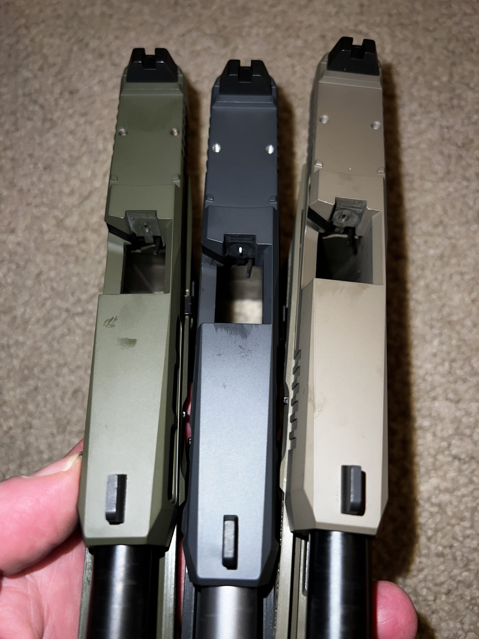

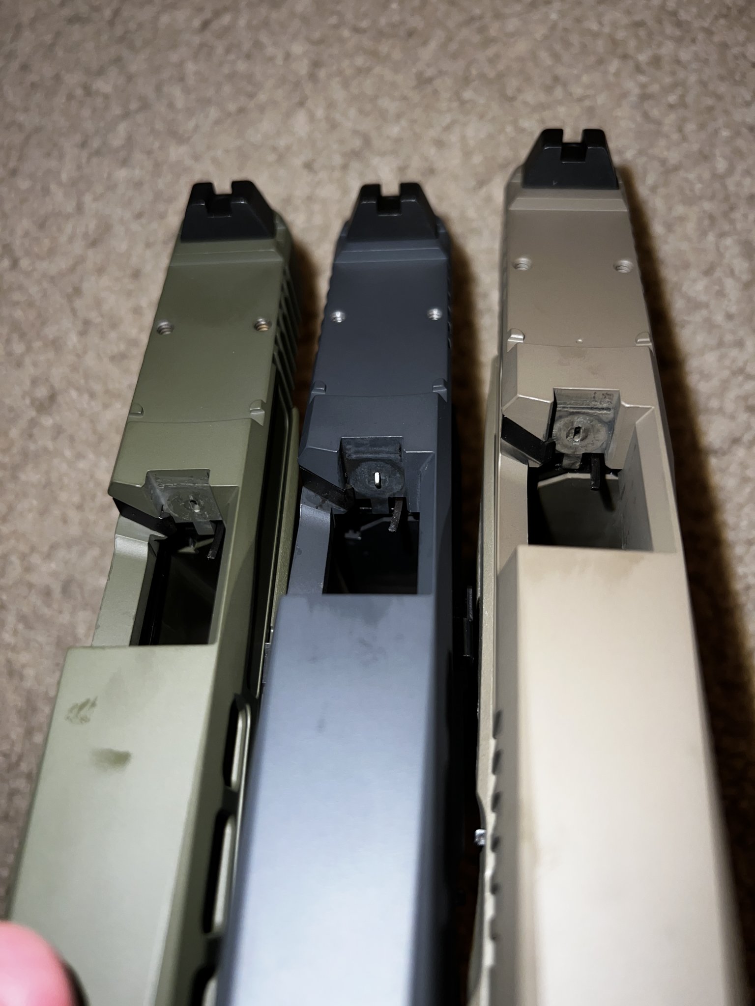

mikeinfwa Que Chimba Full Member Minuteman Mar 20, 2002 2,147 16,998 Jacksonville FL Oct 19, 2023 #2 Oct 19, 2023 #2 Swapped this upper with a different lower and it cycles properly. Placed a different upper on the grey lower and the issue remains. So its caused by the grey lower.

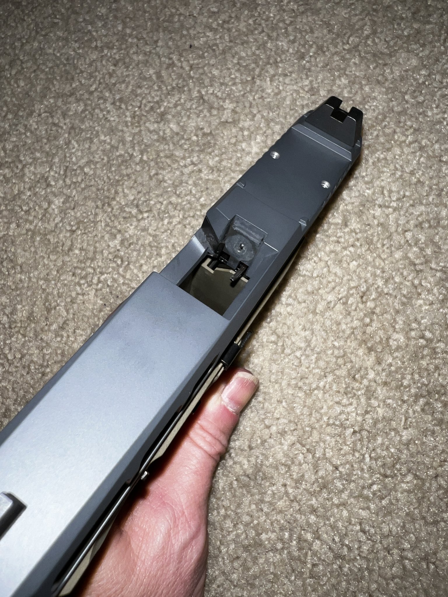

mikeinfwa Que Chimba Full Member Minuteman Mar 20, 2002 2,147 16,998 Jacksonville FL Oct 19, 2023 #3 Oct 19, 2023 #3 Well.. Cycled the slide and dry fired about 20 times and slide seems to be working fine now. Maybe it just needed to get broken in

SanPatHogger Major Hide Member Full Member Minuteman Mar 1, 2020 1,041 979 Oct 20, 2023 #4 Oct 20, 2023 #4 I had something very similar happen to my P80. Could be left over shavings or debris inside the slide. Pull the striker and blow the hole out.
