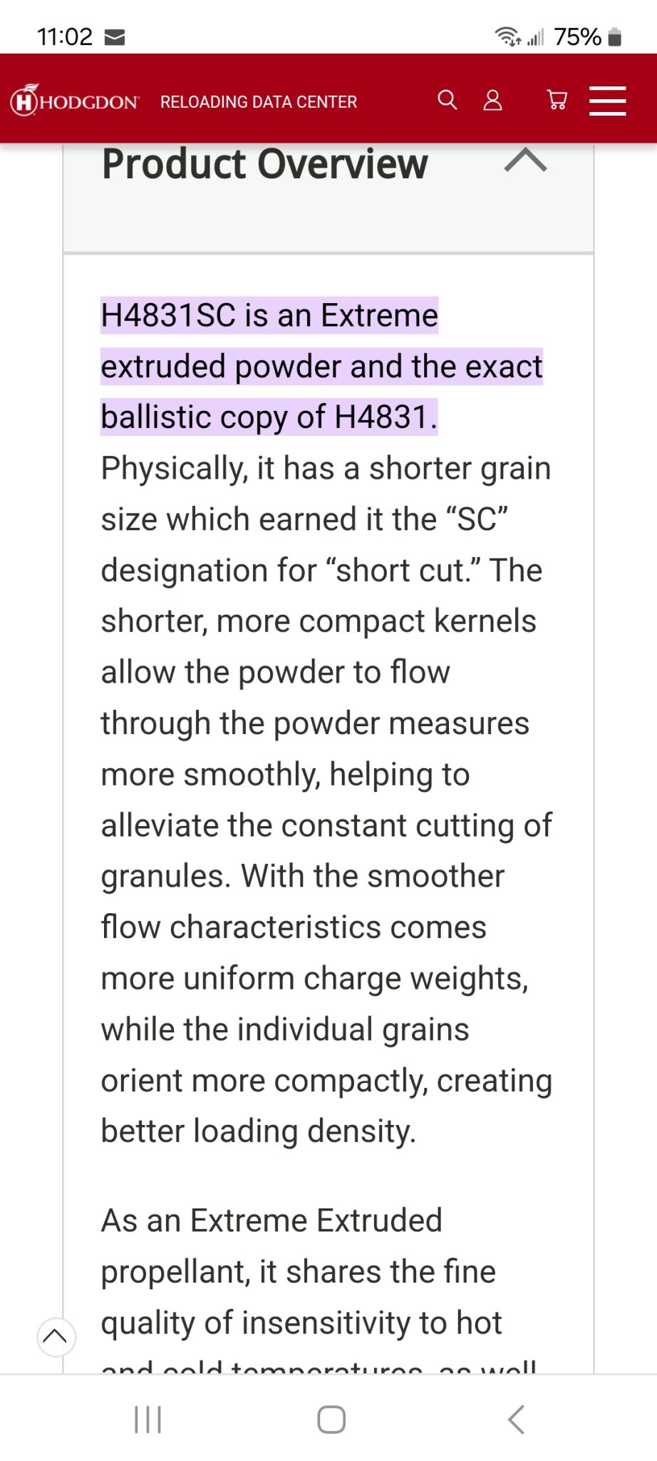

Simple question, is 4831 interchangeable (when loading by weight, not using a thrower) with 4831 SC? All the load data I can find just states 4831, but all the powder on the shelf is 4831SC
First time loading with this powder, just making sure.
When 4831 SC was released, Hodgdon specifically stated the load data was exactly the same. They are the same powder with different kernel sizes to allow the SC to flow better through powder measures and to allow a more dense case fill.

From Hodgdon:

Didn't take issue just commenting on the difference. Now if I were to take issue it would concern the comment "and the exact ballistic copy of H4831". Considering most every batch of a given powder is somewhat different. Marketing. Of course ADI discontinued the H4831/ADI 2213 quite a while ago so its really a moot point.
